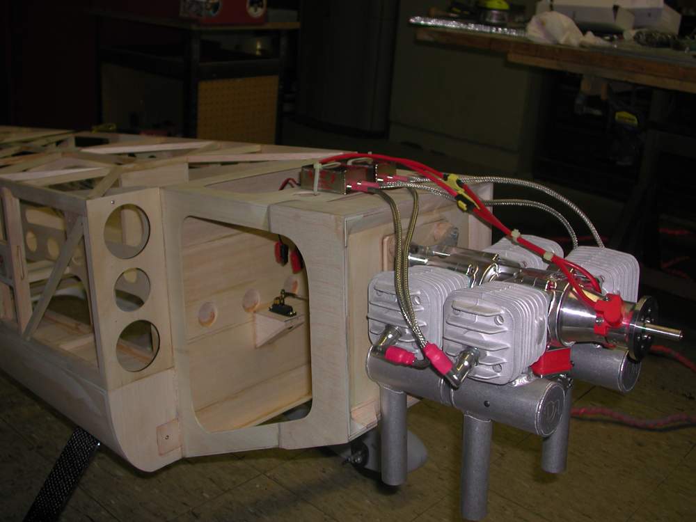

I use 'em all but thin CA works best with Gorilla Glue or epoxy over the top next after the CA dries, wetting the wood a bit helps gorilla glue adhere, on some harder, denser woods it doesn't soak in but just hardens on top giveing the "appeareance" of a glued joint
This is my scratch built 52% Extra 300 SP that weighs 48.5 lbs. with a DA 200cc, it has a 150" wing span and a 144" fuse length. It is completely constructed using CA on all wood parts and Gorilla glue for sheeting on foam parts only. This is a video that a guy was doing at a big bird event a couple of months ago.

VERY nice work sensei. It is exactly what I was referring to - the proper joint type and fit. I don't see much adhesive under tension there
I understand that yours are your designs but unfortunately, there are many kits out there that don't necessarily have as much thought put into the joint types.

Thanks for the kind words. You are right on the money, construction and joint design along with joint fit is all key to a strong and light airframe.
