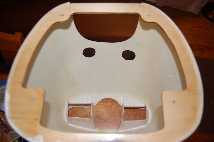

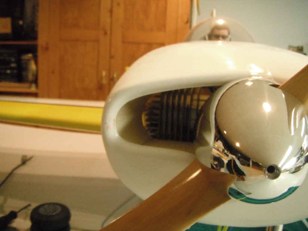

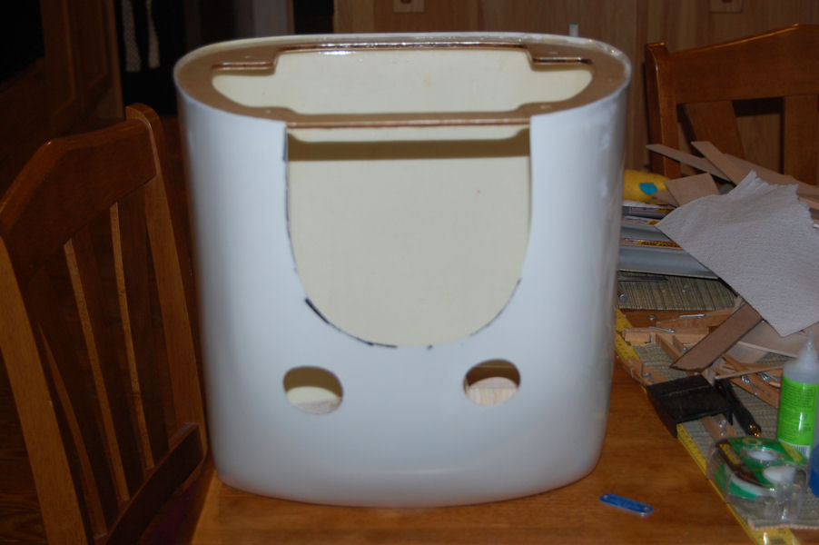

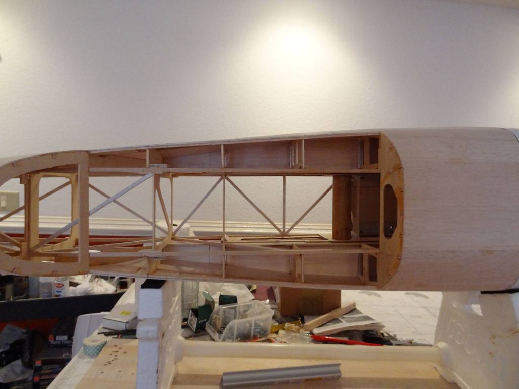

There's a hole in the bottom, pretty much what they showed on the plans. I made the cutout while fitting the cowl. The front of the exit cutout sort of sticks out a bit, such that the exit is blind to oncoming air.

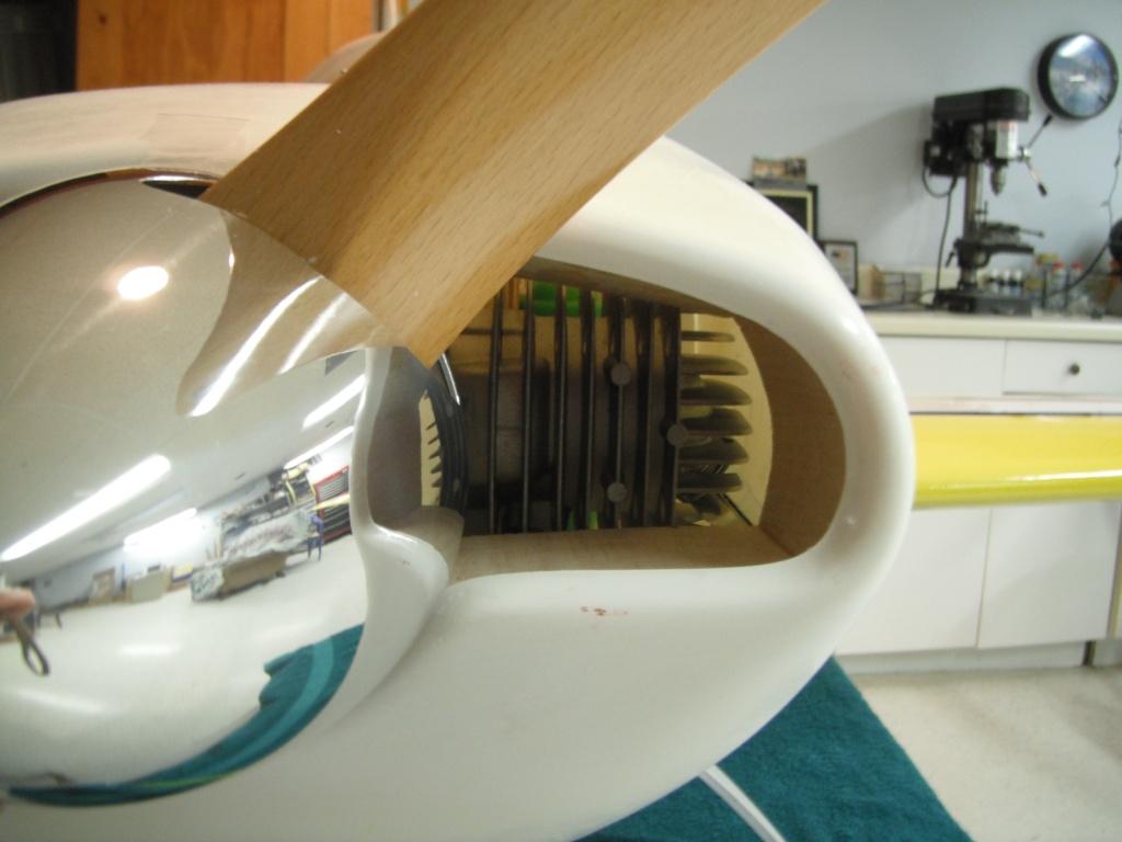

Very impressive. Now i am kickin' the tires again. The two fella's in this area that have these do not use any baffling. I was going to do something very basic such as shown in the picture.

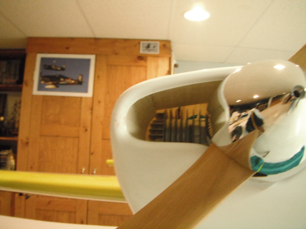

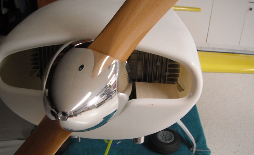

Followed your lead Impluse and added baffles. I am sure this extra time and effort will pay off with a cooler running engine. Also, i am happy to report that with all the equipment moved as far forward and possible and the correct prop and spinner added we have achieved the correct CG. No additional "dead" weight will be needed. My only worry now is radio interference will all that equipment tucked under the cowl. Three battery packs, ignition module and a smoke pump. I have to have something to worry about......[]

Baffles keep your engine happy happy happy. Looking sharp.

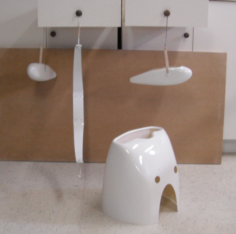

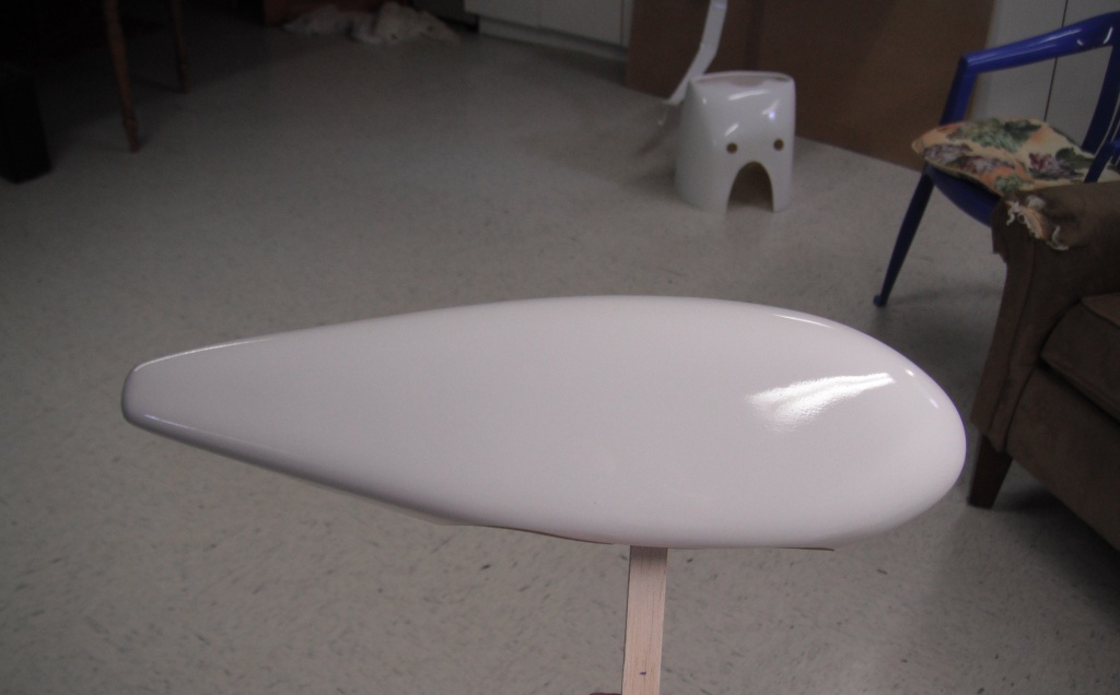

Wow,, actually able to upload pictures for the first time in two days.

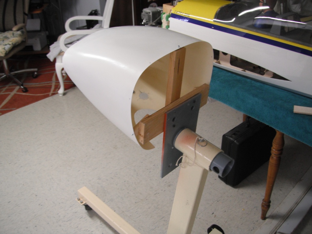

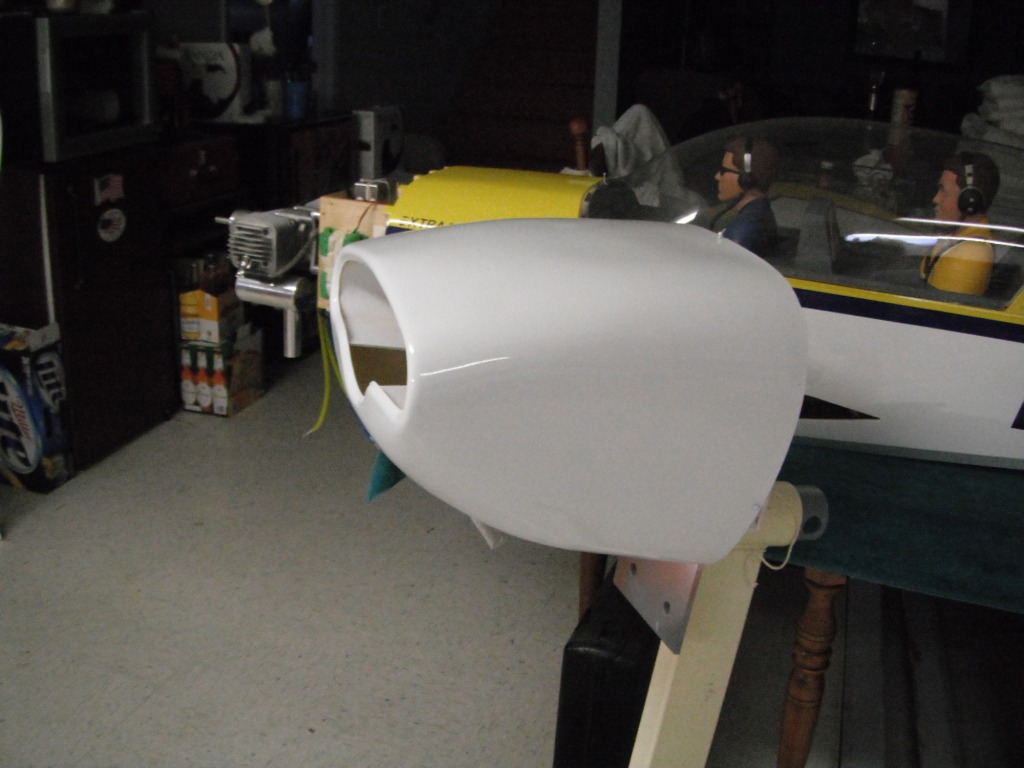

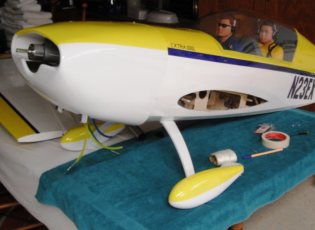

Got the cowl, landing gear and wheel pants painted white. Had a few flaws in the cowl to begin with so i sanded and repainted today after building a simple fixture on an engine stand to hold it. The first painting was done just holding it by hand and the best analogy i can come up with is it was like trying to hold on to an oversized basketball and trying to paint it. The first 2 pictures on the stand were after sanding, the last picture is after the second painting session, it turned out great this time.

Is the paint you're using compatible with the canopy plastic? Did you make that "Extra 330L" text near the nose?

Yes, it is compatible. I used it on a Goldberg Extra a couple of years ago. It is awesome paint. I got the graphics from Kirby Graphics, i know the owner from scale contests over the years http://www.angelfire.com/oh2/kirbysgraphics/index.html

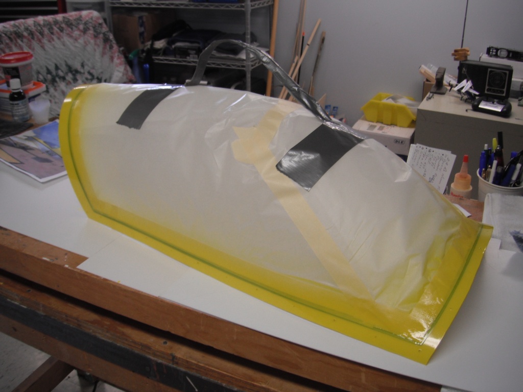

Yellow paint applied today. How about that high tech handling fixture on the canopy?

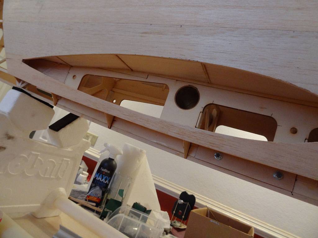

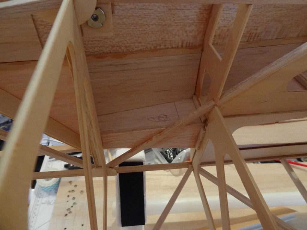

Gotta do what you gotta do to get the job done! I just got a shipping notice on my wing tube last night, so that plus a bunch of electronic gizmos should arrive this week. I did a balance check yesterday with all the servos installed and I'm definitely not tail heavy, which I consider a good thing at this point. I went ahead and walled off the wing root area inside the fuse, and I'm considering rigging the wing to accept nylon bolts from inside the fuse, which means I would have to scratch a new accessory tray. Cockpit interior is finished as well.

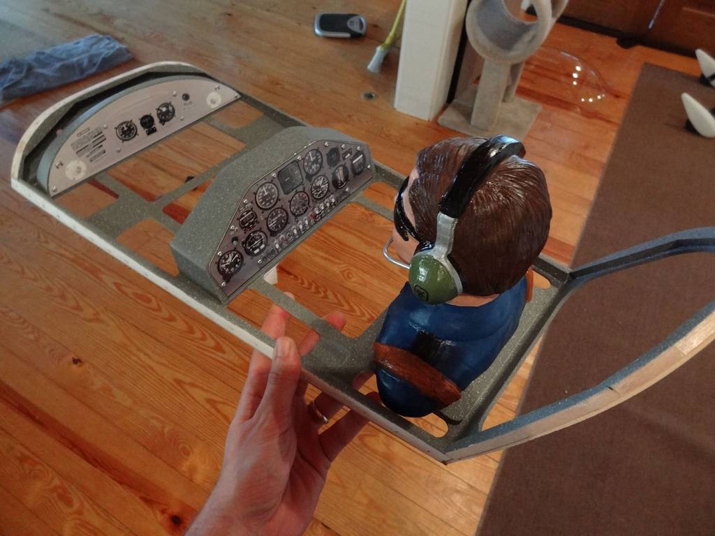

The cockpit was rustoleum gray primer, with a top coat of duplicolor gray spatter paint. The wing cutout is strong enough to bear the fuselage weight now. When we checked balance yesterday, I threw all the accessories I had on hand into their expected locations. I was able to control CG with battery placement. I'm thinking about using the nylon bolts instead of bolts through the wing tube, but I haven't decided yet. If I do that I'll need to put a tray above and forward of the wing tube for the fuel tank, and a tray about 6 inches aft of the wing tube for batteries, etc.
PS: 22.5 lbs with all the junk thrown in.
