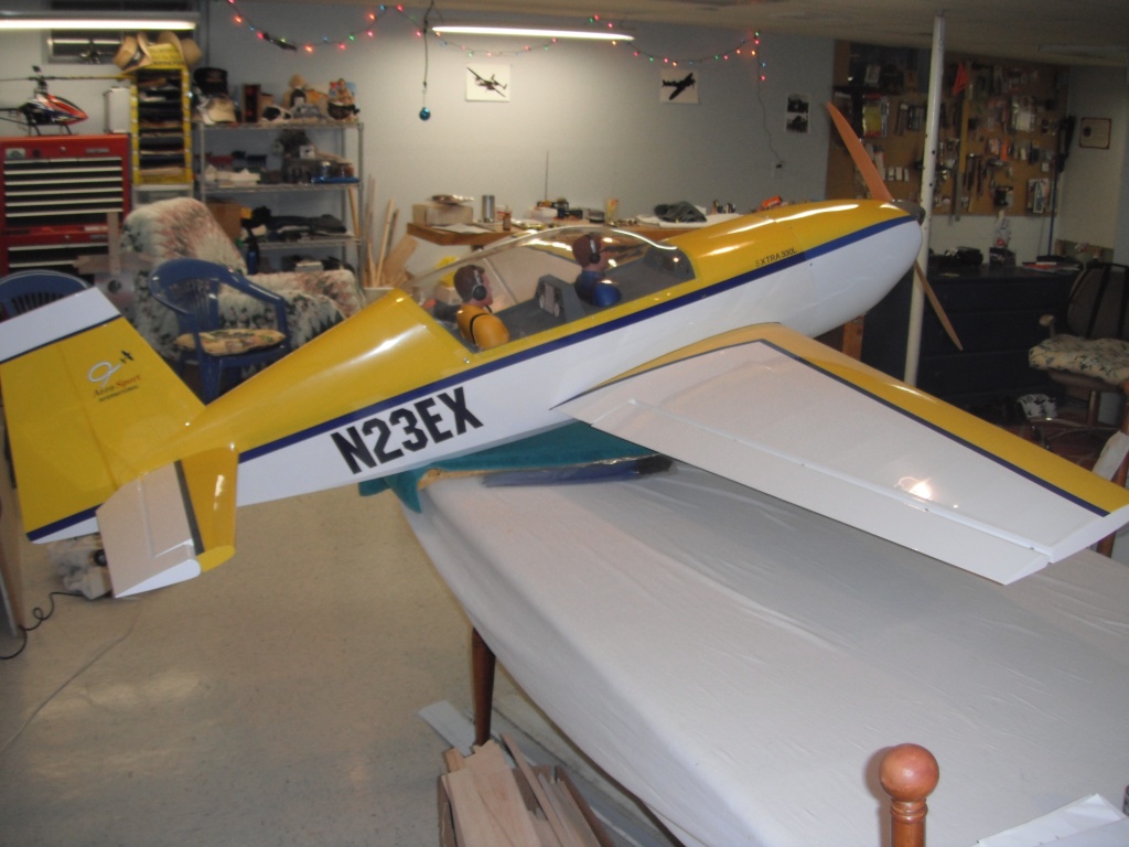

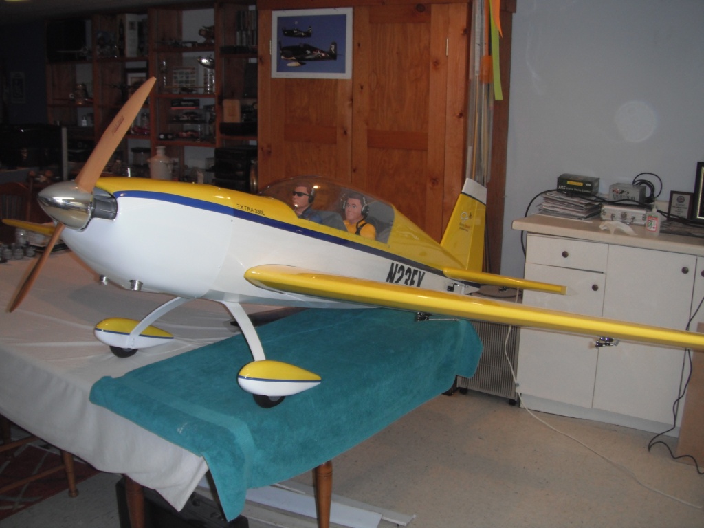

Well fella's this one is finished. Just need some decent weather now for flying which will probably be April or May before we get that.

Nice job! I hope to get my beauty shots up here soon. I meant to ask, how did you polish that spinner?

Thanks fella's. The spinner came out of the package polished, it is an MPI, they are good spinners and not nearly as costly as some of the others on the market. It will need polishing in time, typically i use Semi-Chrome to polish them.

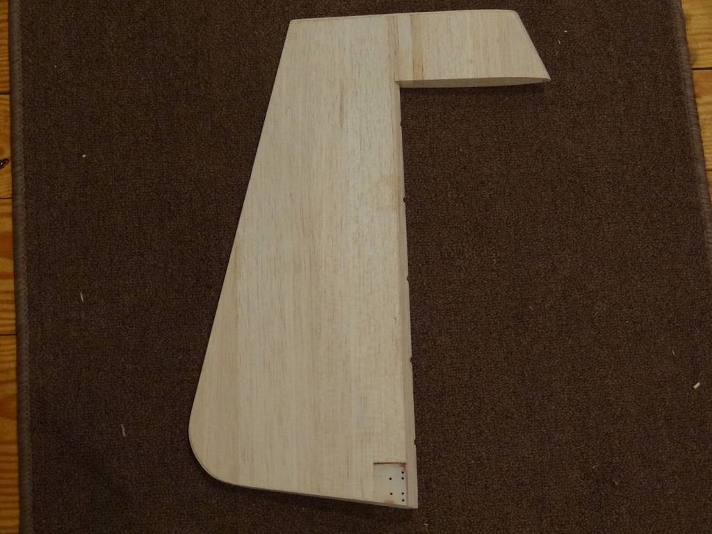

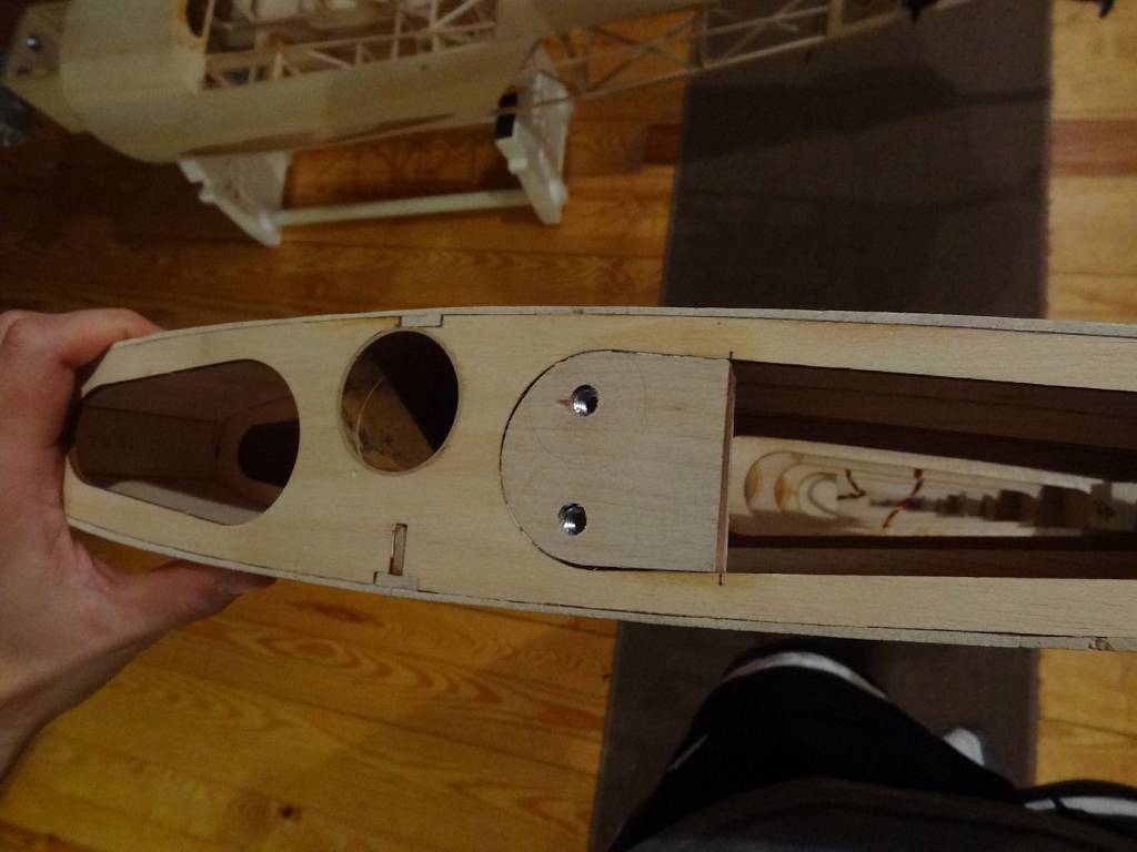

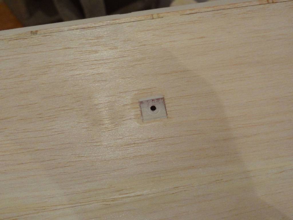

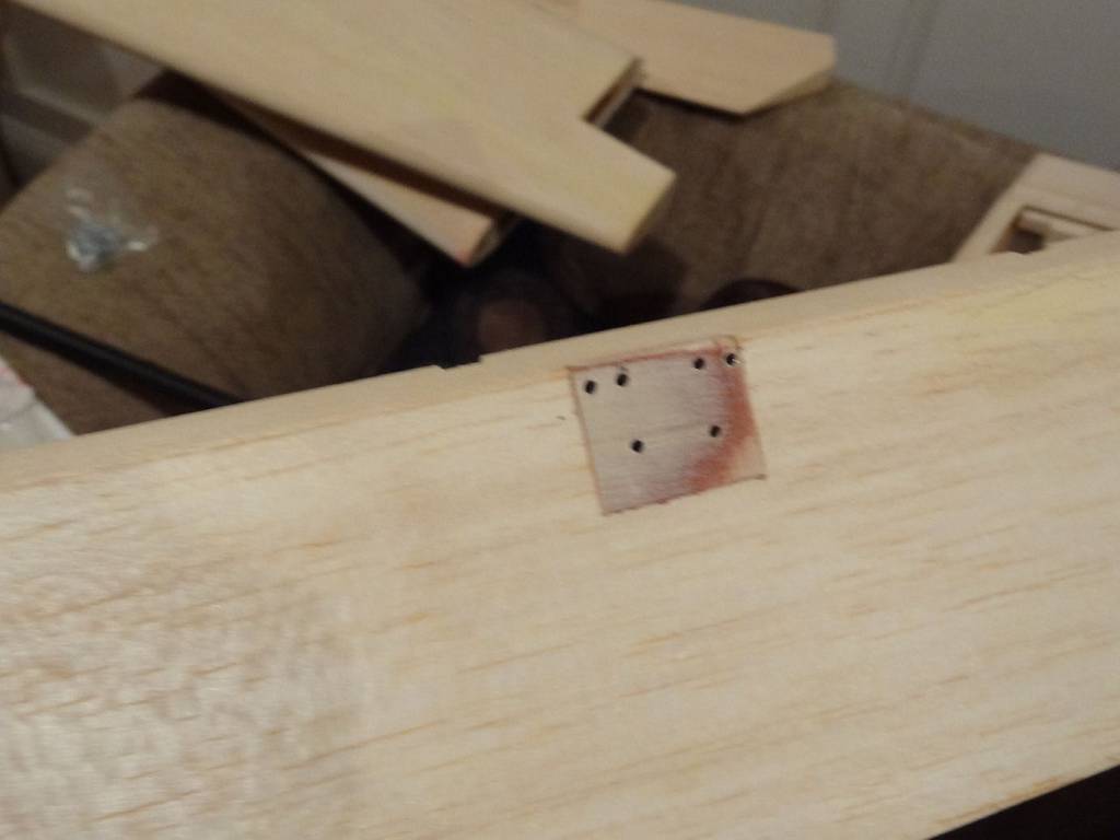

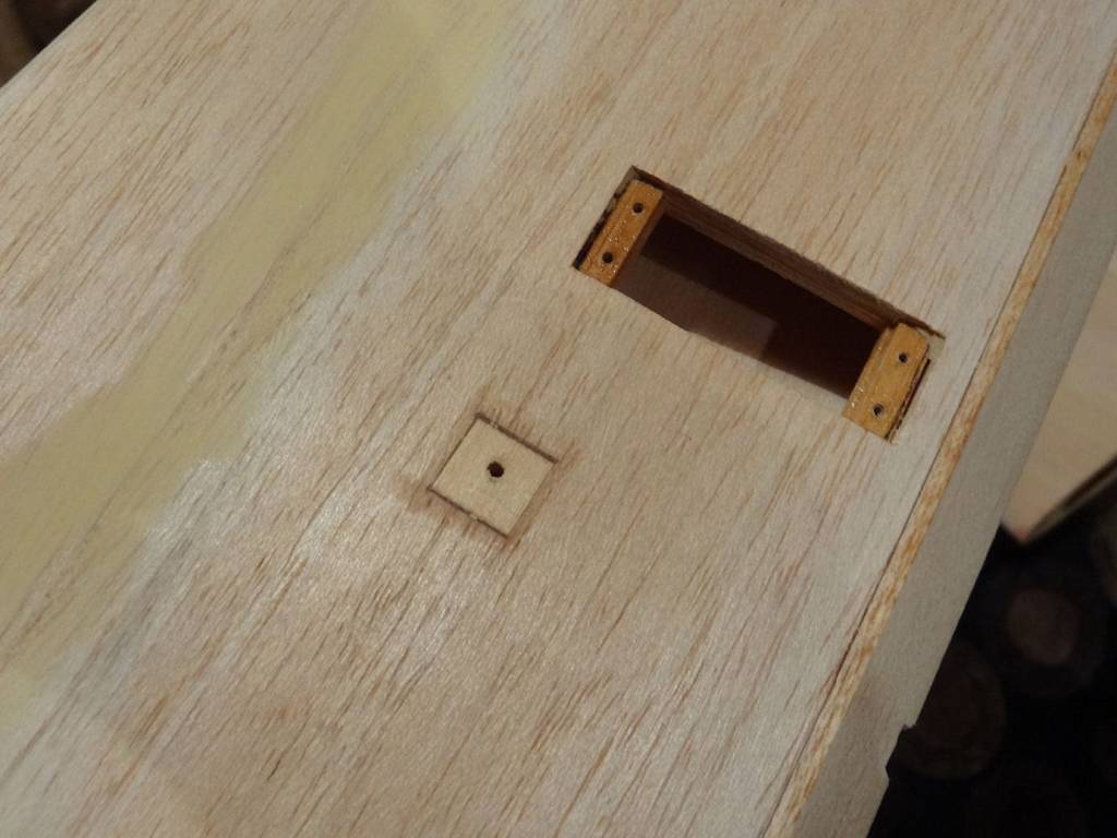

I finished the wing mounting a couple of nights ago. I was going to use 1 nylon bolt and a peg with a cotter pin in it, but after I finished the first screw hole I decided I may as well use another nylon bolt instead of the peg/cotter pin. I added ply insets for the control horns on the tail surfaces and drilled the control horn holes. I also added ply insets for the stab bolts above and below the stab. I will tap the stab holes per plans, but will use a bolt long enough for me to add a lock nut on the underside. I added two more hinges for the rudder, and bobbed the lower tip of the rudder. The canopy is glued up, but the canopy/fuse gap needs some epoxy/microballoon action. I still need to inset ply for the aileron horns, come up with a tank/electronics tray, route ignition/throttle/choke and then I will start covering and painting. Final colors will be corsair blue, deep red, and white. I think the scheme is a variation of yours. I see it on several different Extras with differing colors.
