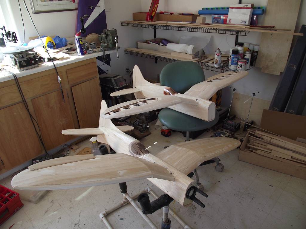

Still plugging away. Finally close to finished with the wings. Now I started the floats. Two sets of floats is really eating up the wood sheeting. I ran out of thin CA tonight so I will be working on the hardwood pieces like the fins and rudders that use epoxy.
I'm so glad to not be working on wings!!!!!!!!!!!!!!!

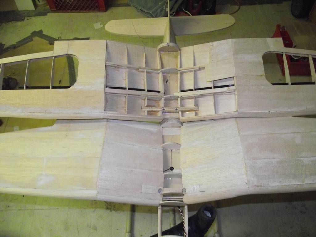

I made the center section my mod area. As drawn the wing would fall apart on my first loop. Very weak area. Later I will take some photos but RCU is a hit and miss deal for photo posting. Depends on what server number you are on and then you can mayby get two, three max, photos posted unless you remove most of the pixles? That's why I went over to RCG. I go back and forth but all they have going for them is better servers.
Anyway, until I run the wires through the wing tubes I have both the wings center sections still open.

I tossed out the stock center 1/8 braces that are about useless and maqde up my own so they are just dihedral braces that go in two bays and are epoxyed to the spars, both main and rear Then I have the front brace added too that is also drilled and counter sunk for 1/4 X 20 screws. There is another block to be added. Then the center section is sheeted and planked. Look at all the room in that fuse and I already have two servos in there. This is a good size plane with lots of hand room.

I am enjoying your build. It's great to see how you've addressed some design issues and applied your improvements to the building process. As you have pointed out the wing center is very weak as designed. Mine broke on the third flight, fortunately it held together well enough to land it. I had to cut into the wing bottom and add plywood spar doublers. Once that was done the wing would hold up well during spins.
The rudder is massively effective on this plane if you build it with the plan dihedral. The ailerons would yaw mine a little but the rudder would cause it to tuck its nose down and turn very hard.
On mine the nose was extended one inch forward of the plans. I'd read that they tend to be tail heavy as designed for a seaplane. For mine which was a land plane version I needn't have extended the nose because it ended up nose heavy.
Keep the post and pictures coming. Best regards, Lou.

Just finished one set of floats so I put them on one of the plnes to get an idea of the weight, so far it is at 4 pounds, I'm thinking about 6 pounds ready to fly for the electric powered one. Sure are a lot of floats hanging off the fuse!!!!

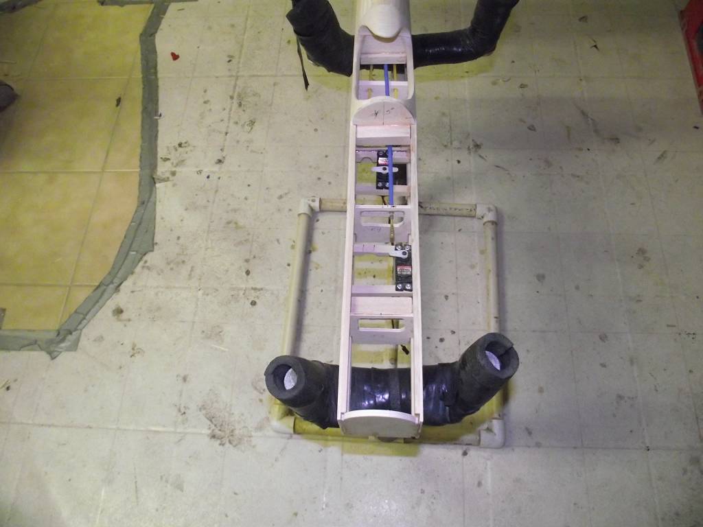

The planes are pretty much finished except for the sanding and final set up, for those that have PMed and asked what has been going on with the build, sorry for not posting any photos. You know how it goes after the planes are framed up, nothing looks like it has changed. I have had the floats on and discovered a mistake in the float wires, the length of the templates is way too long and I have to bend new wire. No big deal, I had to bend neew back wires to get the incidence of the floats corrected.
Today I took the floats over to my wood working club to sand off the fill coat, baby powder in my shop stinks and leaves a trail from the shop into the house!
They are glassed and just need to be steel wooled. About the only building part left is glassing up a pair of cowls.
Too bad these planes aren't ready to maiden. Our field, the DRY Lake bed is under about a foot or so of water at the moment.
Anyway, sorry about not posting up on this build. If RCU ever gets therre servers repaired so you can post photos I will be doing a build from MAN plans I really would like to do a build thread on, a complete how to on the Prime Cut plus 20. Can't wait to get to that build but I have to get my #1 Swoose glassed and painted before I move on to another build. Next build if the old time Saytr for a friend. I was going to do two again but I really want to get to the Prime Cut!
Gene
