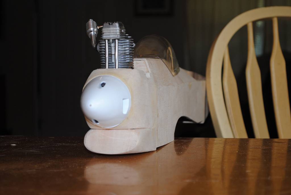

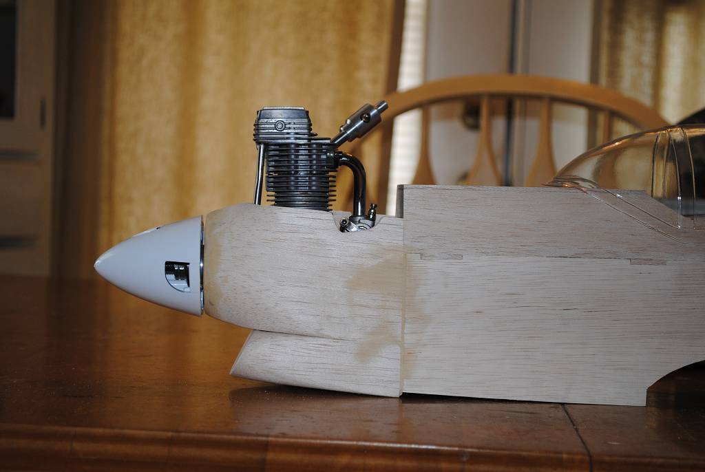

I have made some good progress on the fuse.
The cowl has been shaped and sanded. Next up is to work on the wing mounting. If all goes well I should be starting to cover the plane this evening.
Later!!
Anthony

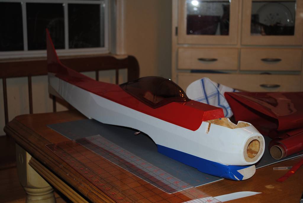

Covering has been started.
It has been years since I have used Monokote. The fuse will be the hardest thing to cover so I figured I would get it out of the way. So far it is turning out pretty good. Going to call it a night and get back on it tomorrow.
Later!!
Anthony

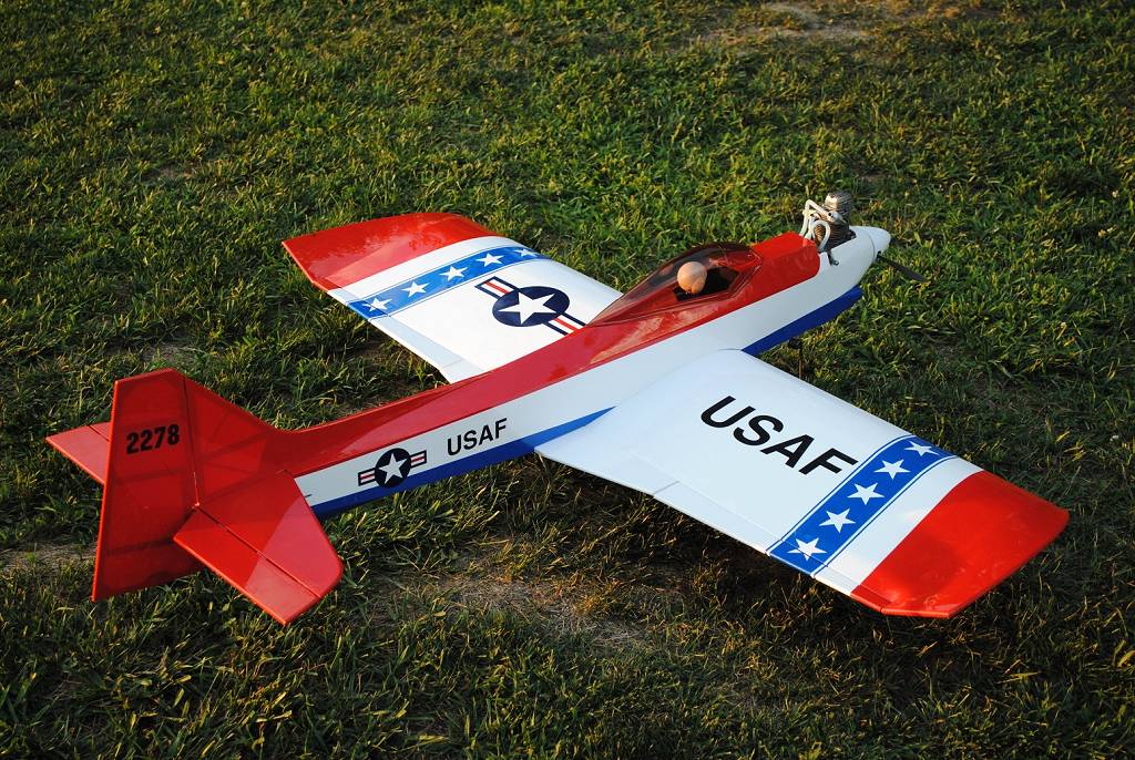

Joined: Sep 2006
Posts: 8,131
Received 5 Likes on 5 Posts
From: The Sunshine state, when it's not raining!
Default RE: Top-Flite Contender
Just came across this thread. Really Anthony, 10 days. If you build any faster everyone would miss everything. LOL
Look's great. I bet it's going to be a rocket.
Old 08-05-2012 | 03:18 PM
  #41
WacoNut's Avatar
Joined: Jan 2005
Posts: 6,604
Received 36 Likes on 33 Posts
From: Blanchester, OH
I am slipping a bit, it should be flight ready right now
I have always liked the looks of the Contender and wanted one. I think this will be a great plane to have in the hangar for Fun-Fly events at the club.
Later!!
Anthony
Old 08-05-2012 | 03:19 PM
  #42
RICKSTUBBZ's Avatar
Joined: Oct 2007
Posts: 1,700
Received 41 Likes on 36 Posts
From: Hempstead, TX
ORIGINAL: WacoNut
Hi Rick,
I will be having some fun with this one. I had to mow grass when I got home from work today so it is slowing me down a bit.
It has been years since I have covered a plane with Monokote and I am going to need some pointers. I will be doing a Red,White and Blue pattern with overlapping colors. What is the best way to seal the edges of the monokote? I will be applying some of the trim parts with windex and little heat. Is monokote trim solvent best or acetone?
Later!!
Anthony
Anthony,
You have outdone yourself once again......I fell a sleep for six days and you have about finished the thing.
I have not tried the acetone yet for applying trim. I have successfully used monokote trim solvent for doing narrow strips of monokote to form trim around the windows of a Decathlon. It even worked around the windshield. But I had to cut the pieces curve to fit - obviously since I was not using heat to stretch and shrink. I have had some success using the Windex trick for larger trim pieces. But heat is still need to keep the stuff on. even with the Windex to squeegee out the air I still ended up with those pesky little bubbles that needed poked with a pin.
Anyway...your plane is looking as good as I figured it would. Looks like you got the covering stretched around the lower nose well.
Old 08-05-2012 | 03:39 PM
  #43
WacoNut's Avatar
Joined: Jan 2005
Posts: 6,604
Hi Rick,
I am using Windex to put the stars down and I will test acetone tomorrow for sealing.
It took alot of heat and stretching to get the nose and the wing tips covered.
Later!!
Anthony
Old 08-05-2012 | 04:13 PM
  #44
WacoNut's Avatar
Joined: Jan 2005
Posts: 6,604

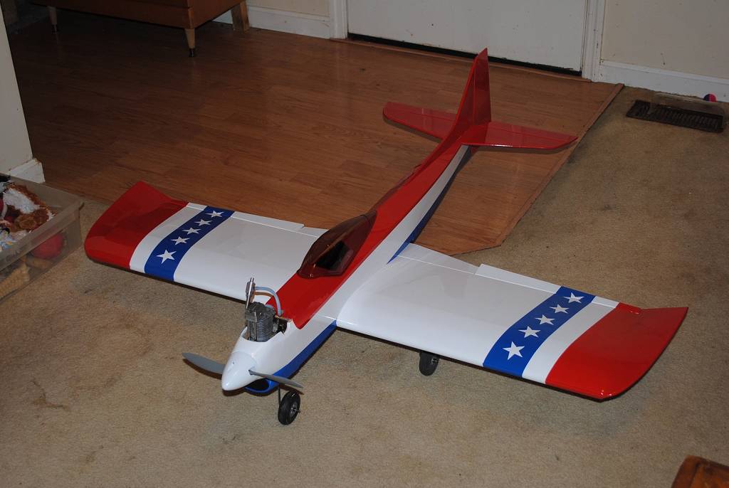

I think I am done with the covering.
I do need to cut out the slots for the landing gear wires and seal them down. I am happy with how the covering job turned out. I will go over the stars and some of the trim pieces tomorrow with acetone and heat if necessary.
I think the stars add a nice touch.
Anthony

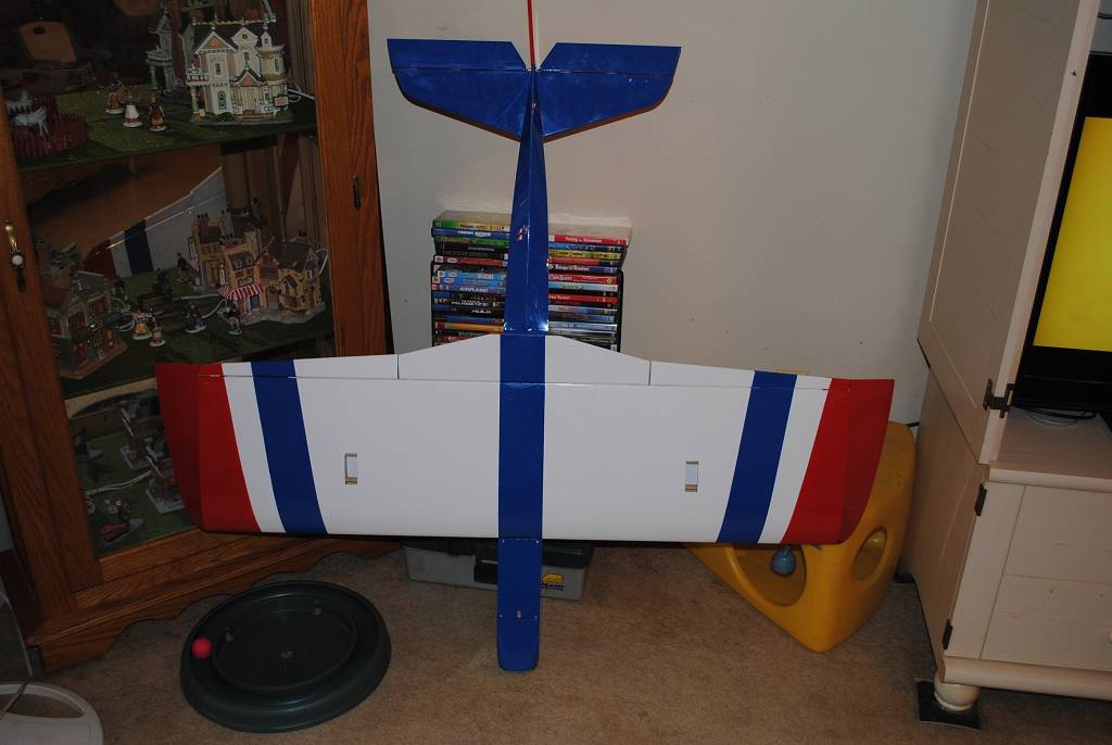

I have all the servo's installed in the plane and the fuel tank is installed and plumbed.
I am still waiting on the missing inner control rod, I called them today and they said it shipped yesterday so hopefully tomorrow it will arrive.
The landing gear has been mounted and the plane is now sitting up on it's legs. I also painted the cockpit and I am in the process of painting the pilot. I will finish up the painting tomorrow and glue the pilot in place and glue the canopy in place.
Should be on pace for putting the maiden flight in this weekend.
Anthony

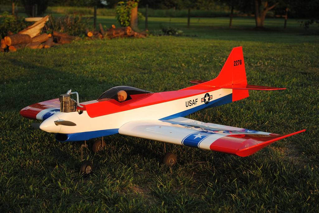

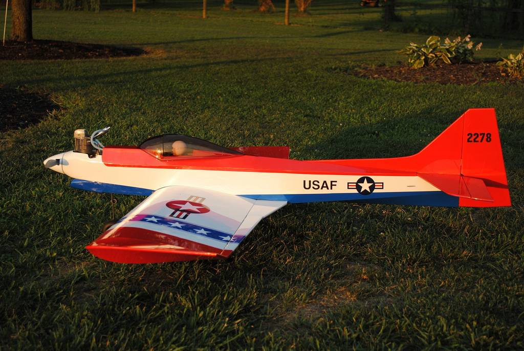

The control rod did not arrive so I worked on adding some decals to the plane. My wife said the white areas were too plain. I also added a 1/8" pinstripe to the blue bands on the wings.
I have to say I have enjoyed building and finishing this kit. I am usually a scale plane builder and flyer but I will be proud to show up at the field with this plane.
Anthony
