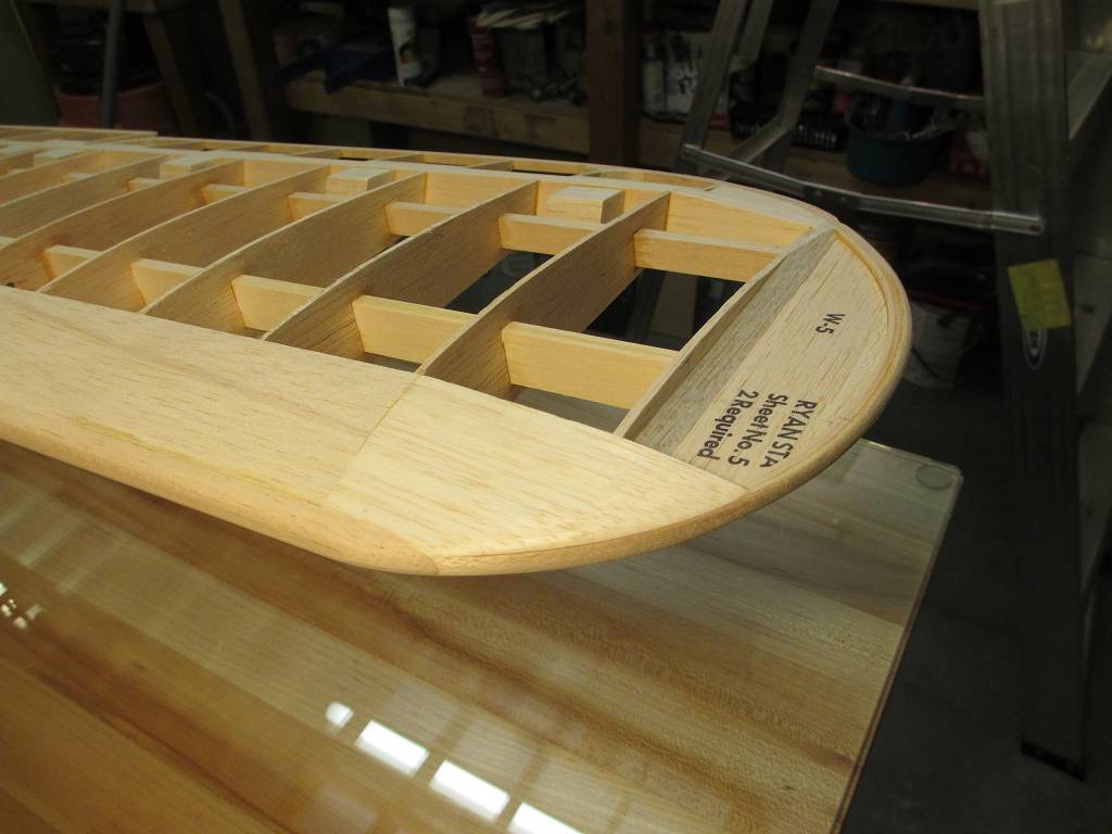

I hope that everyone got through that storm safe and sound. The wind was relentless as well as the rain! I went out early this AM to cut up and cart off to the dump downed trees on my property.
I was very busy working on my plane today as you can see. I finally got all the sheeting done on the wing as well as completing the wing tips. There is still plenty of sanding to do to get everything to fit just right... I had to stop and clean off the work bench because is was getting out of hand.After it was clean I thought it proper to have a little photo shoot. Of course I couldn't resist the temptation to place the wingand cowl on the fuselage! I was very happy to see the fit of the wing in the saddle with absolutly no sanding done yet, </p>

Oops! I see a crooked piece of sheeting. Gonna have to start over there. I do have a question. Would you be willing to ship a copy of those plan's?

Uh-oh, I saw a slighty mismatched rib toward the root, the leading edge just ain't gonna cut it!  SORRY!  Robert did it so I had to as well.  I mean, what do you expect ya know.
Really, that looks so beautiful!  Great job and, like so many others have said, it's a shame to cover it!

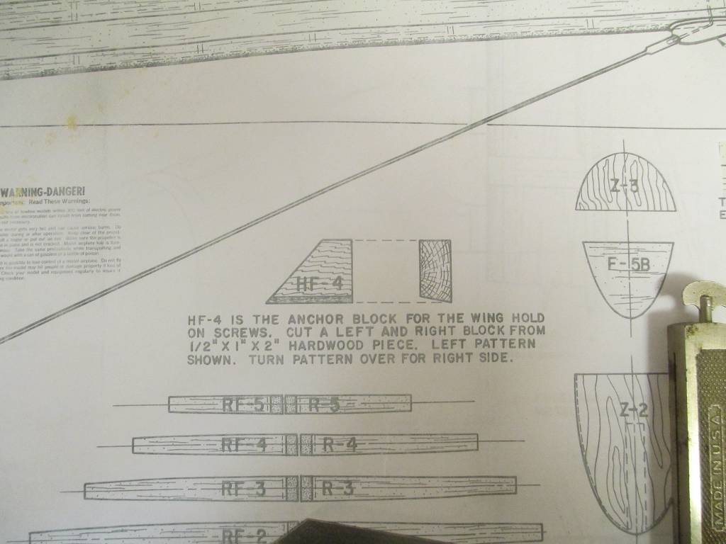

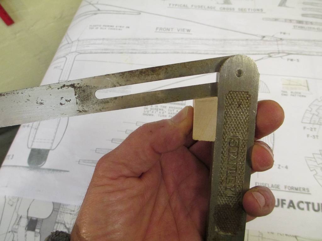

Time to get the wing mounted to the fuselage. This means some carefull measuring, after all the time and effort one puts into buildingtheir plane you have to make every effort to ensure that the wing is aligned properly or you won't be happy with how it flies. This means making sure the wing is centered on the fuse andtheangle ofincidence checked and or adjusted. So first on the agenda is to install the wing anchor blocks (HF-4). These blocks are not square so you can see how I duplicated the angle from the plans. I measured from the plans the exact locations of these blocks, you can see the pencil marks.
On a side note, I'm sure you all have steel rulers similar to what's in the photo. Have you ever placed your ruler on the side of something and reached for your pencil only to have the ruler slide off of where you placed it? It's happened to me several times but not anymore! What I did was to take some of the sandpaper that has sticky back and placed it on the side of the ruler that I don't use. The friction that the sandpaper gives you stops the ruler from sliding around. It also can be used as a sanding block!

Really spectacular! Everything looks like it is going together perfectly. You're making me want one!
I like the sandpaper on the back of the ruler idea. I have one backed with a super thin layer of cork. Not sure where I got it but the cork really helps it stay in place.

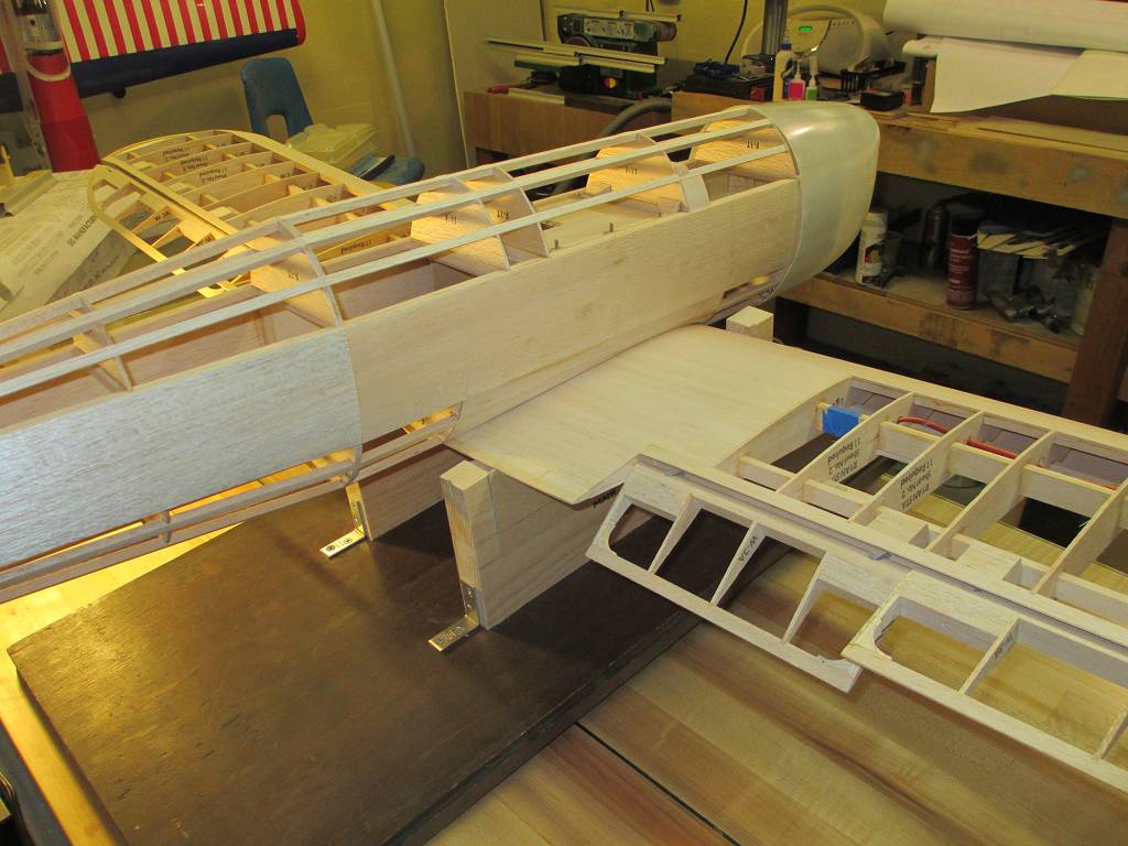

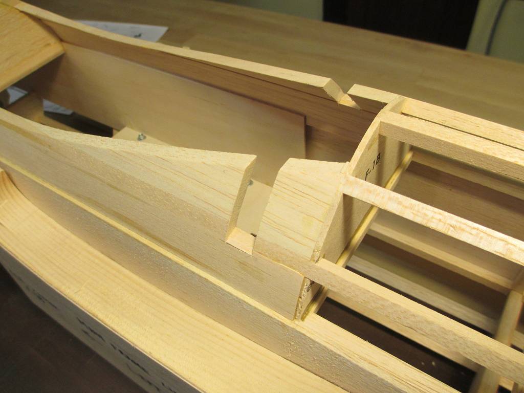

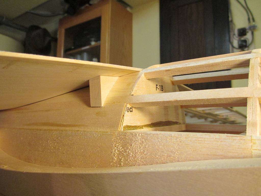

Aftercarefully marking the exact positions of the wing anchorblocks I had to trust my measurements and slice into the fuse. It was a bitnerve racking to do it... It has a lot of angles that you have to deal with all at the same time. One side is done and the other side is 3/4 of theway there. Doesn't seem like I accomplished much tonight butI am happy with the results of the little that did get accomplished.The blocks will get trimmed down after the sheeting is done. In fact I am not following the directions as they tell you to glue the blocks first,then sheet the fuse. I am choosing to do it the other way around.
PS- yel914, You may be interested to know that I fired the night cleaning staff and we'll get those can labels straightened out. LOL
