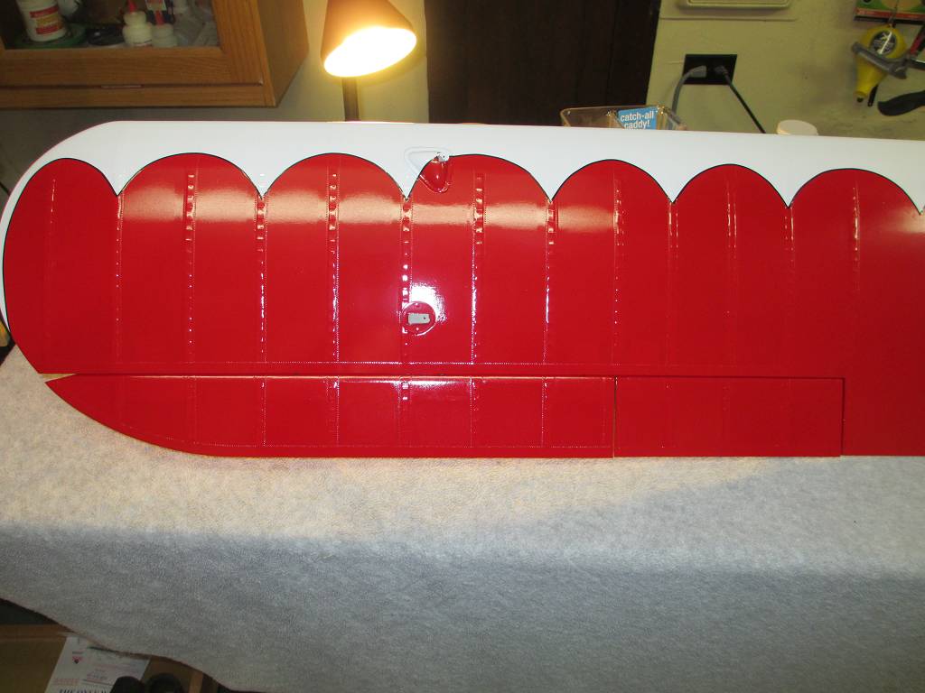

Glad to hear it Handyman 220 and it will be every bit as good I'm sure!
Got all of the pinstriping on the wing done. I used 3M 1/16" tape for the job, one roll was enough to complete the top and bottom of the wing... Next I will epoxy the aileron and flaps onto the wing (you don't know how long I've waited for this) .

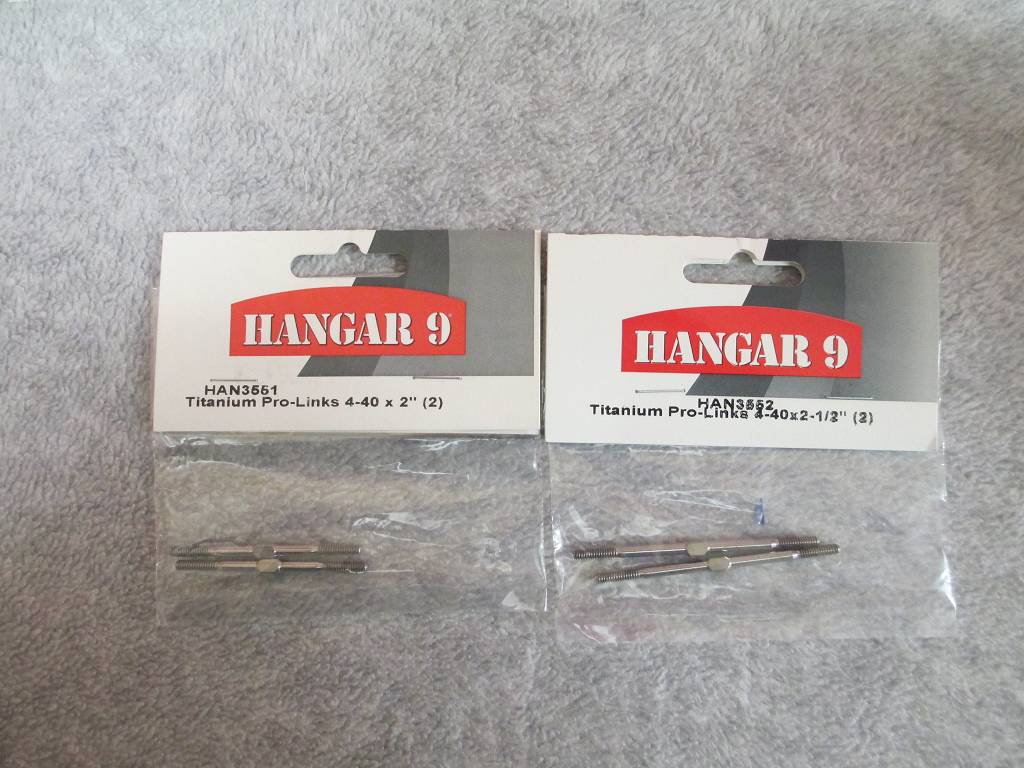

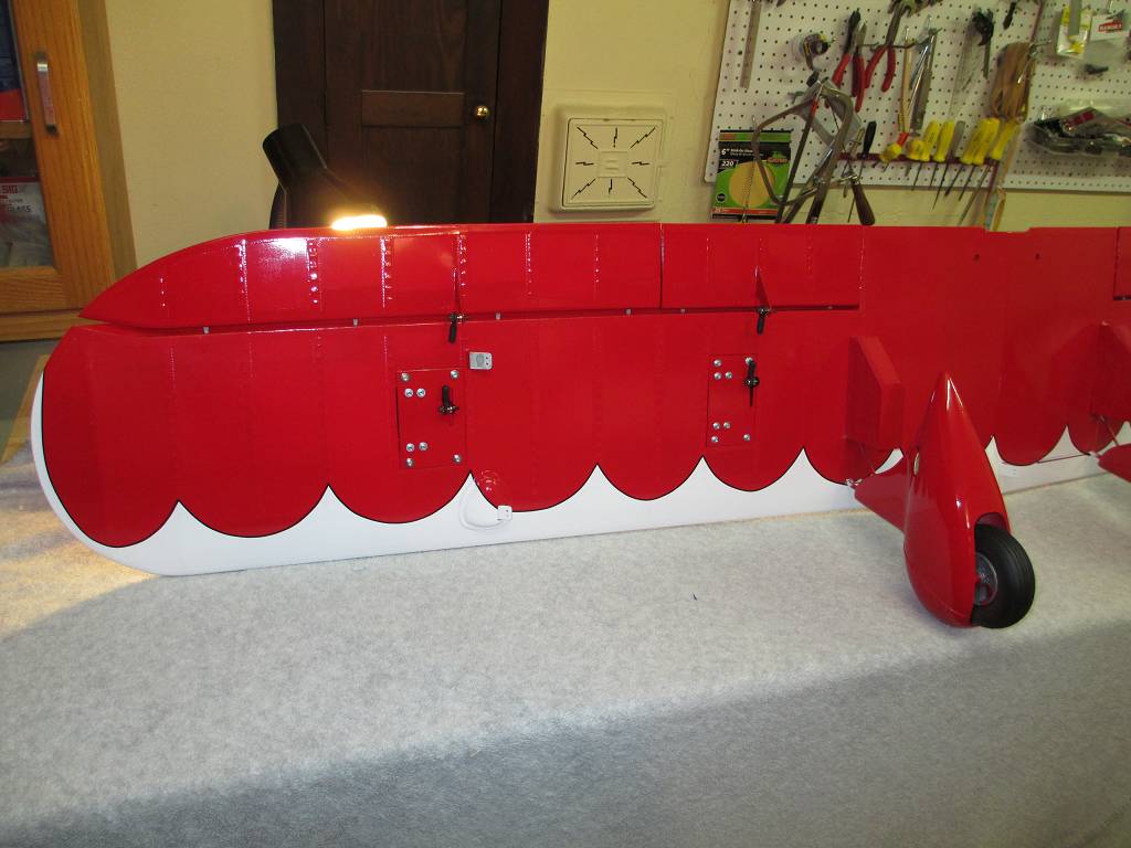

Thanks David, I will take a short break and enjoy our short flying season, but I bet I'll get bored at night and start the Spacewalker sooner than later...After all, I'll miss the opportunity to communicate with you all.
Here are some photos of the aileron and flaps attatched to the wing permanently. After installing Dubro 4-40 heavy duty ball links on the servo arms and control horns I measured the distance between thinking that I was have to make some custom rods, but I got lucky and will be able to use the Hangar 9 Titanium Pro Links instead. In photo #5 you can see how the aileron and flap wires exit the center top wing. To eliminate the possibility of the wires abrading against the wood and causing possible problems, I like to use rubber grommets that solve this problem and make it look cool as well...

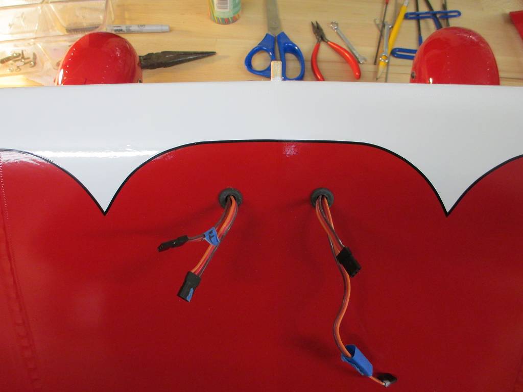

I'll take one ofSTA and SCpleasegreat minds think alike, I did the same thing with my servo wires as I got tired of the holes in the balsa wearing and breaking out. I got to do some flying Sun and practice my cross wind, in the opposite pattern, coming in over the trees landings I bet you have to wear a bib now just to keep the drool off your shirt your almost ready to give birth
