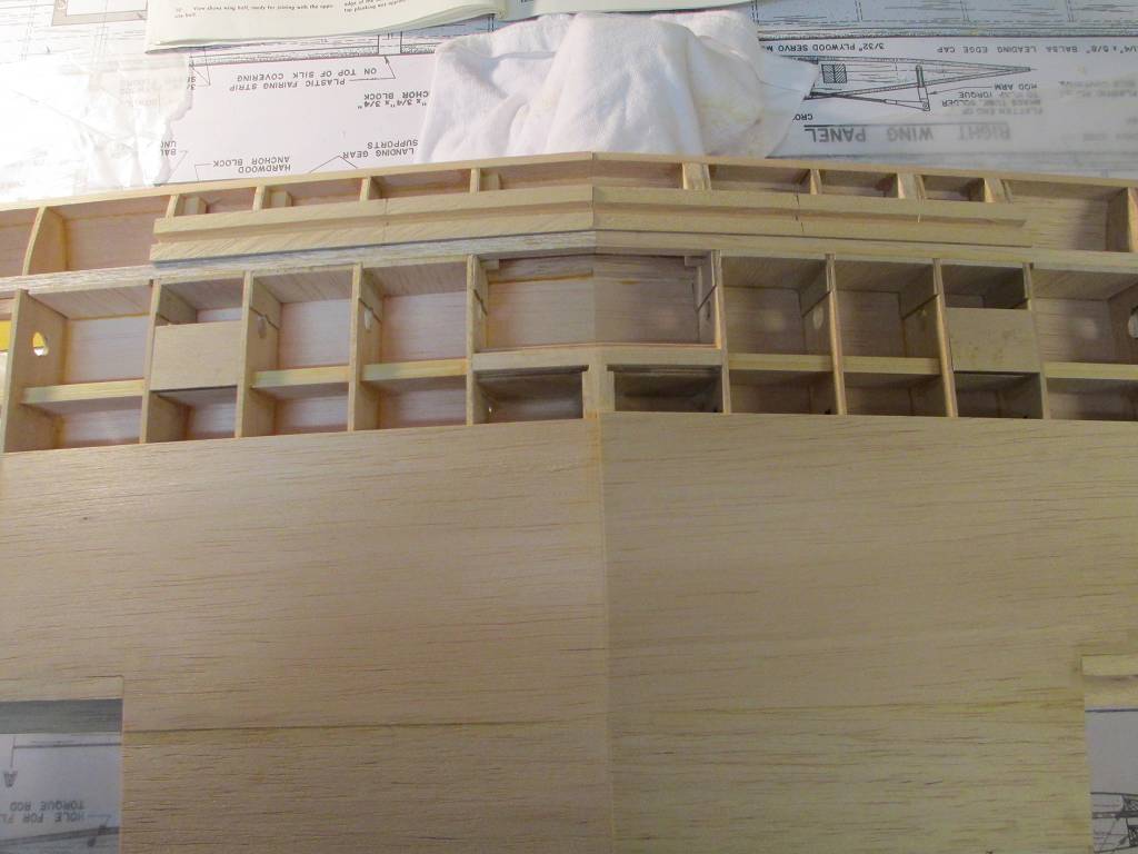

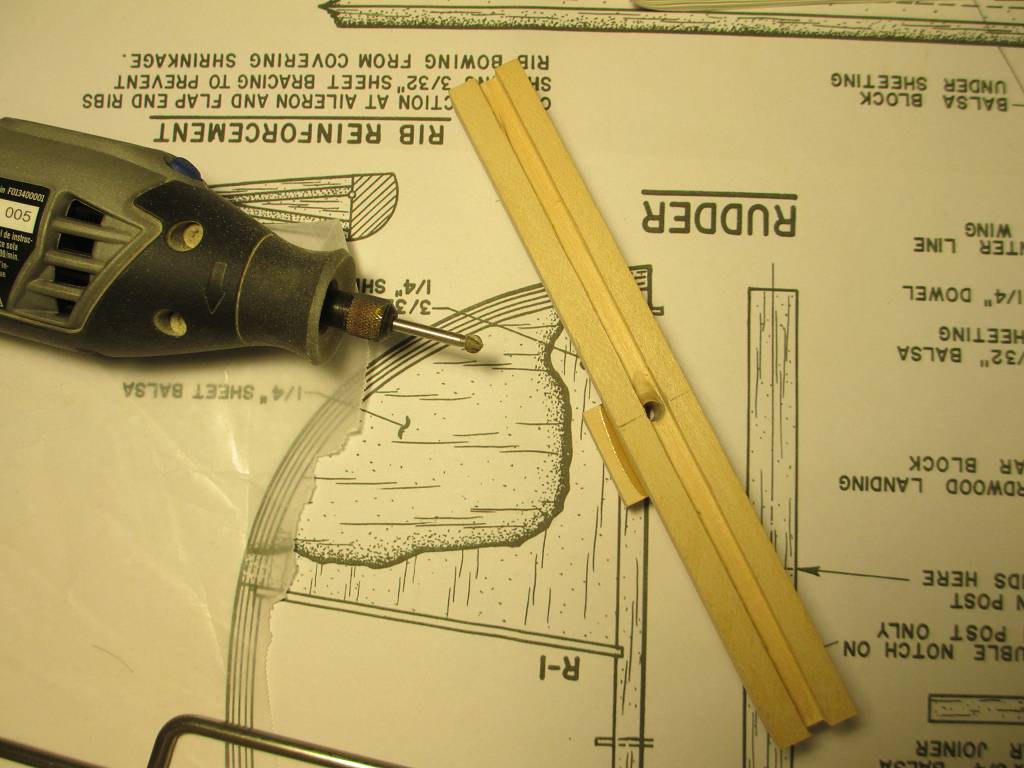

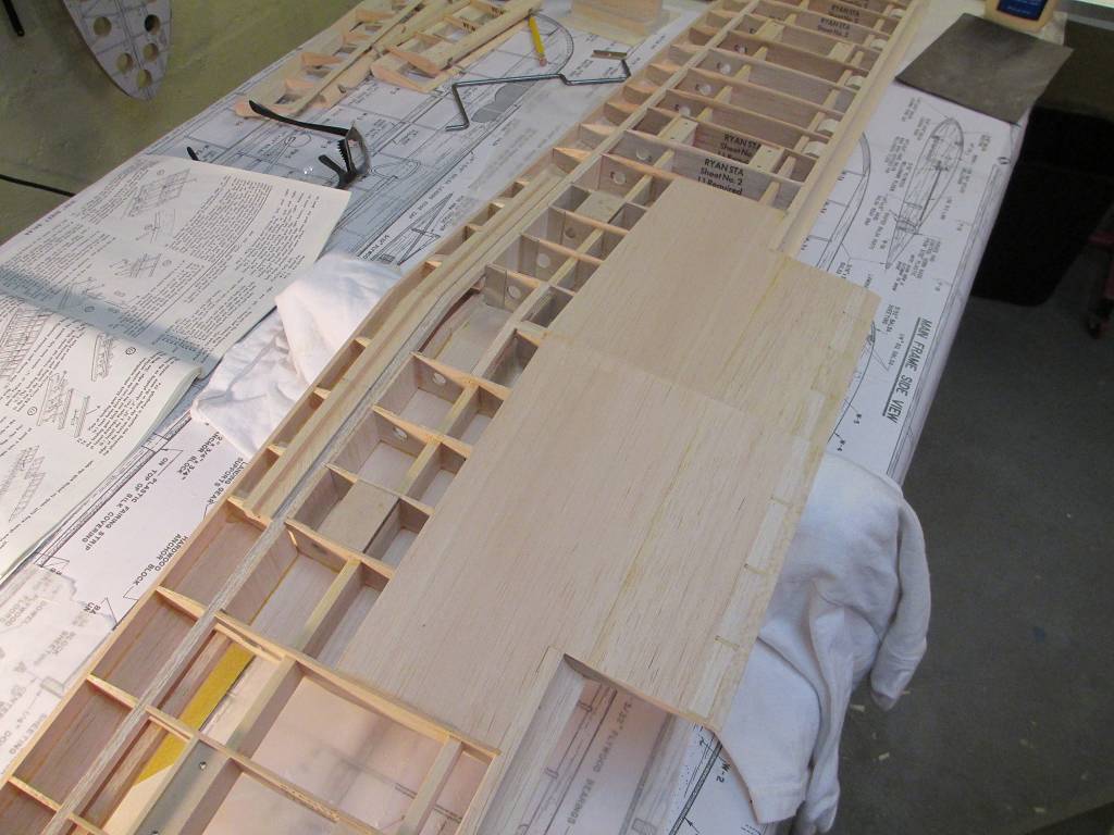

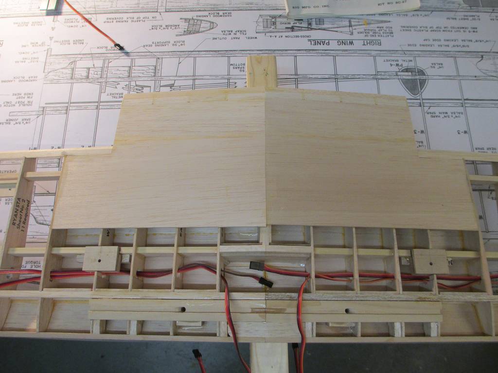

Concentrated tonight on the center wing section. You can see how I added support to the centerwhere the wing halves meet, this is for the sheeting to have something to be gluedto. Fitted the landing gear mounts, they are now ready to be epoxied in place. I also decided at the last moment to add an additional hardwood block that will anchor an additiional steel brace that will help prevent the landing gear wire frommoving back(Theseare not yet visable).</p>

Old 10-23-2012 | 05:38 PM

With such clean and crisp work it almost seem's wrong to cover it.
Keep up the good work.

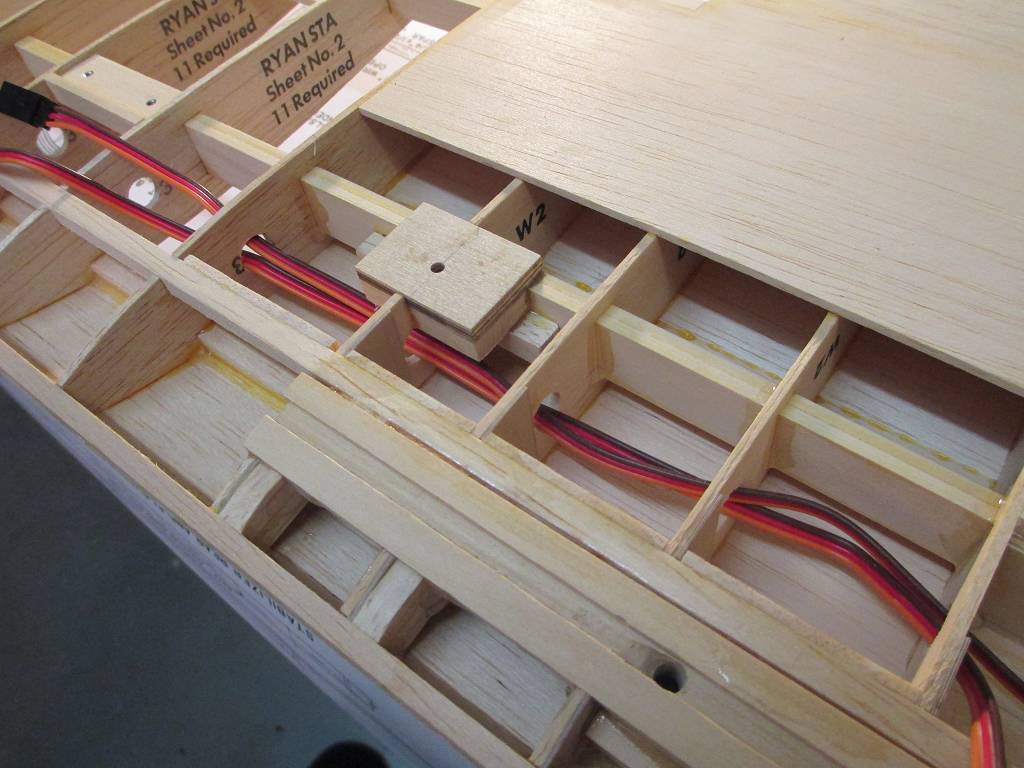

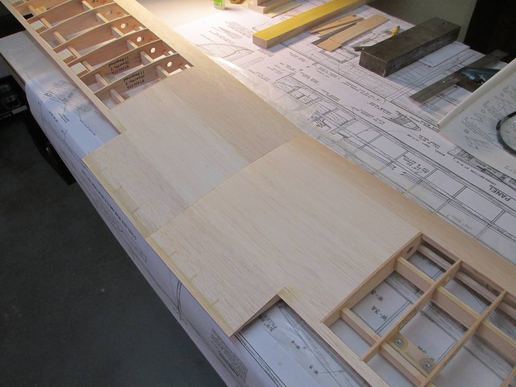

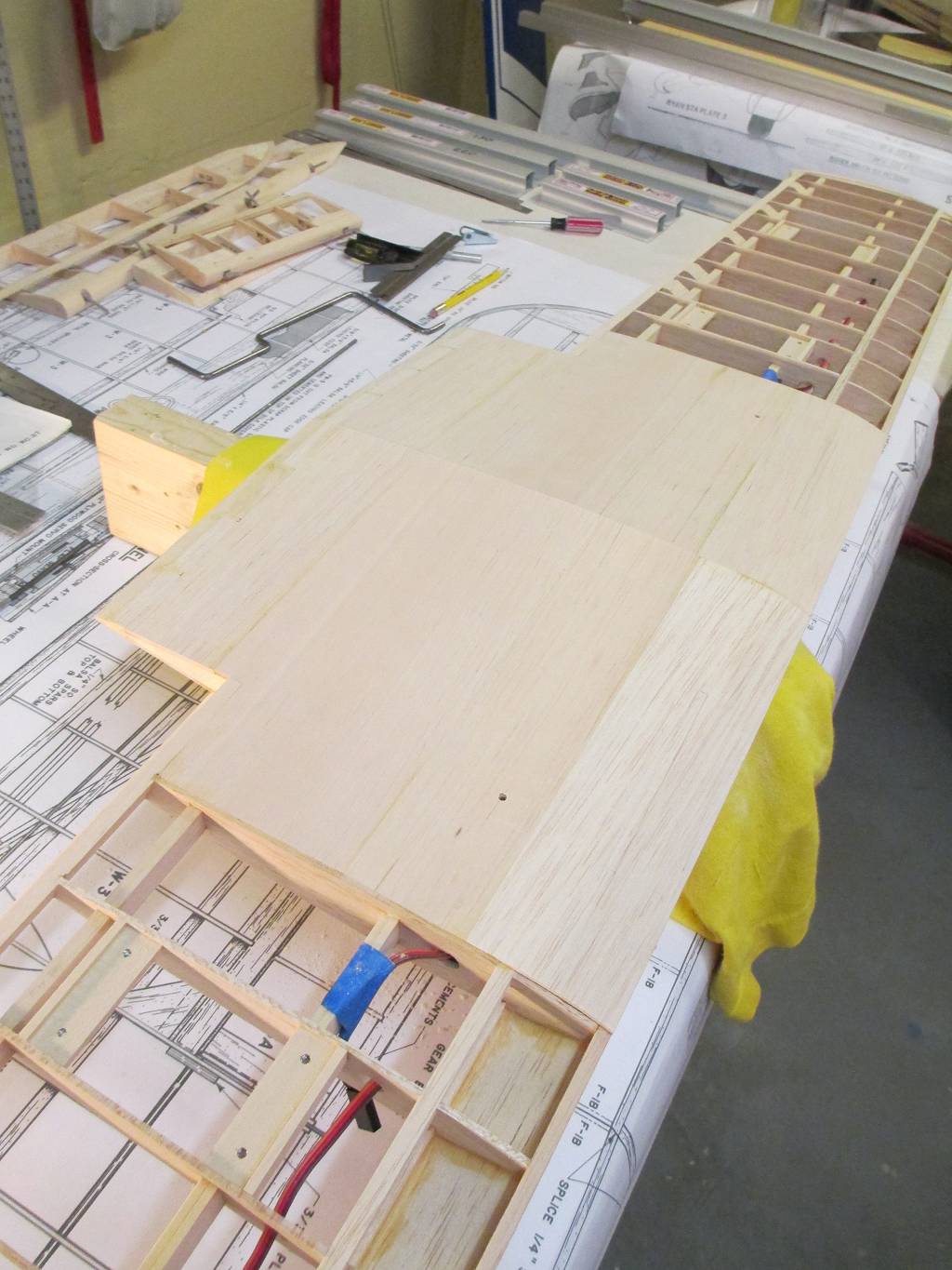

Sheeting for me goes painfully slow so you will have to bear with me. I was only able to fit two pieces in tonight. You can also see the blocking that will support the landing gear wire. The blocks are not epoxied in as of yet, in fact each block will be moved inwards slightly, centered on theadjacent rib. If I do this right the additional wire bracing will all be hidden under the gear fairings.
On another note, work is taking me on a two day training seminar soI won't be posting anthing tomorrow night... sorry guys. On the way home I will be stopping by the LHS to pick-up some supplies I need to complete the wing. Can't post pics- 500 server error message again!
I tried posting the pics again this mornimg and I'm still getting the Error message. Anyone else having problems? Need to leave for my training seminar so I'll try when I return on Friday...

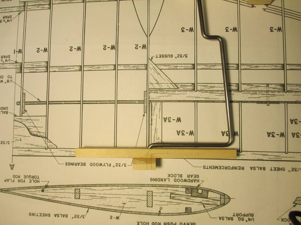

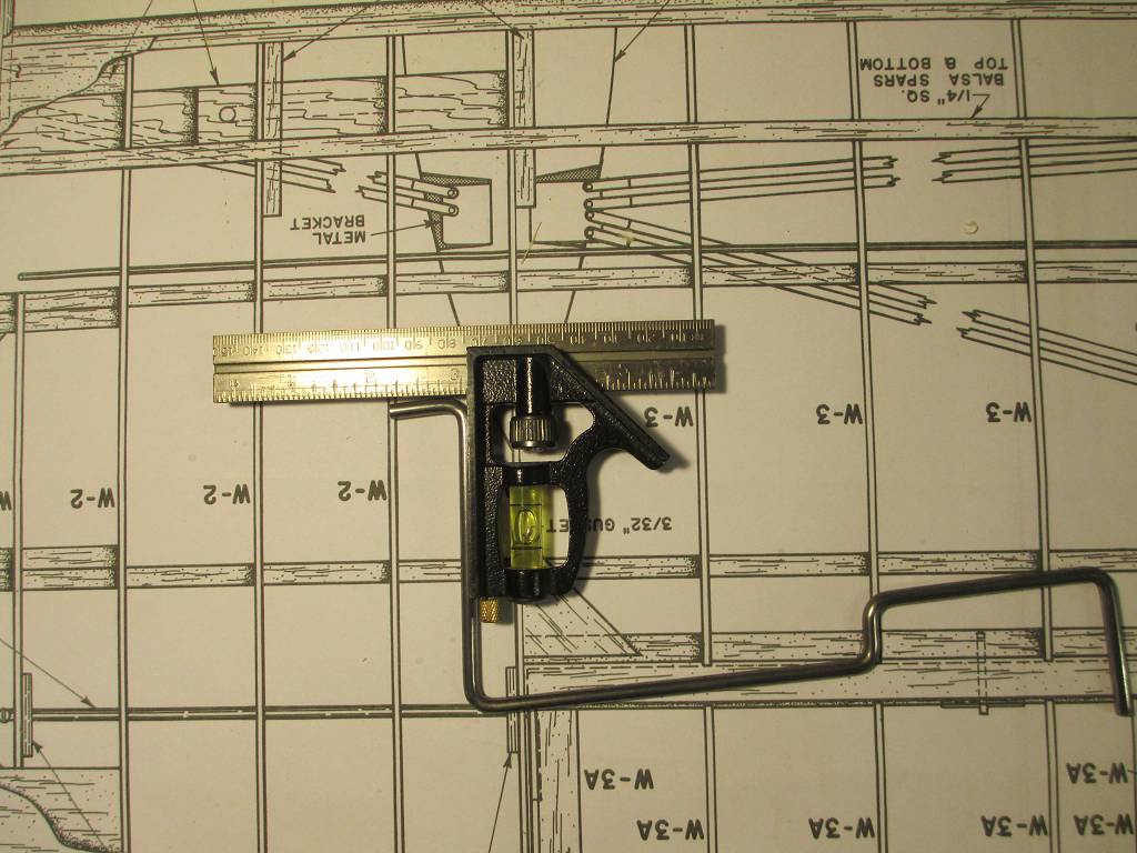

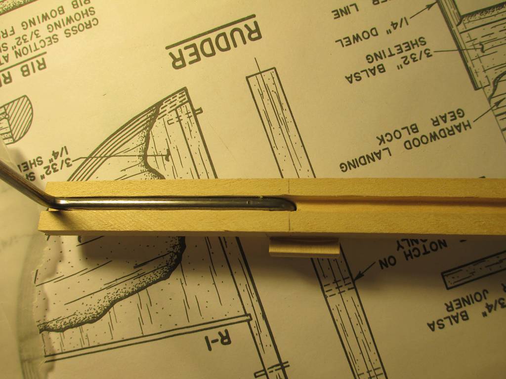

Well I'm home! Got right to work on getting the landing gear mounts sorted out. I thought it would be better to drill the holes for the 3/16" landing gear wire first. Upon close inspection I noticed that the end of the wire is not at a 90 degree angle, so I replicated the angle by hand so it could be inserted without any binding. If done right as the wire is inserted into its hole the space between the wire and the mounting block should stay equal. In order for the wire to fully seat I used my Dremel tool with the bit shown to ease the inside edge. Worked well...Once I was satisfied with the fit of everything I epoxied everything into place.

Curious VJ, could you not have straightened that out in the vice? Doesn't seem like it would've taken much.
Looking good by the way! Good craftsmanship!

I could have David, but to be honest it didn't cross my mind!</p>

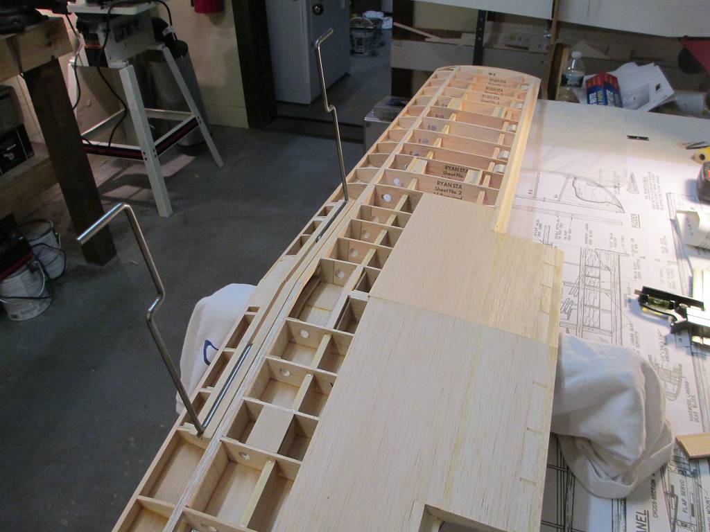

With the storm setting her sites on the east coast we are all busygetting ready forthe possibility of no power- gasp- nointernet-NOPOSTS AHHHHHH.

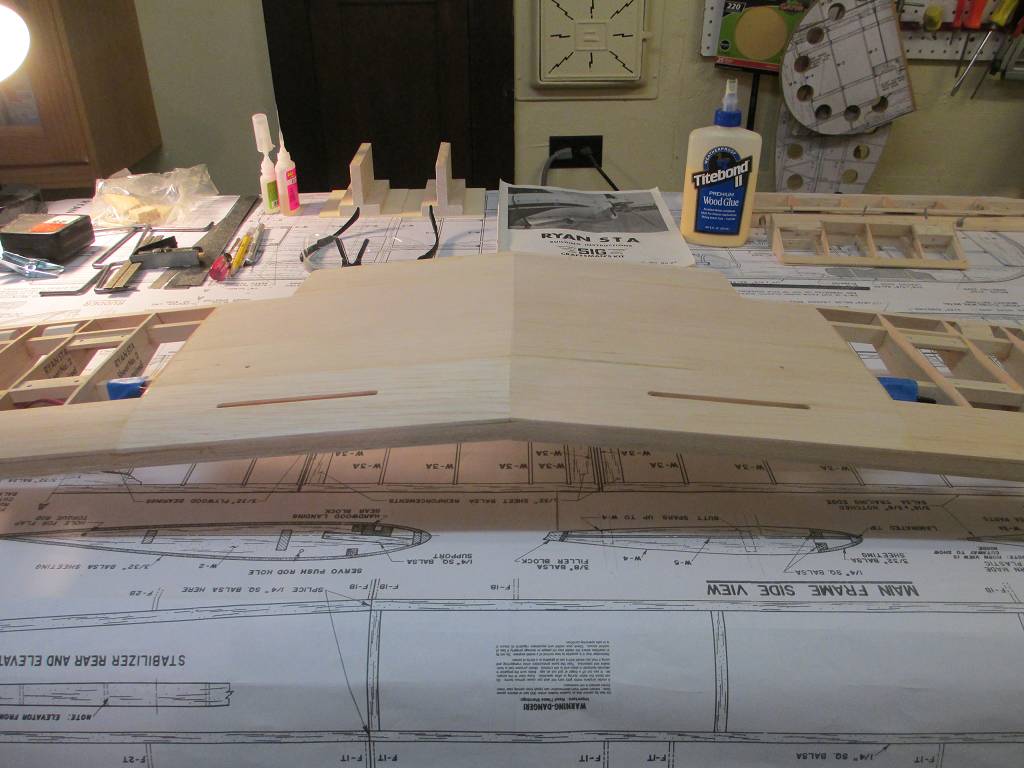

Managed to get the restof the center section sheeted. This may be an "oldschool " type wing, but it sure is strong! Glad to be finishing up the wing and to move onto something else.

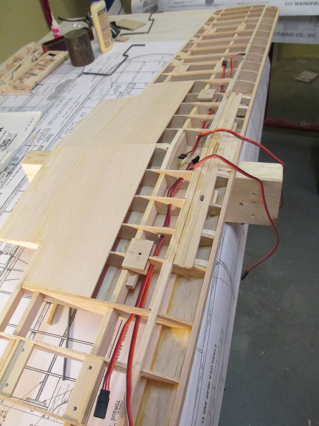

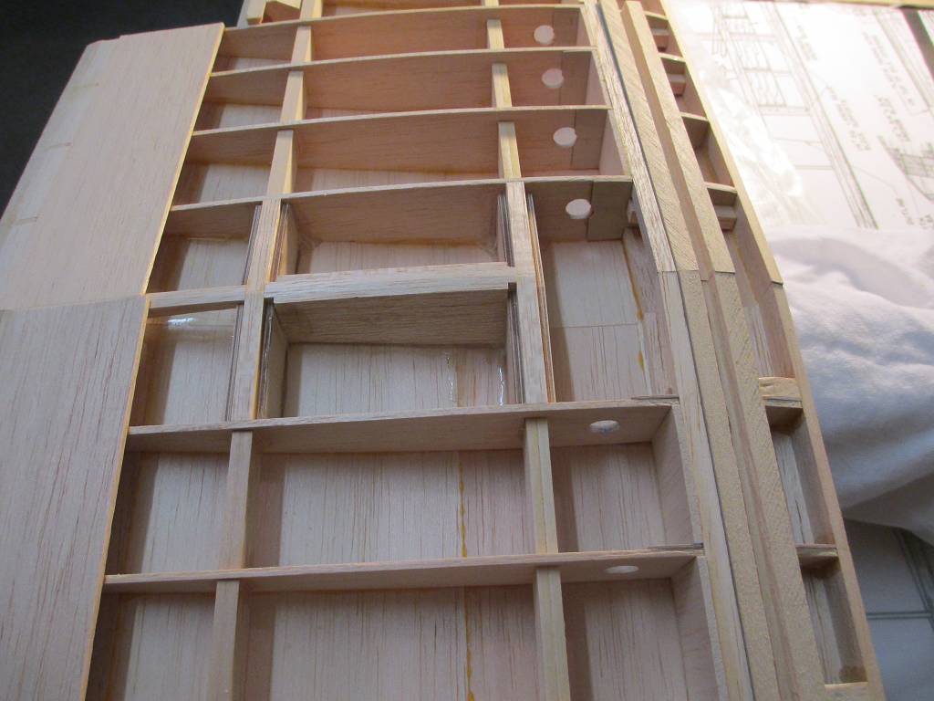

Most of the wing has been sheeted. I finished opening up all the holes/slots for the landing gear and bracing. Next I will glue on the leading edge and get that shaped this morning. Still have some sheeting to do on the wing tips, but it's near done. I am happy to report that the wing is straight and true...
Here's wishing all involved that you may be safe during this storm and not lose power.
