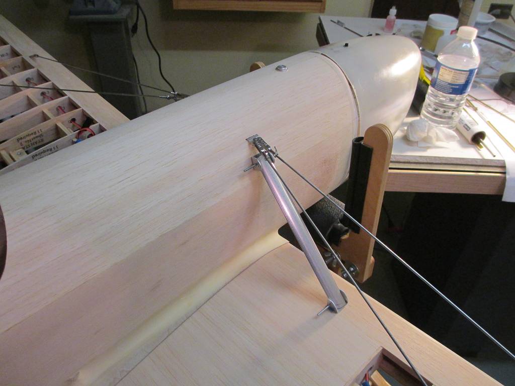

I could benefit from some feedback on the mock-up struts that I made. It's not too late for me to scrap the idea and move on. The hinge pins will be replaced with 2-56 x 1" bolts, the pins are just for alignment purposes,also the top and bottom of the strut will be filled and rounded off giving a much cleaner appearance. My intent here was to make a strut that would fold against the fuse by removing the bottom bolt. Is it or (just like the Romans did). Your input is much appriciated...

Close enough in my book. But I will also ask, could you make the mount go inside the tube rather than outside.

Wouldn't want to make things easy on ye I am with Robert on this one. Since the struts are not functional how about making a socket at the fuse end for the strut to slide into and a internal fitting at the wing end for the strut to slide over. When you remove the wing the struts will just slide out for transport and storage. With all the other mods I have seen you pull off this shouldn't be too much of a stretch.
Have fun with it

Wellllll since you asked... I'm not keen on the brackets too much they seem to take away from the the nice work you did on the wires. The ones on my arf are made out of wood and then cut on angles on each end and then simply screwed in to blocks iin the wing and fuselage. They go on and off pretty quickly. I even cheated and attached my fake wires (which are silver elastic) to the top screw on the strut. I guess I vote But on the upside Ilike the alum struts and I want to update mine with those when I rehab her.

I'll try to get a good picture of the struts on the Byron. They attach at the top with screws, and at the wing they use a Robart hinge that allows the strut to fold against the wing. It is a great idea and works very well.

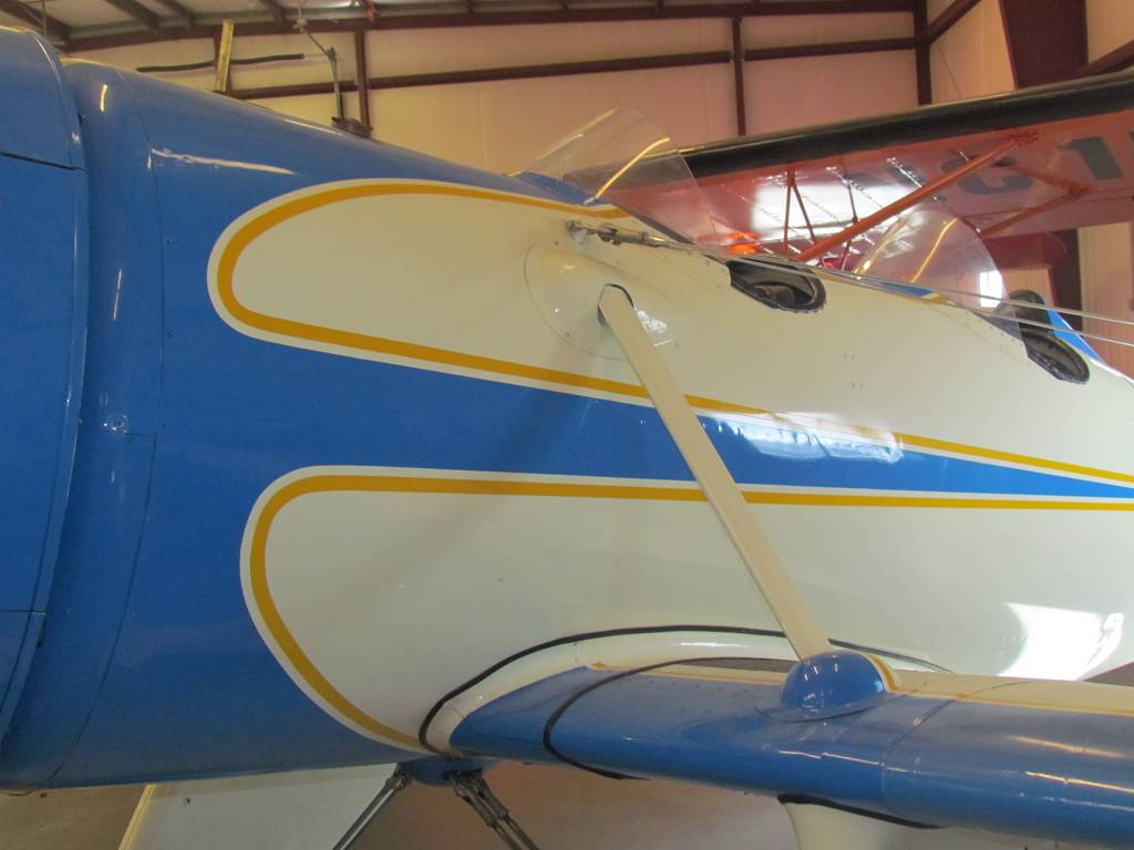

VJ,
Maybe these will help.

John, Your photo collection never ceases to amaze me !

Thanks for all the suggestions and photos as they all have been helpfull for me in redesigning the struts. The second version will hopefully be better than the first. You have given me food for thought... For me this is the most difficult time of a build. After spending countless hundreds of hours during these past months it is easy for me to get sloppy and not put my best foot forward trying to get to the end.

Great pictures! You really captured those details of the wires and struts well. I would love to get a set of those pics John, and I would be willing to pay youfor them and have you burn them to a cd. VJ I hear you onproject burn out, I had to take a break from my P-47 buildbecause I was getting frustrated over gear doorinstallation. Idecided to do some sanding onmy Cub instead and it wasactually nice and relaxing, I knowI'm a sick guy
