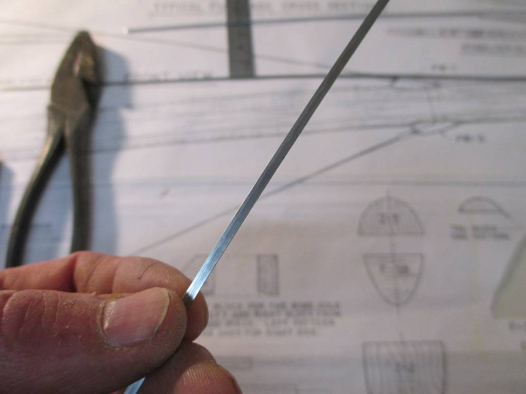

Chris, I debated with myself wheather or not to use the flat wires supplied in the kit, but in the end I went with what more appealed to me. If this were going to be a true "scale" build I would have went with the flatter wire. I literally have hundreds of hours into this build and I probably have the same number of hours of debating and decision making that went on in my head to get to where I am now... If at a later dater I want to make a more true to scale flying wire I can easily swap them out.

Airframe2, the plans call for a flat steel wire (about 1/8" wide) that you would attatch the clevis to. Isubstituted this with regular 2-56 steel rod. My flying wires are fully functional. I will post a photo later this evening on what was supplied in the kit so you can see.

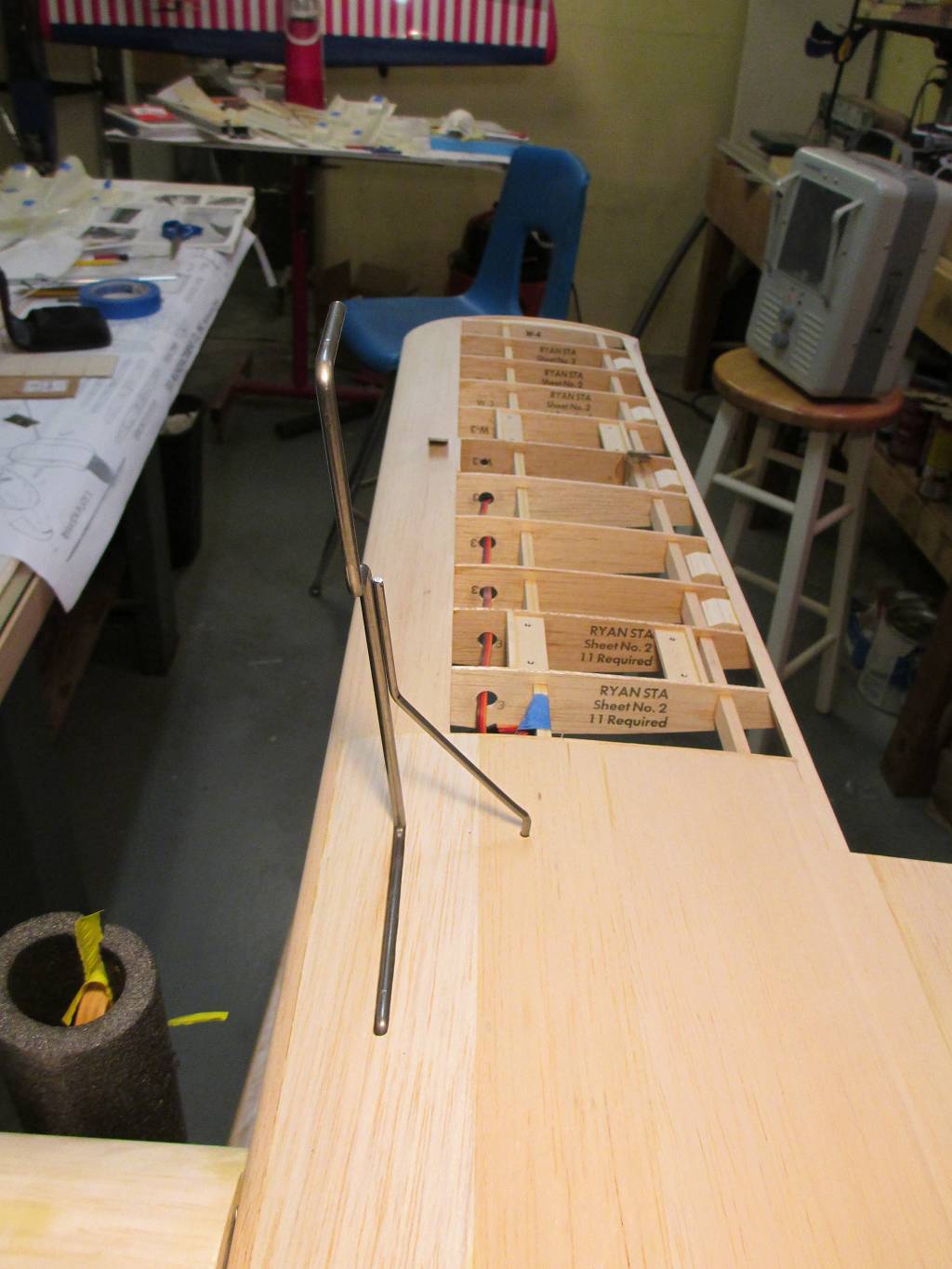

Airframe2, the first photo shows the stock flying wire (on bottom), the middle is the same wire turned to show its thickness, while the top wire is the 2-56 rod that I used. The instructions say that this( stock ) wire is made of aluminum, but it's not it's steel and can be soldered if you choose.
ID:	1830446   Click image for larger version

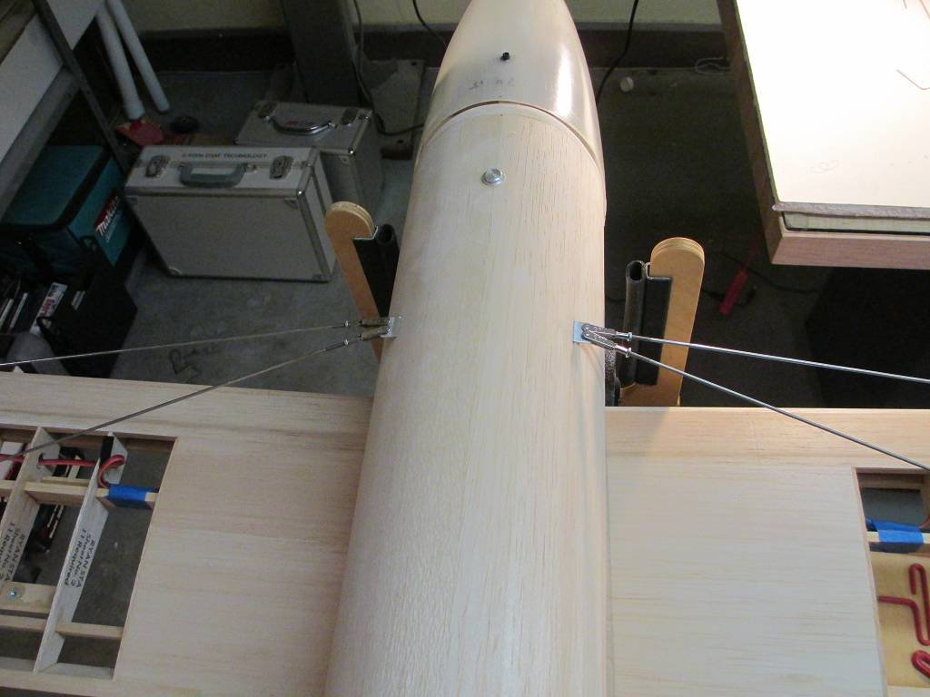

This morning I made the last set of flying wire brackets for the trailing edge side of the wing. Brackets are similar to what I made in the front except they are a different size. I did not follow the instructions as they would have you make two separate brackets for each side (top and Bottom).I combined them making one and believe it will be less prone for any type of movement. I added a 1/4" x 1/2" balsa stock thatI epoxied to the adjacent spar to further secure it between thebay.
ID:	1830761   Click image for larger version

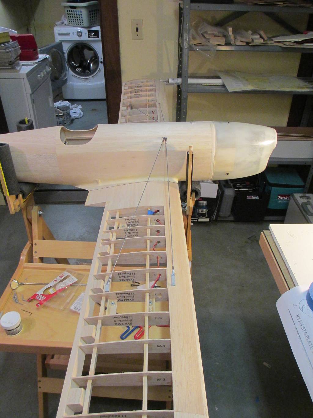

Upper flying wires completed, here's how they look. It occured to me that maybeyou would want to seewhat I use to do my soldering with. This Ultra Torch works very well for things like clevis' because a propane torch gives off too much heat and an electric soldering gun not enough. Not very expensive and works super. Good stocking stuffer from Santa! Time to work on the lower flying wires but that means I have to assemble the landing gear first. Not much left build wise, but plenty sanding wise...
ID:	1830816   Click image for larger version
ID:	1830817   Click image for larger version
ID:	1830818   Click image for larger version
ID:	1830819   Click image for larger version

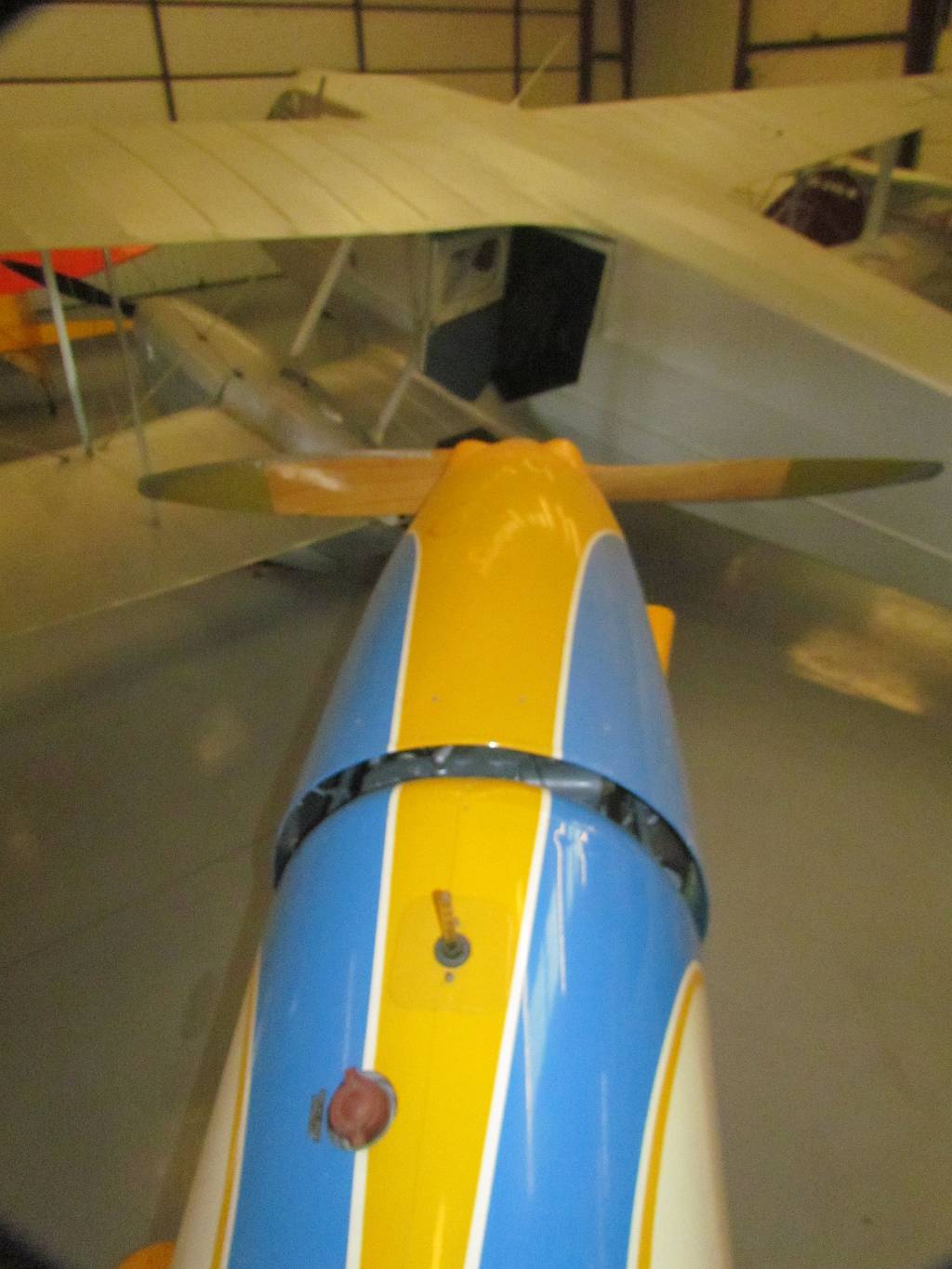

skylarkmk1's Avatar
Joined: Sep 2004
Posts: 2,031
From: Festus, MO
Default RE: Sig Ryan STA
OK Guys,
I made it out to Creve Coeur Airport this morning and took about 100 photos of the ST-M (white with blue & yellow trim, posted earlier) with the Ranger engine. A few are below
P1 - Profile of N 48587 (yes that is an AN-2 in the far background)
P2 - No need to seal the gap, the elevator is similar
P3 - Top view of nose paint (de Havilland Dragon Rapide in background)
P4 - Top of wing paint, bottom has a similar paint scheme
ID:	1830928   Click image for larger version
ID:	1830929   Click image for larger version
ID:	1830930   Click image for larger version
