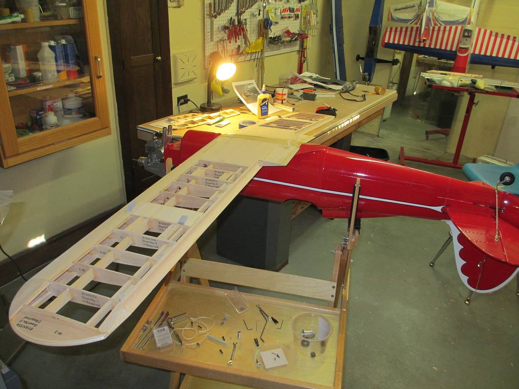

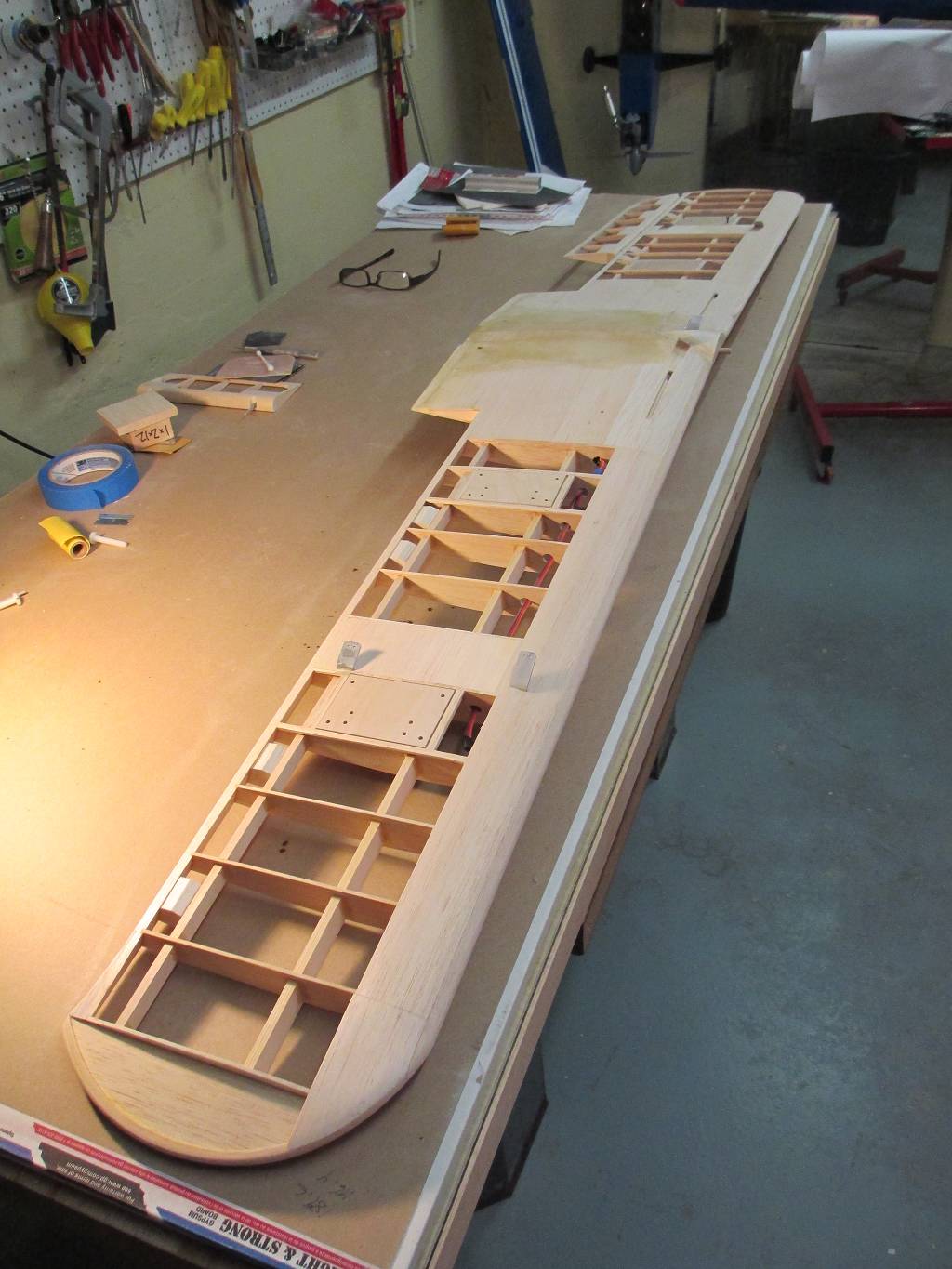

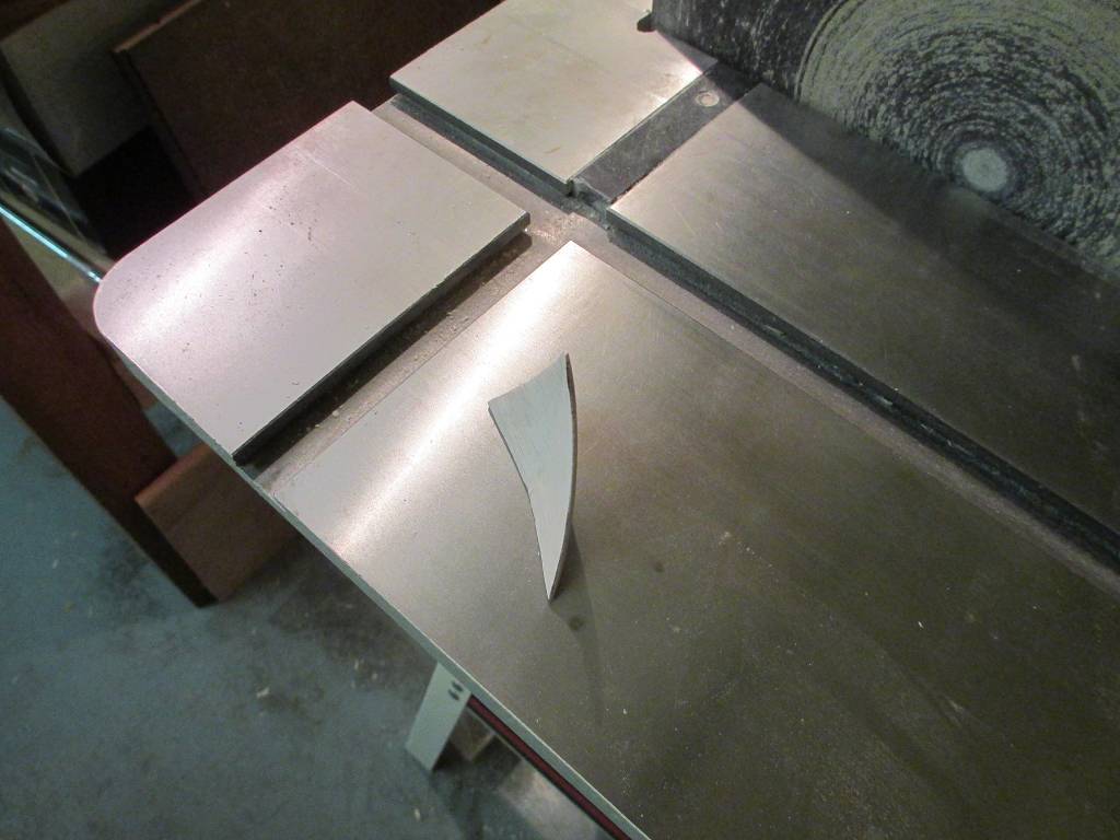

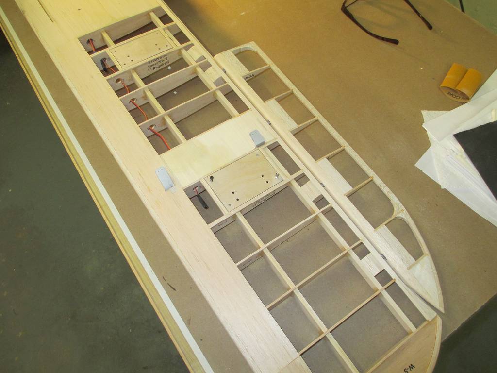

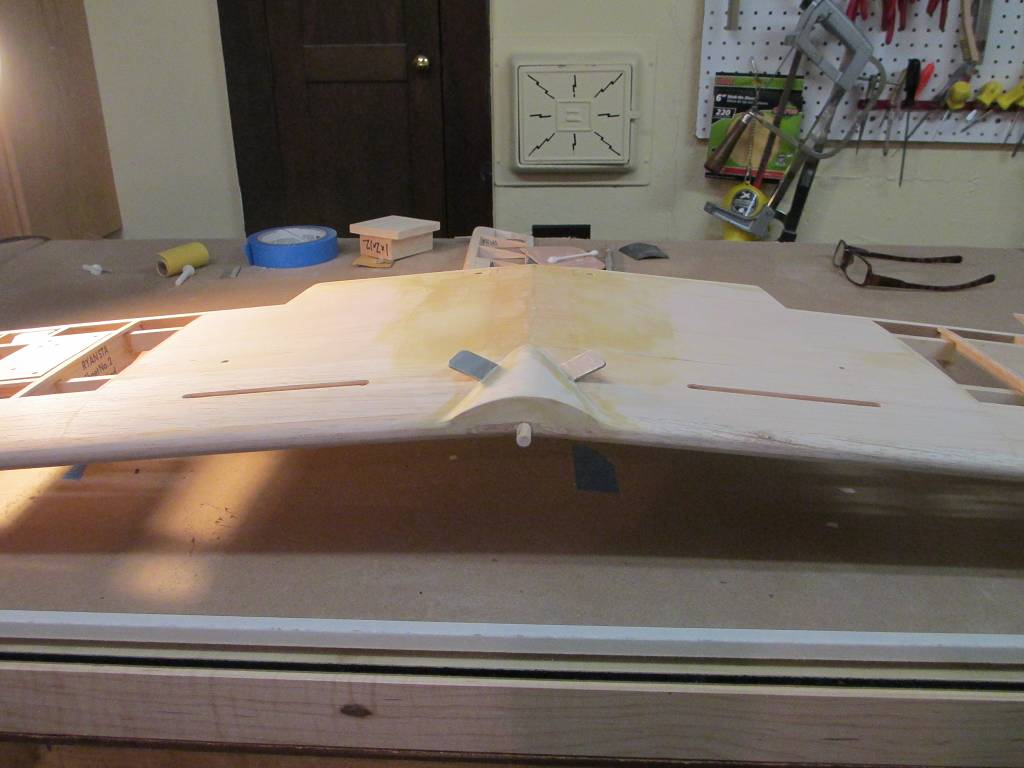

Didn't want you all to think that I have been slacking, so I thought I'd take a few photos and show you the progress that I have made.Progresshas been painfully slow at times, but that's part of every build...
The center of the wing has been glassed and two coats of resin have beenapplied, thiswill givemore than enough strengthto this joint. I also decided to box in the bays thatare next to the aileron servos for acouple ofreasons. One, it gives me a bay to tuck the servo lead into,if I have a servo failure that requires me to getat the connection itcanbe easily accessed. Second, it will giveadditional surface areafor the Solartex to hold onto around the aluminum wing brackets. Speaking of having enough surface area for the covering to attatch to, notice thatI have alsoadded 1/8" square stock around the aileron and flap openings for thesame reason.
I wasn't happy with how the front of the wing blends into the fuse, so I decided to make a filler block which proved to be quite a tease to make but fun.It was like carving a Doritos chip!

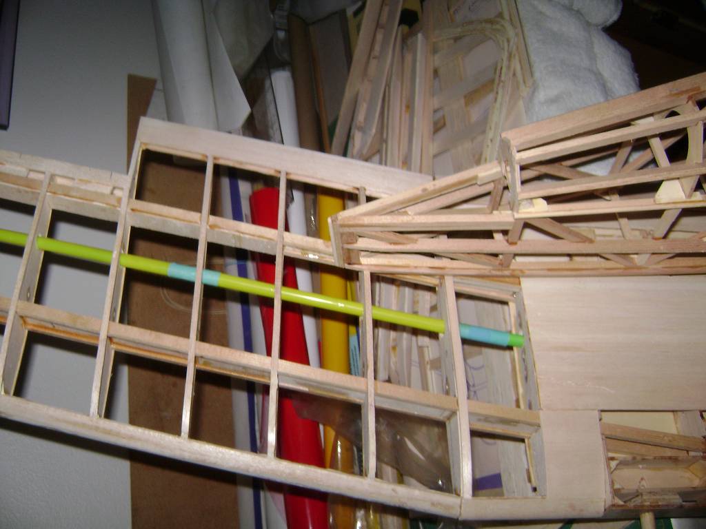

Just a tip for those aileron servo leads; use a large Malt straw. The Malt straws are even big enough for the "J" style Futaba connector. WALMART's got'm.

Now thats what I'm talkin about, details always the details. Such a small piece VJ but it makes all the difference in the look. Paddcat, thats a great idea on the straws. I have even heard of wrapping a sheet of paper around a dowal, taping it with some scotch tape then soaking it in thin CA.

Vince, I love the added piece to blend the fuse and the wing 110% better than the original design. I think the idea about the wing servos is the only way to go. Ed thanks for the idea on the malt straws I was looking for tubes for my project. I will aso add a bit of foam as suggested by ghoffman! I swear some of the best ideas I have ever used come from the members of this board and I have been building since I was 10 years old! THANKS TO ONE & ALL!!!!

The "Malt straws" as installed on my Jungmeister which is in the framing process.

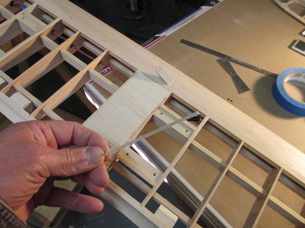

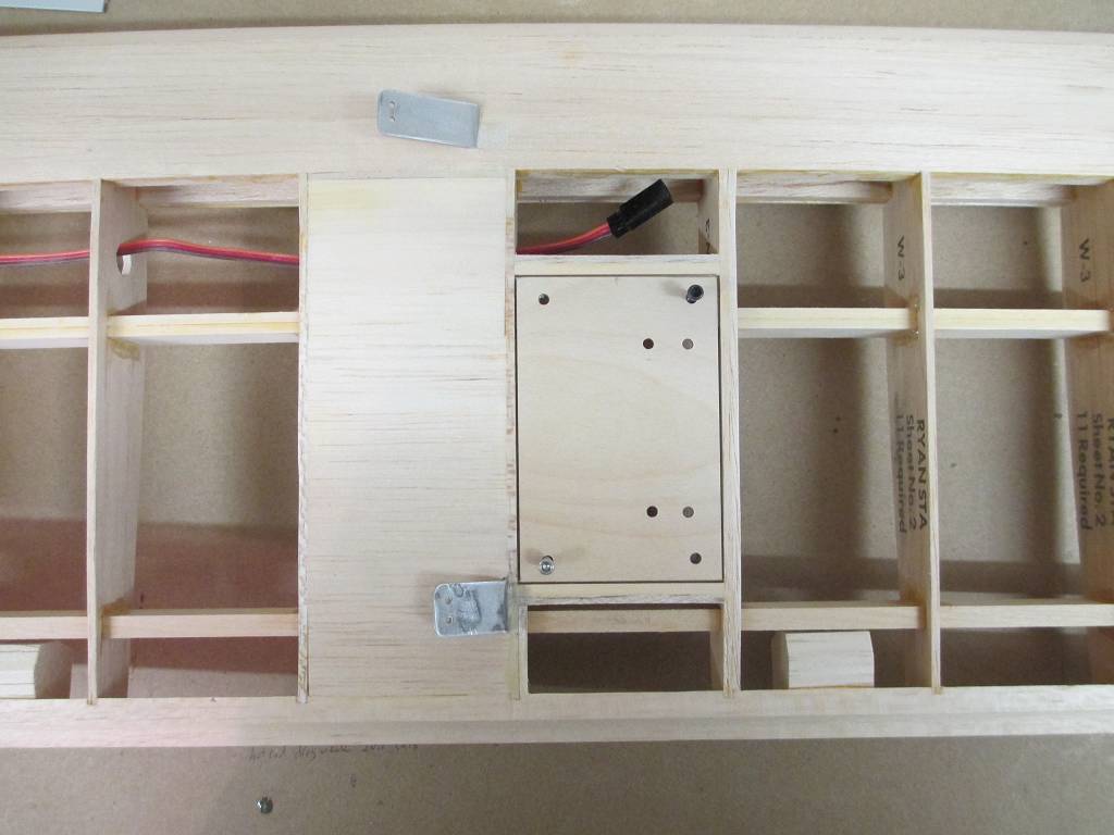

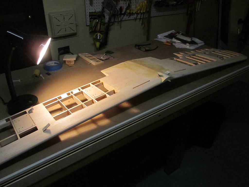

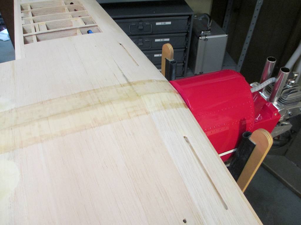

No work today due to more snow . Mother nature dumped another foot of snow on us the day before Spring! The good news is that between snow removal I was able to spend the day in my workshop. The wing is finally completed and now ready for covering...
A lot of time was spent sanding, filling any dents, low spots and then more sanding...final sanding was done with 400 grit for a super smooth finish. Other details that I had to attend to was reducing the final opening sizes of all the servo covers. When I fitted them they had very little clearance, 1/16th was taken off around the perimeter to accomodate the thickness of the covering and the paint( as seen inthe before and after photos).
I mixed up a small batch of epoxy and I put a small fillet on each rib securing it to its spar. I did this because of the way the wing was assembled sliding each rib over each spar wipes off the majority of the glue that I had put on. She won't move now!
Ialso had to fit another aluminum bracket thatI made for thefourlanding gear wires which I screwed and epoxied below the balsa block thatI made the other day. I need to give the wing a good vacuuming followed by blowing it off with some compressed airbefore I can start on the covering.
Tip of the Day: Don't be in such a rush to epoxy the wing centering dowel in place. Epoxy it in place <u>after</u> you put the covering on the wing, that way you don't have to bother cutting around the dowel.
