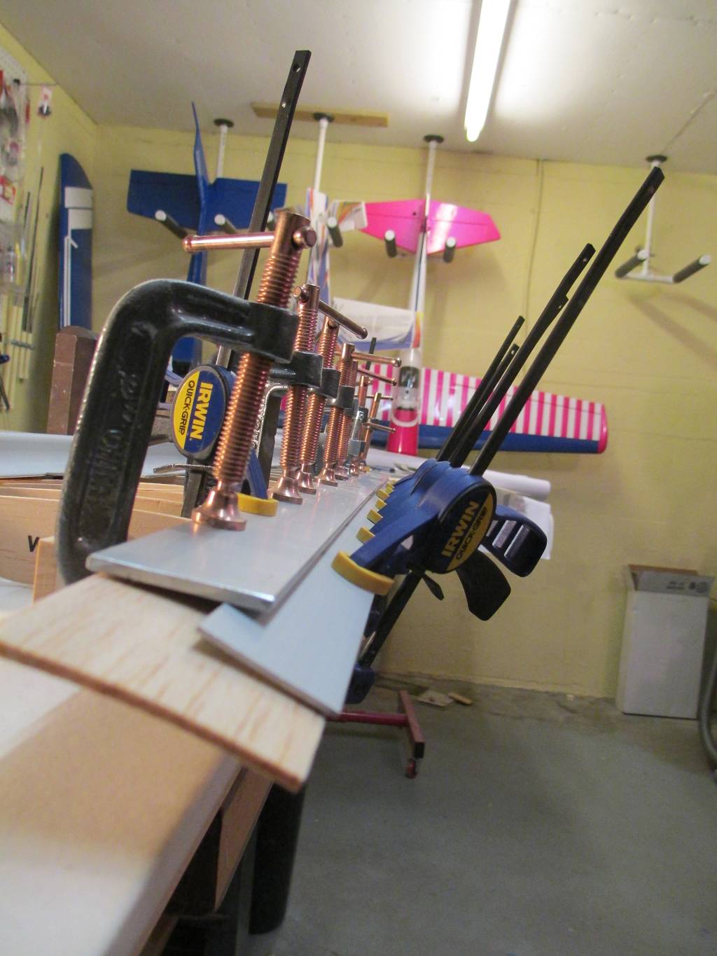

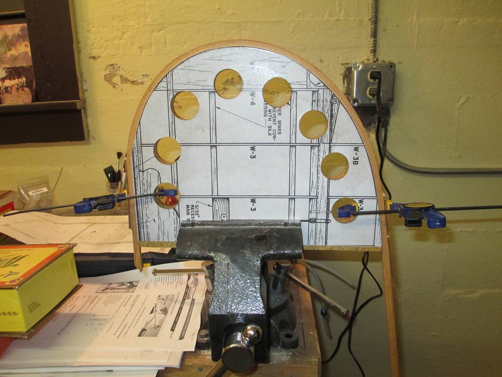

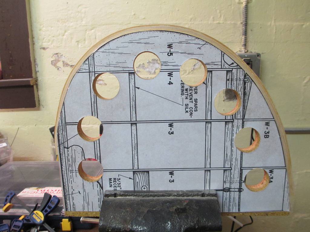

Funny what we in this hobby get excited about, I got up at 4:00 am just to glue the wing tip laminationsthat was drying all night in the jig. I released the clamps around 10:30 am and as you can see it held itsshape in the jig perfectly. When placed on the plans it should be a perfect fit. Should look like a million bucks with some minor sanding...
Side Notes:
  1. I took a piece of scotch transparent tape and laid a strip of it down on the jig in the event glue dripped from the laminations. Thispreventsyou from bonding your wing tip to the jig.
  2. After removing the clamps but <u>before</u> removing your wing tip from the jig, make an index mark on your wing tip, it will aide you in proper alignment when fitting to the wing.

Cool!  Nice job VJ.  I'm learning, keep on going!

That's pretty cool there VJ, but too much work for me. I too use water buta little differenet in the method, I use magnets over the plans.

Ah yes the advantages of the magnetic build board. One day I'll break down and buy one! But building the jig was very theraputic at least give me that ....
Next on the agenda was to attatch a 3/32" balsa wing tip to the chord line of rib W-4. After measuring where the chord line was, I had to attach the wing tip perfectly squareto this line. I suppose thier are many ways to accomplish this, buthere is the wayI chose to do it. I hung the wing off the build table, using a square kept it in the position that I was looking for, it was easy to do. (Also visible in the 1st photo are the hinge blocks that I glued on.)

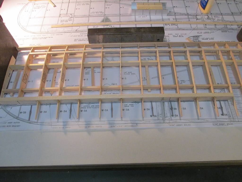

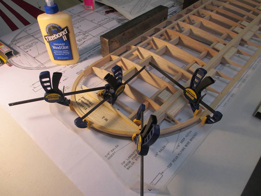

Thought before I went out this morning (flying) I would glue the wing tip to the left wing. Here are the photos.

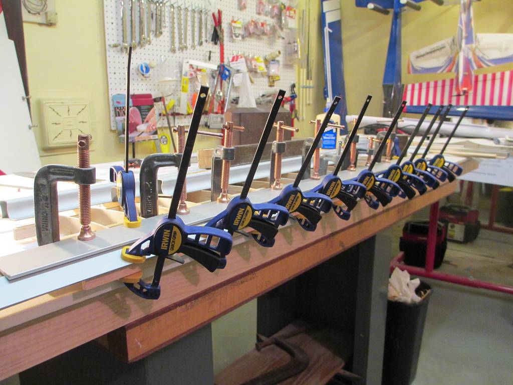

Only got in one flight before it started to rain . So I went home and started to sheet the top of the leading edge with 2" x 3/32" sheeting. If anyone asks you what you want for your birthday or the holidays, you can't go wrong if you ask for clamps...

Looking good VJ!  And, WOW, you've got a few clamps.  But no matter how much I ask for something... well... you know!

Beautiful lamination on the wing tips! Something magical about pulling the part off the form and it holding its curve.
<div>
That's the next step on my Nieuport build.

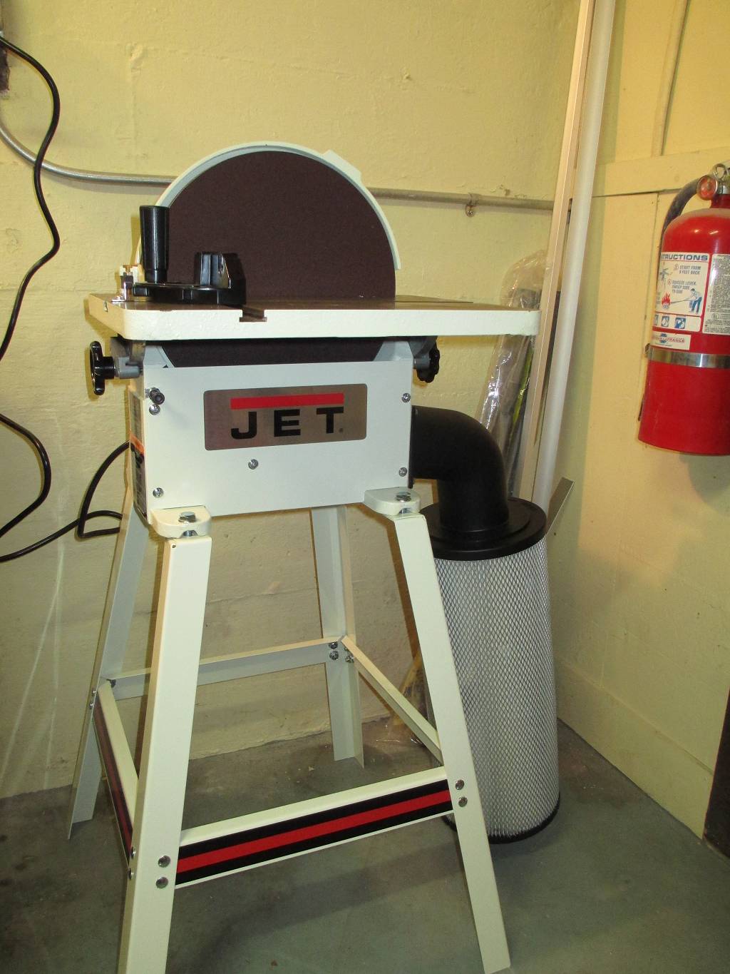

Guess what arrived at my back door today. A brand new Jet 12"disc sander that I've been eyeing for quite awhile. This will be a welcome addition to my workshop. Compared to my 6" disc sander that had a cheap wobbly aluminum table with a not so accurate miter gage, I'll be in sanding heaven!

There is nothing wobbly on that one! I was surprised at how big it was when mine arrived. The wind out of the port is like a leaf blower. My Ryobi one always threw dust in my face as I sanded. This one leaves no trace of dust on the part / table. It all gets sucked up by the internal hampster wheel fan and shot out of the exhaust port. Your filter on the port will work perfect!
