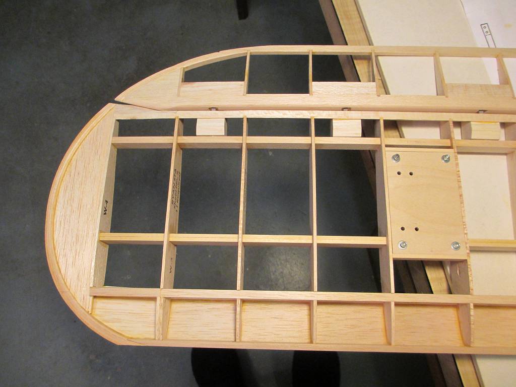

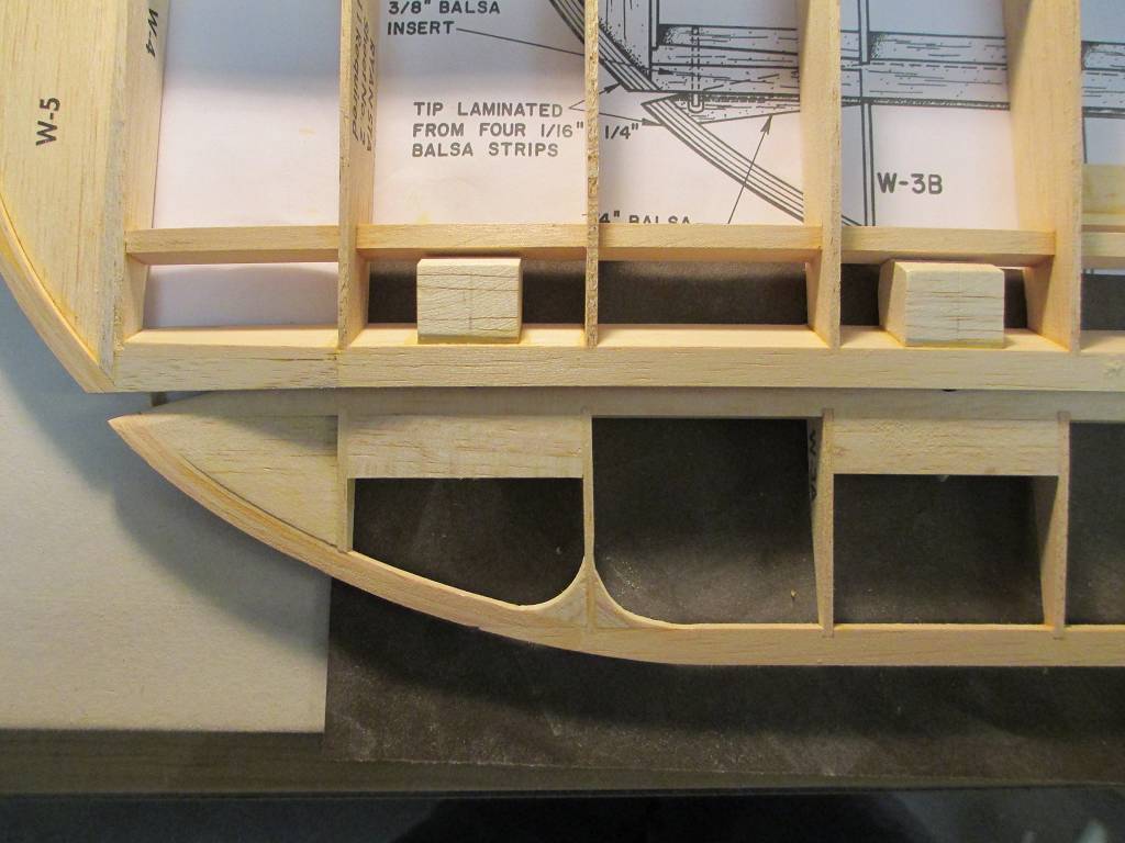

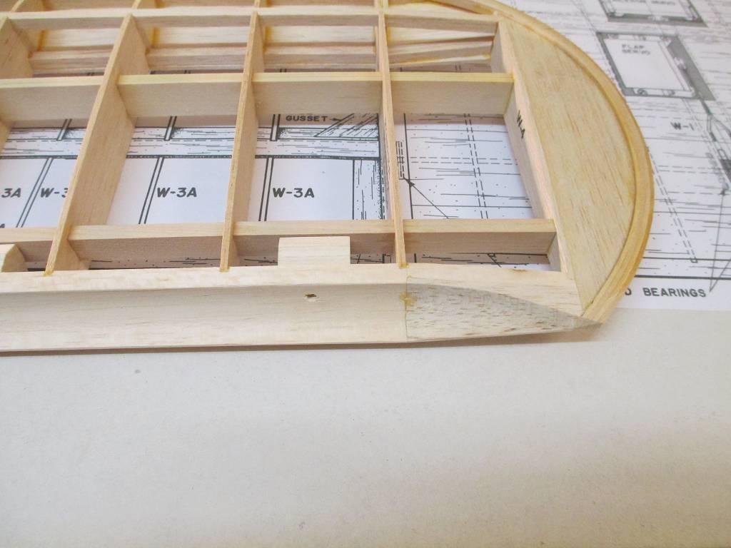

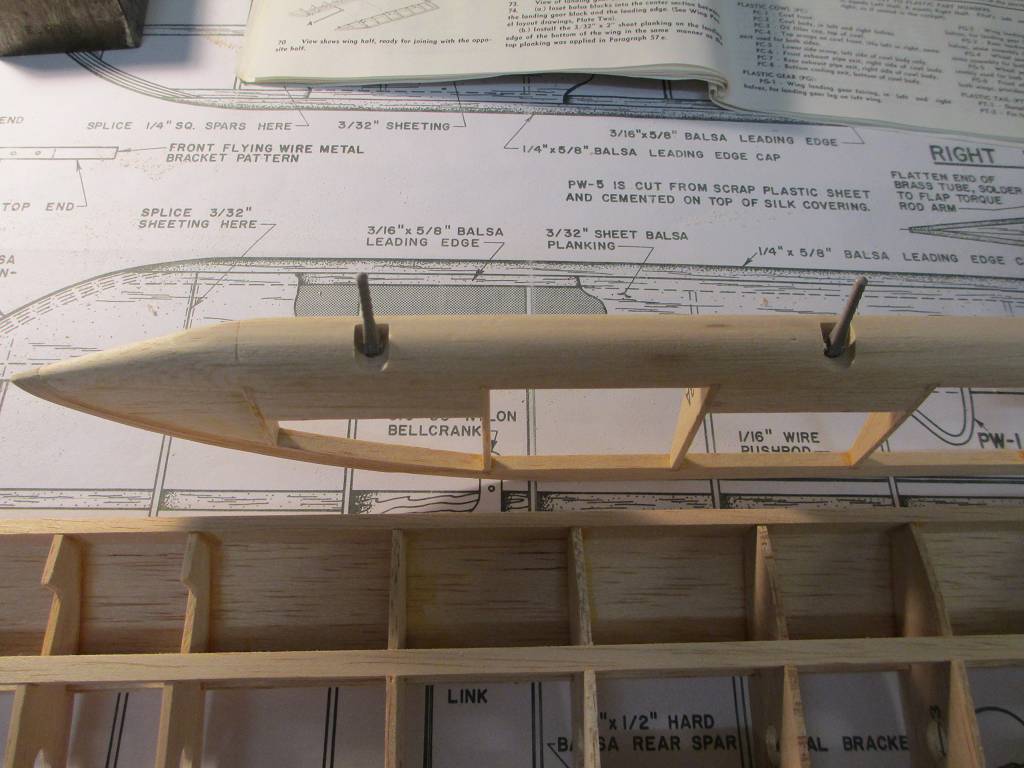

I've been busy in the shop today. I spent most of the day deciding how I wanted to transition the aileron tipto the wing tip. As I said in an earlier post, the plans are vague in how this is accomplished. This is my interpretation of how I thought it should be done as you can see in the photos. It took quite a bit of time getting the fit just right
Anotherchallenge was to hinge the ailerons and flaps using Robart hinge points. Ihave used these hinges inthe past with great success, however this was my first attempt at using them in a "scale" type situation. I had already decided which bays that I wanted them to go in. You can see that I added the necessary blocking these hinges need . I drilledall of the holesusing the drill press to ensure all holes were straight. Now it's time to installthe hinges...each hingehad to be sunk pretty deeply into the aileron leading edge. I first marked/scribed with a pencil the hinge centerpoint visible in the photo. Next was setting up a simple back stop on the drill press to act as a depthgage to ensure all 6 holes were sunk at the same depth. I used the small drum sander that comeswith a Dremelgrinder that I'm sure everyone is familiar with chucked in the drill press..After all holes were countersunk I had to sligtly further enlarge the first 1/8"of the hole by handusing a drill bit.This is done because if you notice on the Robart hinges they are slightly tapered near the knuckle end. If you ommit this step the hinge will never seat properly. The holes in the wing's trailing edgedid not need any further enlarging due to the fact that the hinge standsproud of the trailing edgefor it to work correctly in this application.

A really excellent job on the aileron hinging. It's nice to see good craftsmanship is alive and well! My own Ryan is still in the box, but this all looks very enticing.

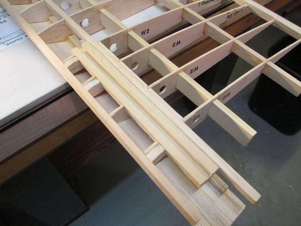

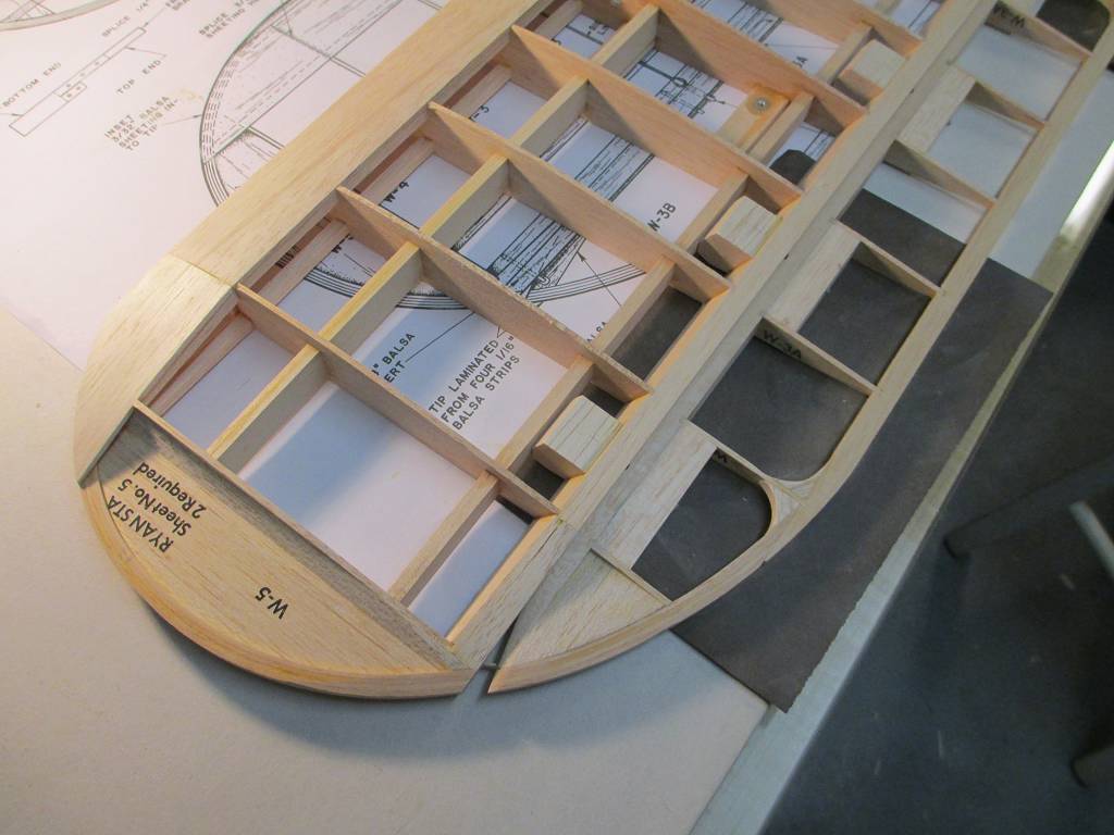

Spent most of the day at the flying field, but I did manage to put in a few braces in the aileron and triangle stock in the wing tip. Wanted to give these areas a bit more strength.</p>

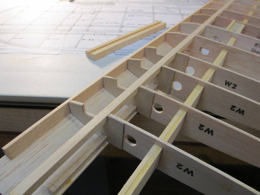

In an attempt to shure up the landing gear block what I have done was to reinforce each of the four ribs that support the landing gear block with 1/32" birch ply cut to fit the profile of each rib. Each piece was glued to the inboard side of each rib.The weight penalty is minimal and from the reasearch that I have done this area has been prone todamage on less than perfect landings.

I can confirm that reinforcing the gear block area will save you a lot of grief. I have started recovering my wing and the only place that needs repair is the gear block area.

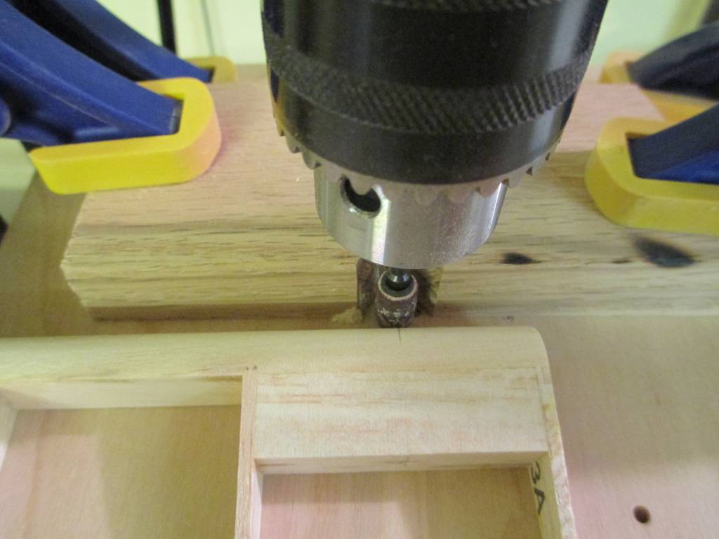

Thanks swift bill. This plane certainly has it weakness' and I am trying to eliminate or at least reduce the chances of problematic occurences.
On the same theme I have spent quite a bit of time reinforcing the landing gear mounts. I have added 1/4" balsa stock to support and craddle the mounts in three of the four ribs, this increases the glue area making it a much stronger connection. Additionally, I installed shear webbing in that area making a very strong box frame. (Note: the grainon the shear webbingwas installed vertically for maximum strength) The landing gear mount block at this time is only sitting in its newmount, it is not yet epoxied in place. The reason I did not place the 1/4" square balsa on the second rib is because there will be a torque block that will be epoxied to the underside of the mount in that area. I believe all of these steps will correct / strengthen an overlookedarea that was prone for damage.

My Contender has the same setup for the gear mounting. I apoxied the torque block in place then added a piece of 1/2" tri-stock from the torque block to the gear block for added security. I didn't like the idea of a butt joint keeping the gear from touqing the block loose on a rough landing. 50+ flights and it is holding up very well with some less than perfect landings.

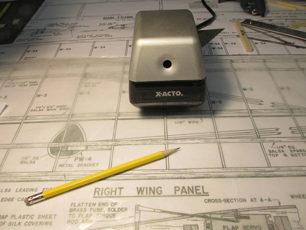

Default RE: Sig Ryan STA

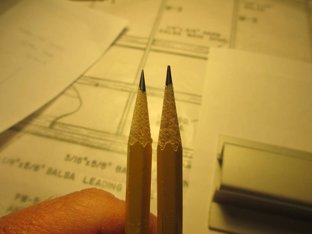

OK, here's my nominee: my X-acto electric pencil sharpener ( Model #19xxCN ). I really like a sharp pencil, it helps me make accurate joinery, this pencil sharpener gets pencils the sharpest! I'll bet a lot of you have the old type hand crank pencil sharpener that you mount to walls, similar to the one I still have as a back-up. You can see the difference between the two pencils in the photo. Both are #2 pencils that just came out of each respective sharpener. You decide....

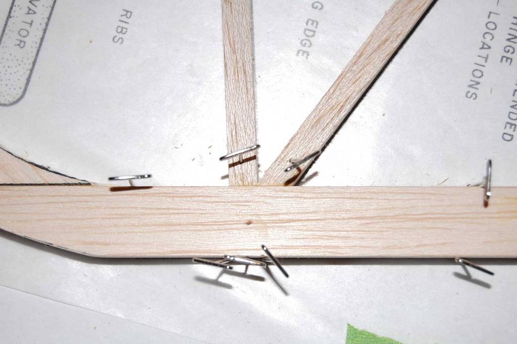

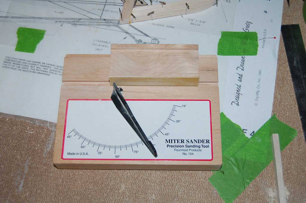

This is one of my favorites that I've been using on my current cub build. It makes fine tuning angles and keeping them square top to bottom very easy.

ORIGINAL: Neddy191
How do you set this to make sure the angle is correct?

ORIGINAL: OldScaleGuy
ORIGINAL: Neddy191
Get the initial angle by eyeball, test fit, sand a few strokes, test fit, sand a few strokes. Usually only takes 30 seconds to get the angle perfect and the joint fit tightly.
