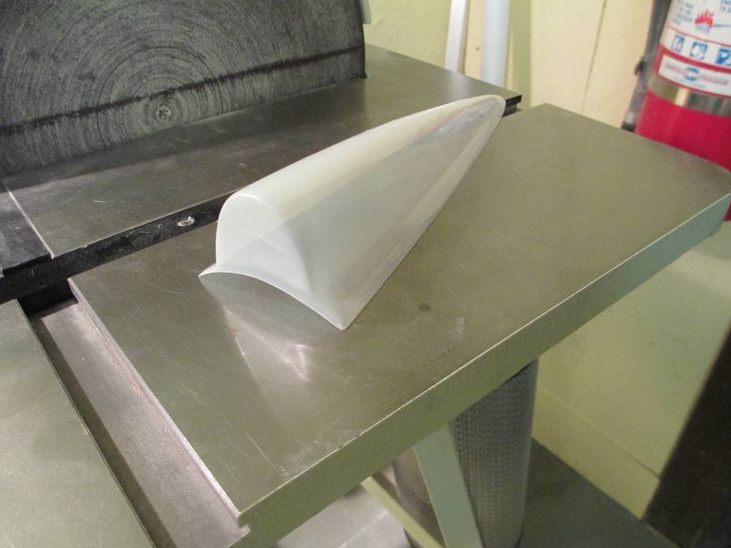

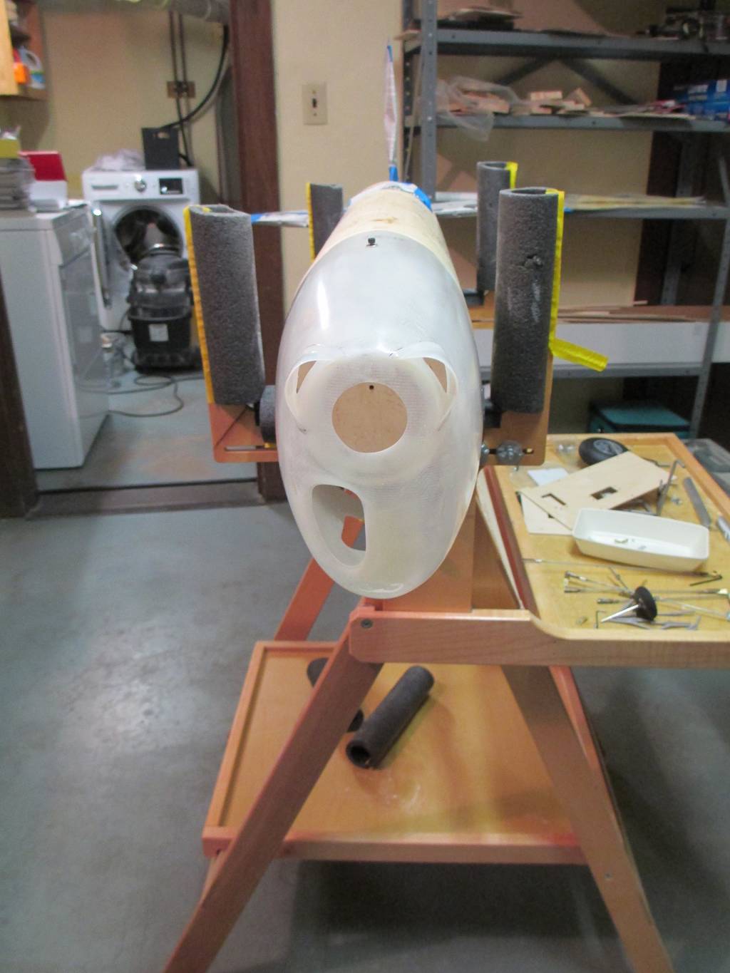

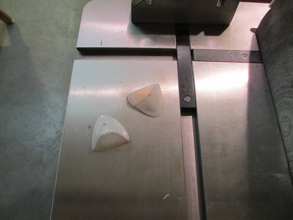

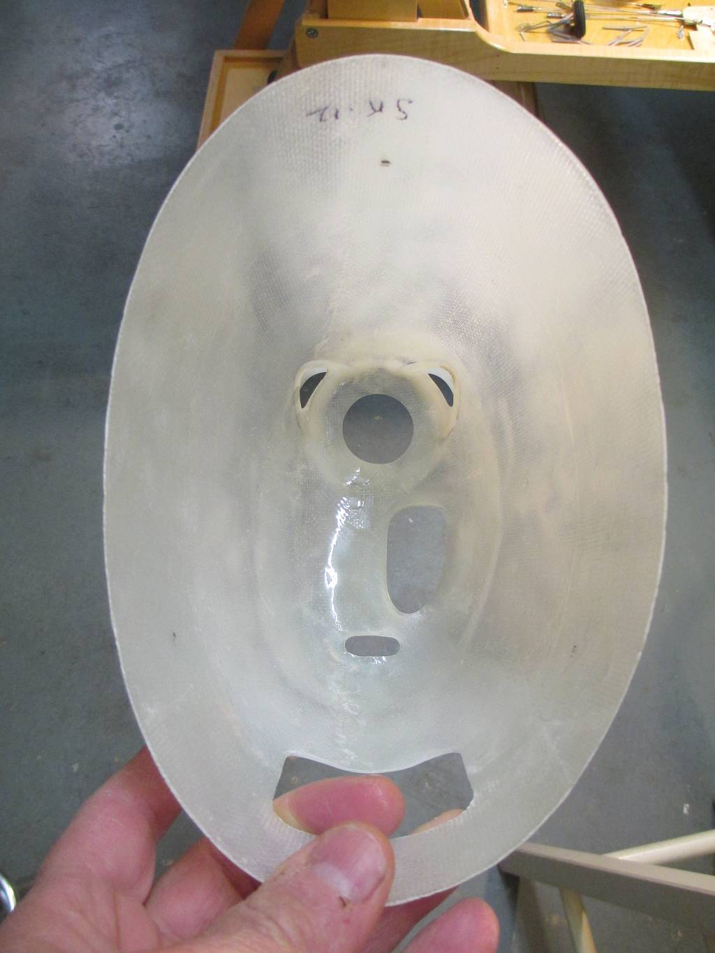

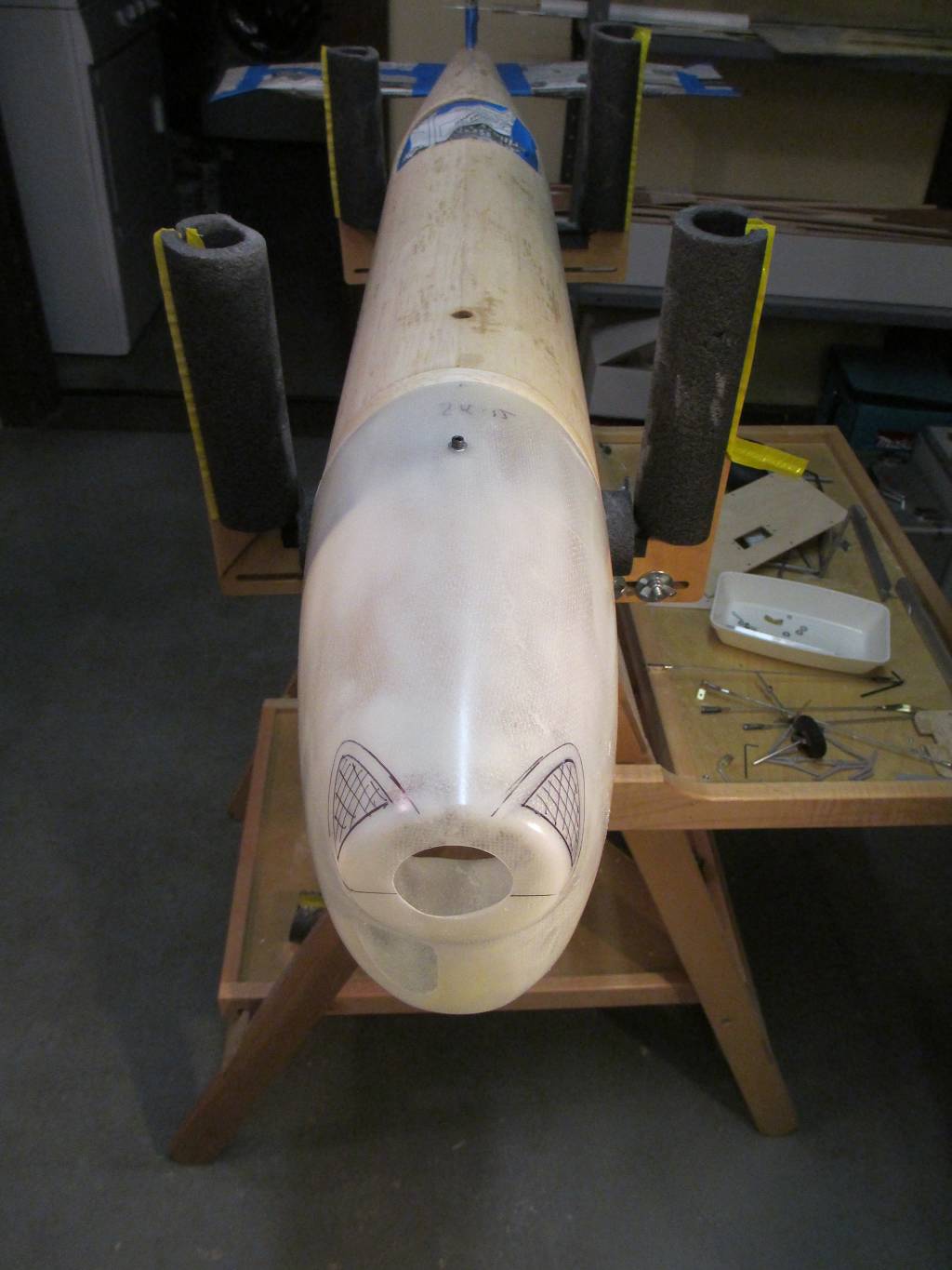

SinceI have to wait for the primer to arrive I decided to focus my attentionon the cowl, specifically some of the airscoops at the top. These scoopswere part of asix sheetvacuumformed ABS. After cutting them free,fitting them was relatively pain free. The pictures that I recieved from John's(skylarkmk1) CD helped me infinding theproper placement. I used a Dremel tool and made these scoops funtional. They wereattatched to the cowlby first scuffing the surrounding area with some sandpaper, then epoxying themin place.

Please tell me your not planning on useing bondo to feather them scoops in?

No bondo Robert. These scoops have flanges that are meant to be visible. Hard to tell from the photos thatI have but they're probably rivited into the fuse along the flange line.

Zoom in on the scoop(s) in photos 1106 and 1180. They appear to be flush riveted to the cowl.

John I did notice that luggage compartment, one of those things I wish I knew about as I was building the fuse. Not going to cut into my fuse at this point, I'm satisfied with where I placed the switch. Its out of sight and is easily accessible. Your right about the flush rivits on the scoop John I'll have to add those later.

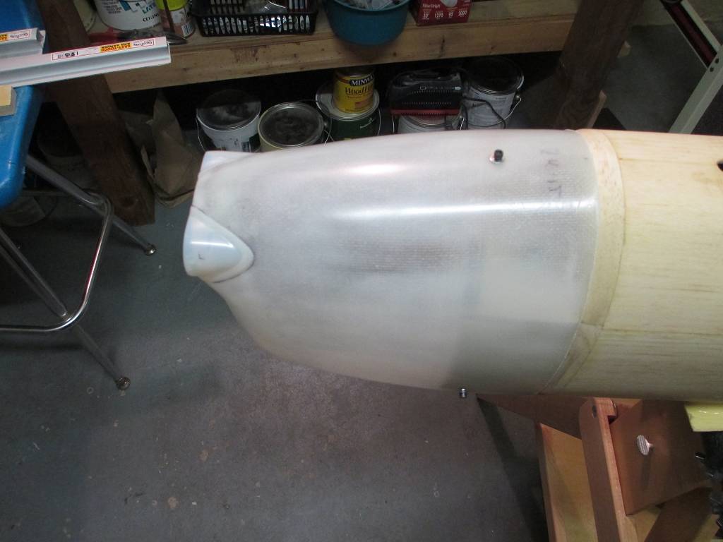

Checked on the scoops this morning, here's what they look like.

Vincent I did not notice the air inlet looked to have a bit of built in diverter. Is that stock or did you add it. I don't recall you talking of doing it.
Old 12-29-2012 | 07:51 AM
  #765
VincentJ's Avatar
Joined: Mar 2011
Posts: 4,994
Received 186 Likes on 166 Posts
From: Hancock, NH
Default RE: Sig Ryan STA
I didn't add any diverter, where are you looking?

The air inlet. Where the arrow points.

Ithink it's just a shadow effect ace. Ihope everyone had a good Christmas and santa was good to youI did a little post Christmas shopping with my GC from Tower and along with the coupons picked up a TFP-51 arf along with a DLE20 and many extras.By placing my order into 3 seperate orders I was able to maximize all my coupon codes and saved $160 over the total purchase.I know you all aren't big arf guys but the p-51 is on sale for 249.99 until the 31st and if your a club member you get free shipping and with the $50 off coupon you get a real nice plane for $200. I am going to salt it away and maybe strip it and convert to a B model and glass it. Funny thing is I just sold a B model conversion kit that I had sitting around and figured I would never get around to usingOh well. Sorry to hear about the paint issues VJ and Ihave a snow blower if you want to borrow it, I'm a skier big time so I can't feel sorry for ya hey you are in NH ya know. Continue on now.

Oh, now I understand...Sorry. That is stock, no modification by me.

Robert I think you are just seeing the bottom of the cowl thru the opening.
VJ,
I would suggest adding a baffle to get all the available air over the cylinder. Can't hurt anyways.

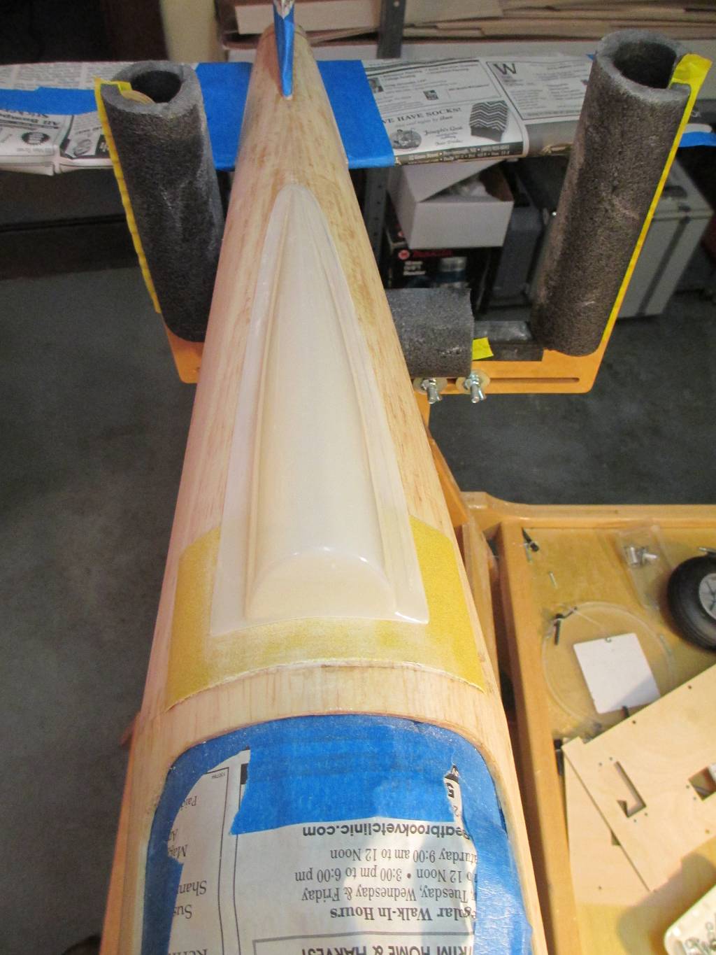

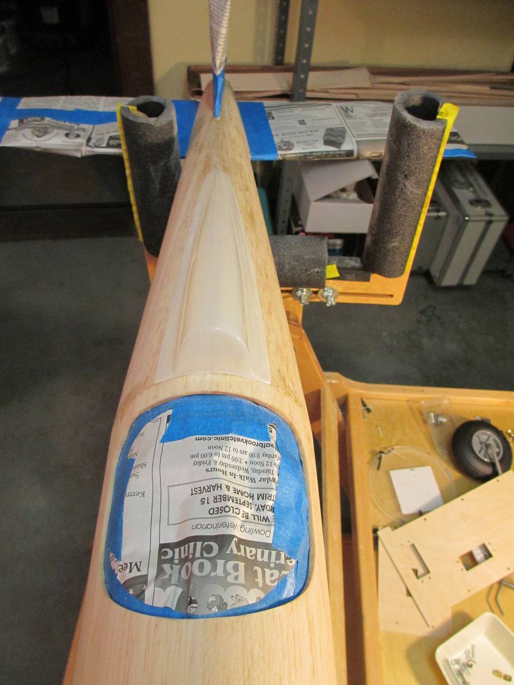

Decided to fit the headrest to the fuselage. I wanted to get a perfect fit between the parts so let me show you how I did it. Since the top of the fuse is the contour that I am trying toreplicate then it seems onlyfitting (no pun intended) to use is a sanding block by attatching some 220 grit adhesive backed sandpaper on it. By gently sliding the headrest back and forth a few times I got a perfect fit.
What are your thoughts on whether or notI should wait until after the fuse is painted to mount the headrest or do it now before I shoot the primer?

I see. Now I do anyway. Had to really, really, look.
Vj, does the headrest need primer as well? Hmmm
