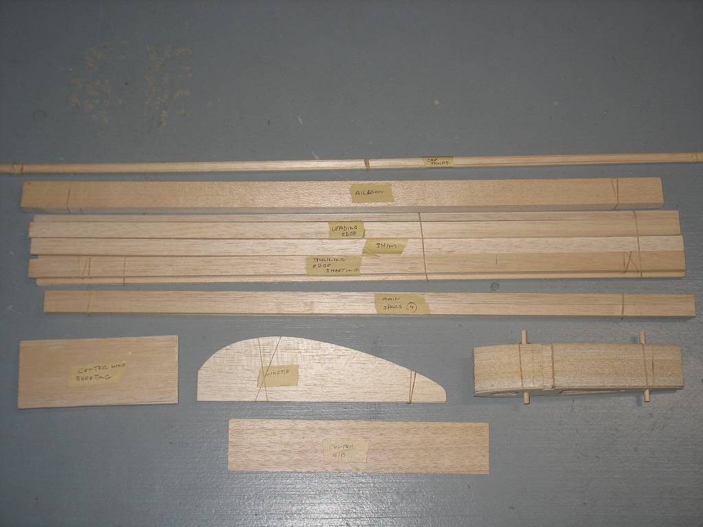

I have everything you will need except the landing gear blocks.PM me if interested.

Freddie, don't the ribs around the landing gear blocks require doublers?

Yes you are absolutely correct on the doublers.I checked the manual and there are 1/16 ply doublers.that I do not have but look easy to make.I went to the landing gear on the fuselage.

I needed a wing kit for this model, too. Since I couldn't find one, I made a rib pattern from the plans, and cut my own ribs.
The rest of the wood is standard stock sizes, purchased from most hobby shops.
From there, it was any easy task to build a new wing.
