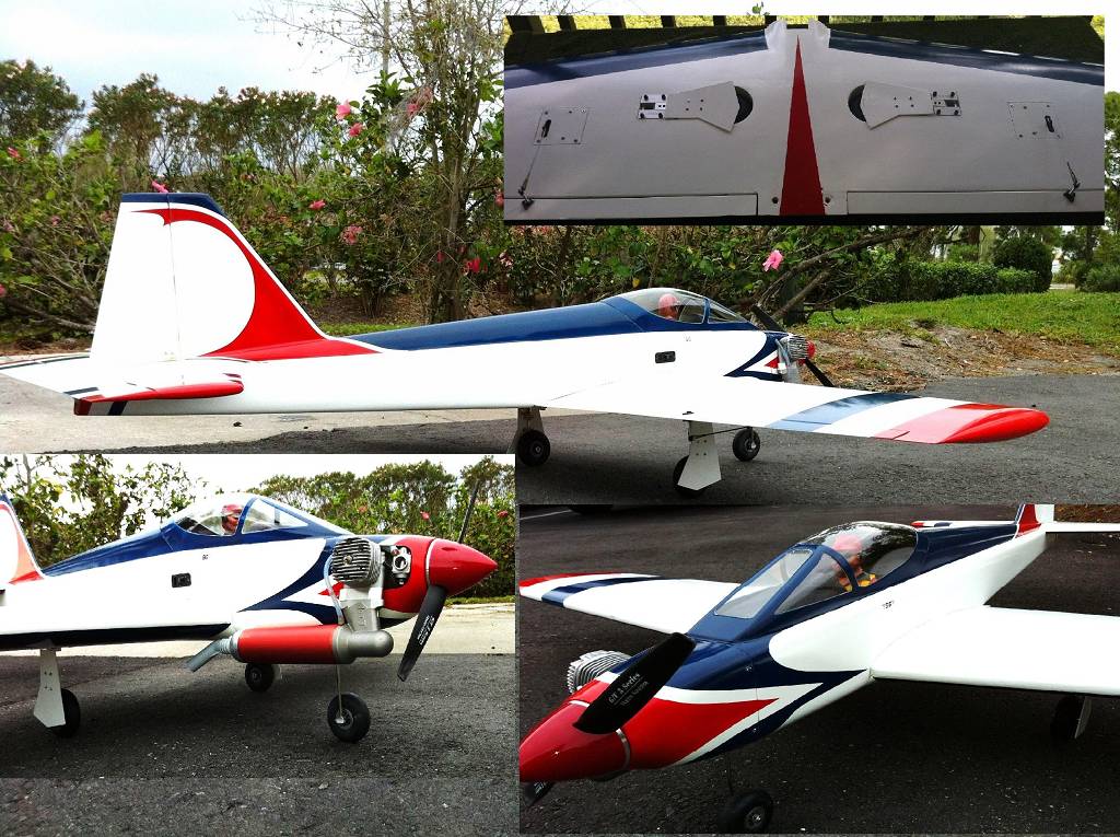

I built this for my son some years ago, a good looker/flyer with the the gear tucked.

Donny, wow that looks great what retracts did you use?

ORIGINAL: ChesterB
And how did you get enough clearance in the nose for the nose gear and fuel tank?

ChesterbJimIinca
The landing gear mains are B@D's, the nose wheel asm. is spring air.
Clearance is solved by mounting the fuel tank further back thru the top of the fuse. with a hatch beneath the canopy. we did the same thing with the SIG kobra a smaller plane....which was absolutely fast and awesome in the air but no muffler, too nose heavy. it would roll real fast with the gear up. look for the thread on the kouger in this forum.
Both are real clean and impressive sights with the gear tucked just beautiful!

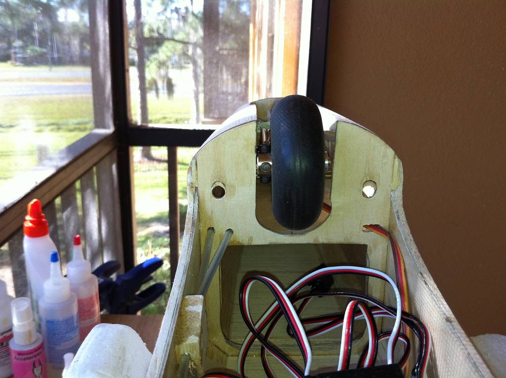

I used E-flight 60-120 size electric retracts on the one I built last year. Easy install and strong.
Nothing says it like a photo.
