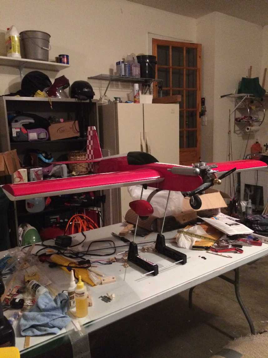

That still seems like a LOT of weight- are you absolutely, 100% sure that you're balancing at the correct point??

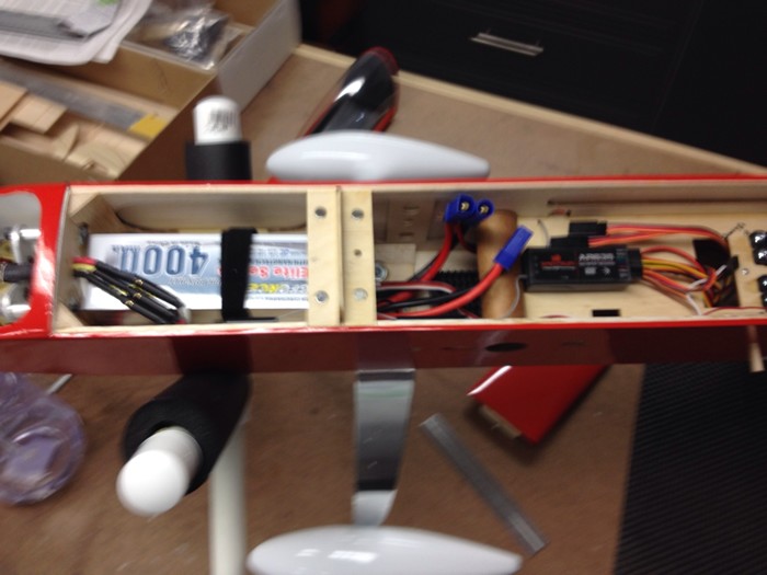

Originally Posted by sideoftheroad
Well this isn't good when you need a small 2x4 to balance it. The servo tray is notched in so I can't change that. Only thing I can think of is a really heavy battery. The nimh battery that's in there now is all the way forward as far as it can go. The engine has it's own mount that attaches to the back of the engine and the firewall has blind nuts so it's pretty much specific to that engine. Don't know what else I can do.
Is there any way you can put a spacer between the firewall and the engine mount to push the engine forward a bit? You could also try a heavy hub/spinner to put some extra weight as far forward as possible.
Your plane looks great, by the way. I just finished an SSE with as an electric conversion. With a 5S 4000 mah battery, up front, I am actually a touch nose heavy (about 1/8" - 3/16" ahead of the ideal CG).
I agree it is a lot and yes I am sure it is correct. Manual says 3.5" from LE which is where is set the balancer at. I even rechecked it and then took out a tape measure to make sure the numbers on the balancer were accurate.
Thank you Al. I like what you did to yours too. What you did to the decking is something I thought about doing only I thought about it too late since it was already put together. The suggestions you made are the same as some of the club members suggested too so I bought the heavy brass hub. I'm also going to make a 1/2" thick ply block to push it out. They also suggested using a bigger engine so I think what I'm going to try is use blind nuts on the back of the 1/2 block which will be epoxied to the front of the firewall. I also bought an adjustable engine mount so I'll be able to try the .45 1st and if necessary make the mount wider for the larger engine.

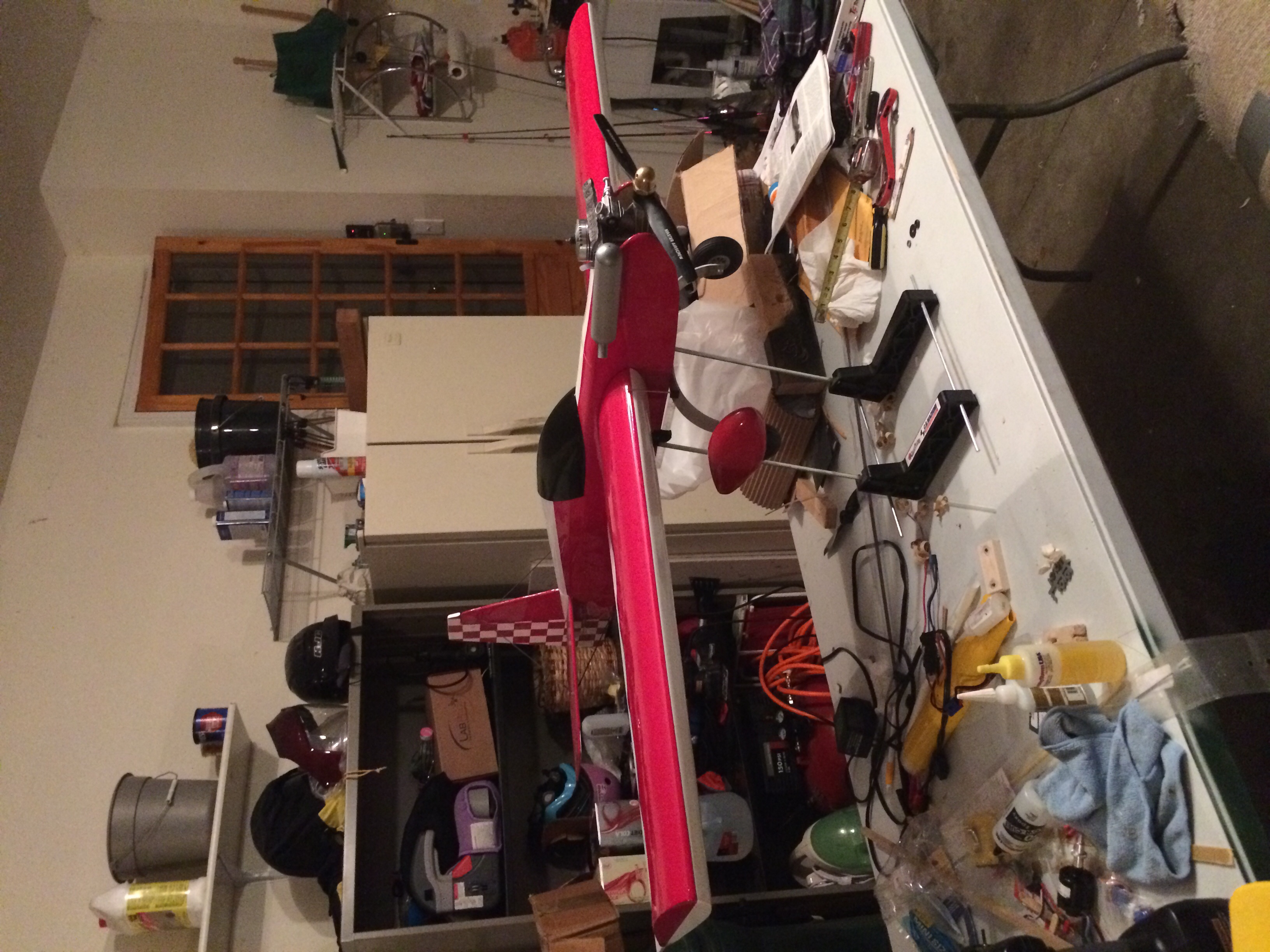

Old 06-29-2014 | 06:25 PM
  #32
Joined: Feb 2012
Posts: 119
From: Noblesville, IN
One of the club members just suggested because I modified the tail I should move the CG back to 4" so I did and put 2oz of led on top of the engine. What do you think?
btw I don't know how the picture looks to everyone else but the thumbnail is like the plane is on its' side which is not how I took the pic and when I click on the thumbnail it looks stretched and horizontal like it should be. Weird.

Old 06-29-2014 | 07:27 PM
  #33
Zor
Banned
Joined: Feb 2009
Posts: 3,524
From: Ontario, ON, CANADA
Default Is this better ?
Nice work.

Moving the CG back sounds like a recipe for disaster
Yeah, I would not move it further back from the recommended range. Unless of course you like extremely squirely controls and a nose in the sky attitude :-)
Al
I concur, I quite like the black canopy too.
Your's is also fine looking AL, I imagine it will make a fun electric. Did you lighten it up, or build it stock?

Sideoftheroad, I looked back at your build pictures and from what I can see the counterbalances were not the only mods to the tail surfaces, but in fact it looks like the elevators and rudder were enlarged compared with the stock kit. I may be in error if this is an update that Sig did since earlier builds?
If so, that would explain the tail heavy situation.
Old 07-02-2014 | 05:03 PM
  #44
Joined: Feb 2012
Posts: 119
Dave, you are correct. Added counterbalance on the rudder and elevator as well as added length to the surface area. Somewhere 1/2-1" if I recall.
Thanks Dave. It is pretty much stock. Unfortunately, with the battery, it comes in a touch heavy at 5.7 lbs. (the battery is a pound by itself though). I documented the build on my blog: http://alsrcsite.com/category/building-projects/sse/ (something I do just for fun).
I've run it up (on the ground) with a 12x6 prop and it's pulling over 700 watts, so I should have plenty of power on tap. I want to play around with a few other prop configurations before maiden though.
