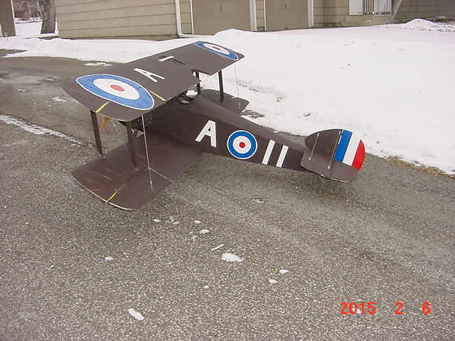

Mine is finished I put 3 lbs of lead up front

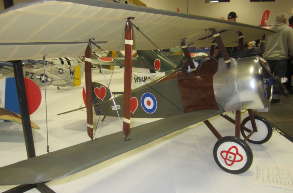

It's official. The Sopwith Camel took 2nd place in the WWI category at the WRAM Show. Yay me!

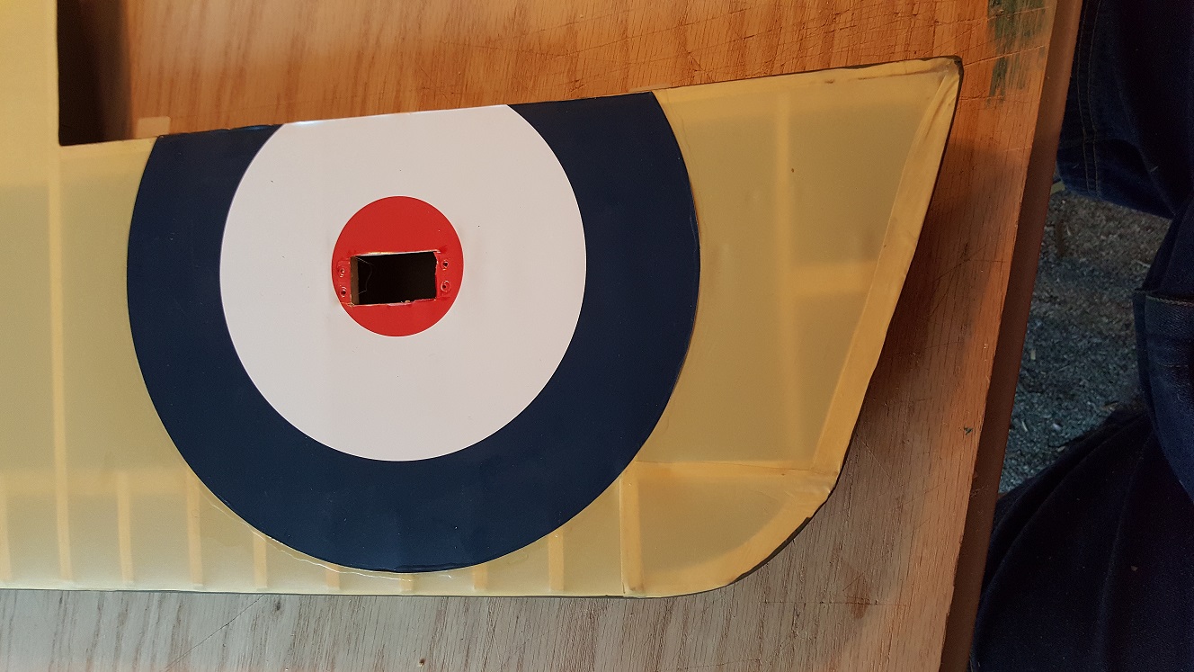

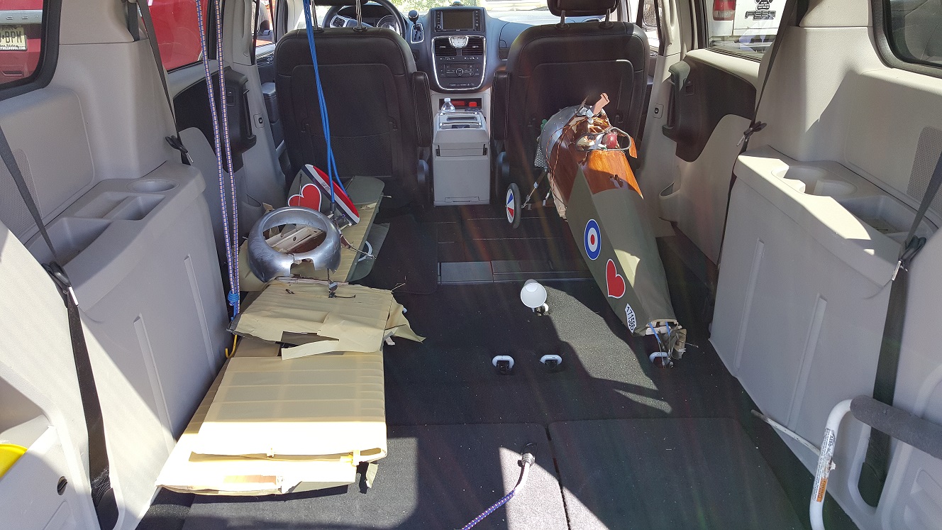

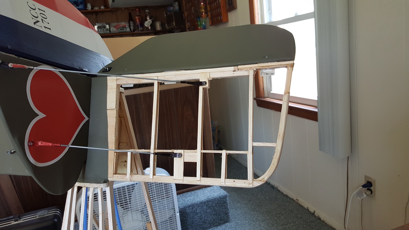

Rebuilding the Camel.
The Camel got caught in a crosswind that I couldn't get out of and went into the trees. As it went straight into the trees, the damage was not total as the wings, tail, and engine suffered the most damage. For you newbies, if it's going down it's best to try and stay straight and level as this minimizes the damage. The cut on my arm is not as bad as it looks as it's well on its way to healing. I'm on Plavix which makes you bruise horribly. The engine suffered damage and I'm waiting for estimates for the parts before I decide what to do with it. At this point, the tail is almost ready to be recovered and I will be using the original graphics again. It's also looks like I'll be able to save most of the stained wood around the cockpit. I'll work on the cabanes and wings next. See you next time.
The Karp

Old 05-27-2015 | 03:04 PM
  #121
Posts: 263
From: Roseville, MN
I noticed in your pictures that you used links on the tail for bracing If you get rid of those and put wire in stead you will help the tail heavy problem quite a bi t Take them off and weigh all of them surprise how much they weigh and then they are way back in the tail how much weight will you have to add to the nose to offset You can get some silver colored fine wire to do the same thing

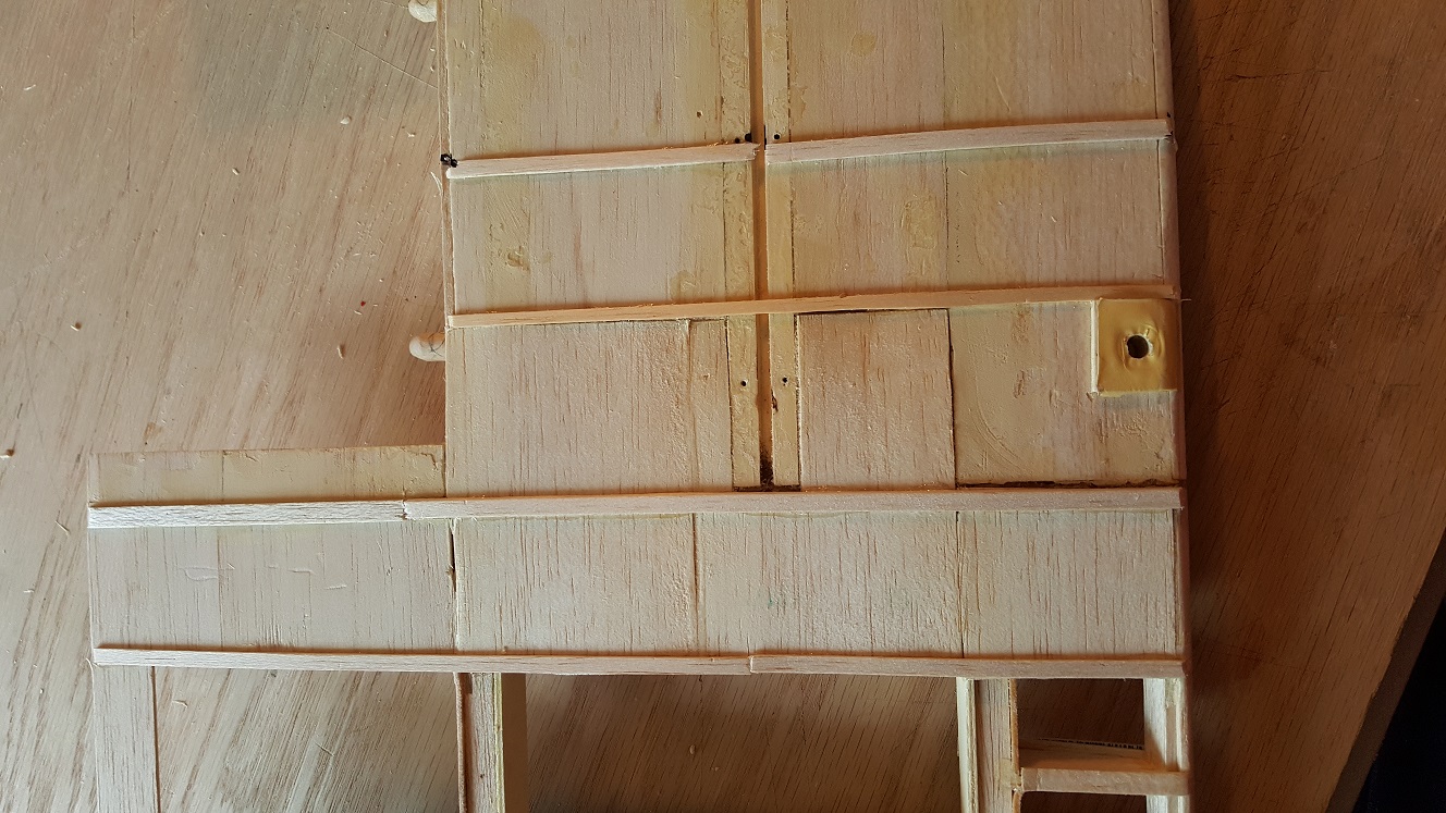

I have parts coming from BUSA, Tower, and Agape Racing & Hobby. While I'm waiting I thought I would work on the bottom wing. The left lower wing panel basically separated from the center section and broke the plywood dihethral braces so I rejoined the two, sistered up some hardwood, and then replaced the sheeting. The right lower panel is not complete as part of it is scattered over Mercer County, New Jersey. I'll replace and rejoin that side when the parts come in from BUSA. The right lower wing tip was the only one damaged and was easily repaired and recovered. The parts to repair the engine have been ordered from Agape Racing and Hobby and cost me less than $35. Everything is moving along nicely. Life is good!

Albert S, Thank you for your suggestion about the links on the tail. I will look into it. As my Camel has done its static display thing and won me a nice prize and plaque, I plan on moving the engine forward to help with the balance situation. I know it wont be scale anymore but I'd rather have a good flying model than a bad flying scale model. I'll play with the engine once everything's back together.

Posts: 263
From: Roseville, MN
I thought the quick links on the tail were to big and didn't look scale for the size of the model so I changed them Then we got into the weight thing and decided that we helped the problem by not using links I think the tail is strong enough without bracing Get it back in the air its a nice flying model !!
