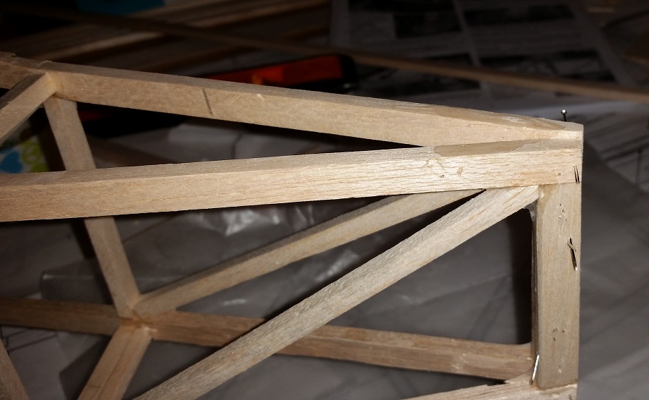

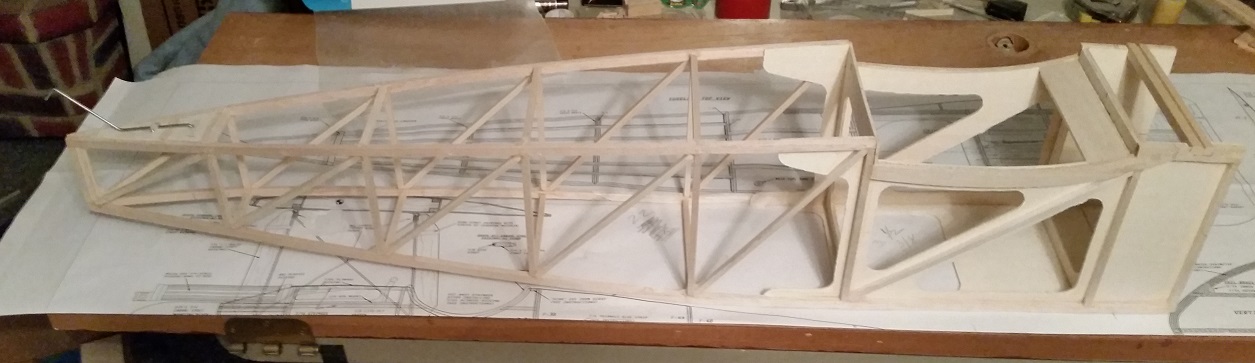

Todays progress has the basic fuselage box built. You start by building two of the stick built fuselage sides and when they're done, pin them together at the wing saddles to make sure they're identical and if they're not, "Make It So"! I left them pinned together while I prepared formers F2 and F3. The top fuselage crutch is pinned down to the table and F2 and F3 are glued to it making sure they are square with the crutch. Now is when the stick built fuselage sides are glued onto the plywood fuselage sides but it seems they're glued together. Thankfully they came apart with a little help from my Xacto knife. I told you I was going to mess up, didn't I? Ok, fuselage sides are complete and they're identical so they now get glued to the fuselage top crutch and you end up with something like the photo above. The basic box is now complete. Now is the time to make sure your basic fuselage is straight, square, plumb, and level because if it's not, your problems will quickly compound themselves.
I've inhaled enough glue fumes for today so we'll pick up the build tomorrow and mess up something new. "On the first of December my true love gave to me, nail polish remover to get this glue off my hands". Ba dump, dump, dump.
Name:	029 12-01-14.jpg
Old 12-01-2014 | 02:56 PM
  #52
Joined: Apr 2006
Posts: 263
From: Philadelphia, PA

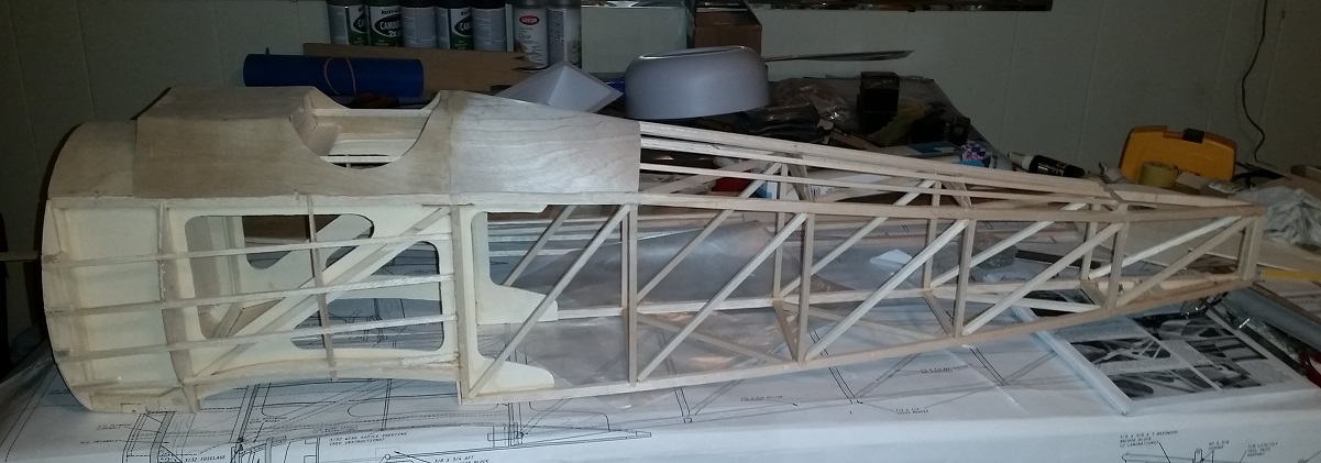

Here's the basic fuselage structure I finished today. I'll mess it up more tomorrow.

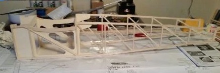

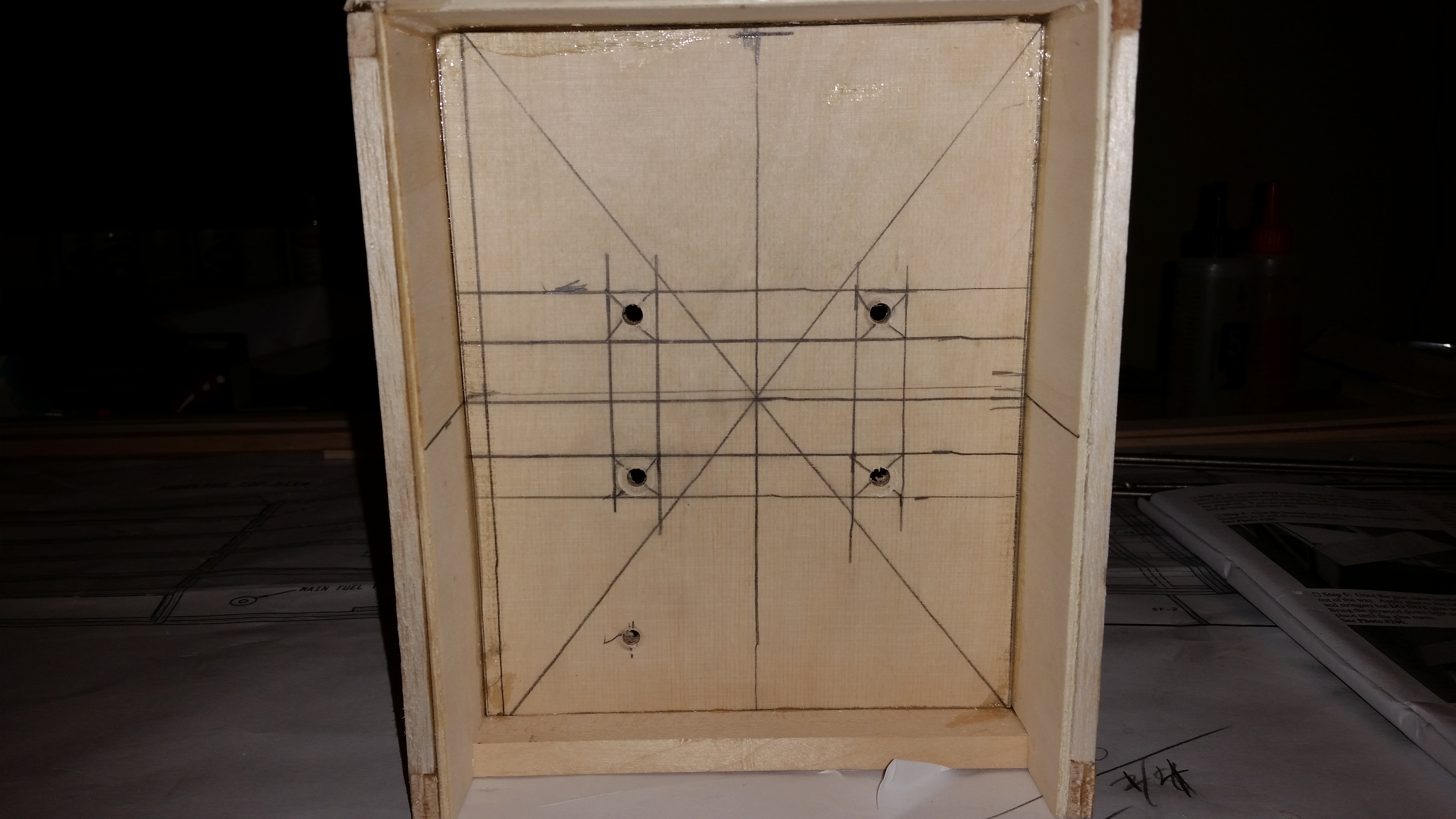

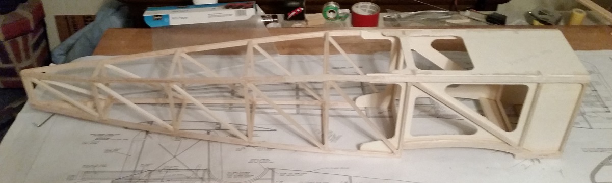

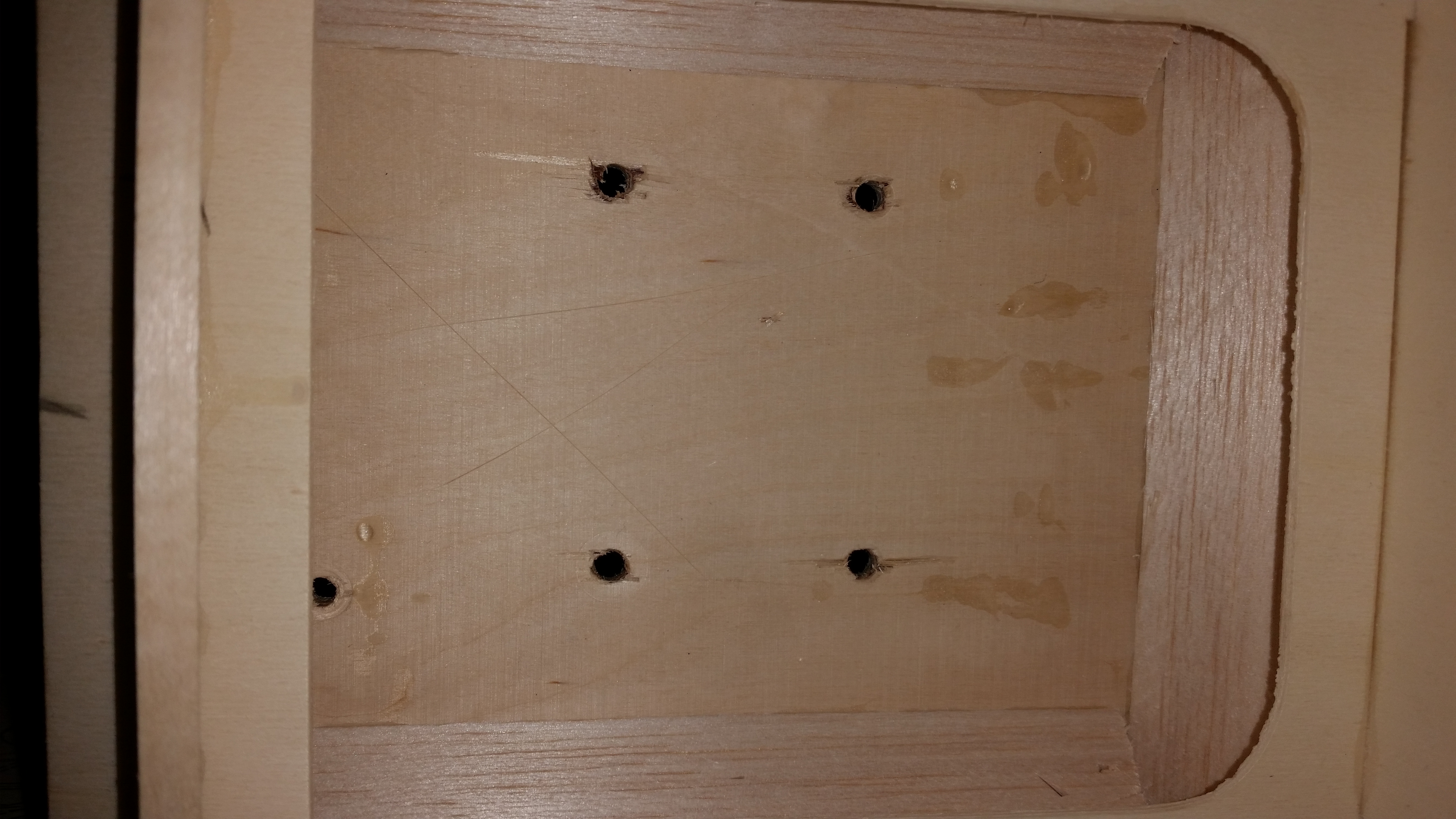

It's December 2, 2014 and before we get to the build, it's tool time. Picture #1 is the set of drill bits I usually use and they're too old. My point is if you can't remember when you got your drill bits then you probably need new ones. They're not expensive, make a great stocking stuffer, and it's 22 days until fat ass in the red suit shows up so put your request in. Now, on to the build.
Pictures #2 to #5 are of the completed fuselage box with the tail skid, wing mounting plate, and the forward landing gear mount installed. Great care has been taken to insure everything is straight, level, square, and plumb. Everything has been rough sanded and is ready for tomorrow's step which will be installing the firewall and mounting the engine. Tune in tomorrow for our next exciting chapter!

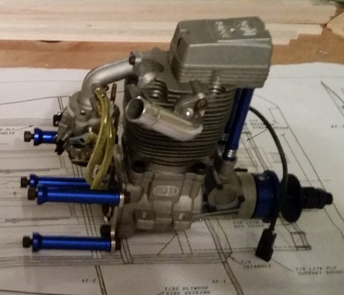

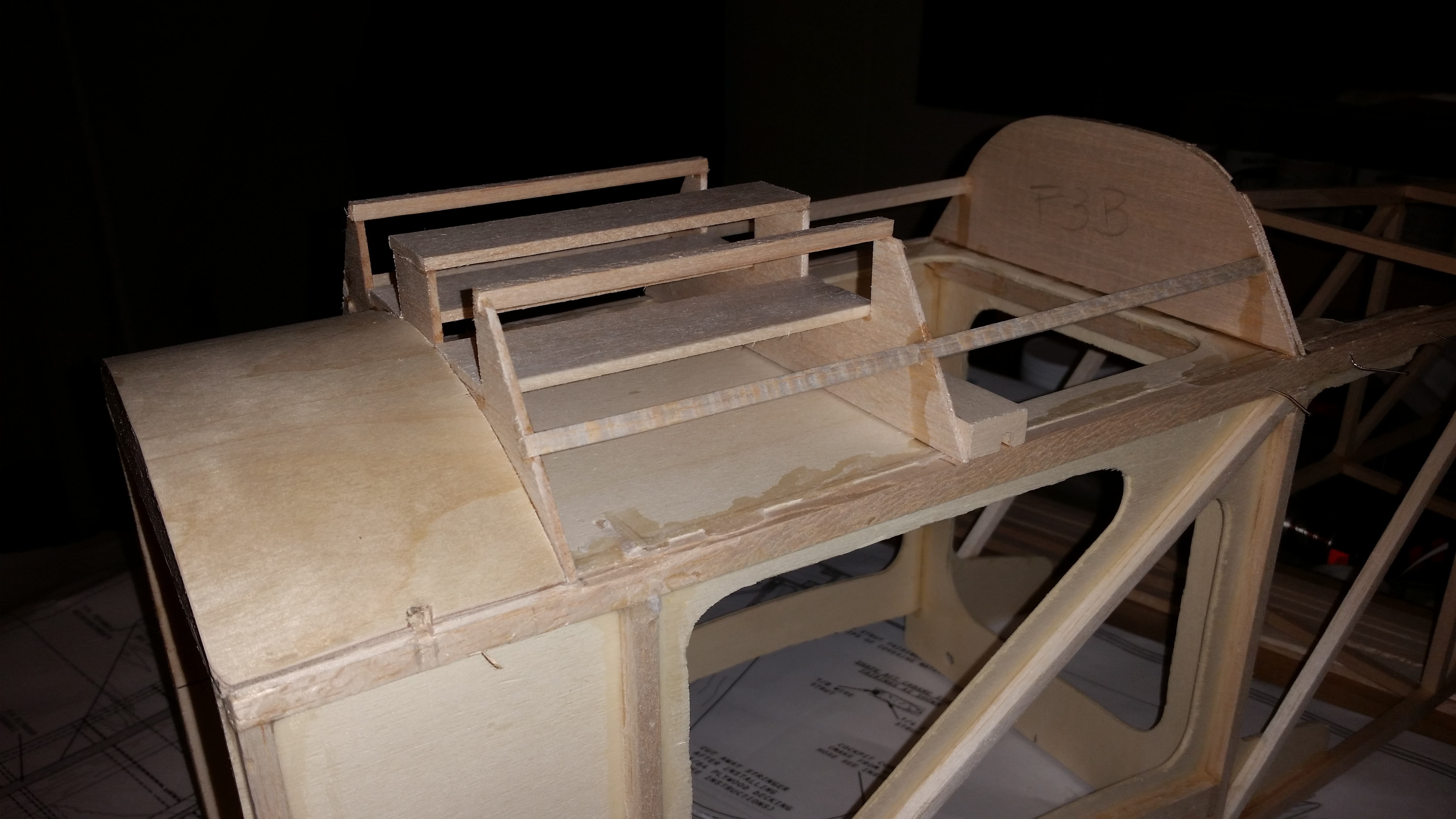

Happy December 3, 2014. I started my day having an ingrown toenail being taken care of, eating breakfast at Nifty Fifties, and spending money at Harbor Freight for tools and the dollar store for Christmas candy. Yay.

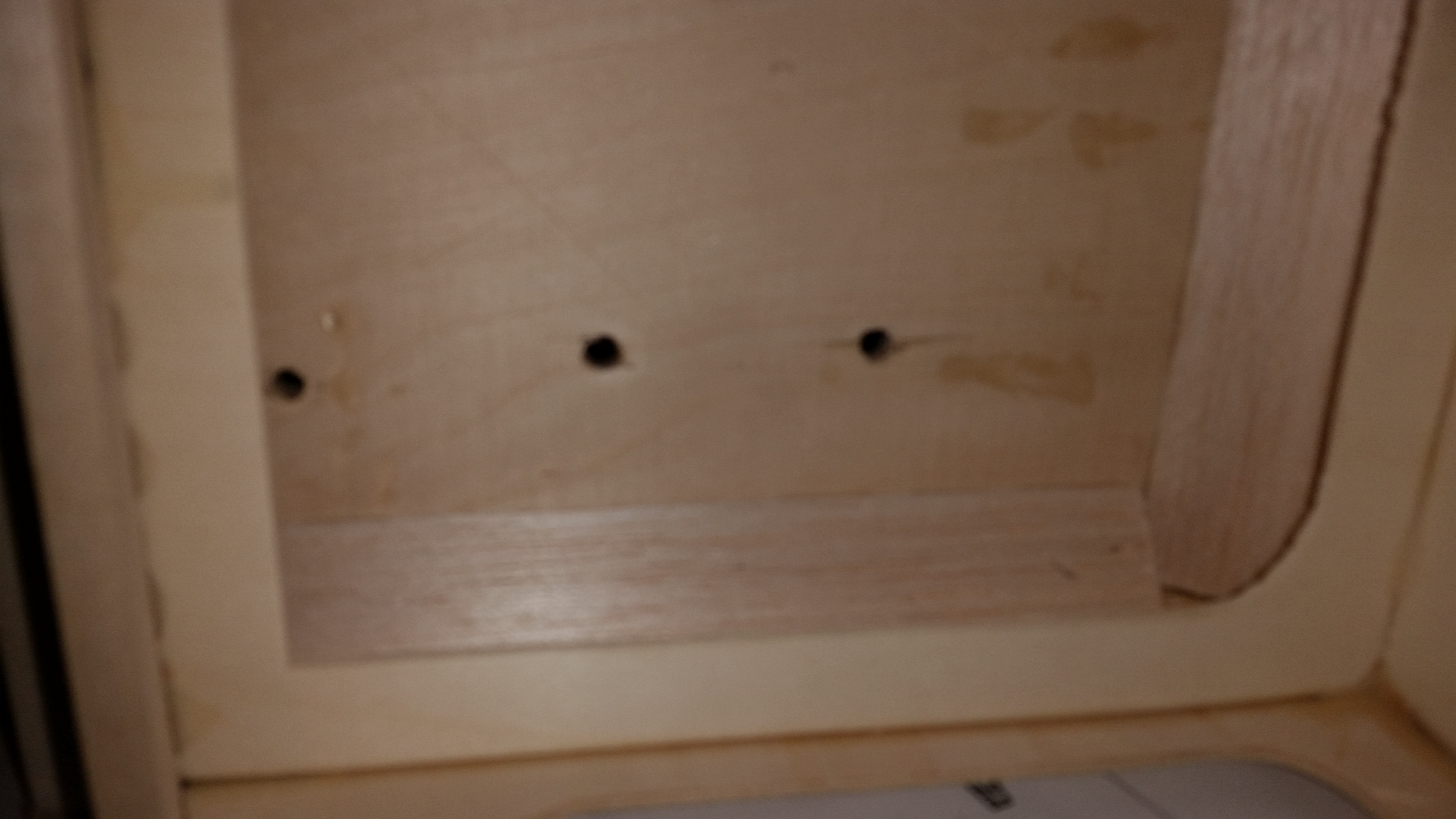

Pictures #1 and 2 are of the infamous NGH 38cc gas four stroke that will power the beast. It's all assembled and ready for installation. Pictures #3, 4, and 5 show the firewall that's been mapped out for the engine mounts and installed in the fuselage. It's been installed so that the propellor will be about an inch from the cowl for plenty of prop clearance. It's also been installed with the bottom recessed 1/8" more than the top. I like to build my downthrust into the model. I'll take care of the right thrust with washers.

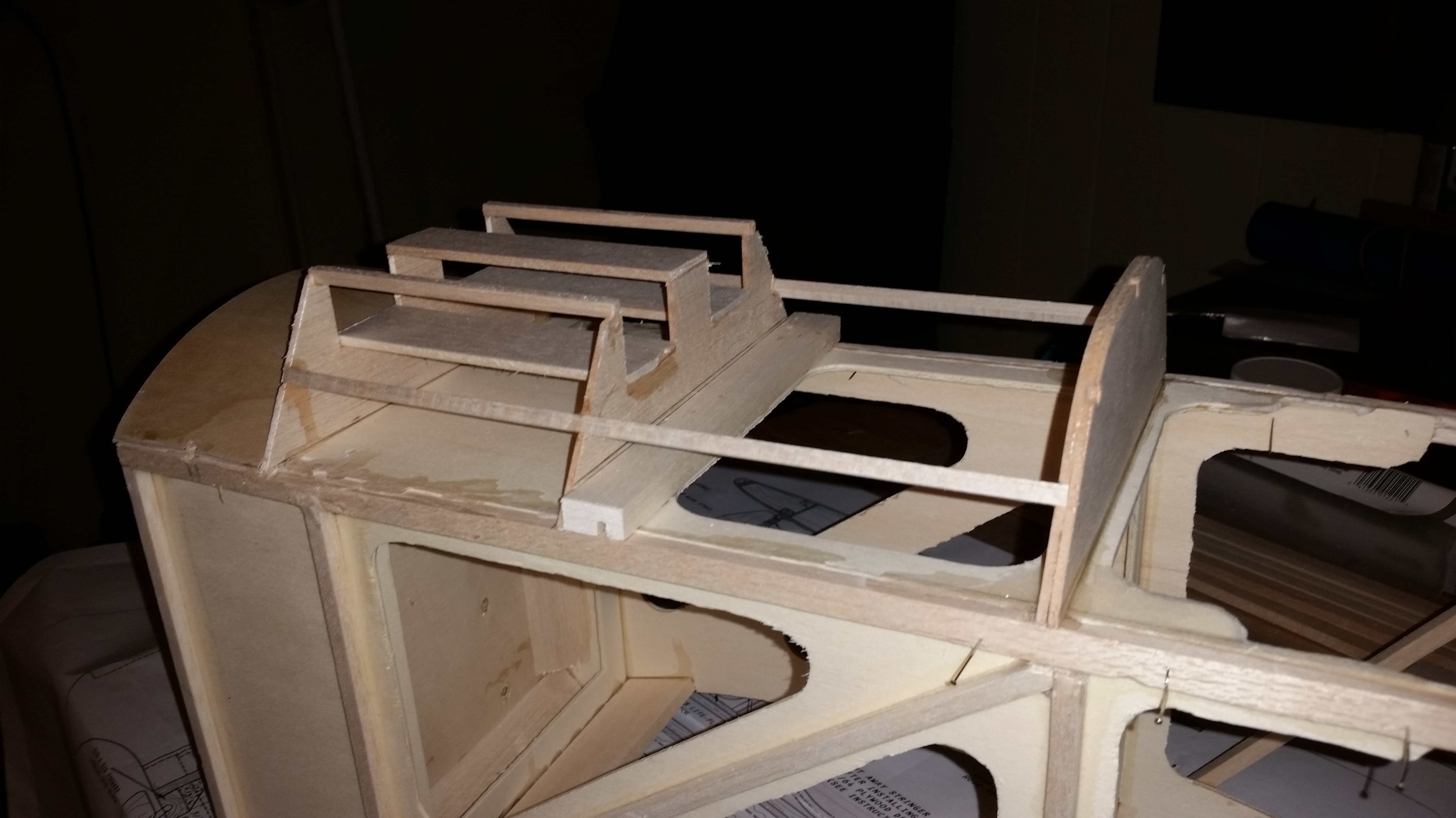

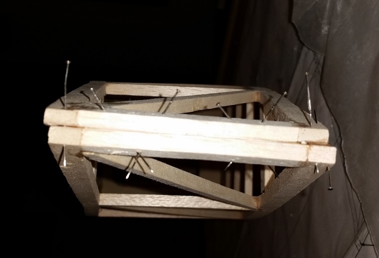

Pictures #6 and 7 show the building of the front deck which is made from two formers, stringers, and the forward cabane mount. Just make sure everything is centered and square. BTW, guess what day it is? It's Hump Dayyyyyyyyyyyyyyyyyyyyyyyyyyyyyyyyyyyyyyyyyyyyyyyy y! Pictures #8 thru 13 show the construction of the "hump" substructure. Tomorrow I'll install the cockpit outer skin. Can't wait can you? Tune in tomorrow for our next chapter of "The Mad Doctor Builds An Airplane". Until then, keep on glueing!

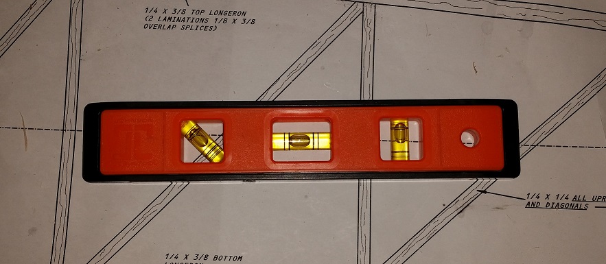

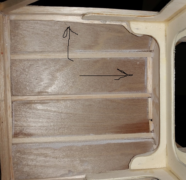

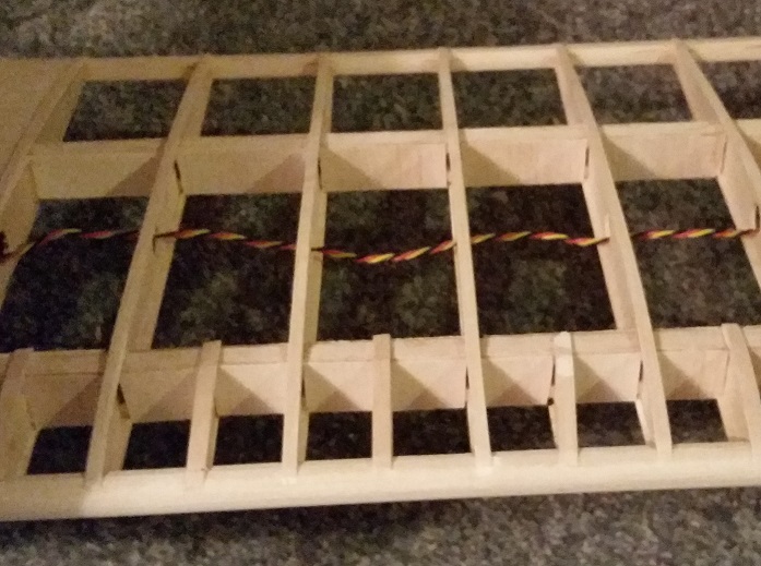

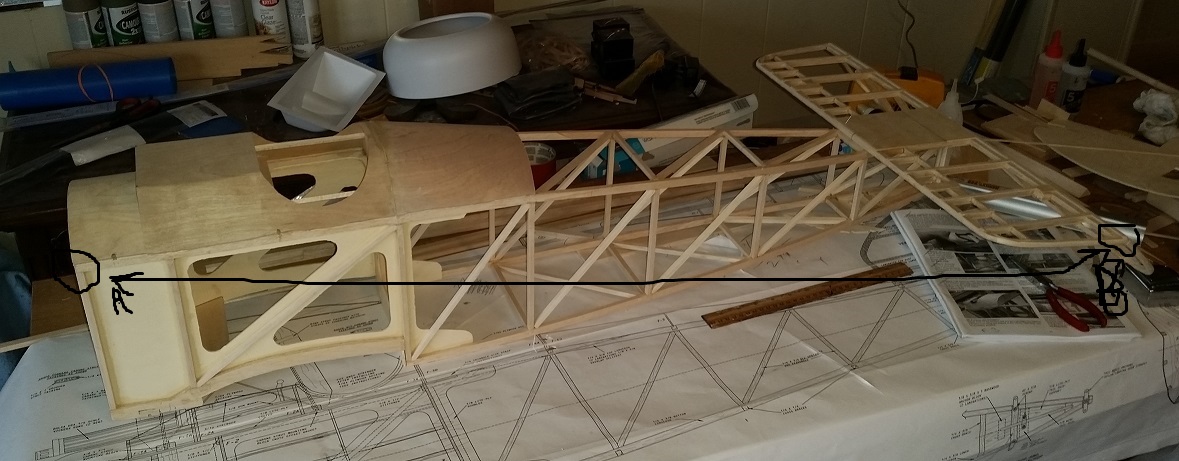

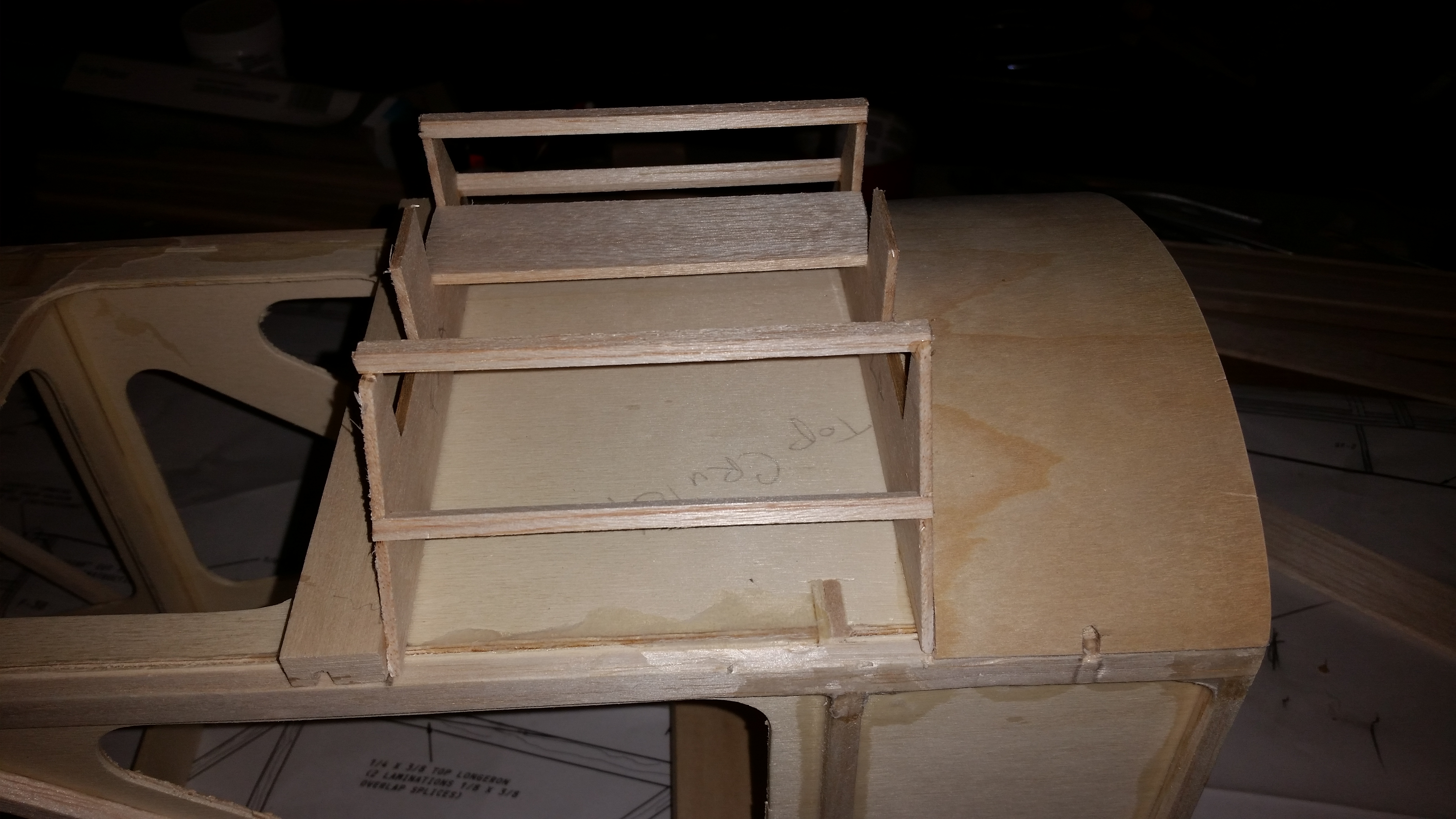

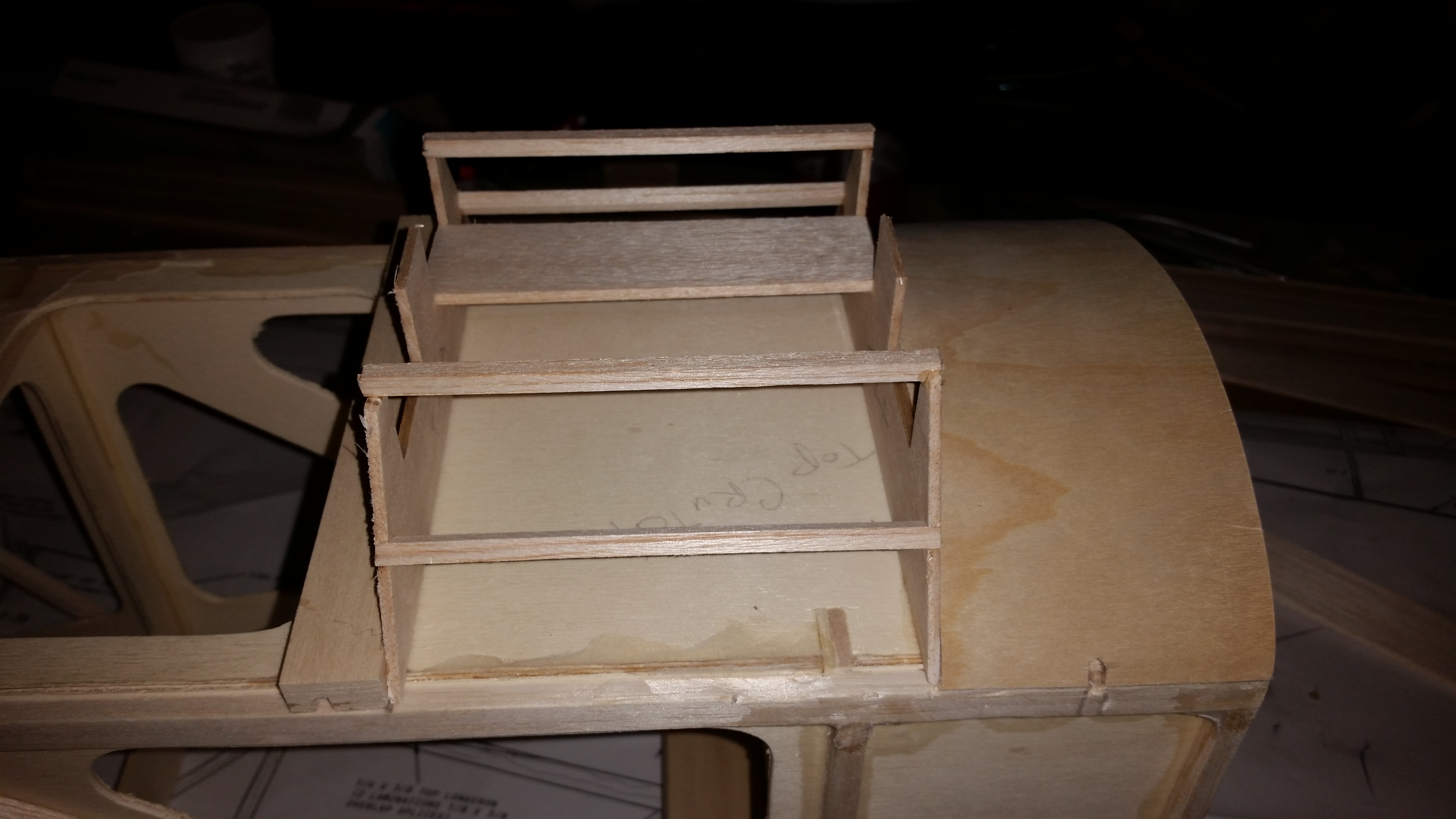

Howdy. Today we made more progress on "The Hump". The forward and rear decking veneer (photo #1) has been installed around the cockpit. Great pains have been taken to keep this stuff from being messed up as I plan on staining it rather than paint or covering. Keep that in mind when working with the veneer. Photo #2 show the underside of the rear decking. I had to add some wood to the F4 former so I would have something to glue the veneer to. It's nothing more than scrap balsa that has been glued on and then cut to shape.
Photo #3 is of a torpedo level that you can buy for cheap just about anywhere. While looking at the rear of my fuselage, I realized I had a twist at the end which would cause all sorts of problems in the near future and now's the time to fix it. Photos #4 and 5 show just how much this bugger was off. Utilizing my level at the forward edge of "The Hump", the rear edge of of "The Hump", and my stab saddle, I now get the same level reading and we can move forward tomorrow. The sermon is ended. Glue in peace.

Thanks for the photos. I had looked up the engine and they only showed photos from an angle that didn't show the carb. Very impressive looking. Can't wait for a full flight report on it.

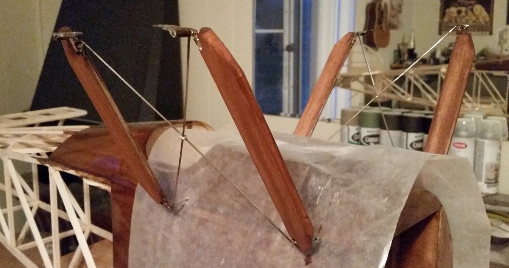

Captain Chicken here. I found out I don't know how to solder so I wired up my cabanes and coated the joints with J B Weld. I know it ain't pretty but it does work. Perhaps one day I will learn to solder.

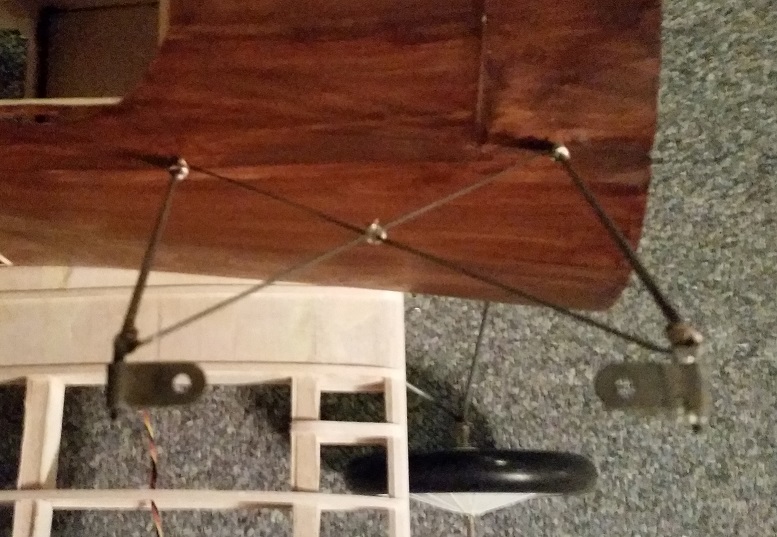

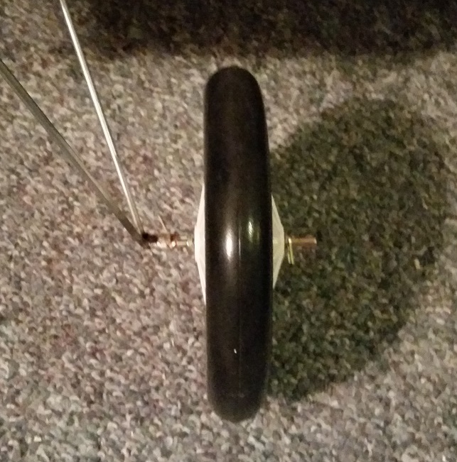

Greetings Fellow Balsa Bashers! The Doctor is in! I tried to build my cabanes using J B Weld but it would not hold so I went to one of our club members and got a quick lesson on how to solder (thank you Ed). Photo #1 show the right cabane completed and installed with the cross braces also installed. The setup of these is very important as this determines the incidence on the top wing. The next step will be to install the top wing, make the struts, and their cross braces. Photo #2 show the landing gear installed with the two sections soldered together, the brass axle soldered on, the wheel attached, and the brass axle drilled through to accept the 1/16" cotter pin. The wheels spin freely but without noise which is what you want. Photo #3 shows the bottom wing with all of its cap stripping installed and there were many to be attached. They have also been attached to the top wing (not shown). Both wings will get one last sanding and they'll be ready for covering. Photo #4 shows our progress to date. It's starting to look like an airplane. Now for the sermon.
Little jobs like soldering aren't hard to do so long as you have the proper tools. The axle assembly was soldered together using a propane torch in a process called sweating. You've probably seen a plumber do this. It's not hard but it takes practice and perseverance. The solder lugs and the cross braces on the cabanes were assembled using an 80 watt soldering iron. You can't use a torch as you would set the airplane on fire and don't think you can use a Hobbico soldering iron or one you'll pick up in Radio Shack, Home Depot, or Lowes. At best, these are 20-25 watts. Remember, the right tool for the right job. My friend Ed used an 80 watt iron and that's probably the lowest you would want. You need as wide a tip as you can get. And, speaking of my friend Ed, here's our next topic. Friends and clubs.
Join a club and make friends. There's a saying that nobody is smarter than all of us. If you join a club you will find a wealth of knowledge, experience, and people who are more than willing to help out the new guy in building or flying his plane. My club holds events at our field, how to do it seminars at our meetings, and we travel near and far to show our skills (or lack of) at other flying field and at small and major air shows. I had the privilige to fly at the open house at McGuire AFB in Wrightstown, NJ last May. The USAF gave me and another club member our own private rooms in the on base hotel which is used by transient officers. This place was on par with any of the best hotels I've ever stayed in and the kicker was that we were on the same wing as the Army Golden Knights and the USAF Thunderbirds. They were really nice people. This wouldn't have happened without my club affiliation. And, our members and their families are more like extended family than just a bunch of guys I fly airplanes with. So, join a club and learn to things the right way. The sermon is ended, solder your pieces together in peace.

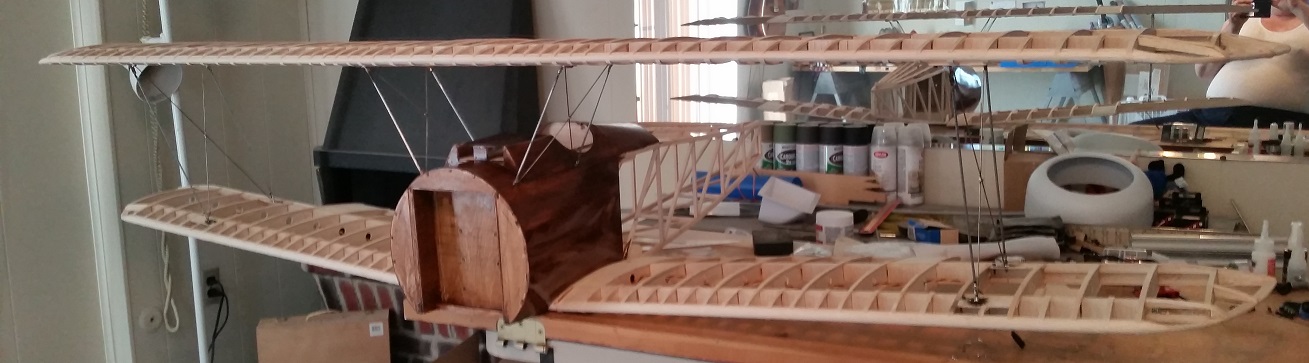

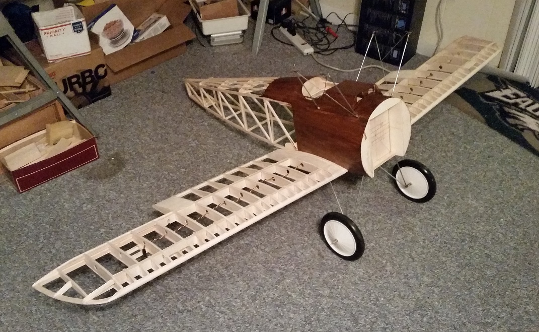

Photo #1 shows the cabanes installed as well as the upper and lower wings. If I did it right, this thing may actually be able to fly. I learned how to do the solder joints (photo #2) and now I need to learn how to not completely cook them. I'm told the secret is to remove the heat when the flux is boiling and the solder is melting and running. How do you get to Carnegie Hall? Practice! Photo #3 shows the cabanes and the wonderful job Ed did soldering. Thanks Ed. Photo #4 is of the natural wood finish on the fuselage front and sides. I used Minwax polyurethane with stain in it. This is coat three so they're done. I learned the fine art of woodgraining many years ago and the secret is to make multiple thin coats so it doesn't run all over the place. Keep checking it within the first hour and brush out any runs you may have acquired. Just remember to brush in one direction and for the length of the wood. This will get a thin coat of clear gloss just before the covering is done. This is going to look great.
Tune in tomorrow when I attempt to screw up something else.

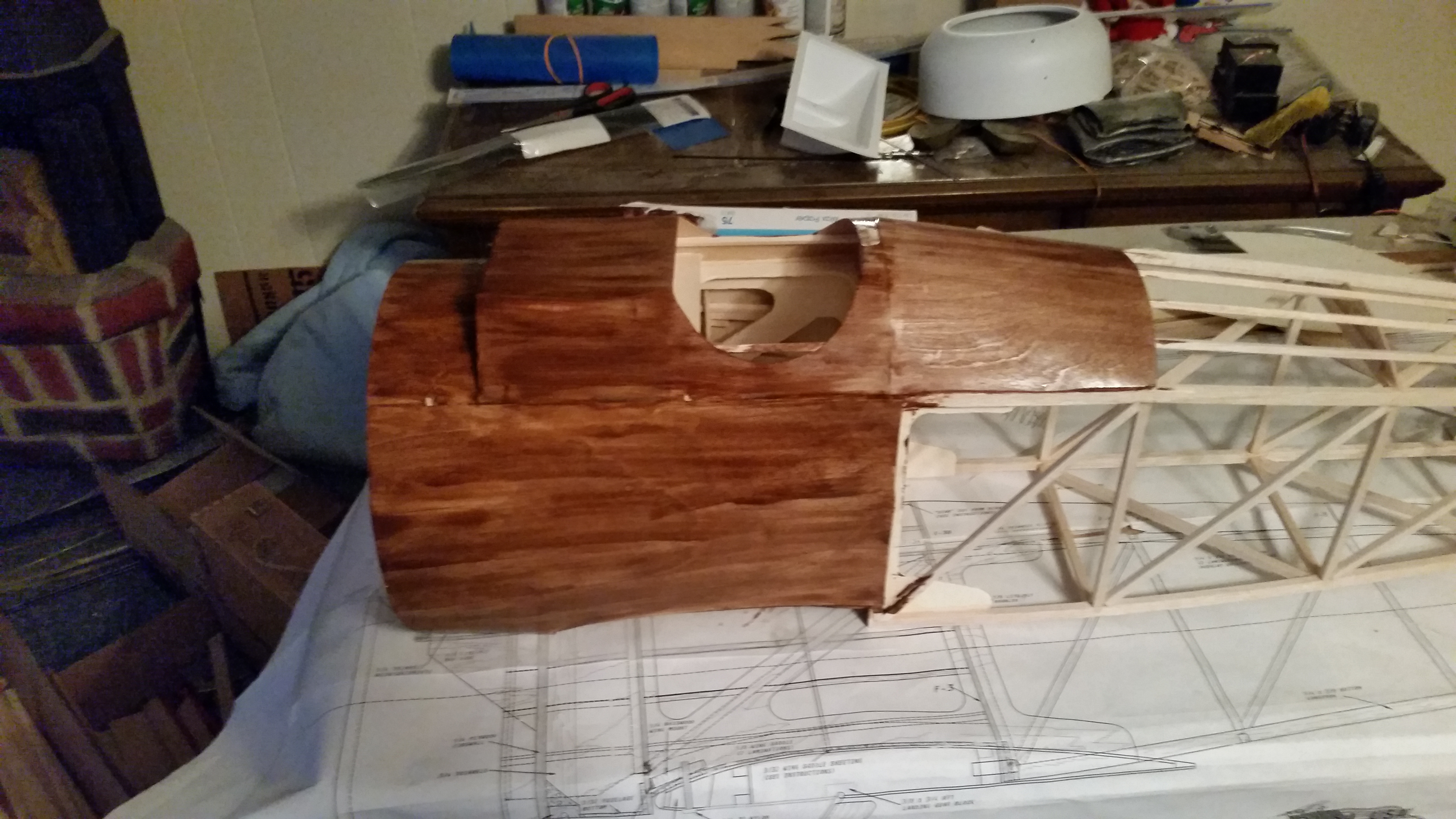

You should stain all the wood and put clear material over it - that would look unique............

That's a great idea. Where do I buy this clear fabric to iron onto my plane?

The stain does look great...........
