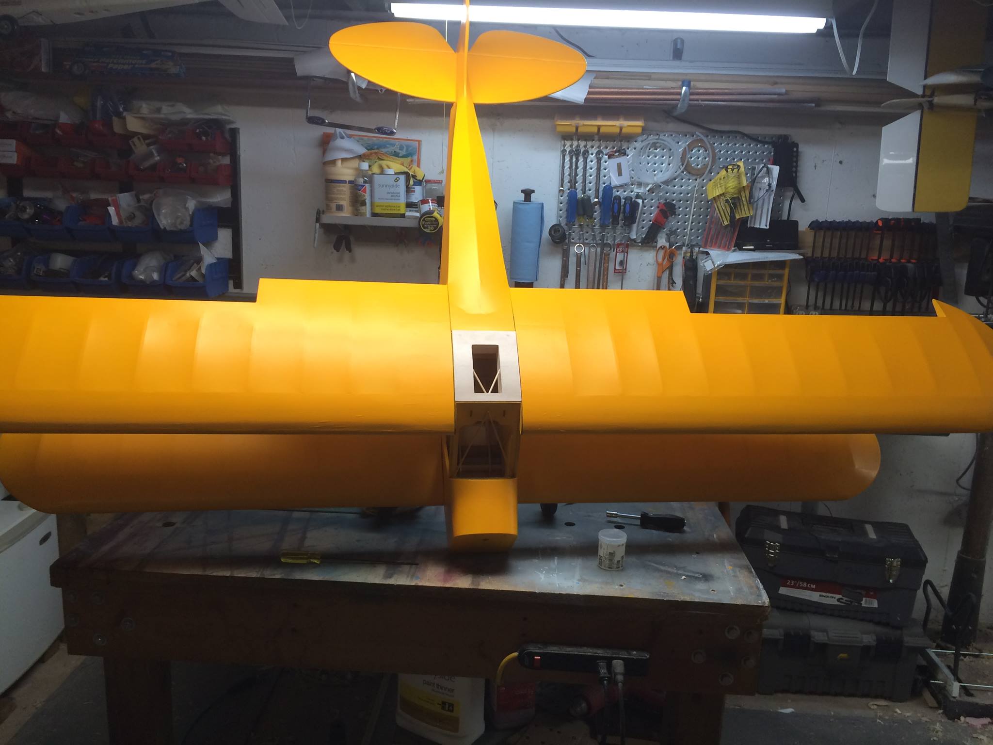

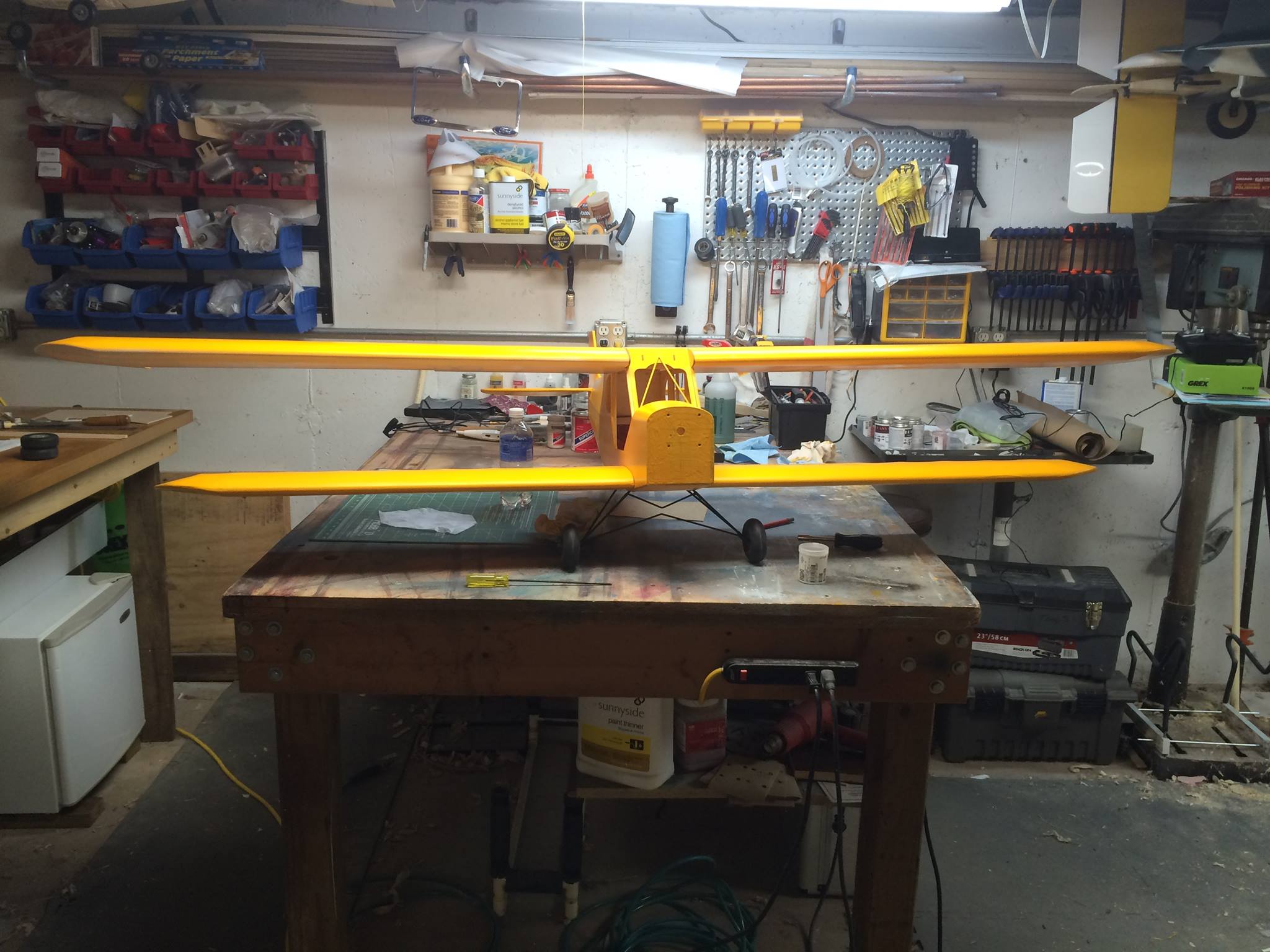

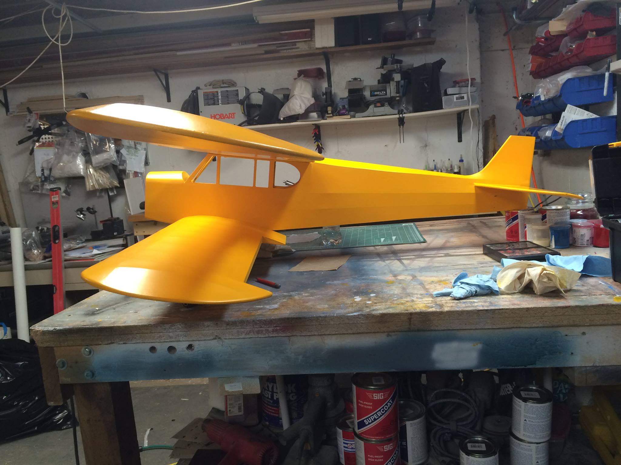

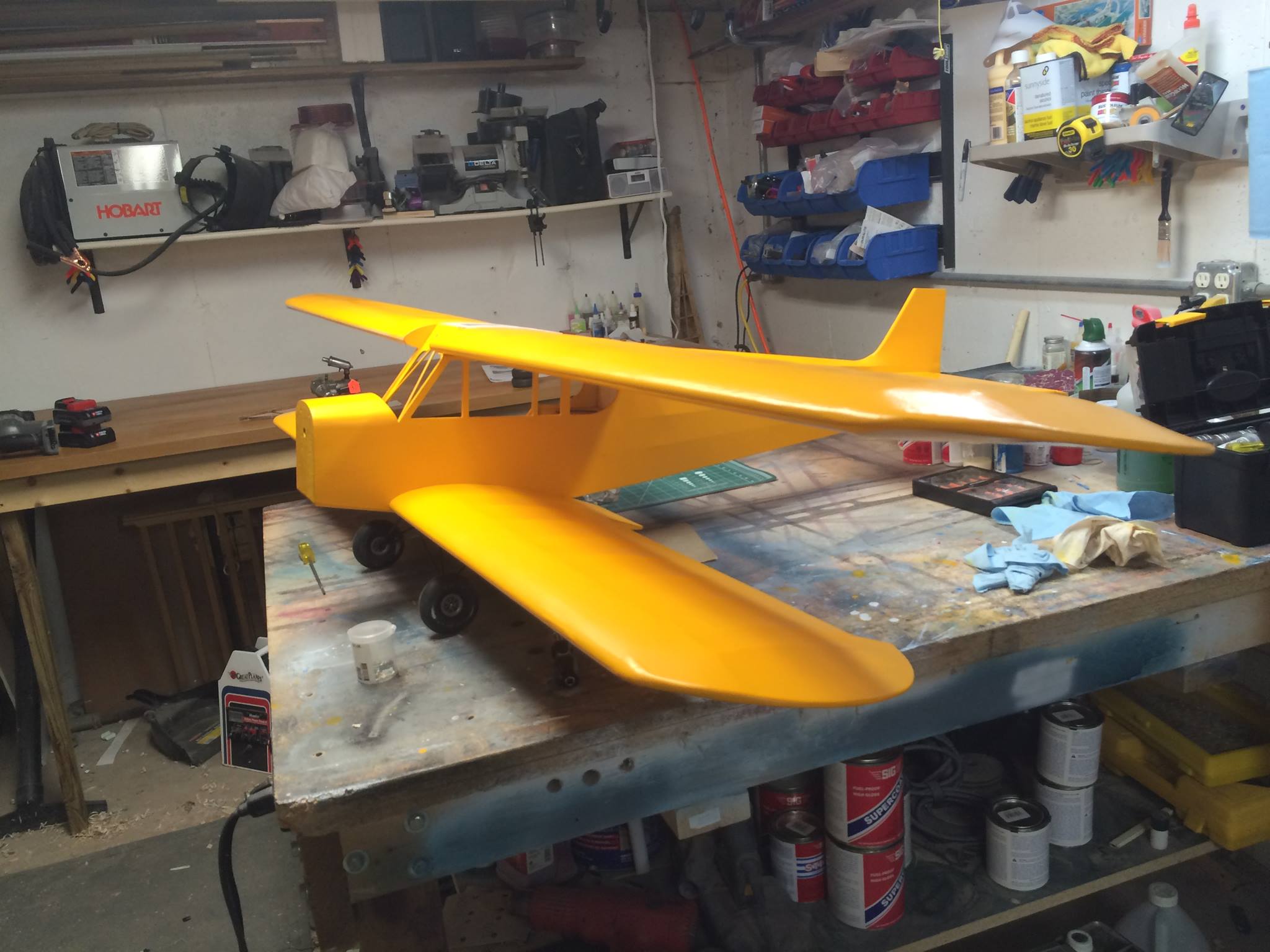

Well, I got a job so work slowed to a crawl, and I ran out of dope so had to get some more. It came the other day so all set to finish. Wings need a final coat, need to put a coat of white down on 2 panels and then the top coat, learned too late that yellow does not cover well. Once the wings have the last coat on, then I fit the rudder, door and ailerons and get them covered and painted, paint the struts, make the end wing joining struts and paint them, then its on to the gear and have it ready for its maiden. My goal is to have the maiden done by June 1st so I can fly it at the SIG flyin this year. I was going to run an OS-70FS, but found a fairly new Saito 100, so have to redo the mount, but since my other Cub has the same engine, I just have to mirror that setup, which means the cowl will be Easy!

Maiden flight on the regular Cub went well, flew great, so hopes are high this one will too.
