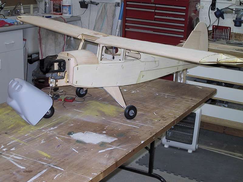

I bought the aluminum at Lowe's--in the roofing section. Comes in 10' rolls so I figure I can make a few more cowls for the 6 or 7 bucks I invested. Best part is that I was able to cut it neatly with some cheap scissors from Harbor Freight. If you have a wife that sews you could borrow her Fiskars to do the cut out. Be sure and put them back when you are finished Just a tip.

Oh my, oh my! The pressure is on. Yet one more beautiful plane rolls out to the runway. Well done Ladd! I love the pait job too, it really suits the plane. Was it from a full size plane, or something you dreamed up yourself?

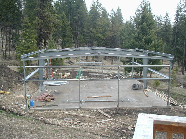

MegaMang, Oh gosh, by all means finish and fly her. I am rebuilding the broken fuselage and it's slow going. I need to take a trip into Spokane for some material and then recover and paint. With the work I have been doing on the garage the plane has slowed to a crawl. If you wait for me you may run out of summer. I have so much work to do here in the good weather my building has to take a back seat to the upkeep here at the "Ranch"

If I don't wait for you to finish, what other excuses can I use for my lazyness? BTW, I'm impressed and totally jealous of your garage already!
Ken, you guys are going to have to design a 20' wingspan plane so wascamp can justify the size of his shop!

Ken, you dont' have to rush the 20 foot span, the doors are only 10 ft wide. And before you get to envious, MegaMang let me say that most of the garage will be dedicated to vehicle storage. With two pickups, a Durango, the tractor and two small boats I will only have a 12 by 20 foot shop. With woodworking and automotive tool storage that cuts the airplane area down to less than the room I now use in the basement. The only advantage of moving out to the garage is that I can paint and dope in peace. As it is now I have to wait for the wife to clear out before I crack the dope can. I do have an 8 ft span quarter scale ultra lite in the planning stages so my work bench will have to be built accordingly.
One thing I know about house renovations is that they never end. There is always something that just must be done to make the place better. Our last place was under renovation with one project or another for eight years. I finished every project and had to sell it before my wife found something else for me to "IMPROVE" I guess that is the down side of being Handy.

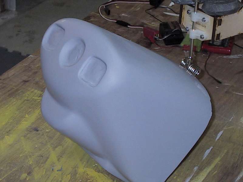

Well it's been awhile so I thought I would update the group as to the progress of my build and the plug for my cowl. I've finished the wing and the fuse is on wheels, just trying to setup the mechanicals and the work out the fuel tank placement. One question that I do have for those that have started and or flown their bird. The stacked 3/8 balsa for the firewall build up. Is this of sufficient strength to carry the vibration and weight of an 70 FS? I'm a little concerned and if you look close at the pictures I have currently bolted the firewall to the front former (for ease of access to the inner fuse for tank install etc.) and I'm not sure if I will leave the bolts in with epoxy or just epoxy and hardwood dowls in place of the bolts once I get the mechanicals worked out. Anyway here are some pics for all to peruse. The plug has had finishing polish done and is currently in it's first coat of parting wax, about five more coats of wax and some mold release and I should be ready to layup the glass to make the mold.
Mahalo
Daryl B.
PS. I don't think I will make my original deadline for the cowl prior to my vacation (to many Honey Dos and not enough flyin and fishin) but there always after vacation.

I did email all of them, looking for a cowl and only got a response from Stan's Fibertech. He asked what size the firewall is. I responded with the size and scanned image of the firewall and thats the last I heard from them.
The plug is the greatest amount of labour, once thats done its a simple matter of making the mold from it and then the best part begins. I get to see what an actual part looks like from the mold. I would guess that the glass part producers are waiting to see what the market will require prior to making a commitment to produce. This is my first attempt at making a mold for a cowl, prior to this I've always used the lost foam method for one offs. I was due for a learning expierience, so I thought I would bite this one off and maybe help out some fellow builders in the process.
