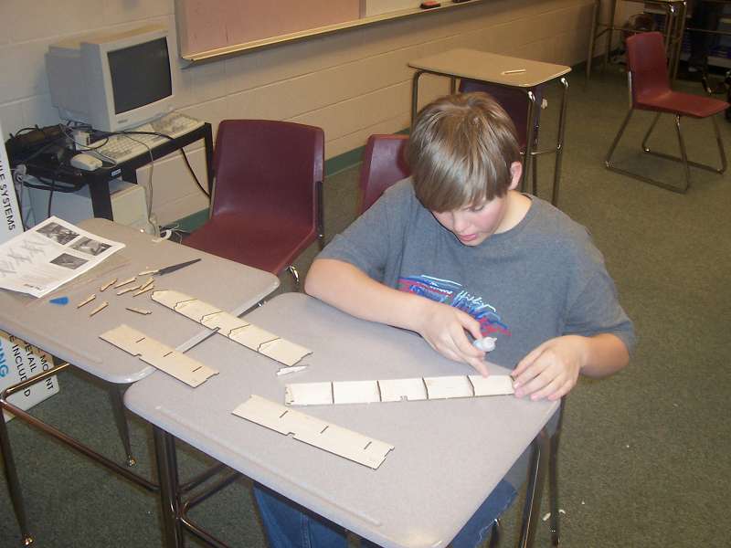

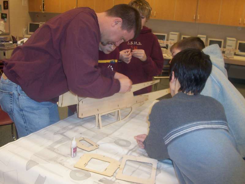

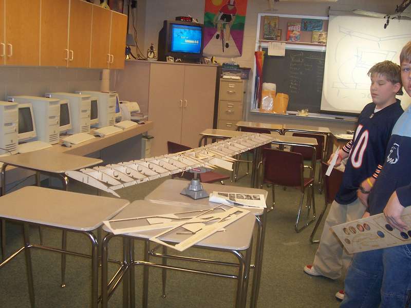

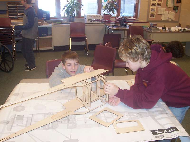

Good day building today with the kids. You mentioned 8th graders, unfortunately they are all seventh graders. Only experience in the room is one kid who's brother I taught to build and then later taught to fly his own trainer. Out of the 70 kids I have building 4 planes a year, a handful (maybe 4 or 5) actually ever get their own plane. Last year I gave an RV-4 to one of the kids because it had two hard landings and I was tired of it. Turns out the motor needed a new bearing. But that kid actually has 4 planes now. Best story is a kid who is now attending Purdue for aviation
He actually did his Science fair on the pitches of different props. Back to the build. On page 18, the lower picture shows a former that is not yet installed while #4 is being installed. Correct. One of my guys tack glued some CA on the outside to give the wood glue time to bond.
Spent quite a bit of time sanding when the class left. Thank you for the tip on the 1/4 square pieces. I'm going to chase a few pieces at the hobby shop tomorrow for the fuse group. Please tell me where I can find that part about the windows not being glued solid? I believe you, I just can't find it. I am a little worried I might make the same mistake later somewhere else. One kid today built part of the flaps and ailerons, then he became a photographer. Photos this evening

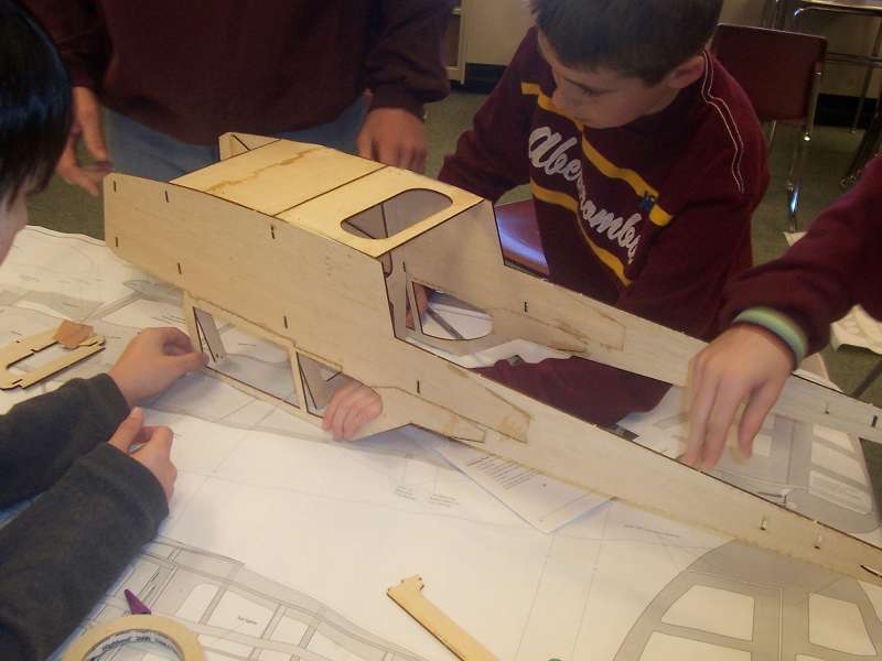

Mr. Hill,
The instruction for the fuselage sides is found on page 4. Pre-Assembly. Easy to miss. The plans also show the parts that get pre assembly, they are shown 1/4 size and have the areas to be glued and not glued marked out. Sorry about misrepresenting the skill level of the class. The point was to alay any fears that prospective builders of this kit might have. The fact that your group is made up entirely of novice 13 yearolds should prove how well designed and thoughtout this plane is. All of us make mistakes from time to time, the benifit of this is that we learn to fix things that we goof up. I think any novice builder who finds an experianced mentor at his local club will be able to build this kit without much trouble. It is not as demanding as, say, a Sig Senior. or 1/5 th cub.

No problem with the skill level. I'm just real proud of fact that my builders are 12 going on 13. I hope my tone did not come across negative. You were right about page 4. I have a few more days to figure out what to do. I could cut some relief or hit it with some deponder. What are your thoughts. This plane consumes much of my thoughts. In my head I am already covering this plane. Do you think that I can make that ridge in the fuse look right without dope? Going home now to upload some pictures for you. Hope tone was not taken wrong on grade level. I never flew a plane until I was 31, they get their first shot at 13! Kids today are so spoiled. I don't think they know it sometimes.

No, I knew what you ment. The fact that they are noviates is great. I would try to free up the bottom of the window frame part. Debonder might be the best bet. mine was glued per the instructions and even then the wood protested when bent. You might try a little water and amonia on the joint to soften it befor you try to form it to the top. It pulls in at the rear and should be softened a little.
Are you talking about the cabin top with referance to cover? It will cover just fine, you might need to use a little balsarite on it to stick the cover on as you pull the cover over the contours. Ken used plastic on his and it looks super. Post your fotos, I am waiting for them.

Well here is my first attempt to post pics. Thanks for the assistance. One pic is of the student who worked on the flaps and ailerons and then turned into a photographer. I really like the personal service offered by Ken. My missing parts were shipped out today. I will post more pics as we go, the kids are as excited about the RC Forum as they are the build. We DROP, STOP AND READ every morning and I have considered printing these pages off for the kids to read.

Pretty exciting for a rookie to the forum. I can only load one pic at a time from my home computer. Here are the rest of the pics taken today. None of these pictures are going to be attempts to be as descriptive and as helpful as Roger. We just want to be a part of this great thread on what we hope will turn out to be a great plane. One of the pics is the wing in the vise, the fuse (and the premature glued pieces) and two other kids sizing up the fuse. I have another group on the tail and I need more pics of their work. The one pic shows the wing in a vise. My inlaws bought the vise two years ago for my birthday. It has a suction cup activated bottom and I considered it worthless on my particle board shelves in my garage/shop. Now in my classroom it is worth its weight in gold!

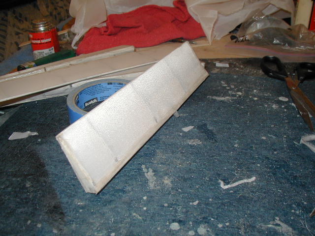

Well, No use crying over spilled milk or Nitrate dope. My wife was gone today so I started the recover job. After I removed the old (brand new) cover I re-sanded the entire structure. The purpose is to get it as smooth as possable. This sanded off all old dope so it was necessary to paint 2 coats of unthined dope on the areas where the new fabric will be attached. I covered the flaps and ailerons because they are small and I could use the leftovers from the first covering.

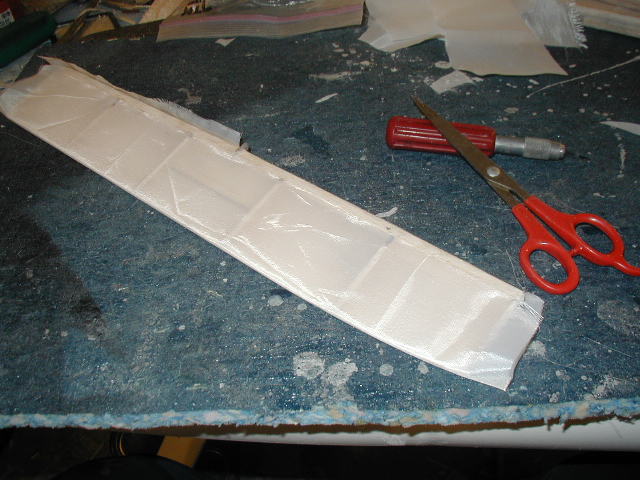

The first photo shows the precut fabric dobed to the leading edge of the flap. I cut a slot in the cloth where the control horn comes through the leading edge spar. the cloth is doped over the spar and across the top. Allow the dope to set up. The tecnique I use is to wet the wood, apply the fabric and then wet out the fabric. You can use the brush or your fingers to smooth the fabric out from the center.
The second photo shows the fabric pulled aorund the flap and doped to spar. You can leave the material a little long so as grip it and pull out most of the slack. After the dope begins to set you can trim the excess just below top of the spar. On this plane the fabric must be cut to allow the hinges to protrude thru. I make a slice at the hinge at this point and adjust the fabric while the dope is still wet. All of the seam overlap is on the leading edge spar and will not show.
The last shot shows the finished flap after it has been heat shrunk. It is important that the fabric be allowed to move freely during the shrinking process. For this reason the ribs and bottom sheet are not doped. The fabric is secured at the leading edge and on the end ribs. The trailing edge is NOT doped. I ironed the bottom sheet and all the wrinkles came out of both surfaces. The top was ironed to achieve the drum-head tightness I like. This fabric is a medium heat product and it will crush light structures if too much heat is used. If the part starts to creak, back off.
It took about an hour to cover and shrink the flaps and ailerons. Plus a little wait for the dope to dry between operations. I have not changed my opinion of Koverall, I still think it is the best covering I have used. Keep in mind that I have not used all the brands of material available and would like to try some of the Nelson fabric on an upcoming project.

Less than a banner day in the classroom. I could not figure out why our 1/4 x 1/4 pieces would not lay down towards the middle of the wing. Come to find out that I did not have the spine or the ribs on either side pushed all the way down. After many tears, I took the wing home and soaked the doublers with debonder. After some creative prying she came lose. I pieced it all back together and things are looking up.
Then the guys building the rudder glued it to the desk. The wax paper was within reach. I fixed that within a few minutes. Rudder fine
desk has a slight lump of balsa[&o]. Hope to get back on track today. A lot leary of the back section of the fuse. Going to start reading instruction from now until the time that class starts. Nice reCOVERery on your plane.

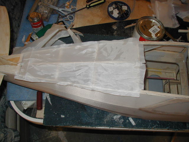

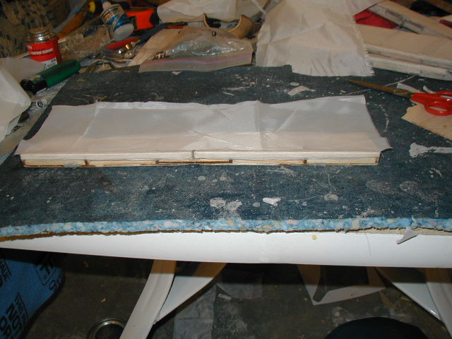

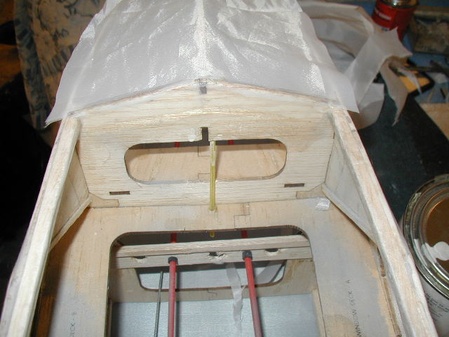

As promised we will cover the fuslage top tonite. Most of the steps involved are the same as covering with film. If you want to put this stuff on with Sig Stickit glue be my guest. In that case it works just like film. Apply the glue and iron down the perimeter using low heat then shrink using a higher heat. I choose to use the dope method which has been used by modlers and real airplane builders since year one!
The Pictures are in the same order as the construction. There will be two posts so keep on reading.

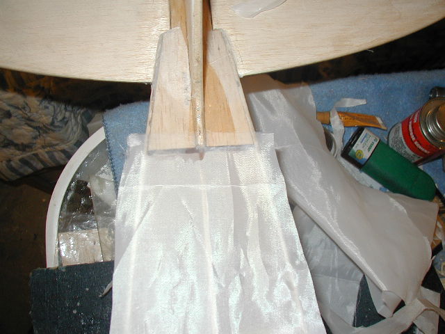

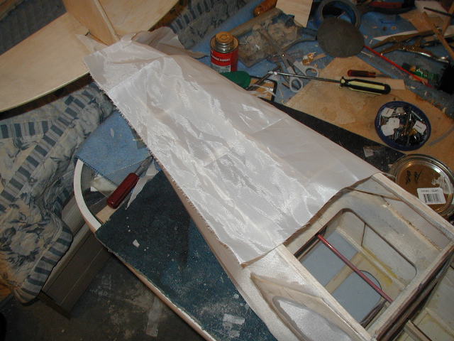

First be sure that the structue has had 2 coats of nitrate dope applied. Try not to thin the dope too much. Unthinned dope is better than thinned but it is a little tough to paint on. Let those coats dry before you cover. Cut a piece of fabric about a half inch bigger in all directions. Try to put the material on so that the finished woven edge runs the long way. Koverall shrinks more in the long direction and this give the best surface. Cut the finished edge off or you will have a nasty seam overlap. (photo 1)
Cut the material around any of the structure where it might lump up. In the secont photo you can see that I notched the fabric where it fits arount the former and the cabin sides. Trim the size so that it has about 1/4 inch for overlap. Apply dope to one end. I wet the area, press the fabric into the new dope and then wet the cloth so it will form and stick down. (photo 2 & 3)
When one end has set up (10 min or so) you can pull the fabric and dope down the other end. Remember that you are only attaching the fabric to the edges of the structure. No dope is applied in the field. The fabric needs to slip and slide as it shrinks. In our case the spine of the fuselage was not doped. (photo 4)
