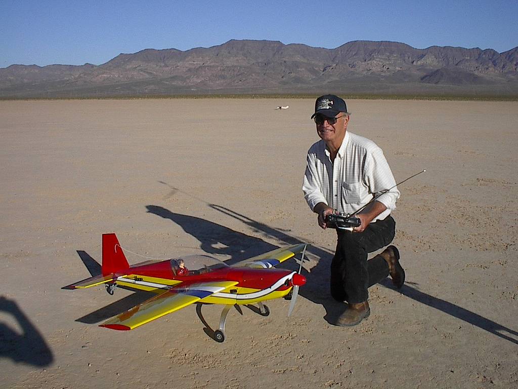

ORIGINAL: Gary L. Sr.
I didn't realize the wee people were back east as well...Why not try a OS 1.08? A proven up-grade!
Finding a good 1.08 is getting hard. Something you don't run into often these days.
This CG is one I built for a friend as a gift, notice the happy face after flying!! The LG is a set that FGS used to sell and it fit correctly. A few pages back it was stated FGS couldn't get them any longer and quit selling them? The ones they had were the wrong size. Too bad, these were very good gear.
