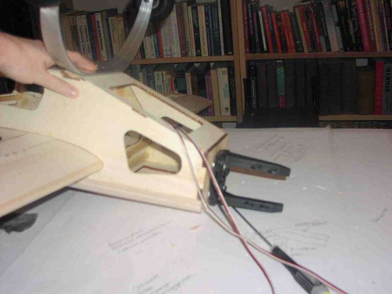

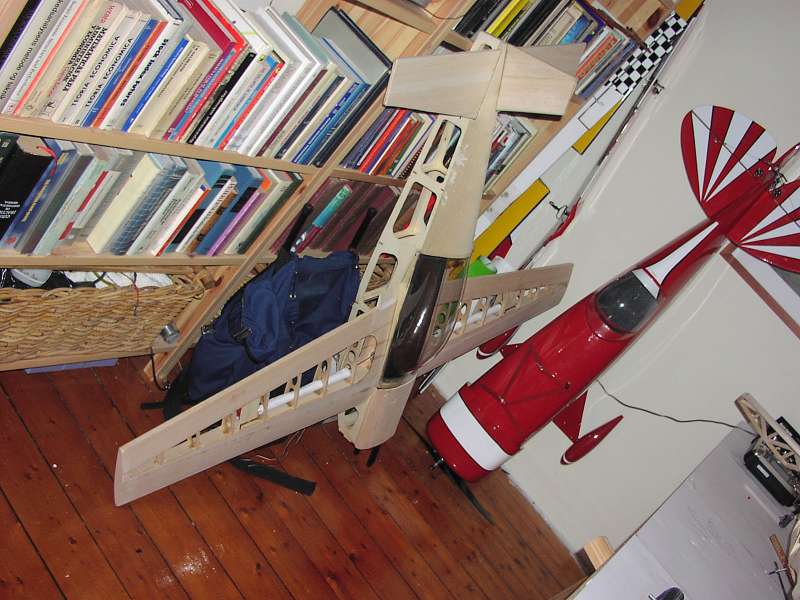

Default RE: Goldberg Extra 300
Hi. I am building my second Extra. It is almost ready to cover. I angled the LG base, so when LG is sitting on the base, is a little forward. My first Extra nose over all time. Also I enlarged the rudder a lot and the ailerons. While flying my first Extra, I noticed that having more rudder would be better, so I did. I am using for power a Saito 180, the engine/plane is a nice combo, I mean, really good. I have available a YS 110, but not interested on use it here, dont think it would be fun at all. If someone would like some pics of the rudder and LG modification I will post them.

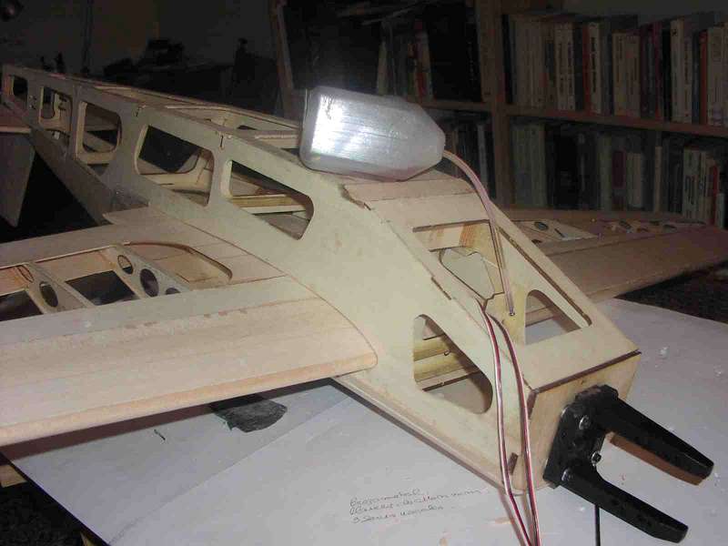

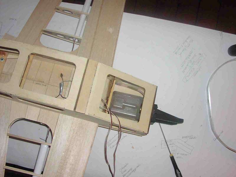

I found a Graupner square 500 cc thank that fits perfect without any modification. I will post some pics tomorrow, my camera is not here. I will show you also the rudder and the LG platform I did. I am using the TNT aluminum LG.
If not Graupner, I think you can find any other brand, but square, that is the trick.
Hi. My digital is an old version so pics are not that great for details. I made a new hard wood plywood LG base and glued it at certain angle so the LG is a bit forward to avoid nose over. Inside you will have to make the appropriate reinforcement with hard wood triangle stock, etc. Then you can see my gas tank, is a 500 cc!, but fits perfect into the original designed tank compartment. Last, you can see my rudder vs the original one (old plane), it actually looks more elegant and I hope that it will work much better. As for servos, I am using pull pull in rudder (90 oz), two elevators at the back of the fuse (51 each), two ailerons (around 60 oz each).
Fuel tank, rudder.
tigil, I dont have plans for the rudder. I just look up at several Extras and made it. I was trying to keep the proportions that I saw, so there is not plan to copy. You could do the same, I have posted a pic of the modified vs. the original, it is not a difficult task at all.
