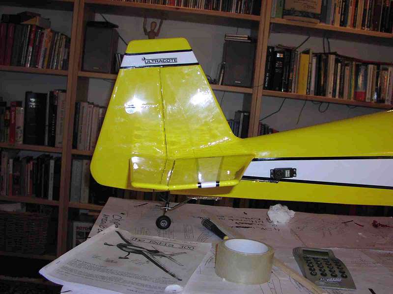

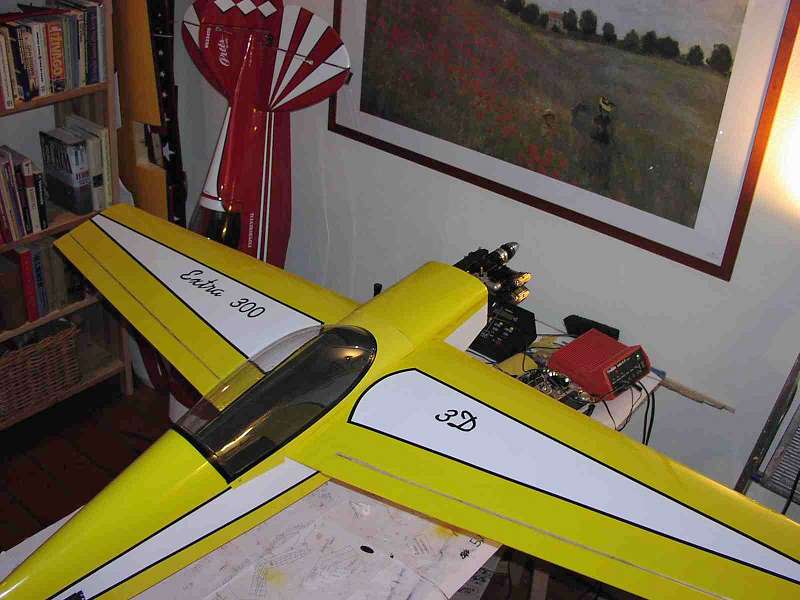

Some progress. The rudder will have more authority, also ailerons, it was a 3D kind of modification.

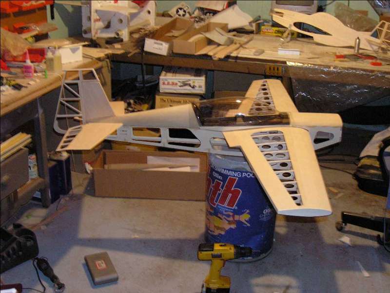

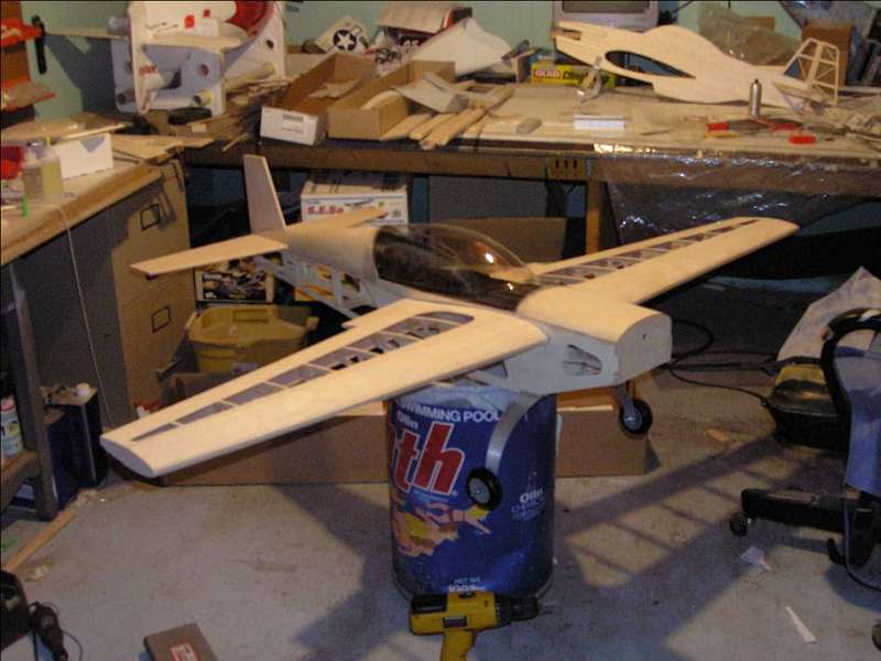

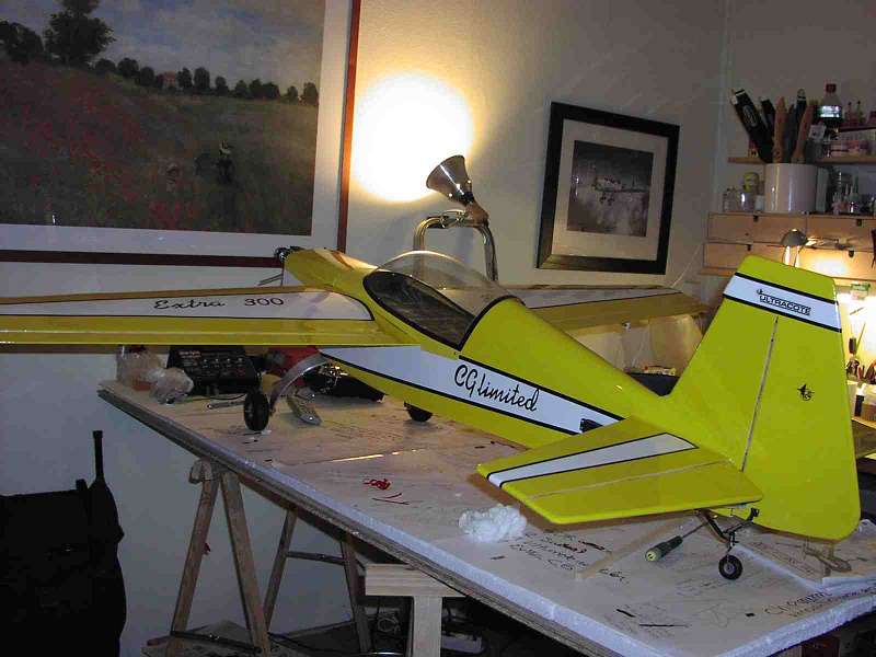

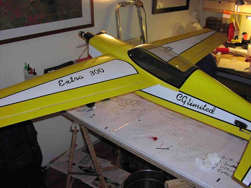

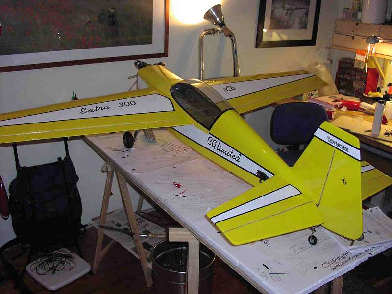

The plane is on balance with the Saito 180 and a 6 volt 2700 map battery pack below the fuel tank and two elevator servos at the back. I need to paint the cowl now. The LG is a bit forward to avoid nose over. It is turning out just the way I wanted.

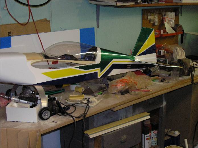

I have just finished construction of a Goldberg Extra 300. I have a Saito 100 engine, fiberglass Specialties cowl and landing gear, 3" tru-turn spinner and APC 15 x 6 prop. I have put two servos for the elevator in the tale. Checked the balance last night and it is 5 1/2 " from the leading edge. I have not weighted the plane yet or covered it, but it seems to be light.

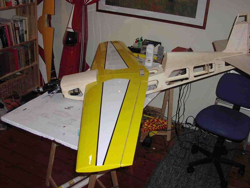

Well this is how far I am but Ido have a question, On the canopy how did you get the covering to stay on the plastic around the canopy when covering, The mods i have done is to enlarge the rudder, Put Stan's Fibretech aluminum gear, and since the picture Have mounted a servo tray midway in the tail for the elevator and will use the punched out wood from the fuse as a hatch to get to the servo's if needed, Just got to finish the hatch with the canopy and I'm not liking the way it is set up so I might change that a little but that's another story.
Thanx for any help

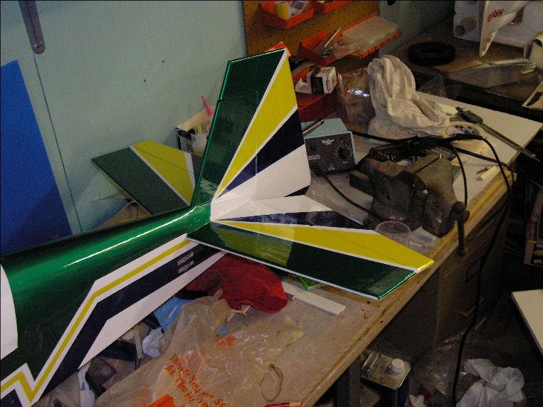

Well this is build #3 and covering #3 and this is how it's coming so far, I'Ve never been acused of being subtle

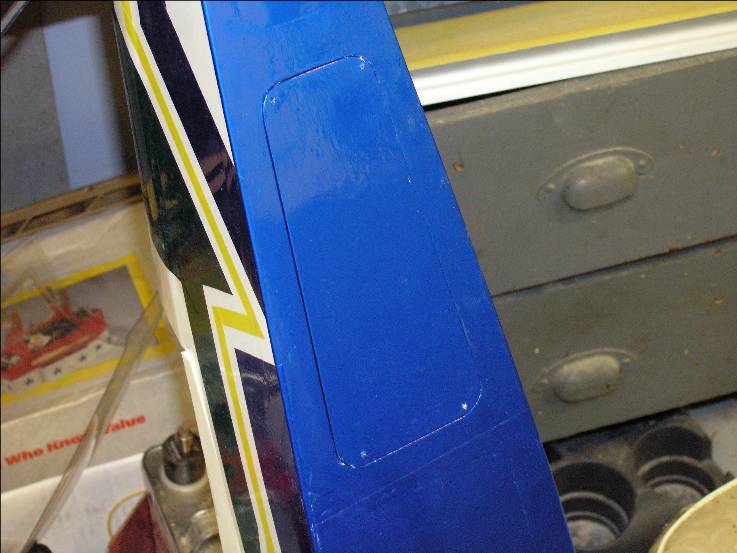

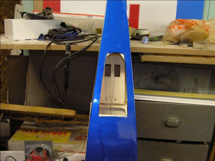

One of the mods I did was to use duel elevator servos but I hate servos sticking out of the plane soi used one of the punched out sections midway to the tail and hald the cover on with servo screws.
