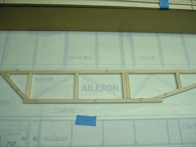

I'v only got the stabalizer done and am starting on the aelerions. Here are the pics

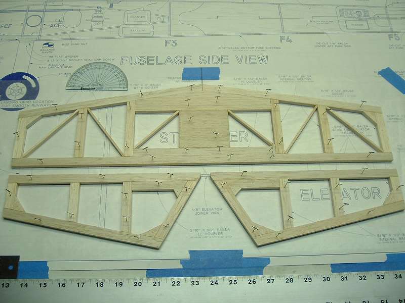

Over the past few days I'v built the Elevators, stab, rudder, fin, and aeleroins. The CA glue is drying a bit to fast for me so i think im giong to start using the epoxy.
here are some pics of the progress..
*note, for all the future people, be careful when bulding the aeleroin. be sure to pin the wood down to the sheet or else it will trick ya.

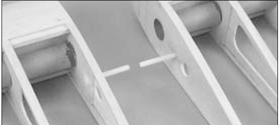

I just read that the wing is removable on the 60. Can anyone post a pic, or send it to me, of how it is attached or comes off? I looked at the manual Tower has online but it doesn't show how they are removed.
The only reason I didn't get a 40 was the wings don't come off.

through the middle of the plane is a aluminum pole (hollow). It sticks out both sides of the airplane and when you want to attach the wings you slide them on to each side of the pole and screw em in with a nylon bolt...

Thanks Nitrobasher, I was thinking it may have been like the SSE. So it's actually more like the large scale planes, the wing is bolted on to the tube and not onto the fuselage.

Courtesy of the Tower manual....

Wydah, you are correct. The aluminum joiner simply 'floats' in a cardboard tube through a bunch of ribs.
The nylon bolts go through the ribs in the wing center section and you put nuts on the inside.
There's a removable hatch on top of the fuselage for access to the nuts and radio equipment.
It's a pretty simple design and looks very sturdy.
