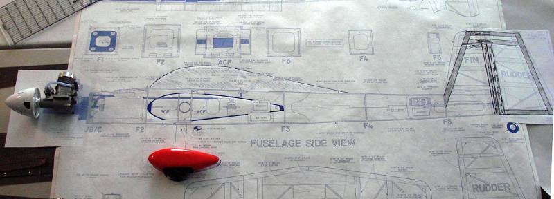

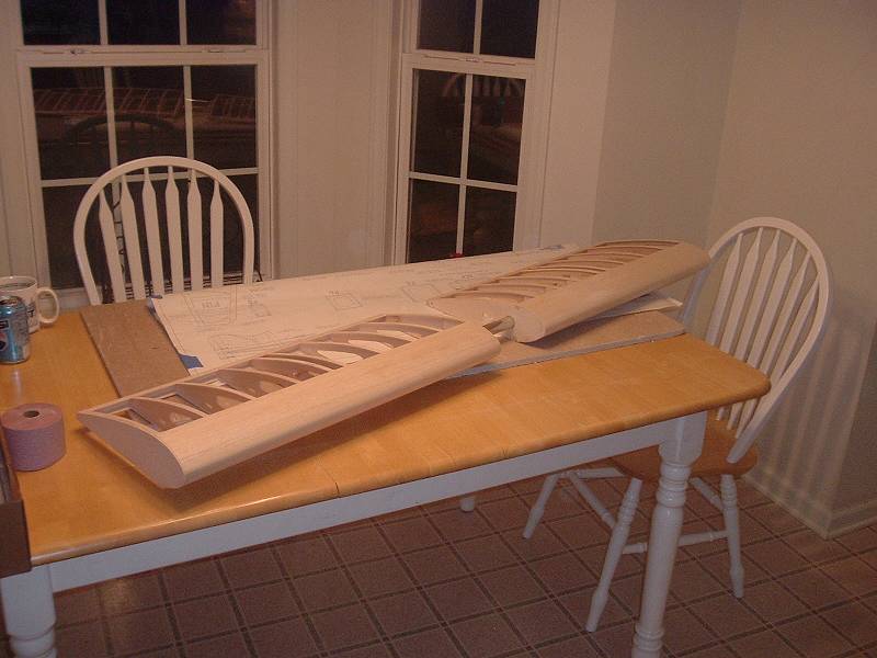

So far, I've built most of the elevator, started on half the wing, and redesigned some parts. For example, I'm not using the screw in the wing technique to hold it on. I also put the aerodynamic counter balance things on the elevator and rudder, as well as enlarging them. I'll tell you what, if your interested, I'll start a build thread. My goal is to finish or get this thing mostly done before the semester starts in September, cause then I won't have any time. I'll post some pictures later.

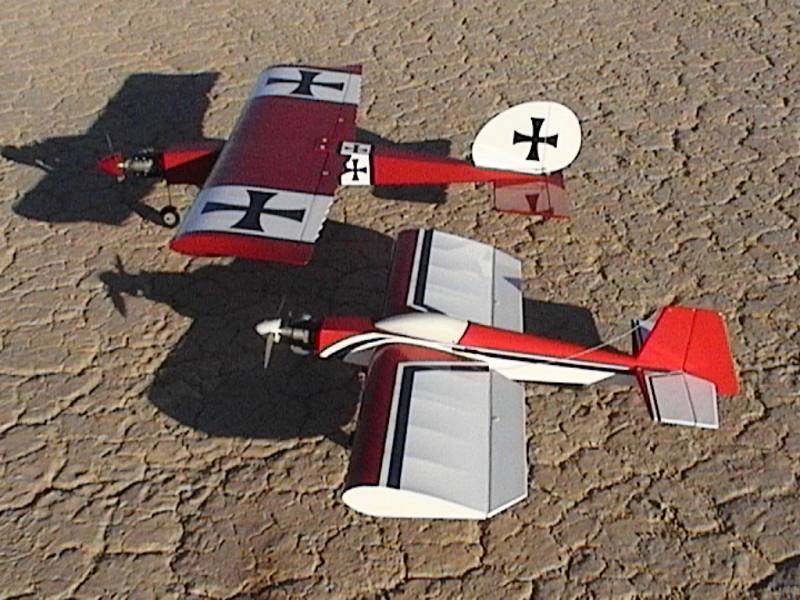

I purchased it for a cheap fun fly type plane. It hasn't seen a lot of flight time since I was plagued with a sticking throttle and then a fuel delivery problem (Kinked tubing). Hope to get some more time on it this fall.

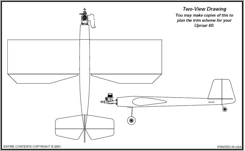

Included below is a 2-view which Tower includes with the kit so you can plan your color schemes.
Have fun.

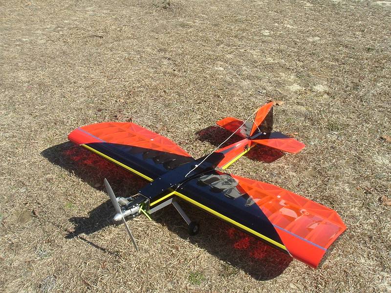

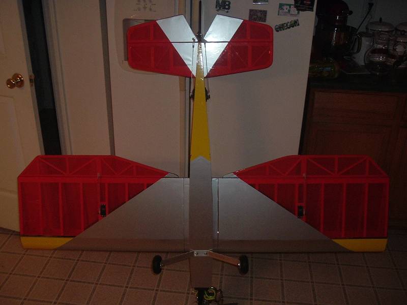

I have put the sticks together on my Uproar 60 and am starting to cover. I built it to specs but I will probably put the canopy on that was shown above. Here is a couple of pics of my build process.

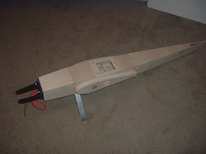

The canopy is definitely a nice add on ... I guess the top access to the electronics bay will need to be put on the bottom. I figured I would address that while building the center section and fuselage.

Yes, the center section piece is pretty symmetrical and so it was easy to just place the access hatch to the bottom-side so I could permanently glue the canopy to the topside.

My thought on that was making the canopy removable by mounting it on a base with a hook in front and a single screw in back. One screw to pop the cowl and you have access to your top hatch. With a very slight weight penalty. Top access is nicer than bottom access in my opinion, atleast you don't have to flip the plane to inspect or work inside the bay.

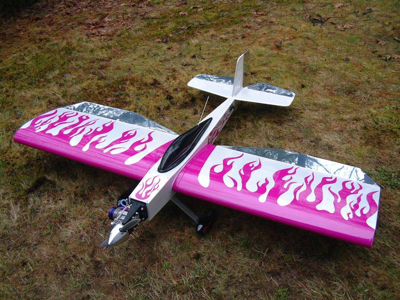

Well I finally did something to my plane other than allow it to collect dust. The wings are now covered and I have somewhat of a scheme for the rest of the plane. Sorry it has been so long.[img][/img]

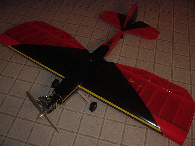

Thanks for the comments. I spent a lot of time trying to come up with a theme and I ended up drawing a blank more often than not. Finally I just said the heck with it and started laying colors. Even though you can't see it in the pics the bottom of the wings are a mirror of the top but instead of black it is silver and instead of red on the tips it is yellow. And no there are no wrinkles yet but I still have a lot to do .

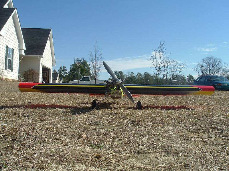

The Uproar is finally done. I put a Saito 91 in it as close to the firewall as possible and put the battery behind the throttle servo. Having done that it required no additional weight to balance within limits. I put high torque servos in the elevator and rudder and standards everywhere else. After doing a couple passes to do some trimming I tried some simple aerobatics and hovering. I still am not great at hovering but this plane seems to do it fairly easily. I also didn't really pay attention to what the instructions called for on throws I just put it where I liked it. The video of the maiden flight can be viewed here: http://www.youtube.com/watch?v=4wO5eekLN6M
Oh on a side note the landing gear is a little short and a 14x4W prop barely clears as you will see in the video at the end
