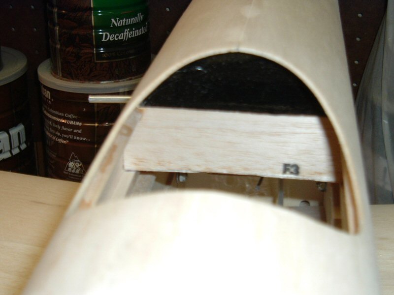

Hey all,
I'm on the home stretch to getting my Sig Astro Hog done and ready for covering with Monykote and I've run into a problem that I thought I would past the collective consciousness.
I can't seem to get the wing incidence below 2 degrees positive (the plans call for 1-1/2 degrees positive incidence). I've been sanding all day long and can't seem to make any improvement whatsoever. The guage (brand new) always reads 2-1/4 degrees on one side and 2 degrees on the other. Frankly I'm scared to sand any more until I understand more of what's going on.
So anyone with any helpful suggestions is most welcome to reply to poor old Dave. [&o]
I'd like to get the incidence within 1/4 degree rather than the 1/2 allowance in the guage's instructions. For what it's worth here is a link to some photos ...
http://home.comcast.net/~dave.combs/daplane.html
I'm so fed up that I'm about to throw the front dowels away and glue in some more wing bolt blocks.

Yup. I'm sanding the saddle at the trailing edges. One friend said to open the dowel holes up and make repairs for the elliptical holes. Looks like fun all the way no matter what I do.
Posts: 3,305
From: Brantford, ON, CANADA
To alter the incidence you are actually tipping the whole airfoil up at the trailing edge. Sanding just the trailing edge will not do it. If the saddle is a good fit to the wing then the whole saddle has to be sanded with more material being removed progressively towards the trailing edge.
I would do that anyway. Why risk all that you have in an airplane on a couple of wooden dowels. Use four screws. It is then easy to make adjustments to the wing after some flights.

I agree with ED S on this one. If you continue to sand towards the TE until you get the correct incidence and wind up with wing saddle gaps; don't worry. These gaps are easily filled with micro balloons and epoxy, or RTV if the gaps are small.

I've decided to cut some new wing saddles to bring down the leading edge and install extra wing bolt retaining blocks near the dowel location by the F2 bulkhead.
Last night I used sheets of paper that were 0.004 thousandths thick to shim down the leading edge. I was able to achieve 1-/3/4 degrees of positive incidence after using a whopping 0.084" of shims on the starboard side and 0.028" of shims on the port side.
I like my idea since, although it's not less work, it negates having to sand down the rear saddles so deeply. I'll glue the lite-ply saddles on the inside and sand to achieve the correct incidence, then fill with either EpoxoLite or epoxy and microballoons. The dowels will remain for alignment.

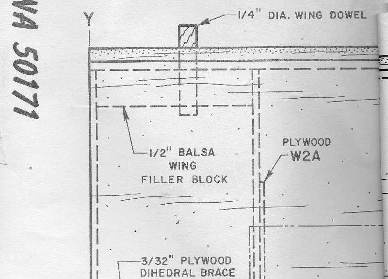

Here's what I think led to this situation:
After gluing in the first 2 bulkheads (as per instructions), I then moved to join the 2 halves. I remember now that the bulkheads did not align at the saddle as advertised even though I took great pains to ensure that both sides were even. I used 3 6/32 nuts and screws to hold them side by side as I sanded them to size. The builder is responsible for cutting the sides from 3/32 planks of balsa, they are not pre-cut.
I glued them together anyhow since there was nothing I could do - I couldn't figure out how it happened to correct it.
I went on building and forgot all about it until I got to the point where incidence was verified. Now I decided to glue in a slab of maple backed by 1/2" and 3/4" triangle balsa stock into which I will drill new holes to hold the wing to the fuse when assembled. The angle stock on top of the maple will be shaped to conform to the wing.

I made lite-ply wing saddle doublers and attached them to the fuse with 6-32 screws to force the leading edge of the wing down. Wouldn't you know it, the reading didn't change one bit. They are still 1-3/4 degrees + on the port wing and 2 degrees + on the starboard wing.
This is driving nuts but not insane. I'm about to remove the dowels altogether to see if that helps and then sand down the dowel to get the correct incidence. You can see my efforts at my Comcast homepage -

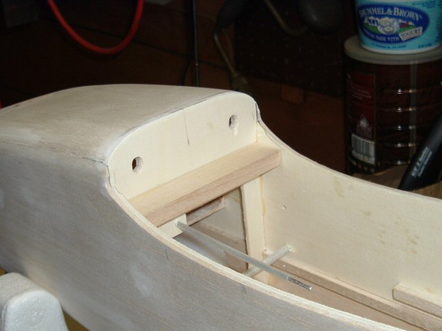

Yesterday, I FINALLY got the meter to read within 1/4 degree positive. The port wing was at 1-1/2 degree + and the starboard wing was at 1-1/4 degree +. I decided to take it and run.
I marked the adjustable wing saddles and glued them in with some slow set 'poxy. Now it's just a matter of fabbing a that chunk of maple across the front in order to attach new wing bolts. The original dowels were set in a piece of 1/2 balsa in the wing and I don't know if I'm that good of a shot to drill a hole through that.
See photo -
and ...
As you can see, I have decisions, decisions, decisions ...
