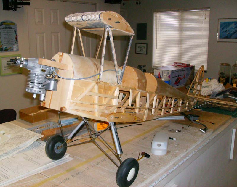

My Feedback: (118)
SEMC - You will love it. I had the Laser 100 in my Premier Tige. It was wonderful. Ihave always wanted another Laser and found a guy selling 2 for less than the cost of 1 new one. I had to have one of them.
Dave A. - Here are a few photos of mine the the RCS/MacKay 140. I think it is going to be excellent.

Jon, Thanks for posting the pictures. Nice neat looking plane! Yes, the RCS 140 fits perfectly. Now I just have to locate one. Take care, Dave A.

My Feedback: (118)
No problem Dave. If I run across one I'll let you know.
As I work more on mine, I realize it was probably flown at one time and someone decided to remove the covering and do it over. How about this...the cowl is silver and there were traces of yellow film. I would be willing to bet it was the same color scheme of yellow and silver. Why anyone would cover an old time plane with film and not fabric is beyond my way of thinking.
I'm covering mine with Coverite fabric and will paint it to look like the photo attached.
