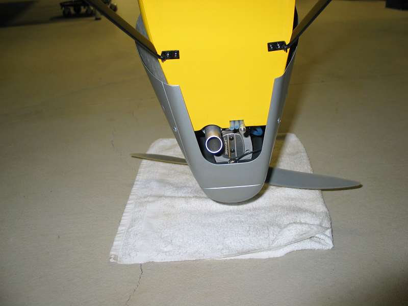

Phoon -- John answered a couple of your questions. I'll try to add a little.
1) Would the DA 50 R (inverted) fit within the Moth fiberglass cowl? The biggest concern is whether the width of the DA 50 R head is too large.
Answer: I didn't take mine apart, so these measurements aren't 100% exact, but reasonably right for inside the cowl:
5.75 inches from firewall to prop drive washer
5.25 inches from engine center line to inside of cowl bottom
3 - 3.5 inches wide at cowl location of cylinder head
Conclusion: All of these dimensions are less than the dimensions of the DA 50 R, minus the muffler. I personally don't see how it could fit.

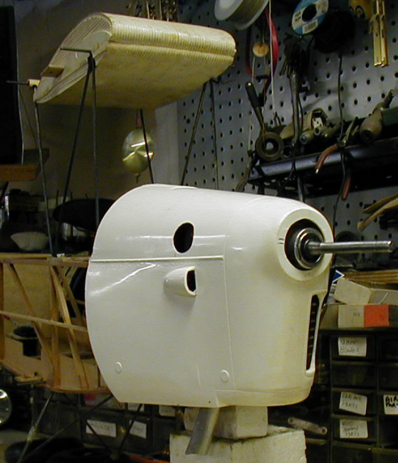

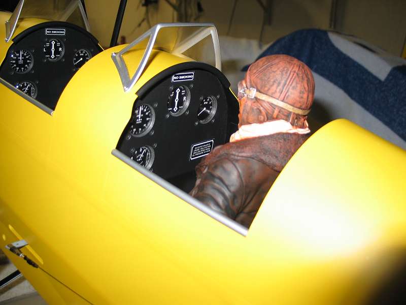

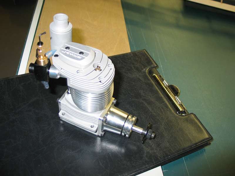

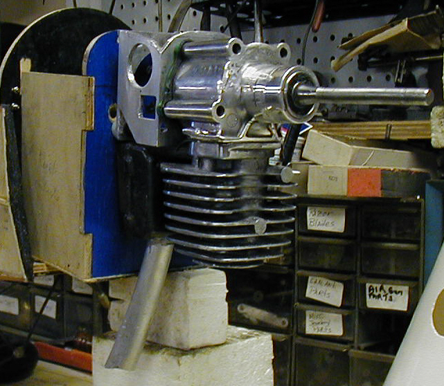

Hello Peter. Glad to post pictures, but if you don't mind, I'm not going to take the cowl off. I have it all set for flying and would prefer not to take apart right now. I have two pictures that I think will give you the idea though. The single cylinder Lasers, as best I know, are all set up the same way -- with the carb and muffler mounted behind the cylinder, and directly in line with their respective valves. This is one of the reasons a Laser will fit nicely into narrow scale airplanes like the Tiger Moth. The first picture is of the Laser right after I received it from Proctor Enterprises. The other is from a few minutes ago, showing the bottom of the Tiger Moth, and where the exhaust exits the bottom of the cowl. It's very straightforward. If you look closely, you will notice that the carb and exhaust are reversed in the first picture from what they are in the recent picture of the Tiger Moth. This was my mistake. The engine is shipped without them in place, but the instructions clearly show the right positions. It was mounted this way on the Super Cub for test flights. Let's just say it didn't run very well at first, and the test flights didn't start until they were put into the right locations (e.g. carb into intake, muffler on exhaust. duh...). Also note I did put an aluminum extension on the muffler to extend the exhaust past the bottom of the plane. After two flights, there was only a little bit of oil on the bottom of the fuse front and the gear. The rest of the airplane was clean. Not too bad for a greasy glow engine.
I threw in a picture of my just completed pilot. He's from Aces of Iron. I tried to follow the instructions on their website to paint him. I'm no artist, but it turned out pretty well, and looks good sitting in the Tiger Moth.

Thanks - the picts are just fine as is. Both your engine and mounting description was very helpful. From your pictures, can now appreciate the importance of a muffler that is on the rear of the Laser, and can see how it fits the cowl. The Laser 180 is ranking right now as a strong choice.

1) Can you tell us what each of the three "tubes exiting from the bottom of the cowl" consist of? It's such a neatly set up system. Are the tubes for fueling the tank, excess oil from Laser crank case, ect? Do I see a dot fueler? Any details you can give us about this are much appreciated.
2) You mentioned that you added an aluminum extension tube onto the Laser muffler to extend through the bottom of the cowl. Can you tell us more about how you did this? For example, did you use a short piece of Teflon tubing with special heat resistant ties to couple to the Laser muffler exit? Or, did the aluminum extension tube fit directly over the Laser muffler exit tube with some special attachment method?

Hello again Peter. Thank you for your kind words. I enjoy all the detail of this hobby, and appreciate that you noticed. Regarding your questions:
1. The three tubes are (1) crankcase vent from the Laser (there's a nipple on the back cover), (2) fuel tank vent, to top of tank, (3) fuel tank fill, to bottom of tank. There isn't a dot fueler, only a Great Planes fuel line plug in the fuel tank fill line. The vent is left open. The Laser instructions say not to use muffler pressure. It's a real simple setup. Just close the throttle to prevent flooding, remove the fuel line plug, pump until fuel out the vent, replace fuel line plug, and you're ready to go.
2. The aluminum extension tube is directly over the Laser muffler exit tube, and only about 2 inches long. Without it though the exhaust would exit directly onto the firewall, and make a giant mess. I found some .750 OD x .035 wall 2024-T3 tubing (I think at Aircraft Spruce & Specialty) that fit the exit tube on the Laser muffler perfectly after just a couple of passes with a file. I secured with a little J-B Weld epoxy and a 6-32 socket head screw. It flew a number of fights previously on my Super Cub, without any problems.
3. The silver is plain old aerosol can Plasti-Kote body shop paint from the automotive department at Walmart. The color is 1001 bright silver. It matches the silver Solartex perfectly. The black parts are the same brand paint, color 1020 black. I have found that Coverite 21st Century Primer works great, and have been using it as my main primer for several years. It dries fast, sands well, and I haven't found anything yet that didn't go over it fine. The cowl was an excellent layup, with only one tiny blemish that required a little spot filler, and it was ready to paint. I used the Coverite Primer, the Plasti-Kote silver, and then Klasskote clear satin using an HVLP gun. Note the windshield frames, and silver frames around the cockpit openings (pieces of nylon push rod) are painted with the same Plasti-Kote silver. Also FYI, since we're talking about paint, the fuse is Cub yellow Solartex, and oversprayed with Yellow Klasskote with satin catalyst. Out of the package, the yellow Solartex was not very opaque, plus not quite the right color. The little bit of paint worked perfectly. The silver Solartex seems to have a much more substantial finish, and is just like it came out of the package.
4. I can't give a real detailed account of the Tiger Moth's landing characteristic after only two flights. But I too had a Goldberg Ultimate, and later a Dave Patrick Ultimate (similar, just a bit bigger) and the Tiger Moth is definitely more gentle than those. I guess I would have to say I expected it to be more of a floater than it actually is, but it's not a small or necessarily light airplane. Also, there was almost no wind on the only day I've flown it. I'm sure that a little breeze would slow it down quite a bit. In summary, though, it lands gently and easily, and gives you plenty of time to think about what you're doing. Based on the experience you've had, I don't think you would have any problems.
Hope I answered your questions. I'm headed to a scale fly-in this Saturday, and the weather looks like it will be perfect. There will be lots of airplanes, so I don't expect to have more than 2-3 flights, but I should know more about it after flying more. I'm going to try to take pictures, and maybe get a movie clip if I can find someone to point the camera.

John. The engine bolts to the bottom of the hardwood beams, in an inverted position. The bottom surface of the beams is actually the centerline of the thrust line, if that makes sense. I don't remember completely, but I'm pretty certain I had to modify the bulkheads holding the tank to lower it to meet the carb height. As I recall, I used part of the supplied parts, and made new pieces for the bottom to lower the tank. It was pretty simple. The way the Laser is designed (if that's the engine you're using) the carb is directly behind the intake valve, so when the engine is mounted inverted, the tank center line has to be quite low. I didn't use the supplied tank. A couple of the reviews I read said the supplied tank leaked, so I used a standard Sullivan round tank, and adjusted the bulkheads to fit. My opinion, it's going to be pretty difficult to get this exactly right without the engine while you are building, unless you have the exact measurement of the distance from the center of the engine (mounting beam) to the carb inlet. Definitely you will want the engine before mounting the cowl.

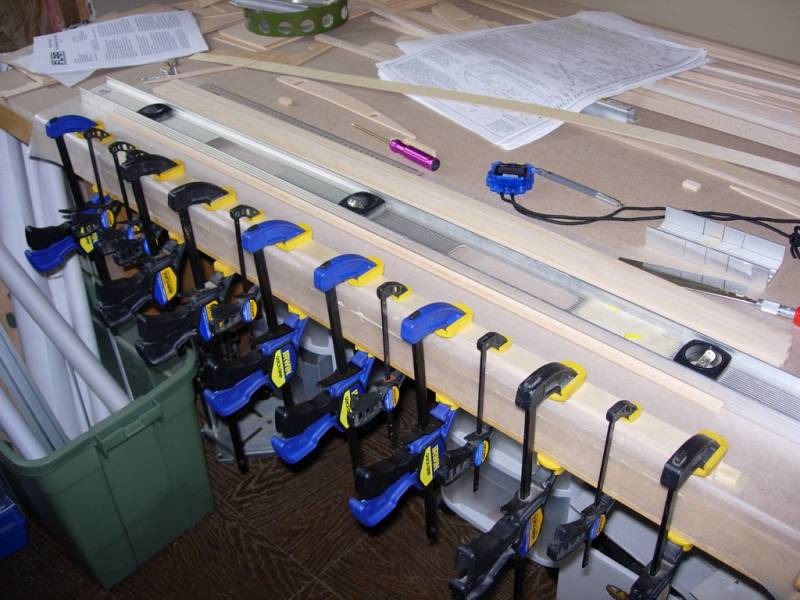

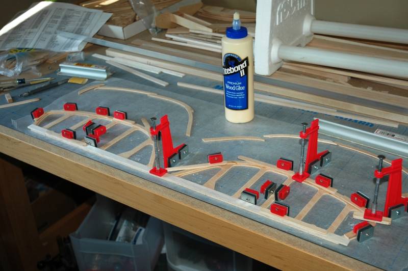

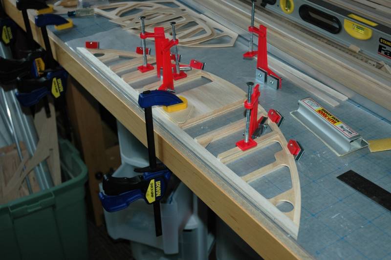

CYBERTOM'S FLAIR TIGER MOTH UPDATE
Well I finally got back to working on this Tiger Moth kit. I am hoping to keep the pressure on and get it finished before June. So far I have created the main spars and am waiting for a cross slide vice to show up so I can drill accurate holes for the Robart hinges I plan to use. While I was waiting to build the main wings I decided to knock out the stabilizer and rudder assemblies.
About The Stock Hinges
I don't really care for the stock hinges made of metal stampings with a small cotter pin linking them together. The Robart hinges (with hinge pockets) will be lighter and not have the mechanical play of the stock hinges. I'm using Robart hinge pockets so that I can disassemble the rudder, stabilizer, and ailerons from the airplane.
Other Modifications
Another item I am planning to change is the cabane struts. They are BIG heavy solid steel rods bent to shape. I plan to replace these with lighter hardwood struts strengthened with fiberglass. I plan on attaching metal brackets at the ends. These cabane struts will be removable unlike the stock configuration. I had hard landing with my Stearman a few years back and bent the aluminum cabanes. It was a real PAIN to fix because they couldn't be removed.
My goal is a very reliable low maintenance airplane that is lighter and stronger than the stock configuration and can be easily serviced if necessary.
