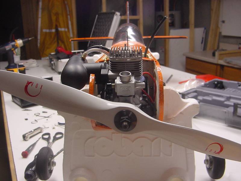

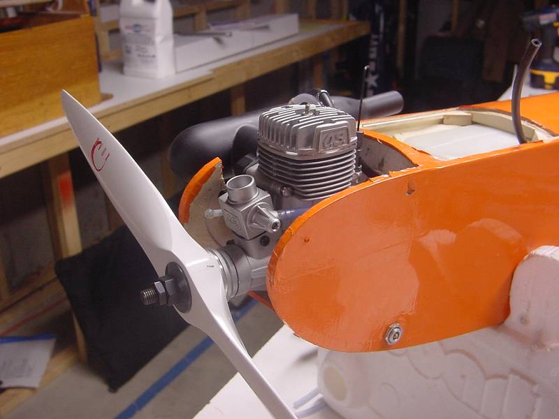

The .91FX will fit nicely. I recently put one in mine and it flies well, only 2 flights on it so far so no word on how it will perform until it breaks in a little more. I used a 15X8 wood prop the first couple flights, going to try a 14X8APC next time out. In the process of installing smoke in it now, will let you know how it goes..

O wow nice! Was it hard to put on the motor and what work did you have to do? Also you think this would be an easy arf to build?

The motor was a simple install, in fits as easily as a .61 would. The ARF should be quite easy to build, I built the kit as my first kit plane and is was a blast to do. I didn't do many mods to mine as it is built quite well to begin with. I just replaced the top stringers on the turtle deck with spruce instead of using the balsa ones that were included in he kit. Then I cut one bay off each wing tip after I had a few flights on it to improve the roll rate alittle. Here's a few pics of the wing mod, quite easy to be honest.

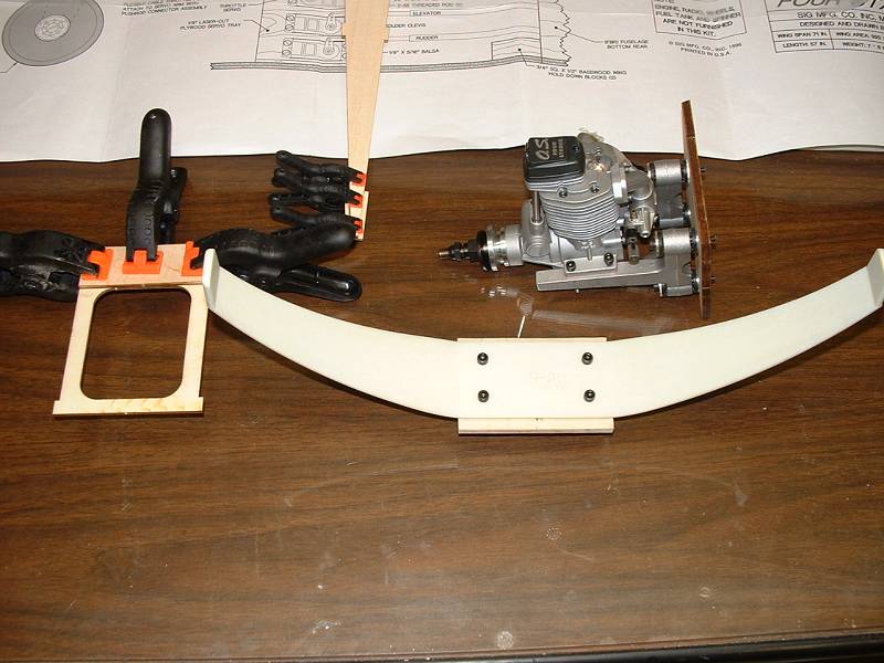

I've had 3, 4* 60's and have had os 91 4 stroke and a os 70 4 stroke and a 61 os 2 stroke and they all fly fine. I also have 2 4* 40s.

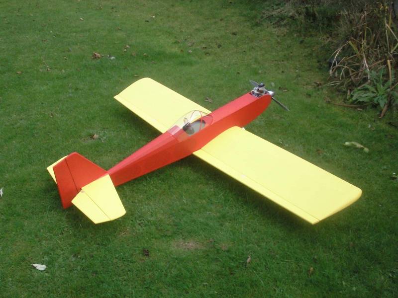

Just almost ready to fly mine now. It seems to have taken ages to build. I have built about 5 arfs since I started this. The only mods were to slightly increase the rudder elevator and airleron sizes as well as sheet the leading edge. The tips have all been rounded which added about 2" to the wingspan! Dubro tail wheel used and all the sheeting that they say for the empenage. The CG seems to be literaly spot on. Must double check that but thats what it seems. The engine is an O.S. 91 FS

Looks good. You're gonna enjoy it. It's going to be a floater, though. The 4*60 that I'm currently flying has the stock wings and I have to reduce the power early on downwind or just fly the pattern lower than usual in order to get it down and stopped on our paved club runway. I've been meaning to clip the wings like I did on my previous 4* but other projects keep getting in the way of it. You'll have fun flying it either way.

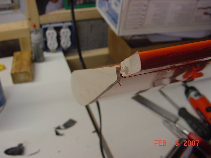

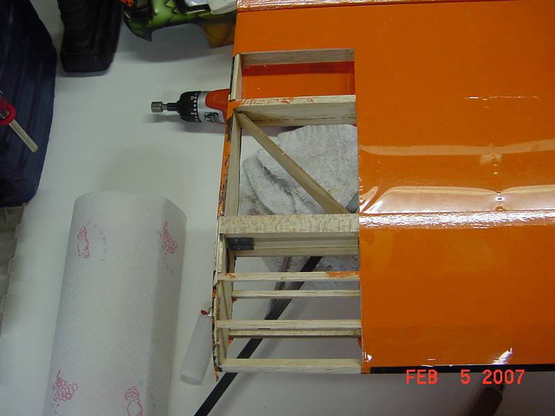

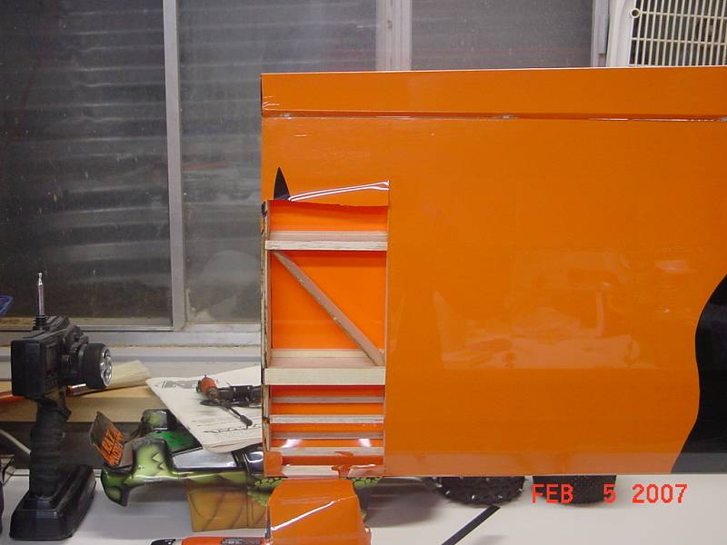

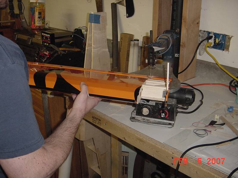

Yes, I agree. I even took 1 bay off the wingtips (6" total) and it didn't effect landings at all. It does roll a bit quicker though, mine is right on 8lbs. w/ a Saito 1.00. I will always have one in my hangar. Almost 3 years and over 250 flights and still going strong. Kind of nice to have a plane that you have to replace the servos and batteries before you have to replace the plane. [8D]
