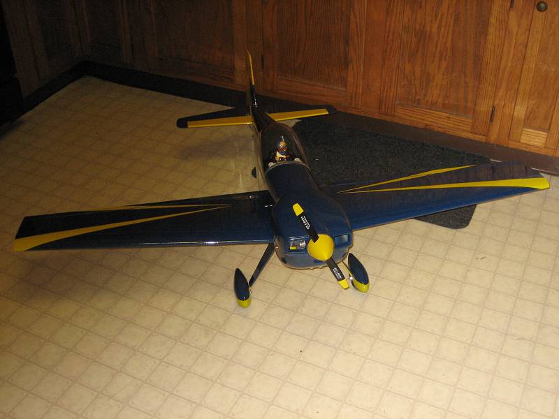

Default RE: GP CAP232 Build
Finally finished with mine! Saito 91. Thanks for all the tips & advice everyone.
ID:	431532   Click image for larger version

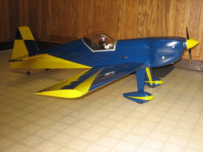

Old 03-23-2006 | 12:48 PM
  #103
alpinestar's Avatar
Posts: 309
From: Manitou Beach, MI
a few more...
So how does it fly with the saito .91 in it... someone told me its snappy with the .91 due to the weight, which doesn't seem right to me since its actually lighter than the os .70.
Nice job alpinestar! I love the cover job. Hey... You got the same pilot as mine! [8D]

There's nothing worse than an unfaithful Barbie.
Using my digital fish scale, my Saito 91 is the same weight as my OS70, so the weight is a wash. Torque on the other hand is a different story.
Thanks gumhead! Great idea on the Barbie, hope you don't mind that I borrowed it. I came home with a bagful of 'em for future projects or in case she runs off with Malibu Ken. I cannot claim originality on the color scheme either... Check out the galleries on the Carden site & you'll see something familiar!! Thanks to the "unknown builder". There are a lot of great color schemes in these galleries for ideas.
Haven't flown it yet... maybe this weekend?? I also weighed the 91 vs an OS 70 surpass (an older one) & found the weight to be within a prop washer. It balanced with a 5-cell 1100 Nimh pack in the middle of the cockpit. The Fiberglass Specialties cowl seemed a bit heavy, but much better than the ABS one. Glad I didn't mount the pack behind the bolt plate per the plans! Yeah, the torque will be a little different.... But a little care with the throttle at low airspeed should prevent the dreaded snap.
Can't wait to shake off the winter rust!

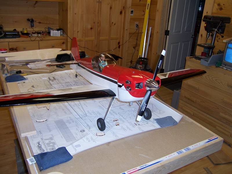

Well believe it or not I still haven't flown my CAP yet [] To darn cold and windy.
Heres another pic tho...

That’s right… I finally brought the CAP to the field! The plane was pretty much completed back in January. But I never got around to putting in all the radio gear because of another build, flying and just plain being busy. Well I finish off the plane this week. It was raining out most of the week but last night the clouds broke and there wasn’t a breath of air. The plane flew great… Better then I expected. All she needed was a few clicks of trim. The roll rate is fast, loops tracked great and the little YS had plenty of vert power.
What surprised me was the way it floated in for landings. No sign of stalling at all. I read a few posts that said this plane tip stalls and falls out of the sky on landings. I tried to stall her at high altitude. You have to be going so slow… almost stopped before the wing will stall.
I had to fly her with out the cowl do to my remote glow plug kept messing up. I also took the wheel pants off, they look good but they don’t help on grass… especially wet grass. The plane came out heavier then I thought. The specs say it should be 4.75-5.25 lbs it came out to 6.75 lbs. The plane is tail heavy, I had to put 6 oz of lead in front to balance the plane. I plan on taking off 3 oz of it because the plane seemed good with out the cowl, which weighs 4.5 oz. I also may move the rudder toward the front.
All in all I am very happy. The plane flew great! I can’t wait to get back out there and really start putting her threw her paces. Whooohooo!
*Edited for spelling
