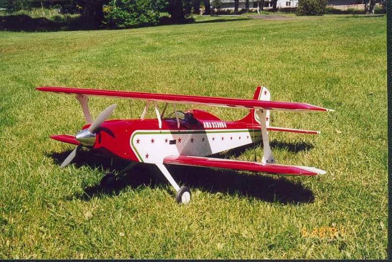

Stan's Fibertech has cowls for the Hog Bipe. I tried to upload a pic of mine so we'll see how that went.
Jim
