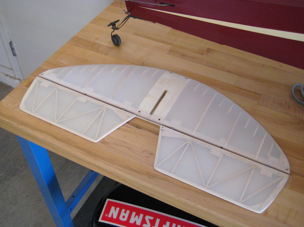

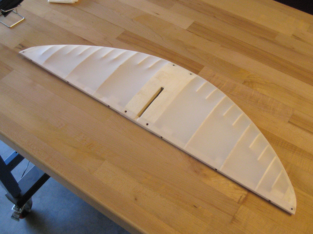

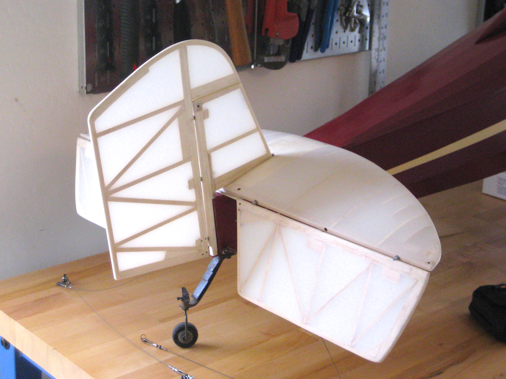

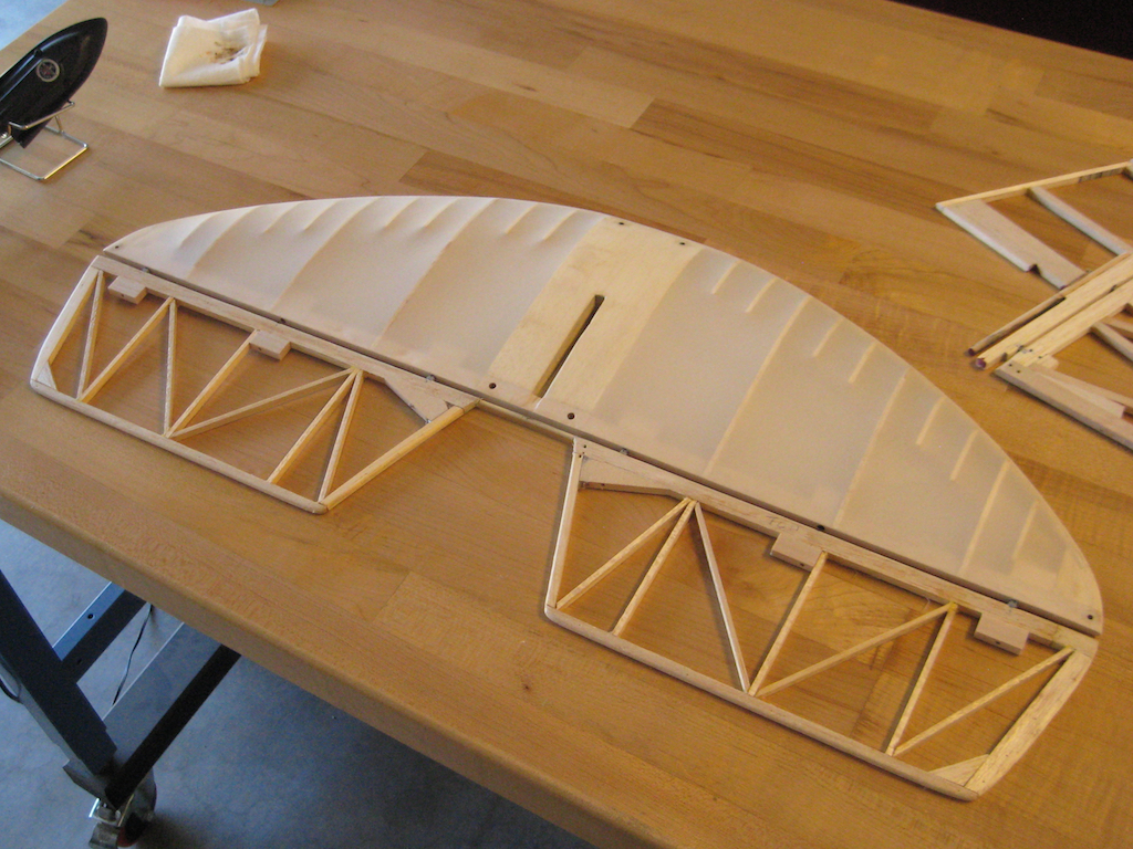

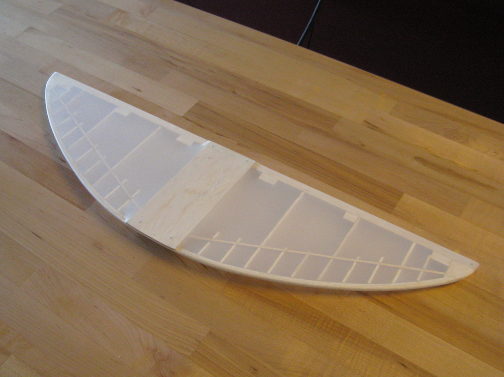

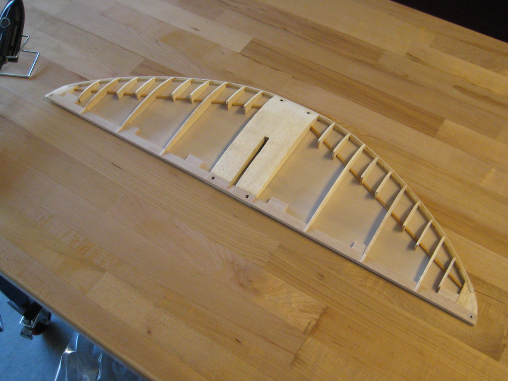

Horizontal Stab is recovered. Using Solartex, which I believe the plane was originally covered in.
Solartex, with exception of the weight, must be one of the easiest to apply / best coverings available. It just stretches around compound curves with ease.
In the future I would like to try Stits as I am always wanting to learn something new. However, I have the Solartex already and its use seems appropriate for this plane.
Covered the bottom, then the top, then used an old soldering iron (Purchased for this purpose) to burn out all the holes.
SunDevilPilot
Name:	Horizonal Stab Covering 1.jpg
ID:	2093714   Click image for larger version
Name:	Horizonal Stab Covering 2.jpg
ID:	2093715   Click image for larger version
Name:	Horizonal Stab Covering 3.jpg
ID:	2093716   Click image for larger version
Name:	Horizonal Stab Covering 4.jpg

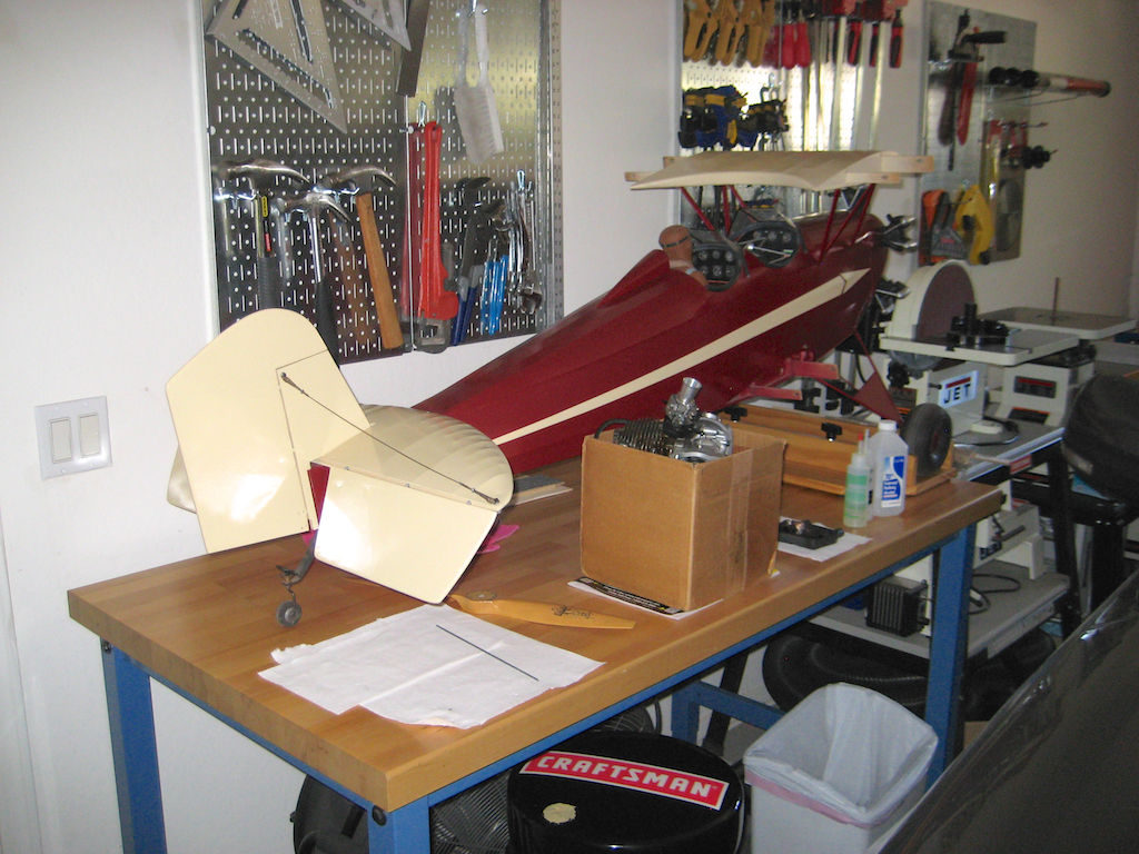

Elevator halves are done. It got too hot in the garage to continue so I stopped for the day. Next up, cover the rudder. Possibly painting next weekend.

Went flying this morning but it turned into a short day. For some reason no one else was there. Had the whole place all to myself. Got home at about noon, had some lunch, then covered the rudder. Was a little challenging, working around the hinges, but it went without issue.
The tail feathers are now ready for paint, which is next.
Then I'll move onto the broken muffler.... Hum... how to fix that.

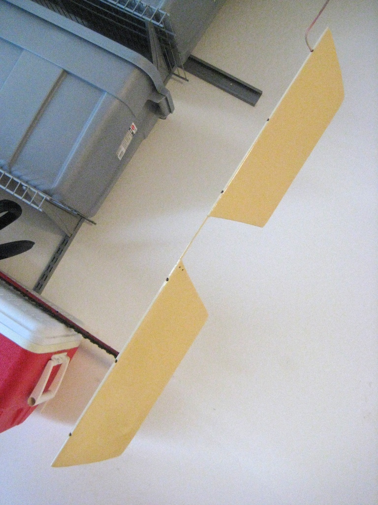

Old 05-05-2015 | 12:33 PM
  #883
SunDevilPilot's Avatar
Joined: May 2002
Posts: 2,025
From: Gilbert, AZ

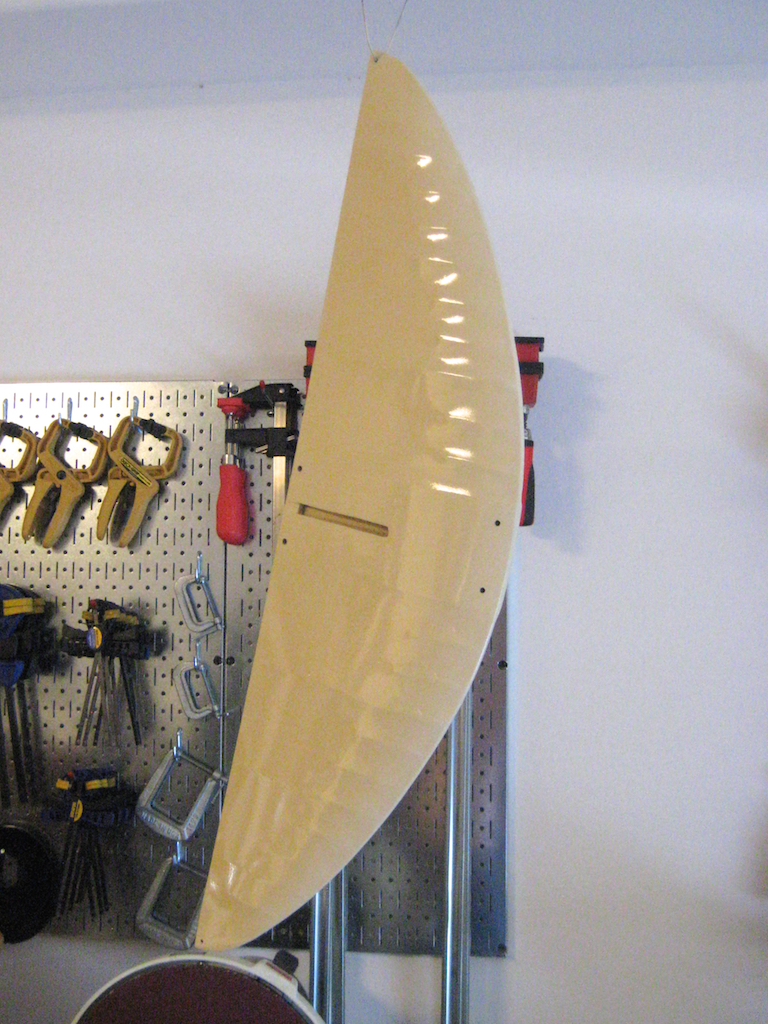

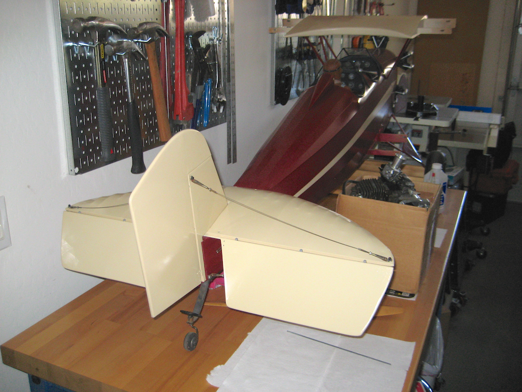

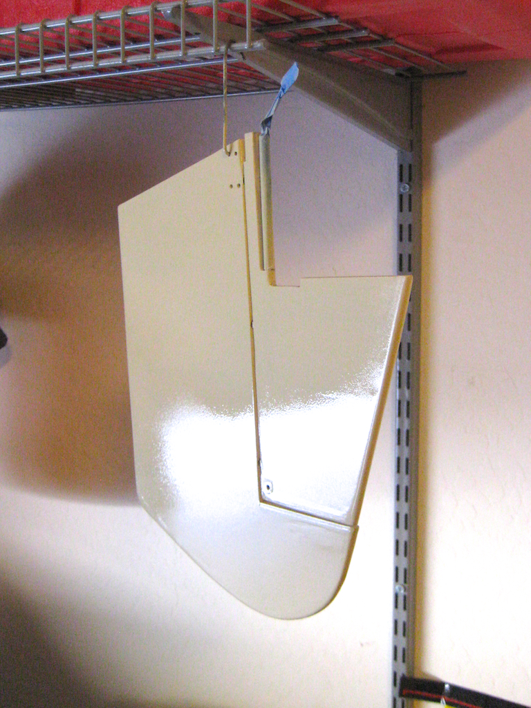

Well.... I decided to get the painting done. If I didn't jump on it the weather around here would rapidly become too hot to paint.
I was a little rusty with my painting skills but everything went on good. Just a little more paint than I would have liked.
I had the cream Klass Kote from my Super Cub project which is a pretty close match to what the plane had on it previously. It may be just a hint darker.
Next weekend I can put the tail feathers back onto the plane. Then... Onto the muffler.
SunDevilPilot

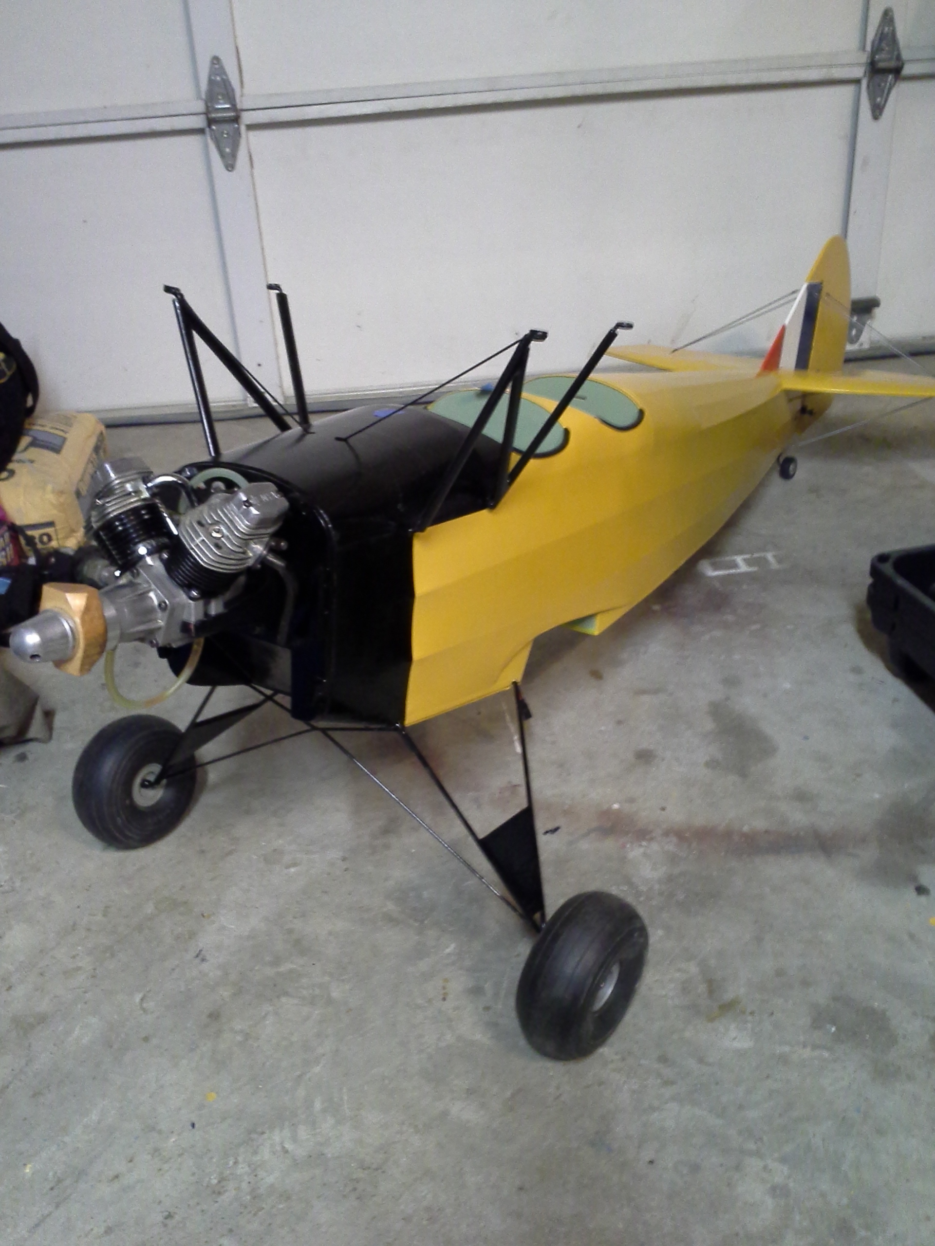

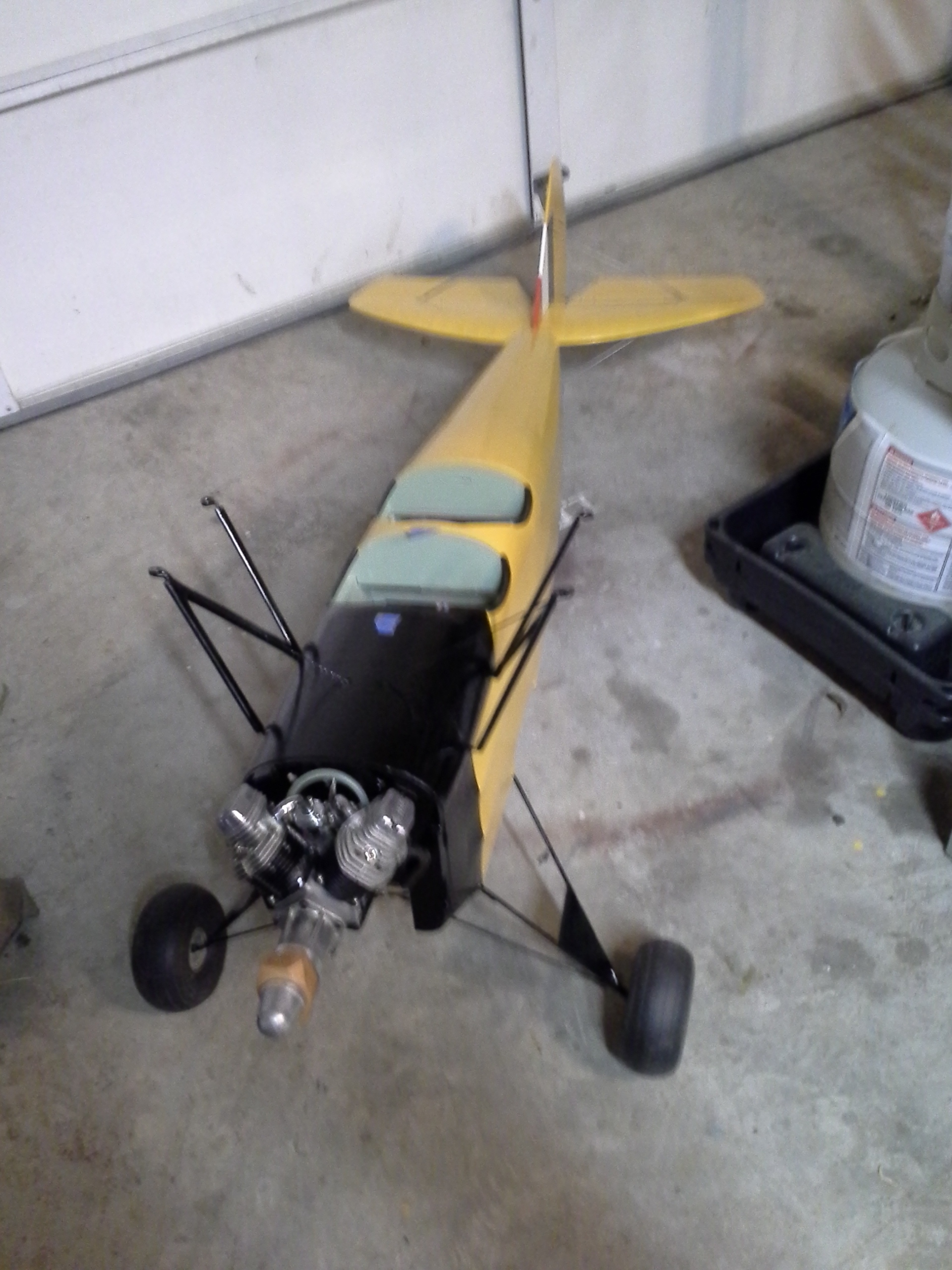

Got mine on her legs after a re-engine of my Cub. I sport the old Throttle Coupled Spark advance and cubing up required a whole new set of linkages and rig.
The engine in the Fleet is an Enya V240. Really powers her well with a great twin sound. Lopes at idle. Engine was overhauled two years ago before the crash. Still a honker.

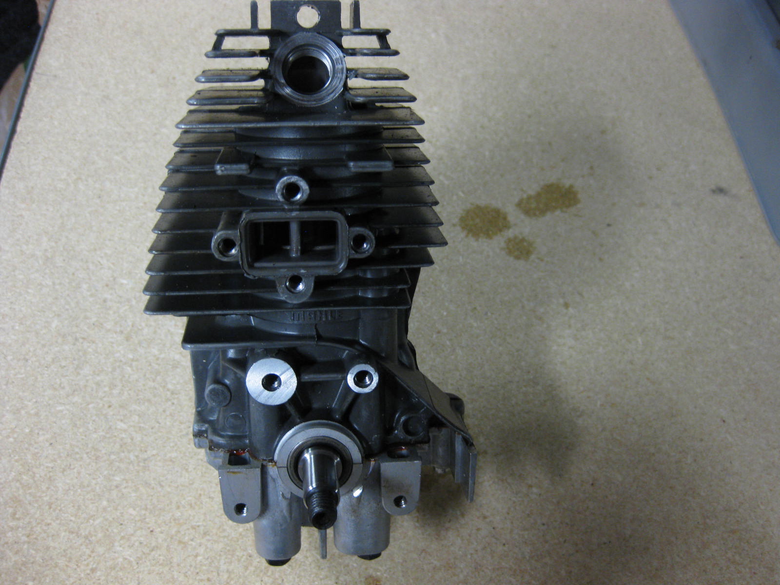

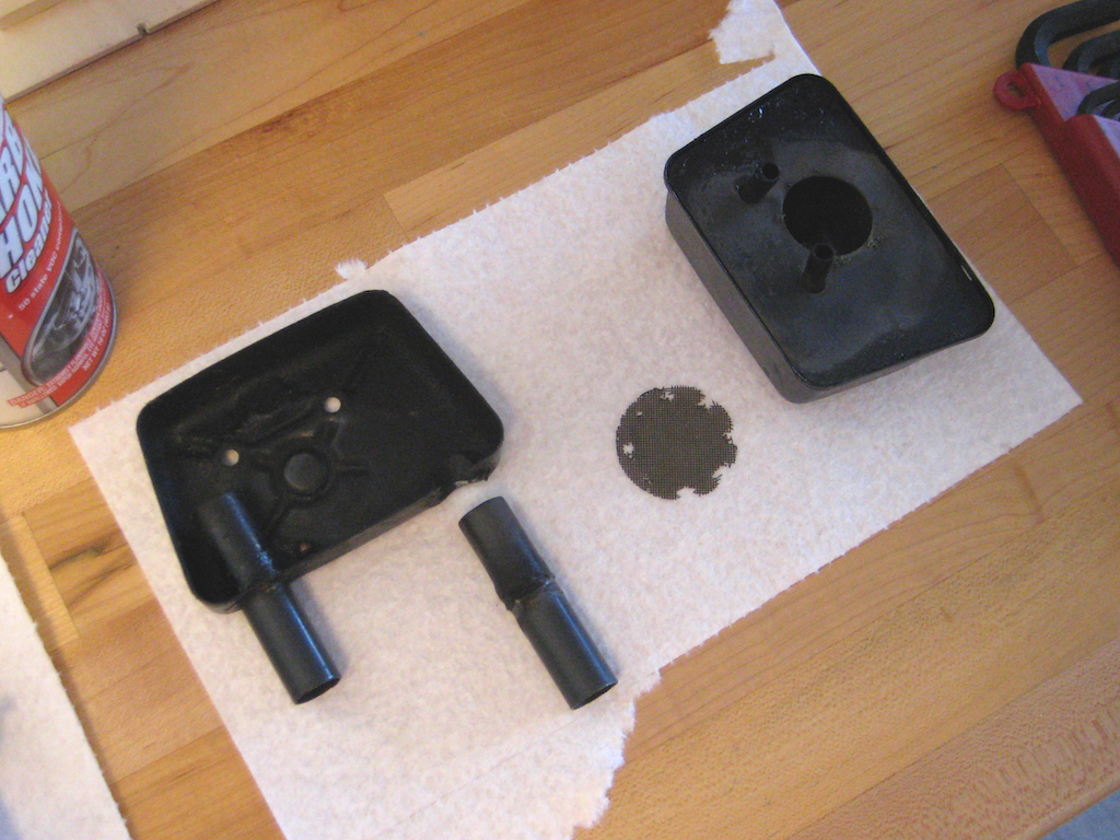

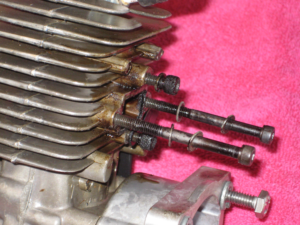

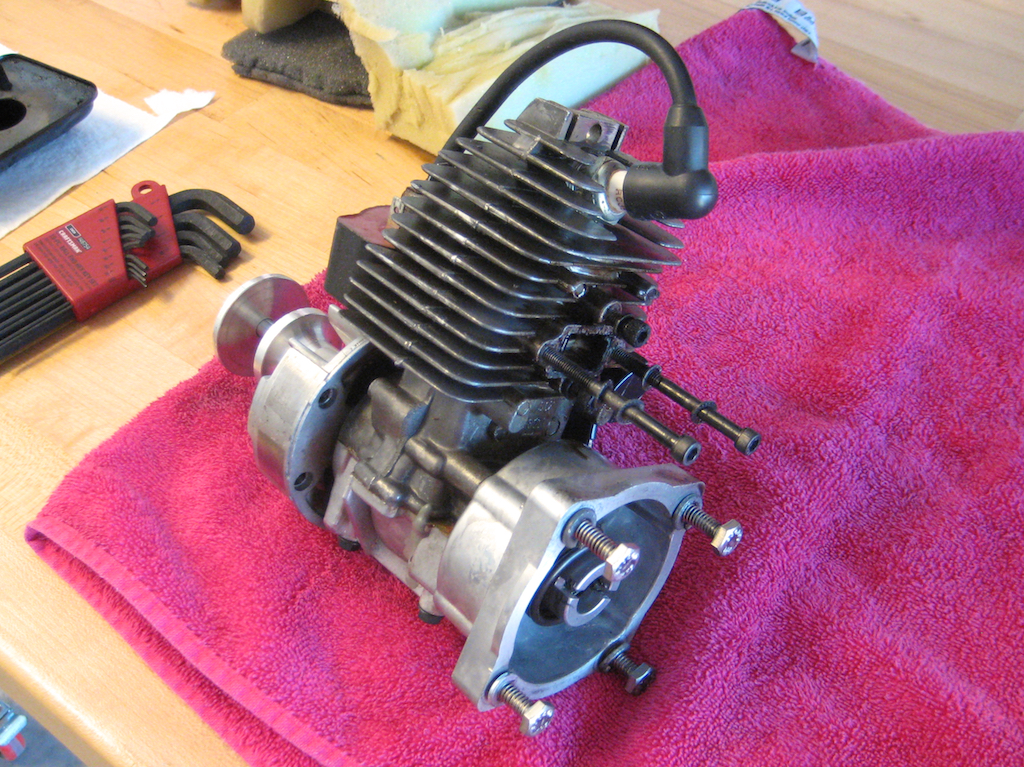

Not sure how to fix this one.
Today I pulled the motor. I had discovered one of the muffler pipes had broken loose. I had been discussing this issue with a guy at the field and he said he had a broken G38 (Bent Crank) and I was free to have it. This one had a complete Bennett muffler and we both thought it would fix my issue.
However, when I took the muffler off the motor from the plane I discovered it had a 4 bolt attachment on the muffler. The first half of the muffler attaches to the cylinder head then the second set of bolts holds the outer half of the muffler on. These outer holes fit the traditional attachment method but are just a bit narrower in width than the muffler from the bend crank engine. I believe the bent crank style represents the current dimensions for the motor. The planes motor also has some raised areas around the exhaust port which would precent any other muffler from sitting flush.
I've looked briefly for a replacement muffler and I haven't found anything like the one on the good motor.
Need to think on this one.

Name:	Motor Pulled 1.jpg
ID:	2095248   Click image for larger version
Name:	Motor Pulled 2.jpg
ID:	2095249   Click image for larger version
Name:	Motor Pulled 3.jpg
Old 05-10-2015 | 03:08 PM
  #886
My Feedback: (-1)
Joined: Apr 2003
Posts: 14,400
Received 9 Likes on 8 Posts
From: Hemderson, NV
Just a thought but have you taken the muffler to a welding shop? As I recall the pipes were just brazed in. I have broken pipes off of aluminum mufflers and had them repaired for a couple bucks.
Old 05-10-2015 | 03:12 PM
  #887
Joined: May 2002
Posts: 2,025
From: Gilbert, AZ
Well....
I may have figured out why the G38 muffler doesn't fit... Because the motor on the plane is not a G38.. It appears to be a Quadra 35. I was looking around and found the attached photos of a Q35. That is what mine looks like!
Bennett still makes mufflers for the Q35 so I may just order one of those.
Before I buy a new one I may just try and braze the broken on back on. There is a suspicious brass ball inside the muffler, near the pipes, as if it had been repaired before. If I totally fail then a new muffler is only $35.00.
I'll clean up the broken one a bit as see what I have. Not damaged too bad.

Old 05-10-2015 | 04:37 PM
  #889
Joined: Nov 2012
Posts: 358
From: Ladson, SC
I'd give it a try too. I wonder , since it is gas/oil , if the exhaust temps would melt a good silver solder.

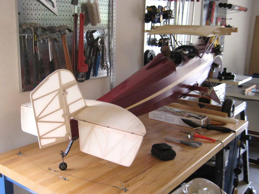

Today I glued up the hinges on the elevator. I still need to add the control horns back onto the surfaces but for the most part the repair process is complete. Just put the elevator on the plane so it doesn't get damaged while waiting for the hinges to totally cure.
The tail brace wires are out of adjustment by a tiny bit, this will be remedied when the final install is done.
I bounced around a bit on what to do about the motor. I contemplated just getting a nice new G38 but the distance from the firewall to the front of the cowl is a little short for that motor. So I decided to just stay with the Quadra 35. Will order the replacement muffler in a bit.
Here is something strange. The damaged G38 I got from a guy at the flying field came in a box. At the bottom of the box was a sales label for a "Low Time Quadra 35". There is also a manual for a Quadra 35 lining the bottom of the box. Guess it was meant to be.
SunDevilPilot
