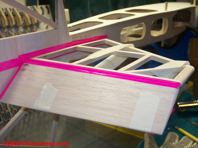

Ken, when you cover, do you have all of your hinged surfaces glued together already before you cover? If so, is that easy enough to do as a beginner?
Old 03-30-2006 | 09:07 AM
  #77
RCKen's Avatar
RCU Forum Manager/Admin
Posts: 28,241
Received 31 Likes on 27 Posts
From: Lawton, OK
Default RE: First Kit Build - Sig Somethin Extra

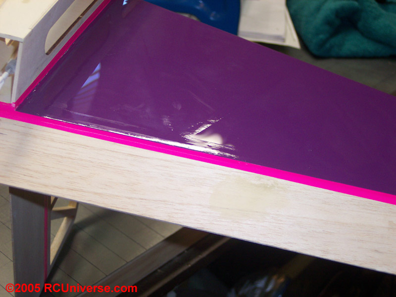

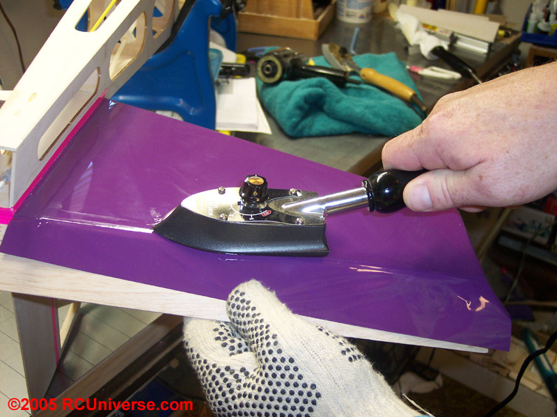

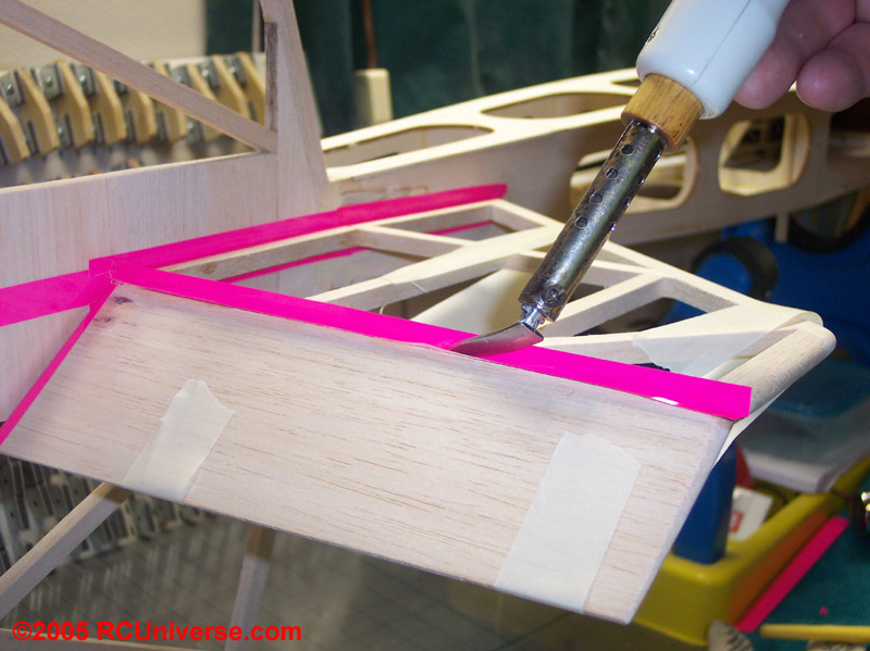

KC,
Yes, I attach all of the control surfaces and then I will cover them. Start off with sealing the gap first, and then cover the rest of the area. It's not any harder doing it this way than coverin them and attaching them. Look at the pictures and you'll get an idea of what to do.
Ken

KC: That's a pretty neat trick! I think I will try that on my next build.

I have always covered the pieces separately, and then hinged them. What I think would be the best way, is to cover the hidden areas first, install the hinges and attach the surfaces, then cover the remaining areas. What this buys you is complete coverage, smooth operating hinged surfaces, and most importantly, if using CA hinges, no CA dribbled all over the finished monokote. If I am using hinge points, I definitely do all the covering before assembly.

Ken: Thanks for the picture by picture tutorial, I think I'll give it a shot

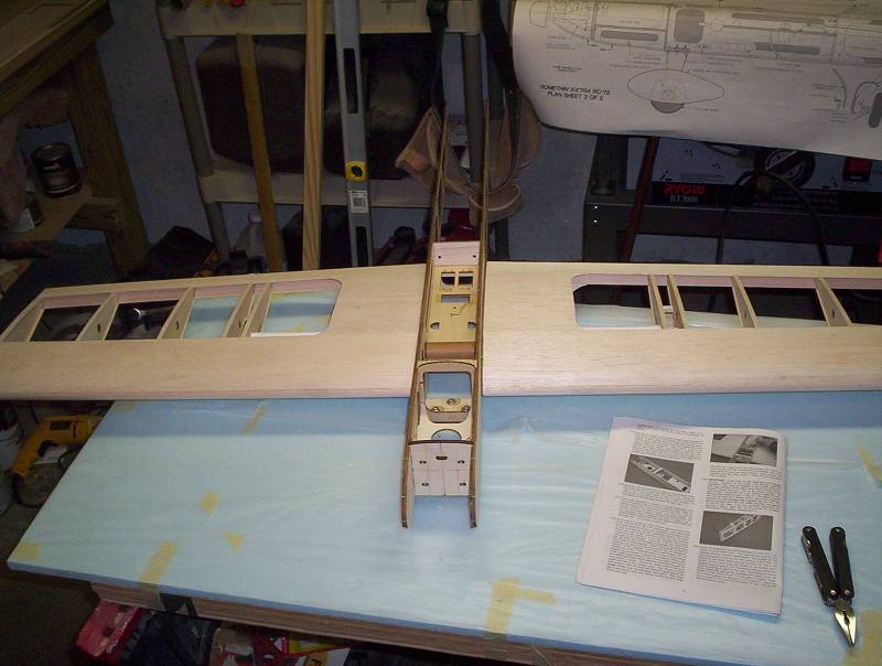

As for my build, I got the other wing built and the wings trued up to the side of the fuse.
Heres the pics!

When you get to the step that has you trim the rear dowels for your wing, I recommend leaving them a little longer. I think I made mine another 1/2" longer just for safe measure. I forget who it was, but somebody posted a few weeks back that the rear part of their wing came out just enough to pop off of the dowel & led to a rough landing.
Hey, that's starting to look like an airplane... Great job so far!

As for my plane, I didn't get nearly as much done as I wanted to today, but here's the progress.
I screwed up on F7 and put it in backwards, so I had to drill new holes thru it and then cover/patch the other 2 holes, seems to be alright otherwise
Beginners night at one of the local clubs tommorow, so I won't get any progress done tommorow probably, but I hope to get some time in on their trainer!!
Don't feel bad. I did the same thing on mine. Bad thing is I already built one before. Screwed that one up too. I built this one without reading the book. The only thing on the controls in the fuse is that the former in the rear of the cockpit will need the holes elongated towards the center to allow for servo arm swing.

KC: okay, now it's my turn.........
your work area is too clean!!
