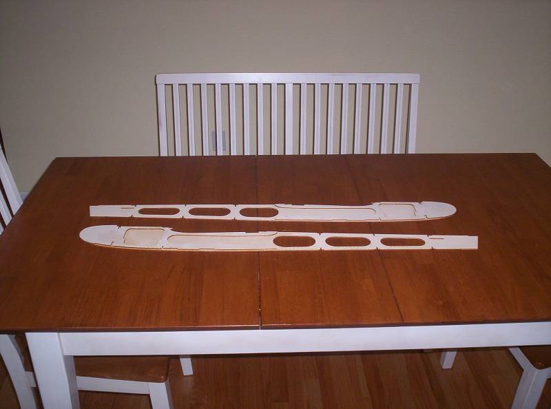

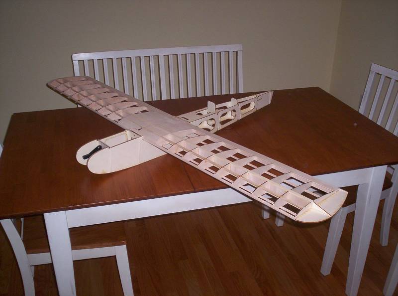

It's at this point when I looked at the wing and went oh sh%$#@$!. Like I said earlier, this wing is built almost identical to a 4 star wing, and I've built many 4 stars and on a 4 star you cut the servo opening on the top of the wing as it is a low wing plane. The mid star opening should be cut on the bottom of the wing, as you can see (for this step at least), my brain was in 4 star build mode and I cut the servo opening on the top instead of the bottom. The fix is easy and will in no way effect the strength of the wing. I glued scrap pieces of 1/16 balsa to the underside of the sheeting, I then cut pieces of sheeting to replace what was cut out, flipped the wing over and cut the new servo opening. The repaired section is an inch and a half wide, after the wing is joined to the fuse later on in construction, it will receive a fiberglass/epoxy wing wrap using 1 inch wide glass tape, so most of the repair will be hidden under the fiberglass tape, after filling and final sanding, you'll never know its there.

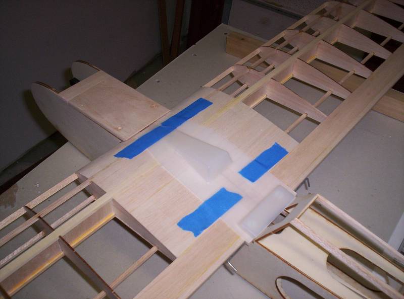

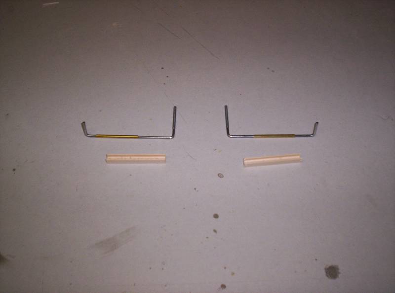

Next is the aileron torque rods. I checked against the plans and assembled the torque rods with the pre-slotted basswood blocks. I use as little glue as possible while still ensuring a good bond. Next, the whole assembly is glued to the TE and shaped. Wing construction stops here for now until the fuse is completed up to the point where we can fit the wing to the fuse.

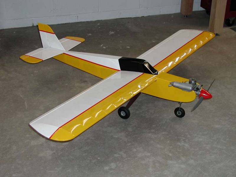

Mark, you'll love the 4 star, I built this one over the winter to race this year, I've never pylon raced so hopefully she'll stay in one piece! Maybe I'll get to turn some laps with you! I covered it to resemble "Rare Bear"

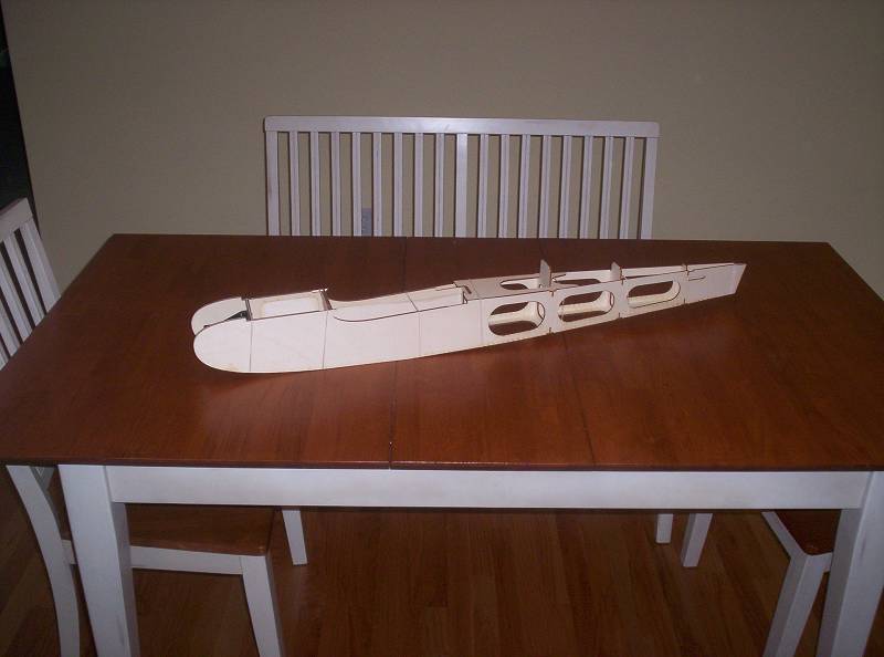

did some work on the fuselage tonight
whoops, no pictures

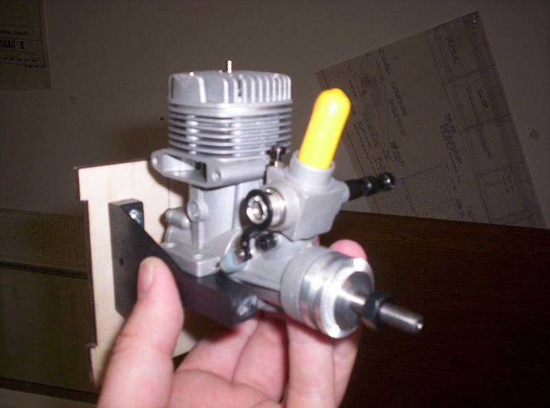

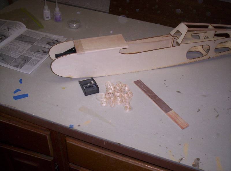

Lets start with the motor mount, it is a simple process of locating the center and thrust lines from the plans and laying those lines out on the firewall. Next, we determine the spacing of our mounting lugs on the engine, transfer those measurements to the firewall and mark and drill the mounting holes for the mounts. We then drill holes for the blind 6/32 blind nuts and install those on the rear of the firewall, I secured them with slow ca, then we bolt up the mounts and check out fit. You can see in the 2nd pic the hole for the throttle cable
ID:	461549   Click image for larger version
ID:	461550   Click image for larger version

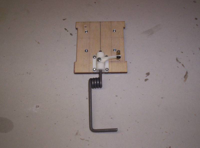

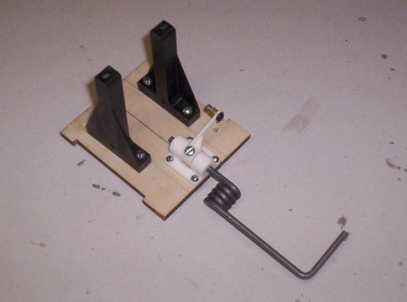

The nosewheel bracket is done the same way as the motor mounts, after the bracket was secure, I drilled the hole for the nosewheel steering cable
ID:	461552   Click image for larger version

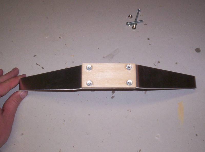

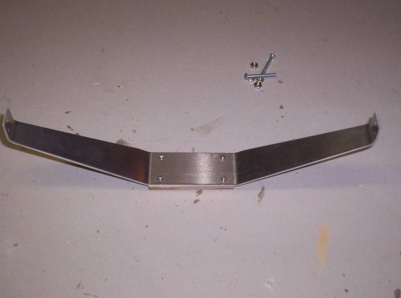

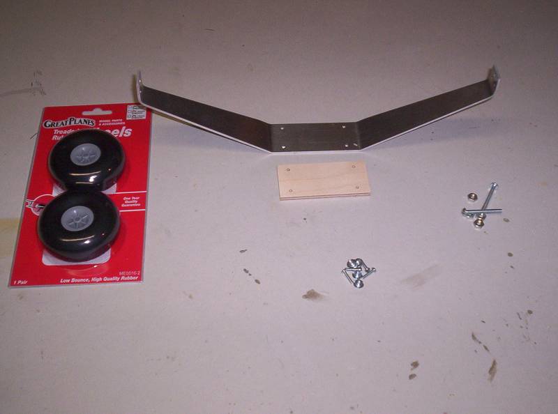

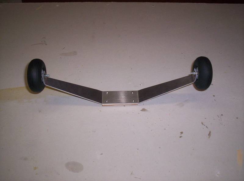

Pics of the main landing gear assembly
ID:	461557   Click image for larger version
ID:	461558   Click image for larger version
ID:	461559   Click image for larger version

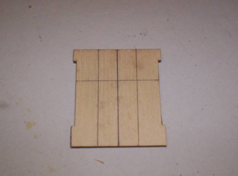

gluing the fuse doublers to the fuse sides (make sure to build a right and a left!)

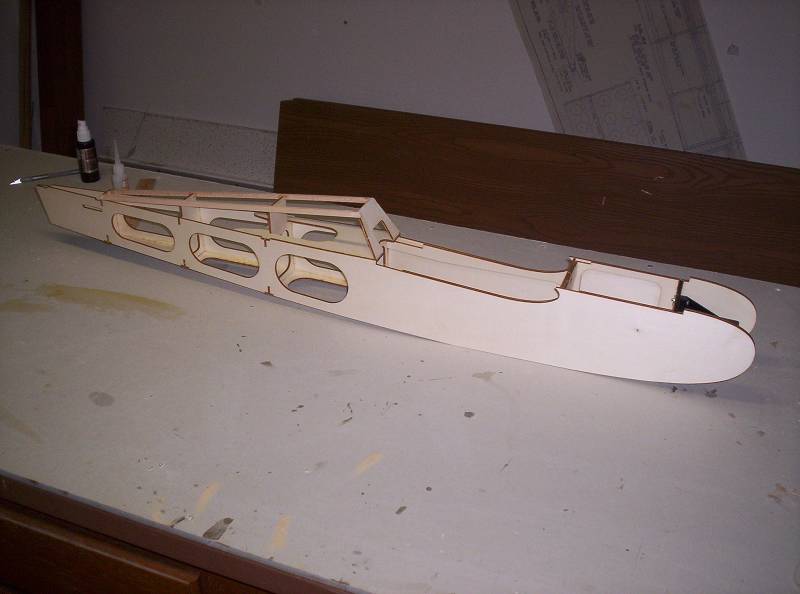

The fuse is dry fitted together in this picture. All the fuselage components key together into one another which really aids in building a straight and true aircraft

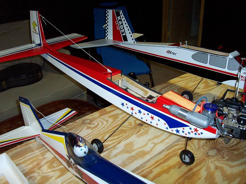

I like your 4 Star 40, the Big Bear Look !! I am all done with my Sig Sr. Falcon, I can't wait to get it out and fly it !! My plane that you got going is looking Outstanding !!

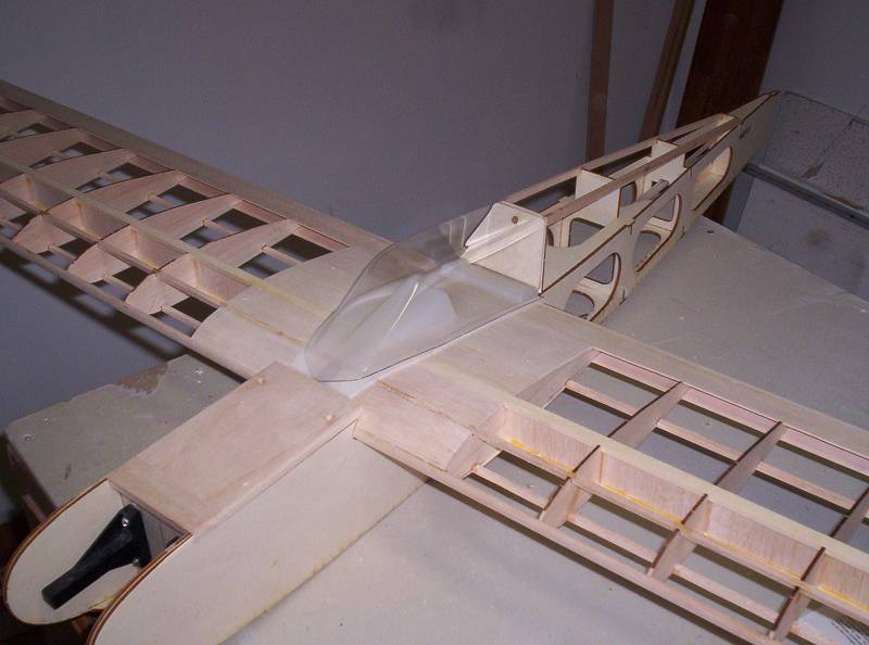

The following pictures show the process of assembling the front hatch. A 1 inch wide 1/4 thick balsa slab is glued at the firewall, this acts as a hold down for the front of the hatch. Next, a lite-ply tongue is glued to the front of the hatch, this slips under the balsa slab we just glued on. the 1/4 circle hatch mounts are added at the rear of the fuel tank compartment. The hatch is temporarily spot glued to the fuse for shaping
ID:	462649   Click image for larger version
ID:	462650   Click image for larger version
ID:	462651   Click image for larger version
Old 05-16-2006 | 10:09 PM
  #41
Joined: Oct 2004
Posts: 251
From: o\'fallon, MO
Default RE: Mid Star 40 Build Thread
Some more pics of the hatch. I drilled for the mounting holes by transferring measurements from the plans to the plane. 4-40 blind nuts are installed under the 1/4 circle tabs. I countersunk the holes in the hatch so the flat head screws would sit flush with the top of the hatch. The rear of the hatch needed to be trimed and contoured to match the leading edge of the wing.

Time for some cockpit and canopy work. The cockpit floor is moulded ABS plastic that must be trimmed to fit. We also fit the rear headrest to the cockpit froor and drill for the 1/4 inch dowel that helps keep the canopy assembly in place.
ID:	464289   Click image for larger version
ID:	464290   Click image for larger version
Old 05-20-2006 | 10:27 PM
  #45
Joined: Oct 2004
Posts: 251
From: o\'fallon, MO
Next we trial fit the canopy to the cockpit floor and trim until we have a good fit.

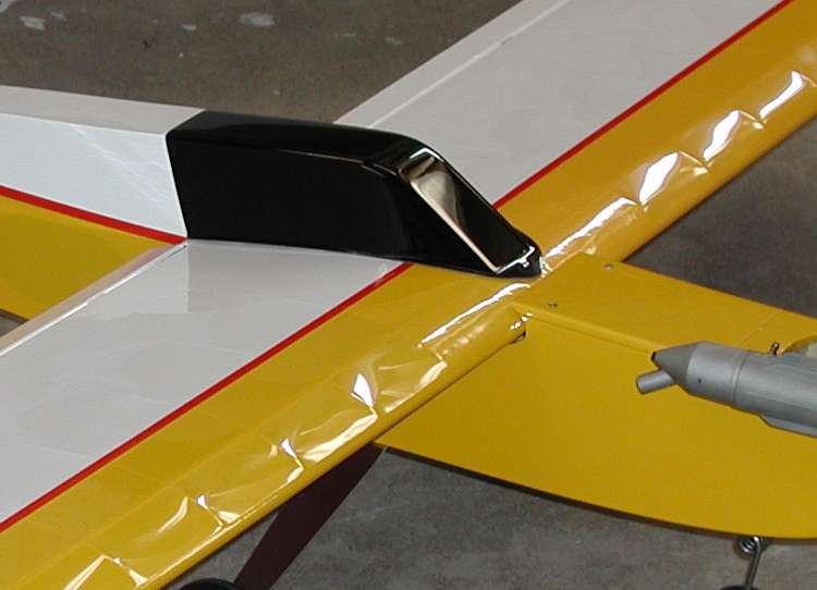

If you paint the canopy black (like I did on mine) make sure you put some vent holes in the back of the canopy (and some matching holes in the former) to let hot air out of the canopy. I didn't and the front of the canopy collapsed inword when the trapped heat inside the canopy softened the plastic on a hot summer day. See the attached picture.

Thanks radioflyer!, that is advise well taken.....I'm now thinking I better put a vent hole in my 4 star
