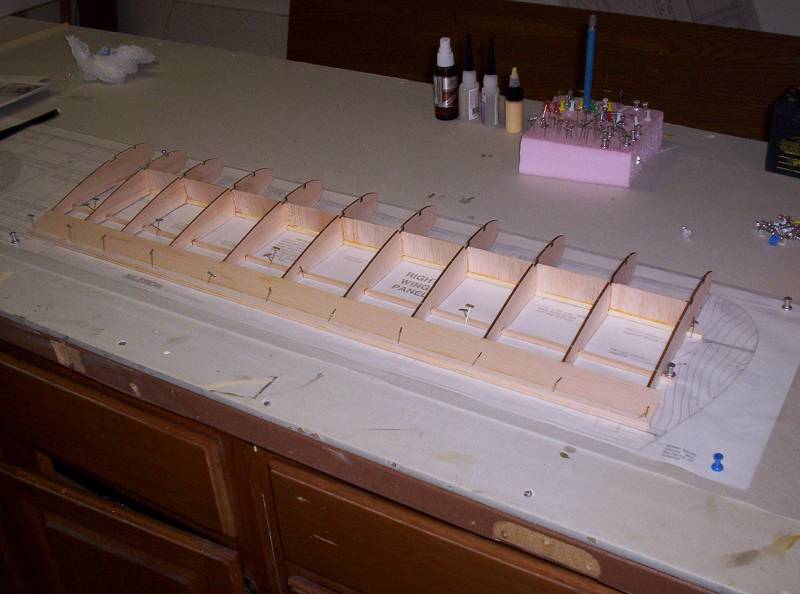

I got some more work done on the right wing tonight. The 3/16 shear webs were added to the wing. The integrity of the wing is dependent on the installation of the shear webs so I am careful to ensure good glue joints. After the shear webs had dried, I added the top main spar making sure it was fully seated in the wing ribs. I then added the 3/16 square top turbulator spar and the leading edge material, which is a 5/16 square stick that will need to be shaped later on.

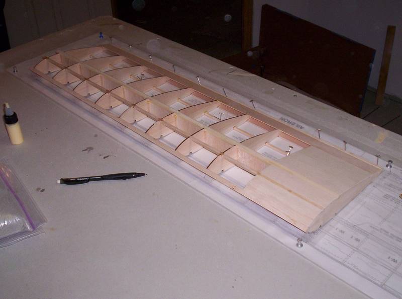

More work on the wing tonight. I added the bottom turbulator spar along with the bottom wing sheeting. The middle bay is left off until the wing dowell and canopy hold down block are added. After that job was completed I shaped the leading edge and trailing edge. I also cut off the spar, L/E, T/E and sheeting overhang at the wing root.

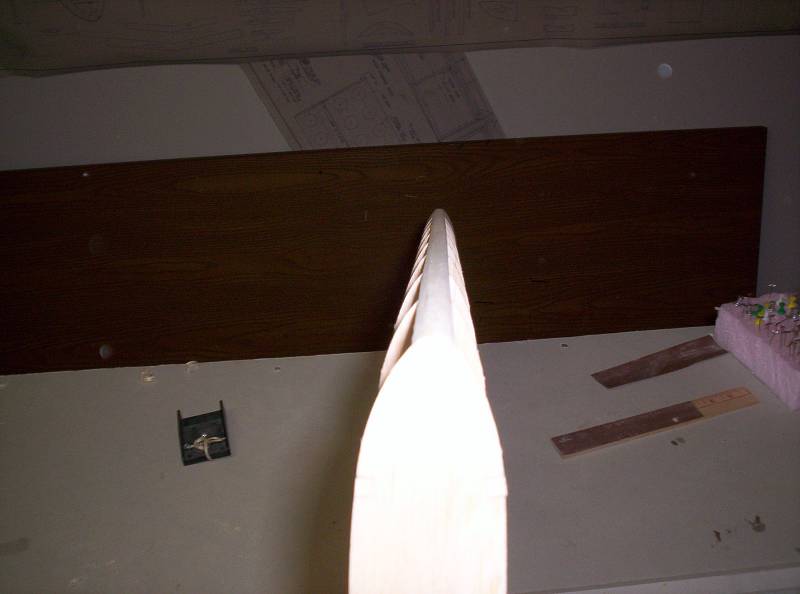

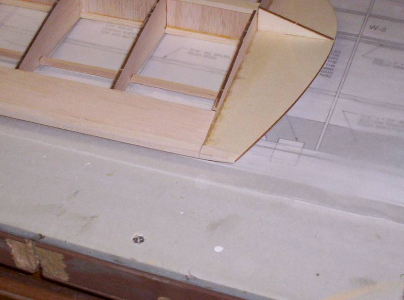

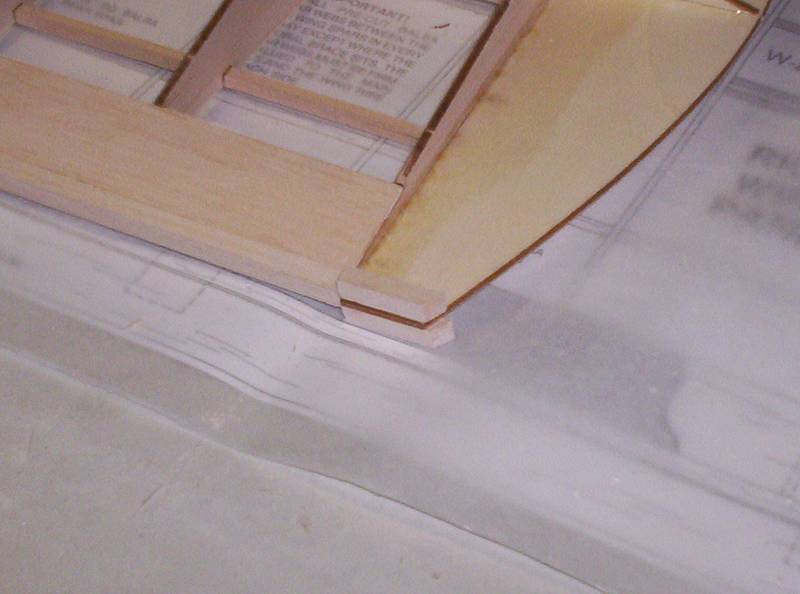

The wing tips are next. I assembled the lite-ply wing tips and then attached them to the wing root. Scrap pieces of balsa were used to blend the TE into the wing tips

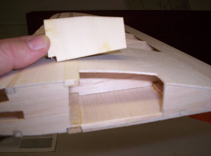

Kit-supplied templates were used to make cut-outs for the canopy hold down block, wing dowel and aileron servo. The aileron servo cut-out also serves as an opening to attach the dihedral brace later
