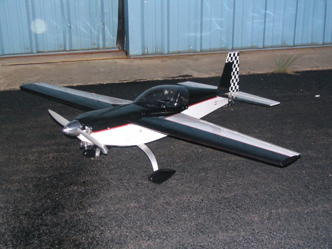

The Extra that I recently finished had a really short life.I rolled it into the ground on its 4th trip because I screwed with the radio and ended up reversing the ailerons.Anyway,got home tonite and the brown truck had left me a brand new kit at the doorstep.Almost got the hori stab framed already.It will be the same as the black/white one w/ saito 1.50,fut 7CAP and MPI on board.These are the best all around planes Ive ever flown and I just had to have another.Maybe I can get some pics as it comes together.Anyone with any hints on it,this is the 3rd one Ive had,and the parts are never quite the size of the prints especially on the stabs.

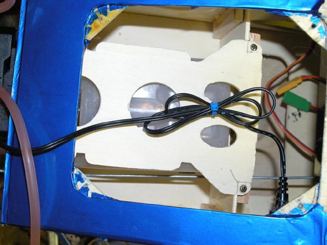

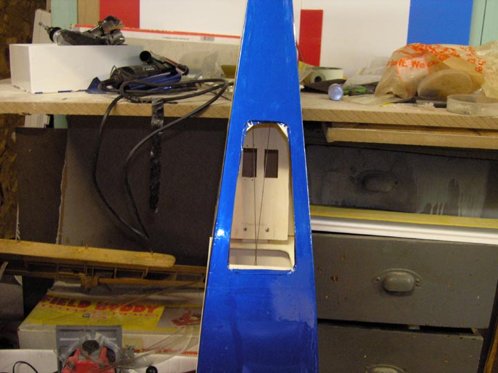

AWWW I remember when you finished it, So sorry to hear this, A few mods I did with the 150 for the CG is mount the servos behind the wing and used the punch-out as a access panel {see pic} I also mounted some blocks so I could screw the tank floor in instead of gluing it so I can get the tank out and change fuel lines if needed much easier but no picks on that one {sorry} I also used the front punchout the same way so I just unscrew the panel and I can get right to it though I do need to remove the cowl. But I'm sure you get the idea from the servo tray in the pic. Hope the build goes quickly for you and I can get some pics of the tank installation if you need them. I love my extra.

How is the build going 8D3, I got a few pics of the tank install, All I did was mount a hordwood block to the former I was sapposed to glue it to and put a few screws in and the 17oz was a perfect fit, I've only dead sticked it once because I was really wringing it out that day and forgot to turn my timer on and it died on the final turn to approach and it actually glides much better than I expected. This is tied for my favorate plane to fly with my Hog bipe. Keep us posted on the build and if there is anything I can assist with just let me know. OH and did you angle the Landing gear forward on the last one, It put the wheels about an inch forward on mine and I have yet to nose it over, Heck I'm still on the first prop. (I probably just jinxed myself now did'nt I)
