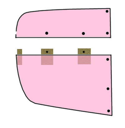

I am about to build a Dynaflite "Fly Baby",1/4 scale and am going to install an OS 120 twin cylinder engine
How are the two halves joined and properly held together and disassembled for maintaince?
I have some ideas but I could be wrong so I need the advice of someone who has done it before.

Split the cowl, then add blocks to the bottom half. You can reinforce them with some fiberglass cloth and CA or epoxy, or resin. Then the top can be screwed onto the blocks.

I've talked to a few of my club members, not all of them,( total of 285 members)and received various answers, so I sent for a cowl from StansFiber Tech in Calif.
I explained to Stan what I intended to do and he said he would for a small sum MOLD me a two piece cowl with a built- in lip that the top part of the cowl would sit on
Epoxy some 4-40 blind nuts on the lip and youv'e got the perfect fit.
That was the perfect answer to a problem.
