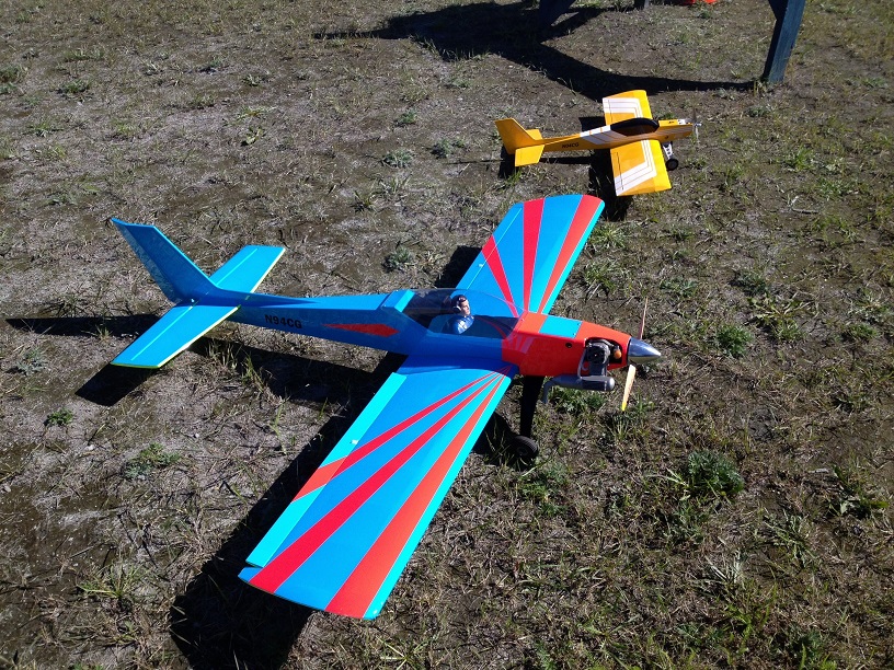

Interesting about the balance problems. When I built mine, I added an inch to both the rudder and elevator, and cowled the engine, an OS .61 FX, and with the battery up under the fuel tank, it balanced perfectly without any weight. It flies very nicely too!

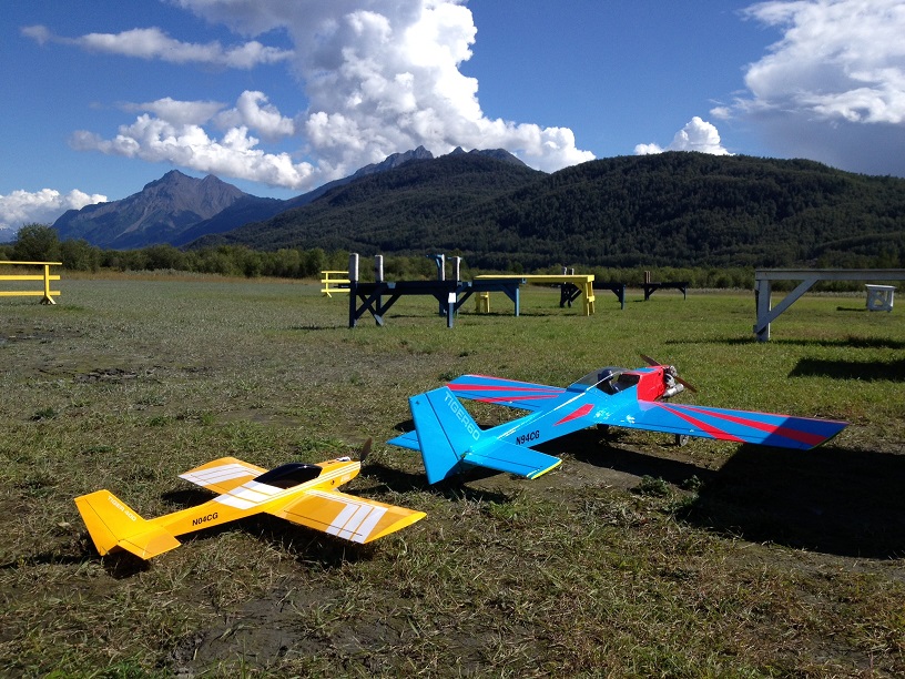

Hi George,
Mine flies pretty well! I did alter a few things, such as replacing the landing gear, and swapping the motor to a Park 400 outrunner. When I fly the Tigers back-to-back, I have to remember to keep the 400 in close, as it is easy to lose in the sky!

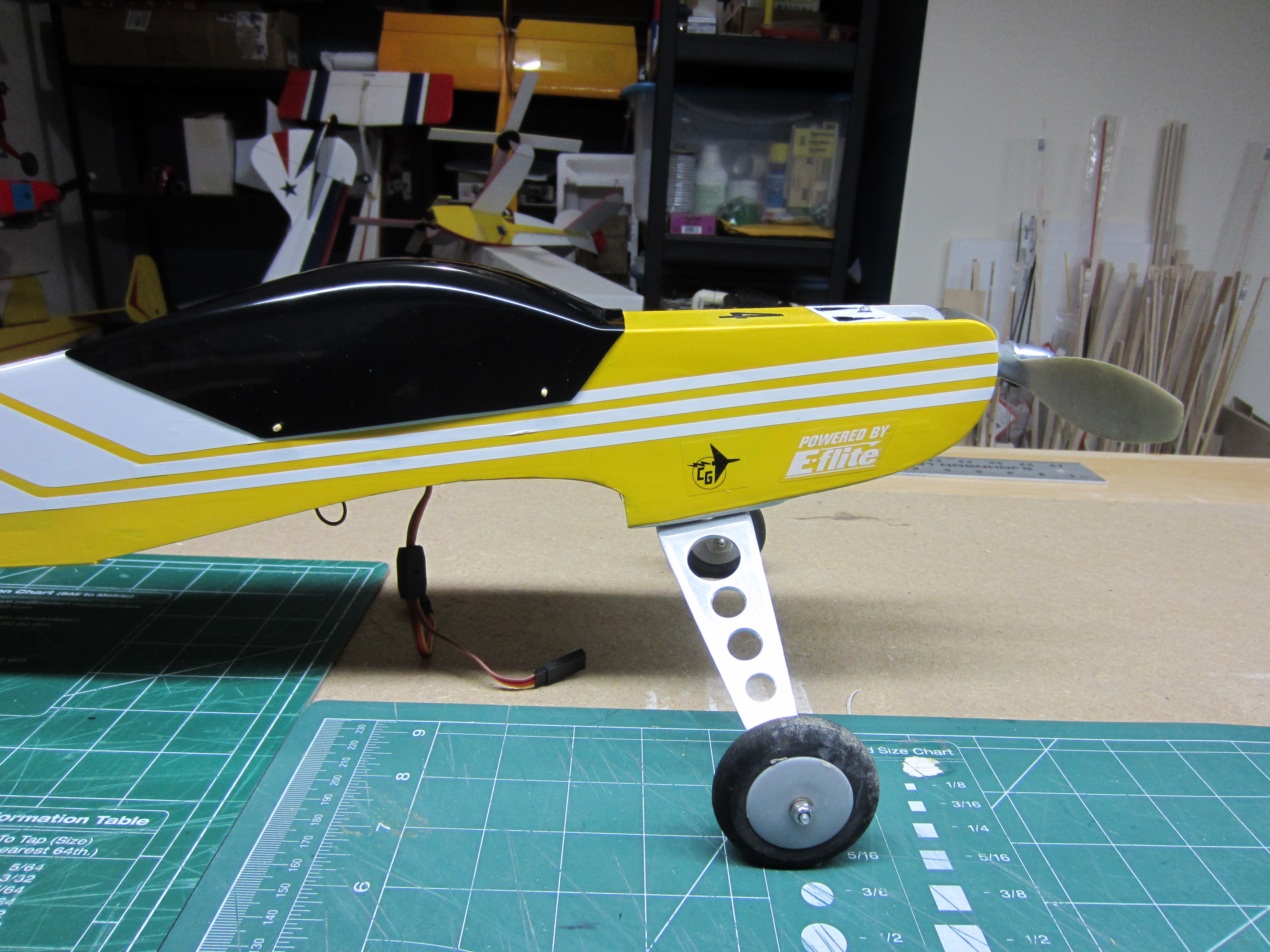

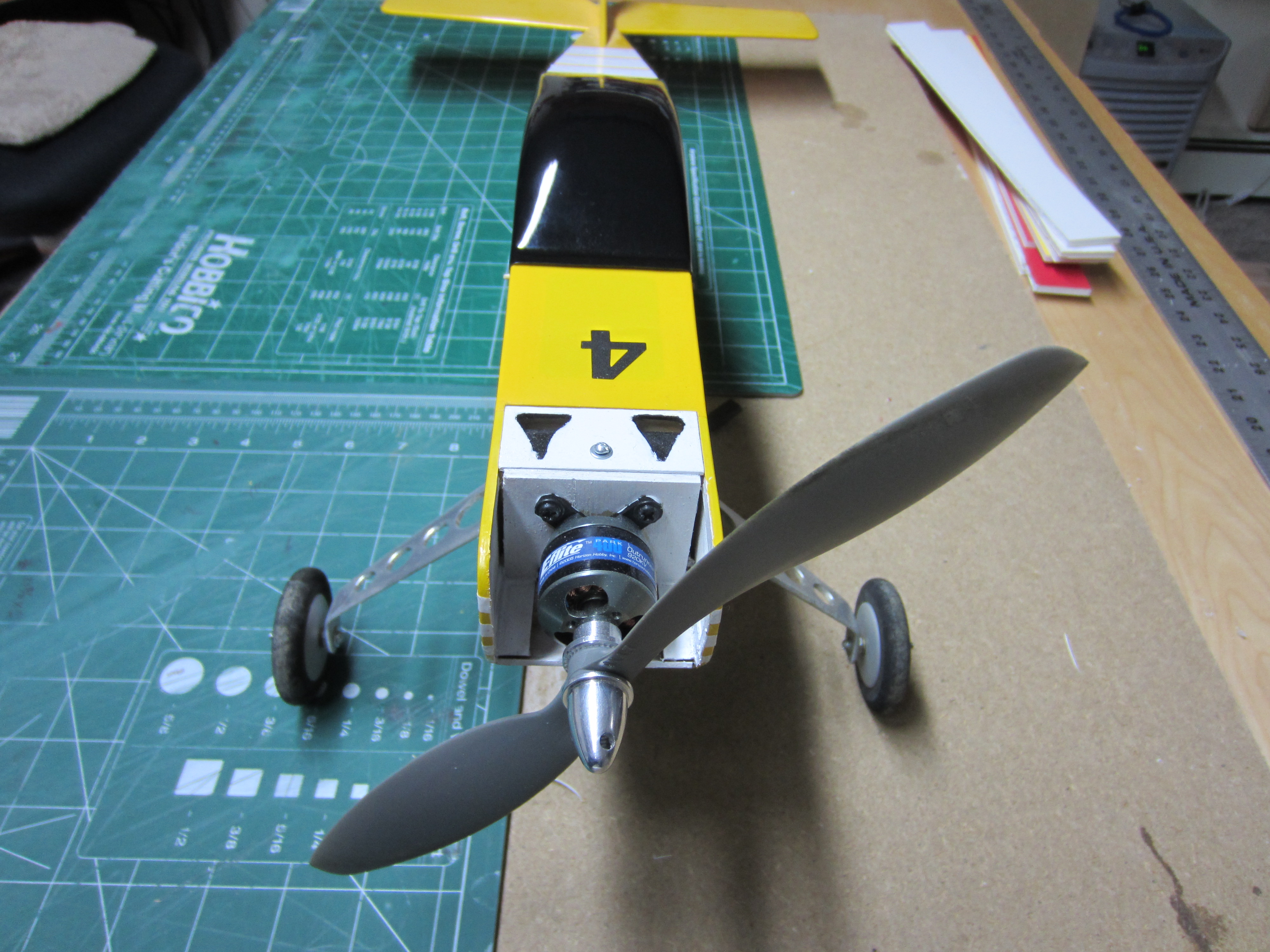

Hi George,
On mine, I use an E-Flite Park 400, 920kV motor, a 1900 or 2100maH battery, and a GWS 9 x 4.7 prop. I don't recall the ESC. The landing gear is regular dural gear that I lightened up a bunch. I put all Hi-Tec HS-55 servos in the plane. I also put a swiveling tail wheel on it, but the skid might be even better.
I must say this thing scoots along pretty well! It's amazing how closely it's flight matches both my Tiger II and the Tiger 60.
Jeff

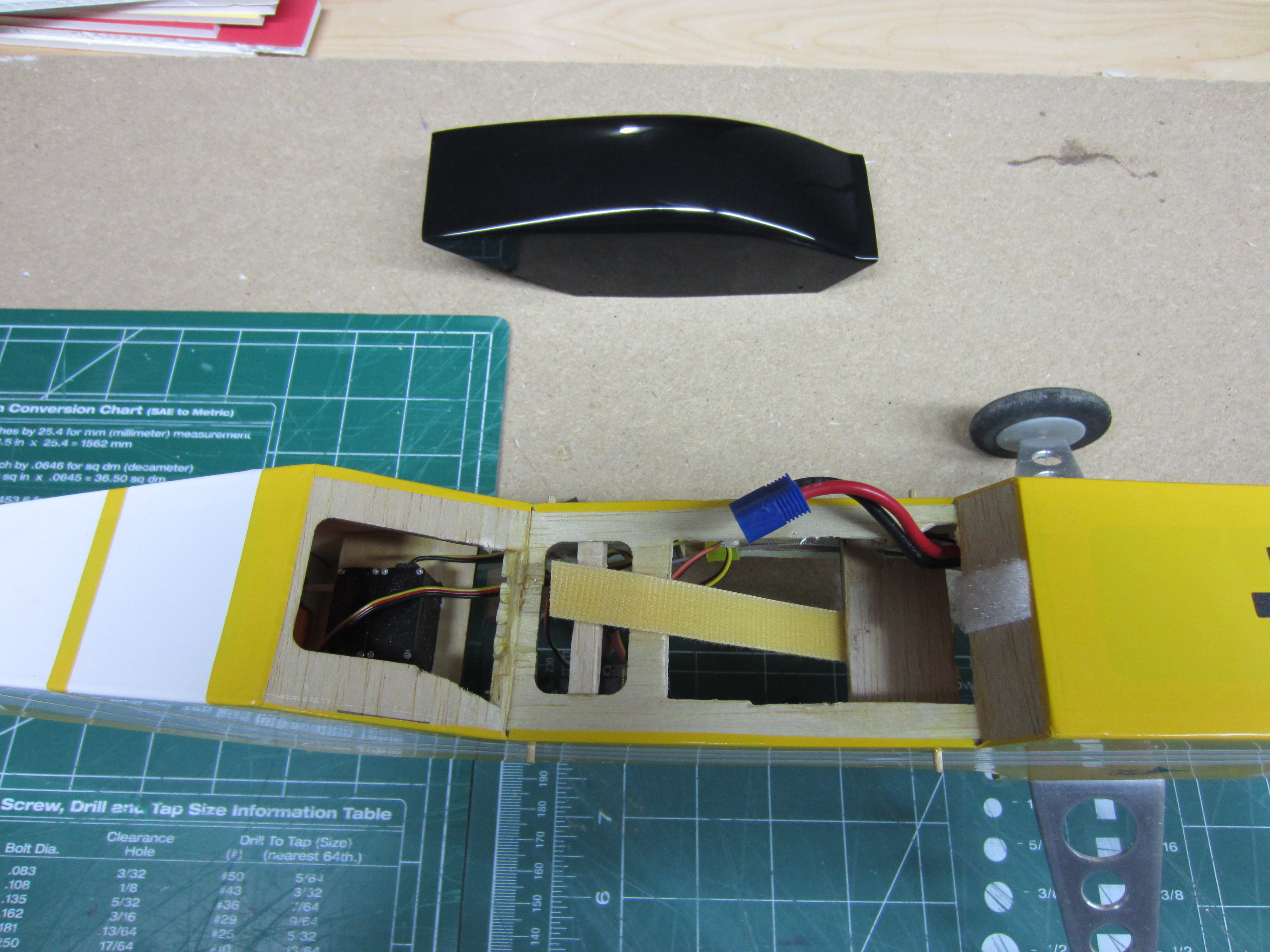

Hey there George,
I used short lengths of bamboo skewers in each corner on mine. The skewers are glued into the fuse, and you just pull the canopy open a bit to fit over the skewers. Works a treat!
Jeff

Old 09-19-2014 | 08:55 AM
  #459
georgewaldrop's Avatar
My Feedback: (28)
Joined: May 2003
Posts: 155
From: Mustang, OK
Nice...May have to try that. I wasn't sure about the tape, and I thought about magnets, but that would add a small bit of weight to add the structure...the skewers looks very good!
