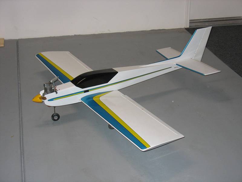

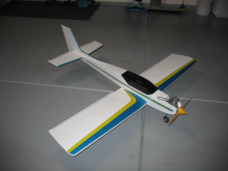

hello everyone,i have been following this post with great interest.would just like to say its been quite helpful and am posting some pictures of my tiger 60 deluxe.its been kit built,completely sheeted,glassed and painted.has an OS 91 fs,13x6 zinger,robart retracts.

freddy_s, sweet looking plane!! How much does she weigh? Have you flown her yet? If so, how' does she fly?

Very nice indeed! I too am curious on the weight of your plane...[8D]
