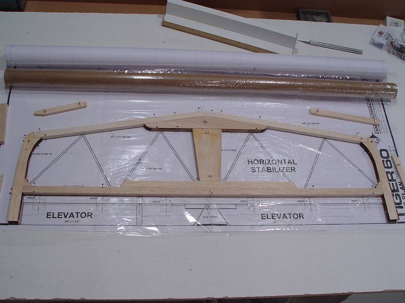

After the untimely passing of my Tigger 2, I felt the need to have another Tiger in the hangar simply because it was such a great plane to fly. I had initially thought that the T2 was repairable, but the extent of the internal damage would have involved almost a complete rebuild. So I figured if I'm going to put that much effort into another one, it might as well be a bigger one. (That and a deal too good to pass up on a Saito .82) So I'm also going to share the construction progress as I make a few minor modifications along the way. My plans at this point (always subject to change) include larger control surfaces in the tail, pull-pull rudder, cowled side-mount engine, shorter wing with slightly less dihedral, and tail-dragger landing gear. Much of this is patterned after the modifications described in the Sept. 2006 Flying Models article by Alan Allman titled "Old Al's Tiger 60 Mods"
This will probably be a slow process as it tends to take me a while to find enough time to make substantial progress, but my goal is to have this done by spring.
Off we go...
I've barely started on the horizontal stab, but the first picture shows how the hinge stick is moved forward 1/2" to allow for larger elevator surfaces.
BTW - has anyone seen a Pitts muffler for the Saito .82?

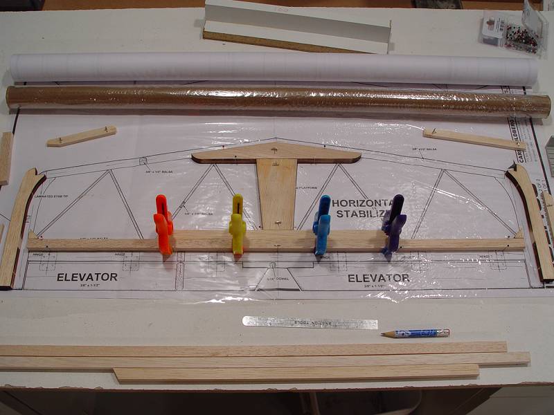

A little more progress on the stab last night. I got the perimiter frame glued up and started on the internal trussing. I had to trim the internal corner gusset from the end pieces to accomodate the relocated hinge stick. This also caused the internal bracing to not align itself exactly per the plans. I had been considering tapering the elevator halvs, and while digging through my balsa pile, I came across some aileron stock thta is almost the exact width needed for the elevators, so that task may have just been simplified significantly. More on that after the stab is completely framed...

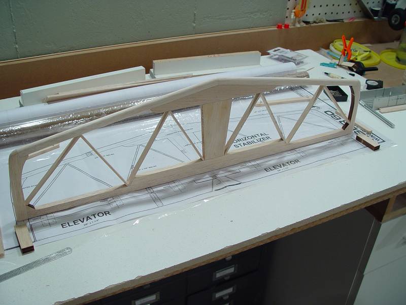

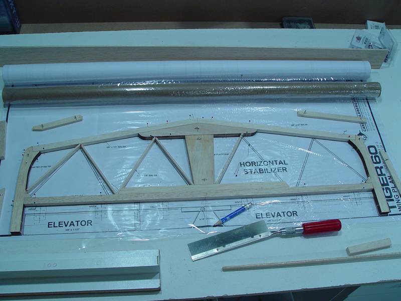

I was able to finish up the H-stab this afternoon. I added the rest of the internal bracing, trimmed the tabs at the elevator edges since I'm going to use full width elevator halves, and rounded the edges. The elevator halves are going to be made from 3/8x2" trailing edge stock as it is just the right width and thickness and is already tapered. I'll finish up the elevators after I have the tail group framed and can dry-fit everything to the fuselage. I was also able to get the V-stab is also framed up and ready to start on the rudder. I'm going to extend the rudder by 1.5" on the top edge and 2.5" on the bottom edge in an attempt to achieve some more rudder authority. The last picture shows the rudder trailing edge close to the actual position.

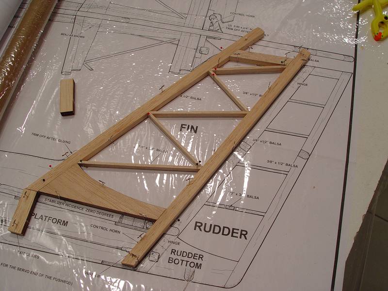

It's been a busy week with the holiday and all, so progeess has been a little slow here. But I got the rest of the tail feathers framed up this afternoon. I decided to deviate from my original plan on the rudder. Instead of adding on th the rear with additional framing, I decided to just add a section of the same 2" trailing edge stock that I'm using for the elevators. With a slight re-bevel of the leading edge to make the angle symmetrical, it adds a nice even 2" taper to the rear of the rudder. Some minor finish sanding should clean it up nicely.

Hi Krossk
Why would you add 2 inchs on the rudder , I know that it would be for more control for the tail surface . From hear-say and seeing it the the tiger is tail heavy , because it s fusaloge is long . A friend of mine built his and with regular tri-gear , sitting on the ground (not on the cg point ) , the plane was very light on the nose . I was just wondering why ?
Michel ( Mike )[8D]

ORIGINAL: michel gravelle
Hi Krossk
Michel ( Mike )[8D]
While the Tiger series is typically very steady tracking and capable of precision aerobatics, they are also known for weak rudder authority and poor ability to sustain knife-edge flight. (My Tiger 2 exhibited these characteristics) My intent by adding rudder is to improve rudder control. My additions are still miniscule compared to what the modification article I referenced earlier recommended. I just didn't like the way that one looked, so I am still trying to preserve the original lines.
As far as balance goes, I intend to add a built-up cowl and aluminum spinner to the nose, which should adequately offset the minimal addition to the rudder. There's also plenty of room for a large battery under the fuel tank if necessary.

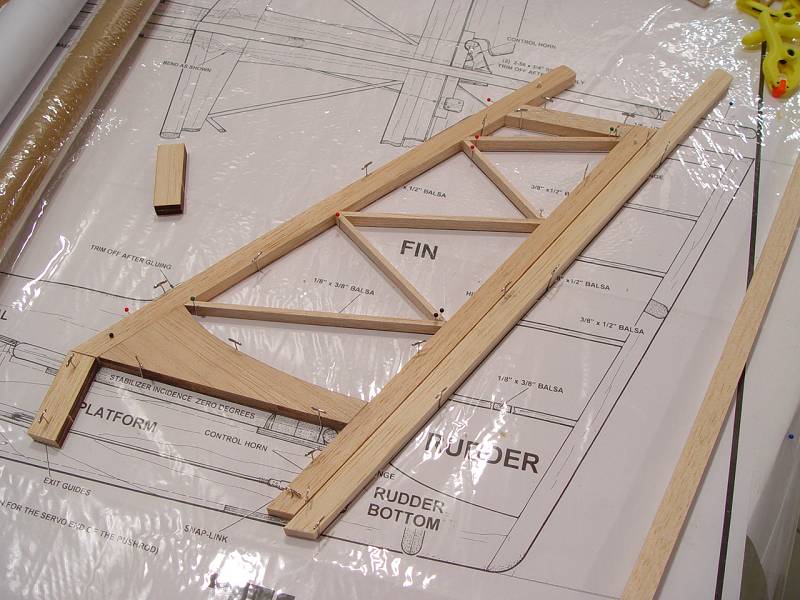

I've pretty much finished up the basic construction of the V-fin and rudder. I still need to bevel the hinge line and slit the hinges, but that will come closer to final assembly of the tail group. The next step is to modify the wing plans to shorten and strengthen the wing. I was able to obtain a second set of plans from a friend, which makes it nice to be able to mark up a set without altering my originals. As described in the article, I will be changing the rib spacing to 3" and adding 3 more ribs per side, while still shortening the length by one bay on each side. Hopefully I'll have some build time later this afternoon and can get some pics posted. Stay tuned...
