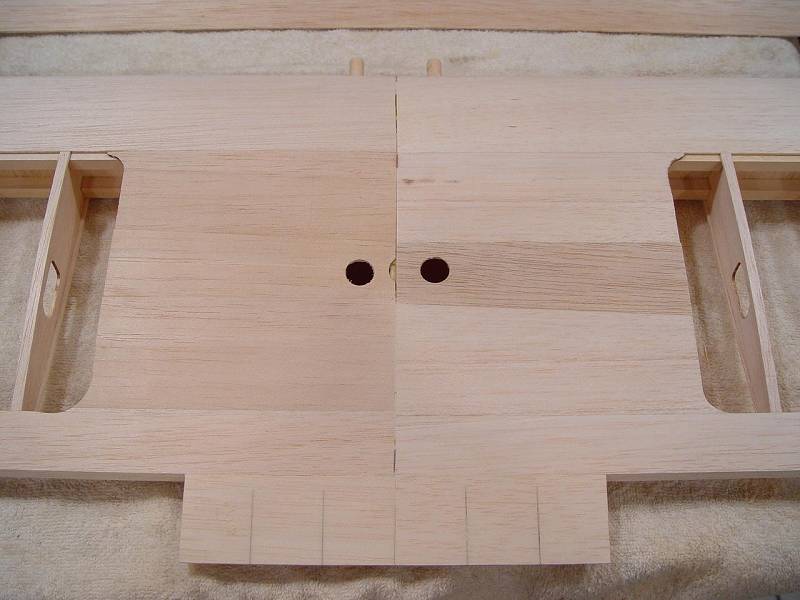

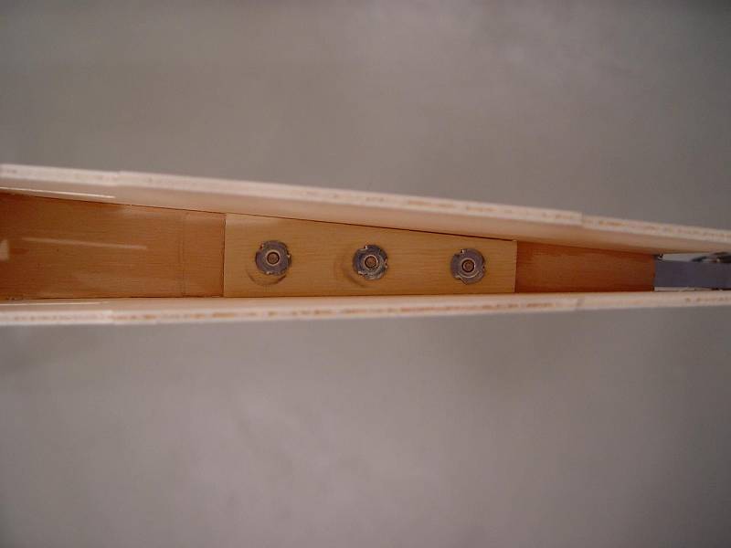

I made some significant progress on the wing today. I was able to get the internal center structure and bottom sheeting completed.
Pics #1-2 I changed the single wing pin to double pins due to the documented tendency to break the fuse from excess force at the center pin location. I did this by making an additional doubler that is epoxied to the front wing joiner, but drilled to accept the rear of the wing pins. The Leading edge was drilled with sharpened brass tubing in my hand drill. Once the pins were epoxied in place, I added additional lite ply half-ribs between the leading edge and the doubler and also epoxied to the pins.
Pic #3 The rear center rib was laminated and installed per the original plan.

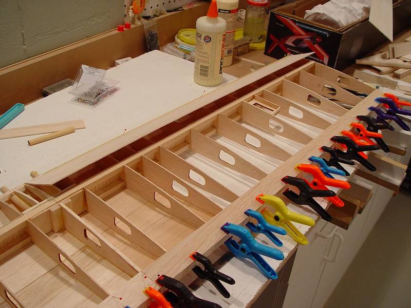

Pics #5-6 When getting ready to install the leading edge sheeting, I realized that there was nothing to support the center joint with the change in wing pin location, so I installed the lower half of the original pin support rib to provide a structural gluing surface for the sheeting. Then I was able to start by gluing the front edge of the sheeting. I've had very good luck by doing the leading edge sheeting in two steps. First glue the sheeting to the leading edge and secure it with masking tape - just like edge gluing sheets for larger areas. Then once that has cured, the sheeting is glued over the ribs and clamped to the spar.
Pic #7 The last of the bottom sheeting installed and drying for the night.

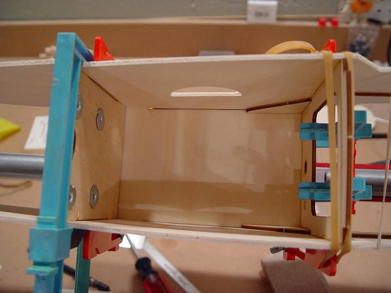

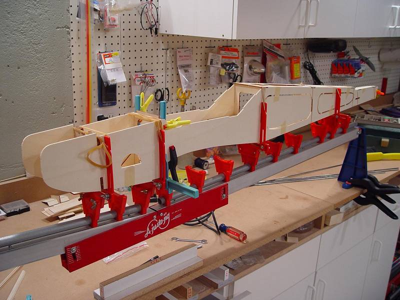

Been a while since any real progress has been made - work, family, etc.
Pics 1-2 Servo mounts and cap strips installed and wing rough sanded.
Pic 3 Center trailing edge installed. I trimmed 1.5" off the outer ends of the t/e strip to increase the overall length of the ailerons. I also encountered the same problems that others have with the thickness of the wing t/e after the sheeting is installed. I ended up sheeting the t/e pieces with the leftover shear web stock from the kit (hence the stripes in the pieces). There was also a fair amount of sanding required on the wing t/e sheeting to reduce the thickness to match the aileron stock which was closer to the wing thickness than the inner t/e pieces.
Pic 4 Some of the initial fuse pieces laminated - firewall and both fuse sides with the doublers.

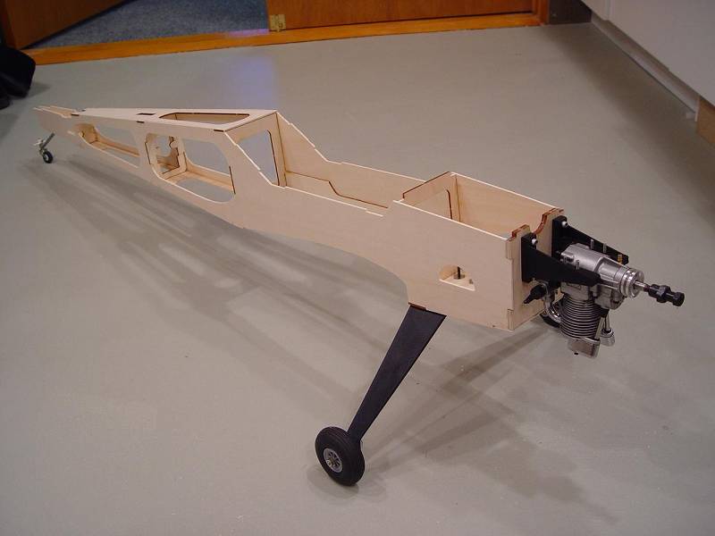

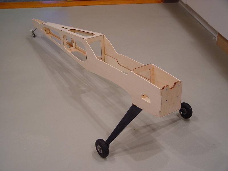

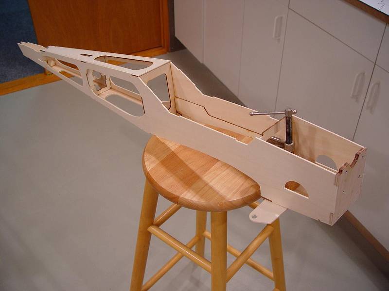

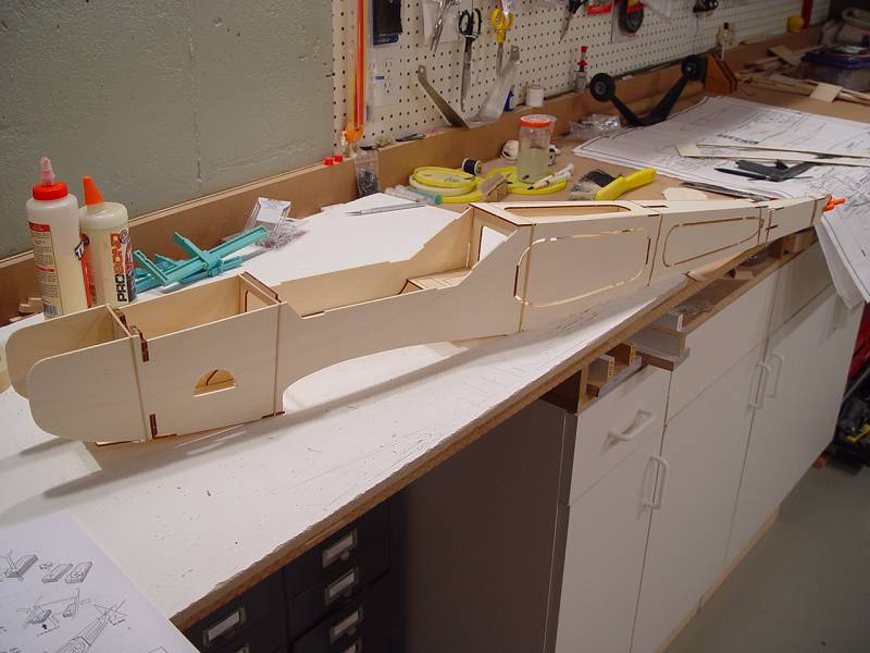

I finally made it back to the bench thanks to all the former presidents whom we so graciously honor with the day off work!
I got the engine mount drilled and located on the firewall for the inverted Saito. I'm using the kit provided engine mount It took a while to get it located properly so the prop shaft would still be centered with the 2 degrees right thrust factored in.
Once that was taken care of, it was on to the rest of the fuselage. The laser cut pieces are very clean, however The first thing I quickly discovered that since most of the larger fuse parts are cut with a router, none of the interior corners were square. Therefore, all of the notches for the interlocking tabs need to have the internal corners squared up so the mating tabs will seat properly. Until that is done, nothing fits worth a hoot. So I only got as far as the initial dry fit.

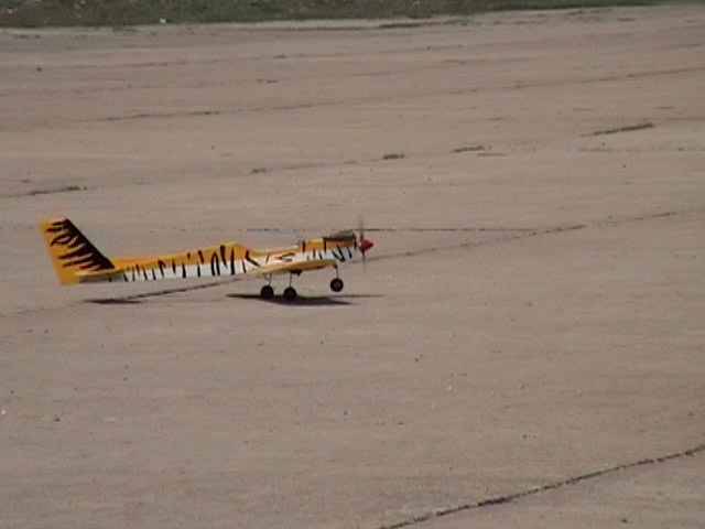

I just finished my Tiger 60, we had a few rainy days here, I have 15 flights so far, powered mine with a new TT PRO 61 Heli engine with a OS 40E Carb and Tuned Pipe turning a 13x4W APC at 16K on the ground (gives it a little snarl) it hovers below half throttle and verticle is out of sight, made the rudder larger+ elevator and 3D throws helps with hovering. It flies great and came out at 7lbs 8oz but I had to add 4oz in the nose to balance, I reinforced the rear fuse it looked weak and sanded (tapered) the tailfins down to reduce some weight, I bent the main gear back but it's still light on the nosewheel when low on fuel. All in all a great flier with no bad habits.

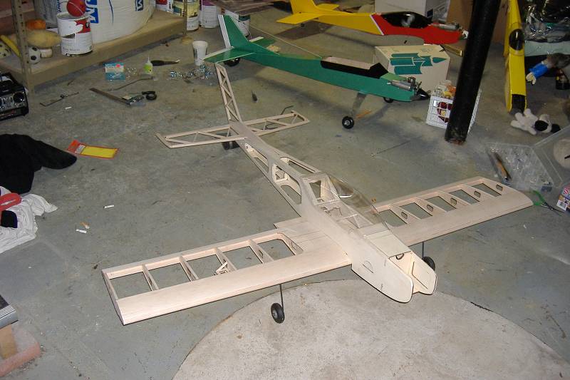

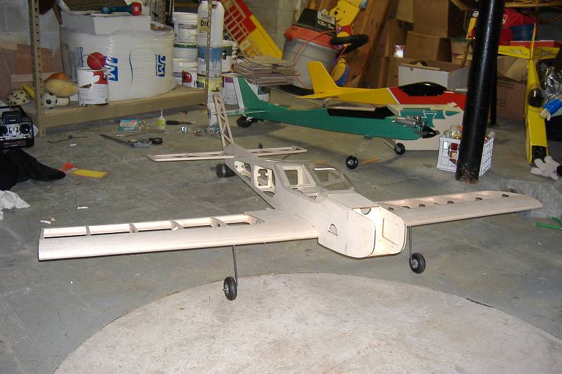

Kross, I have been very busy lately and haven't had much time for the Tiger 60 either. Here are some pics of mine taken a little while ago. I am using an OS.61 SF inverted and building a cowl. I didn't realize how much I took off the wing until I sat it next to my tiger2
I love the way it looks with the main gear still in the wings but moved in front of the main spar, warbird style.

I lost it in 2005 after a radio glitch. I also participated in competitions with it, and it was a successful flier.
I am now being inspired to build another .. and deciding on whther to build a 40 size or a 60 size ..

Nice looking Tiger that was - I know that feeling of loss all too well [sm=cry_smile.gif]
I liked my T2 so much that I just had to have another Tiger in the hangar. Overall, I thought the kit quality of the T2 was better than the T60. Actually, I would have loved to have the wing from the 60 and the fuse from the 2. But then I'm comparing a 12 year old 2 kit to a new 60 kit. In any case, I'm just glad to have another in the works.

Got back on track with the fuse construction today It had been sitting on the bench for a week with just tape and rubber bands keeping it together.
Pic 1: I got out the Adjust-O-Jig with the fuse attachment and set everything up to insure that the fuse is straight and square before gluing. I normally prefer to build with Tite-Bond wood glue, but the way that this fuse goes together almost mandates the use of CA. So I gave in and used CA to glue the fuse together.
Pic 2: The firewall was glued in using 30 min. epoxy and will get further reinforcement with tri-stock when the fuel tank compartment is sealed.
Pic 3: The framed up fuse with the main landing gear reinforcement plate drying. IT is also glued in with 30 min. epoxy.
The fuse cheeks have been removed in preparation for the built-up cowl.
Pic 4: The tail wheel is also attached with a reinforcement plate and 4-40 blind nuts.
Pic 5: Tail wheel test fit.
Pic 6: Main gear mounted. The gear is a set of glass-filled nylon mains from Carl Goldberg.
Pic 7: Framed fuse with landing gear and inverted engine mounted. The rear stab plate will get mounted when it is possible to set the stab incidence. At present, the plate sits lower than the fuse sides, so I want to insure that the stab mount is flat and at the appropriate incidence.
