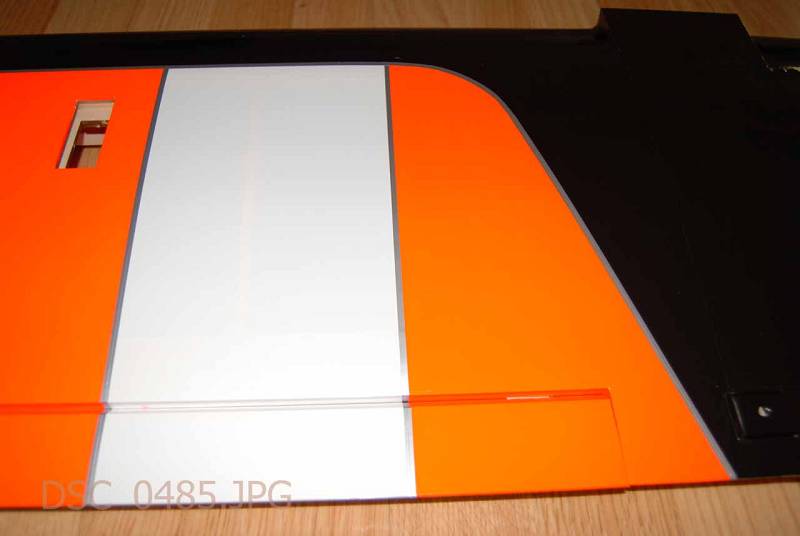

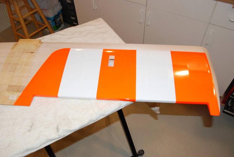

Finally - progress to share!
Pic #1-Rudder covered in Ultracote Charcoal Pearl
Pic #2-Bottom of left wing partially covered in Ultracote White and Neon Orange
The next step will be to add the Charcoal Pearl to the uncovered region and trim with Ultracote Silver.

Thanks - I'm really trying to get this one finished up by early summer so I can enjoy it this season.
But I have been known to take as long to cover a model as I spend building it!

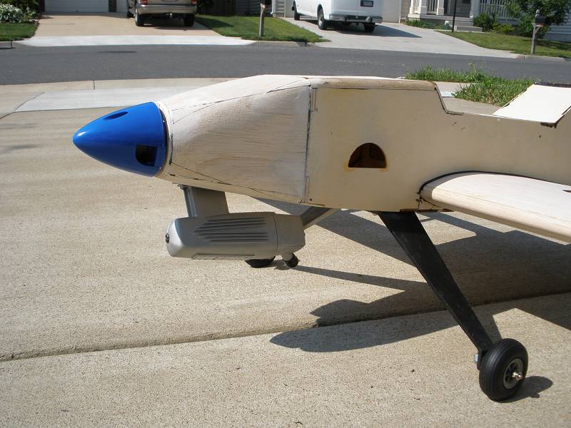

Thanks for the tip on the tail wiggle. I took your advice and glued that last piece permanently into the hole.
The other significant mod I did is to rotate the engine so the muffler hangs underneath the fuse and points straight to the ground, and then put a cowl on here. Here are some current photos. I still need to build the tail structures, sand everything, cover, etc. Think I'm going to cover in all white, and then paint on the pattern.

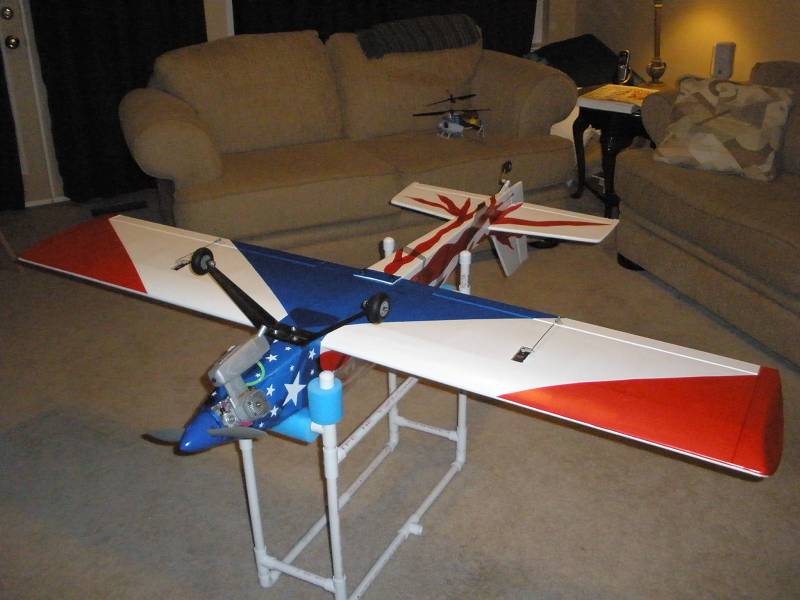

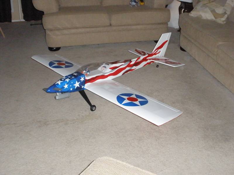

And she's ready to roar!!! Weighing in at 8 LBS 10 OZ. I balanced her side to side before I covered her. Just finished putting her together and checked front to back and she balanced perfectly without adding any additional weight. My receiver pack is two A123 cells from a DeWalt pack connected in a 2S1P configuration and mounted right behind the firewall.
The only real mods are the cowl, which made me rotate the engine, and I took out all but about 1 inch of dihedral.
Maiden is planned for tomorrow morning! Perfect timing for a Patriotic Tiger!
Here are some shots.
Tom

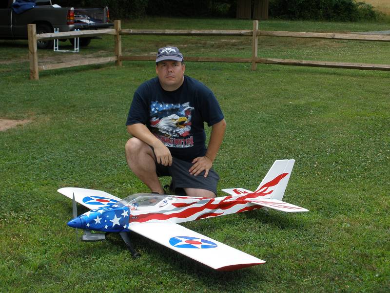

'Tis a dark and stormy night...
However, this morning was gorgeous!! Made a quick stop by the LHS to pick up some props. Got to the field, reamed out a new prop and modified the spinner to fit over it. Got her all fixed up, checked the controls. Had to do some tweaking there. Also turned out to have all three flight controls reversed!! Once those were fixed, I ran a tank of fuel through the engine at full throttle, moving the mixture back and forth somewhat like OS recommends for breaking in a new engine. Filled her back up, put her on the ground and taxied out.
Wind direction was variable, but typically straight down the runway from left to right, and speed varied from dead calm to maybe five MPH. Slow enough to pretty much be negligible. I taxied down to the right end of the runway, turned her around and chopped the throttle. Taking a few seconds to build up my nerves, I then advanced the throttle. She rolled straight down the runway with very little rudder correction. Maybe a hundred feet, bounced a time or two, then gradually leaving the ground behind, a nice straight, level climb!
I took her on up to altitude and played around for a while. A few loops, some rolls, even a bit of inverted flight. Then realized I hadn't even tried trimming anything yet. I did have to use quite a bit of back stick to keep the nose up. So, I started clicking in up elevator, finally winding up with level flight at about eighteen clicks. Absolutely no rudder, nor aileron, trim was required!!
Brought her back around and made a landing approach. She came in pretty hot, but one of the sweetest landings I've ever made. Taxied over to the side of the field and hit the throttle kill switch and she went silent.
Best maiden flight I've ever made! And followed by four more flights just like it. Did a lot of inverted and a lot of straight up. Once the engine is broken in and peaked out, I might actually get unlimited climb out of her! I tried to get her to stall and she wouldn't. She'd just idle across the sky as happy as could be. Based upon that and the hot landings, I'll probably take a click or two out of the throttle.
All told, I'm extremely happy with her. I've now named her "My Colors" because of the stars and stripes theme, and being the patriotic guy I am, I enjoy flying "my colors".
Tom

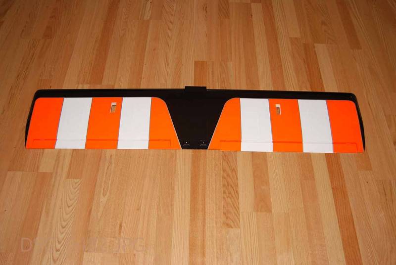

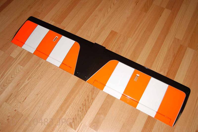

Well, I may not actually get her finished this season (at least at my current pace), but I'm determined to keep making forward progress!
I've managed to obtain a couple of hours this weekend to finish the bottom of the wing.
(Woops - disregard the filename watermark on the photos - forgot to turn that off when resizing them...)
