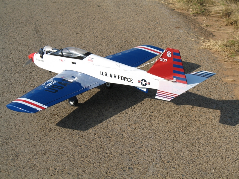

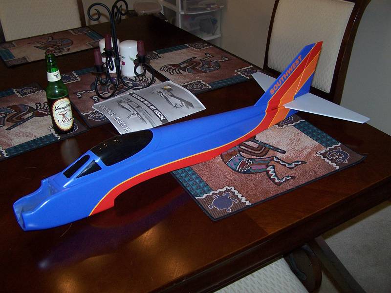

Here is mine.
used blue white and mettalic red.
for stripes monokote red sticker (no metallic avilable).
I'm flying it with an os 25 la, had one laying around.
takes a little time to speed up...
I recomed to use small wheels on it. against drag.
The only problem with this plane, is that it is sensitive to winds (light whight).
I've added a little fin on the bottem to improve it's stablity. (and it works).
A very fun plane to fly.

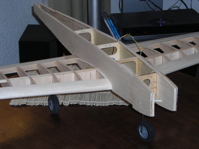

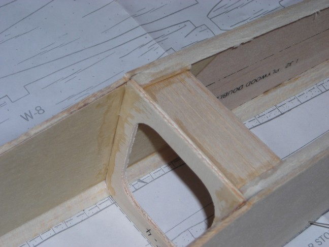

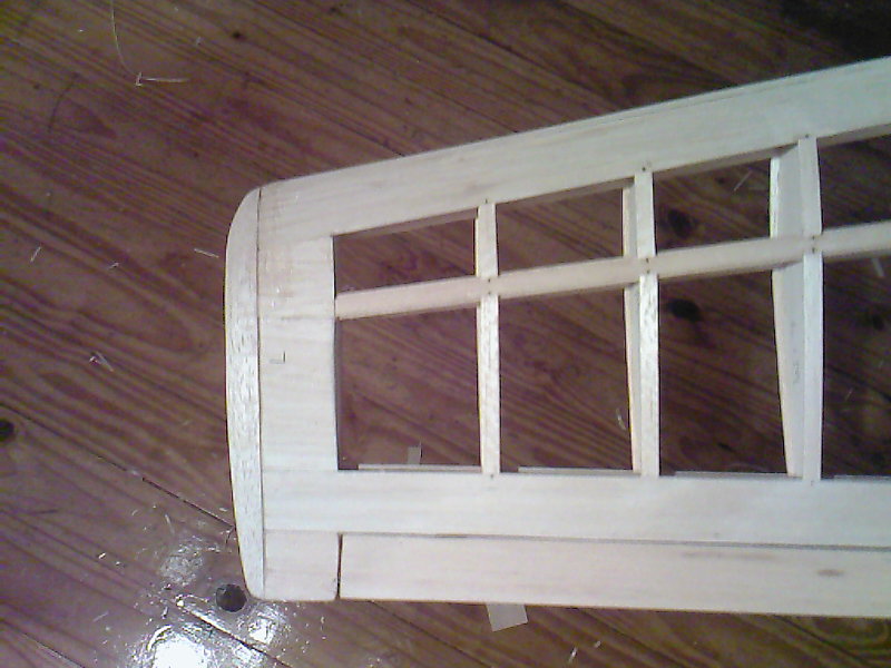

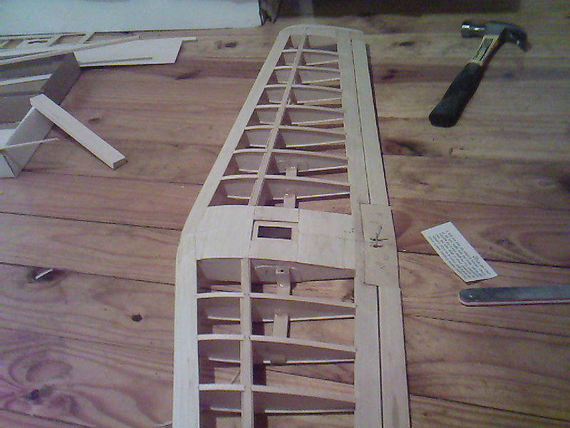

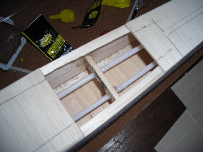

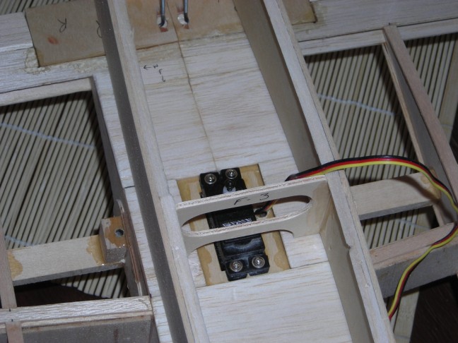

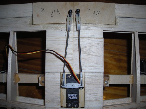

My wing is almost finished , torque rods installed , just need to align them, ailerons are ready to be covered.
just need final sanding on the wing and then it ready to cover , until the rest of the plane is finished.
Started with the fuse , now busy with the firewall , might need to build a new one . Im going to use a OS 46 LA instead of the TT25 pro.
So the engine mounting might be wider, will see and test fit when I get the motor.

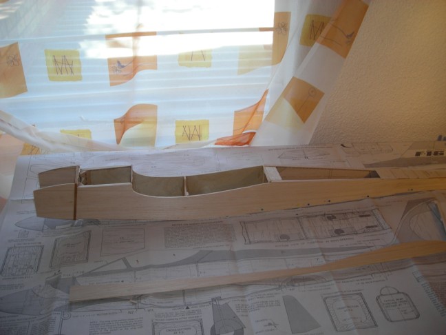

After about two months of working hard and studying and exams and stuff I started building again, Fuse is off the plan and dead straight, im very impressed with myself on the straightness of everything, I took my time and it paid!
I started with the tail feathers last night ,
next step on the fuse is the tank and wing mounting blocks, then front wheel and throttle pushrods and planning the servos inside the plane,
im gonna make the cover under the tank removable for maintenence if neccesary.
Its looking good sofar and im really excited.
The TT.25 is still my planned enjin for now, the 40la sale didnt work out.
See the attached pictures , please feel free to comment on anything

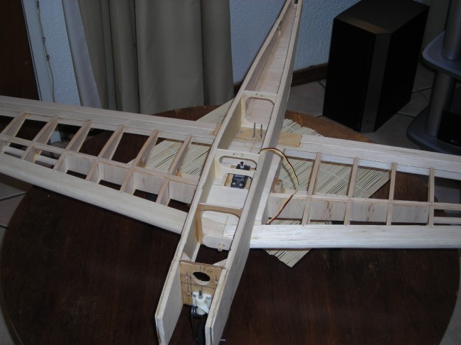

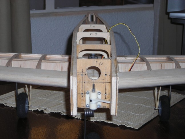

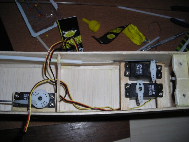

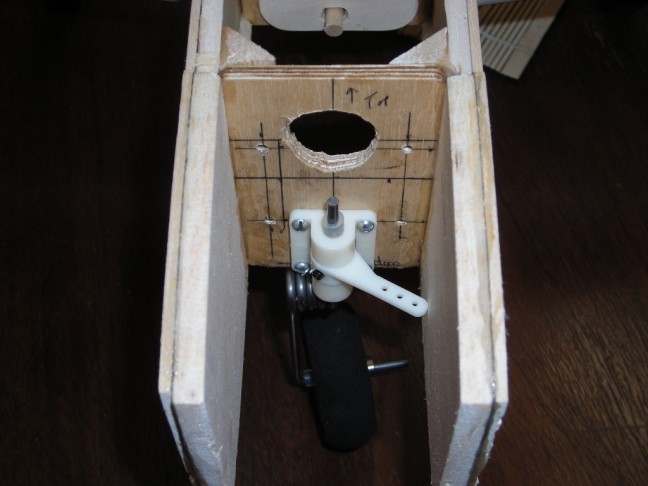

Last night I installed the rudder/nosewheel servo , nosewheel pushrod, throttle servo and pushrod,
and the aileron pushrods.
The Tank is in , no fixed yet but i had to get it in too see where my pushrods can move.
Motor is on temporarily until all hardware is installed

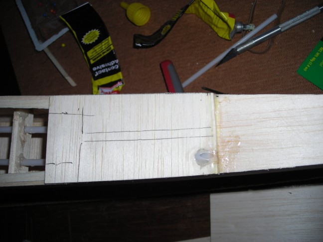

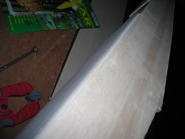

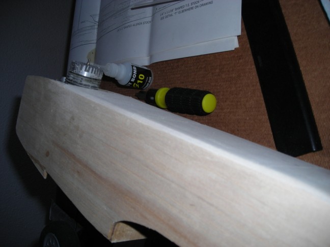

The wing mount is on, with blind nuts on the back.
Laser Rods Guides are glued in and the top of the Fuse is sheeted except for where the laser rods were glued in the middle of the fuse.

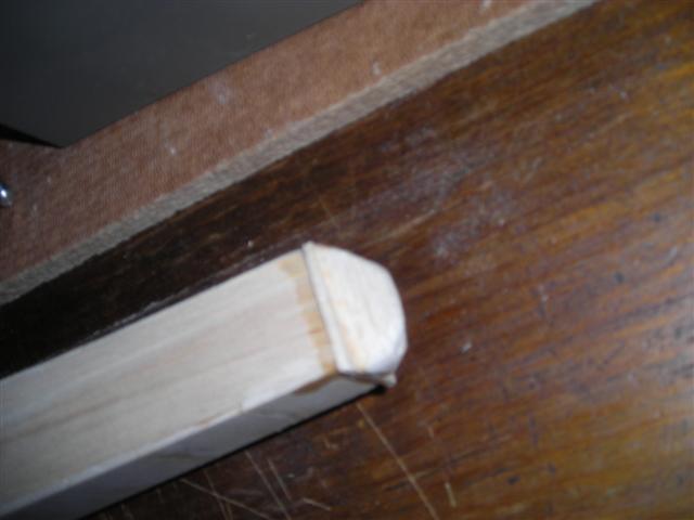

Still need to sheet there. I experimented a bit with the sanding of the fuse,see in attached pics where the corners are rounded.

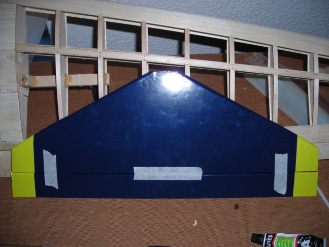

The Rear wing and elevator has been covered, my first ever covering job. Didnt come out to bad i think.
Comments and suggestions and tips please

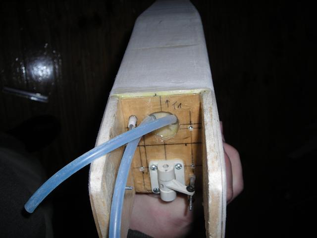

Got the tank fixed in the nose, the top of the fuse is sanded , i bought wheels , nice rubber ones. Idont like the foam, they get flat spots when they stand for a week. But i couldnt find a damn yellow spinner!!! my colour scheme depends on it! why me!
any way that can wait. i have decided that i am not going to close up the cowl. its 2 small in there and i dont have the motor im gonna use yet.The fuel tubing is also in and the whole front of the plane is fuel proofed with epoxy
attached some pics of the progress

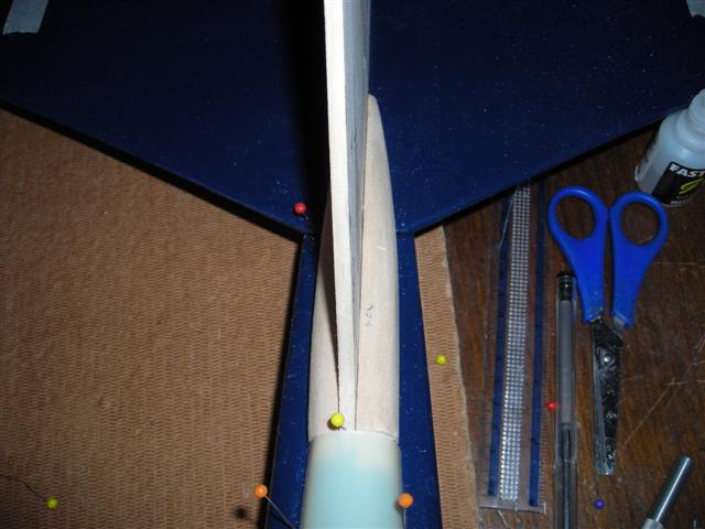

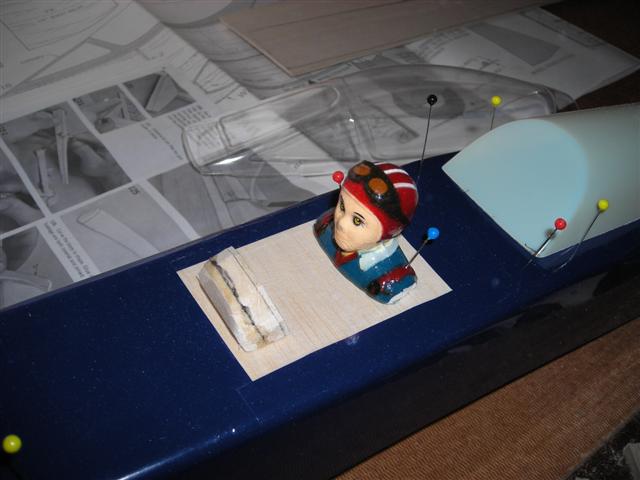

Last night was spend on some detailing in the cockpit, I printed an instrument panel and added some balsa in the back.
All still needs to be painted black . Next is a headrest/seat type thing for the pilot.
I also finished the top part of the fuse, it came out pretty good, i was scared of starting with it.
The front of the fuse is going to be covered in yellow, maybe yellow and blue checkers. The ideas are just popping into my head now and i dont want to overdo it.

Here are a couple of pics from my Kobra re-build. Well maybe not the 737....
Dan
