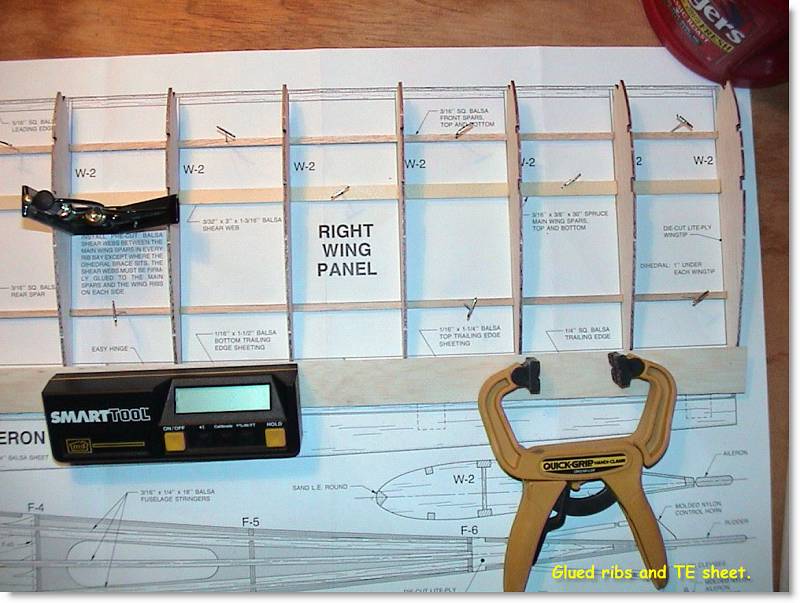

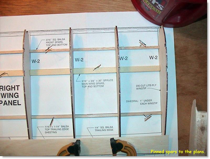

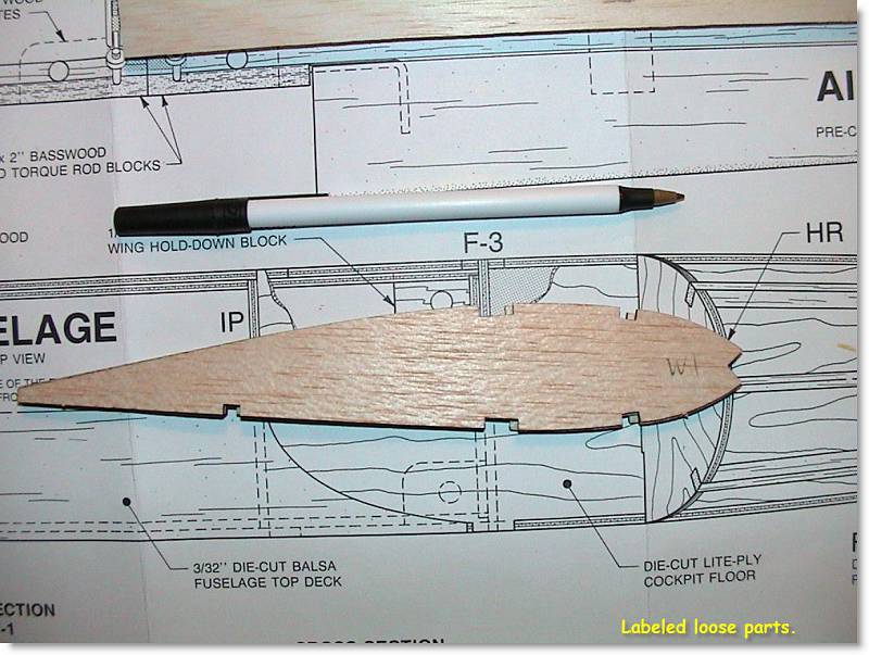

After inventorying the parts I labeled the W-1 ribs because they came loose. I then started on the right wing. I pinned the spars to the plan and dry fitted the ribs. Next I glued the ribs and added the TE sheet to the top of the ribs. I used the dihedral jig for the inboard W-1 rib.

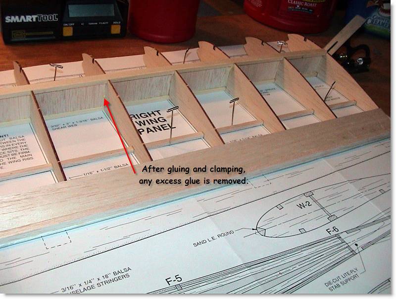

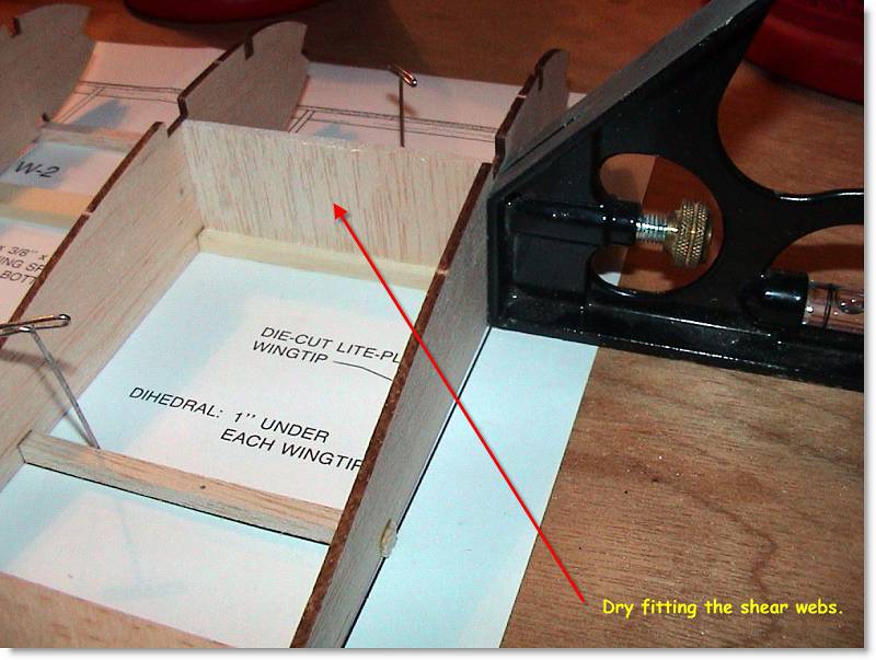

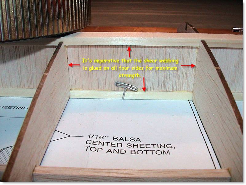

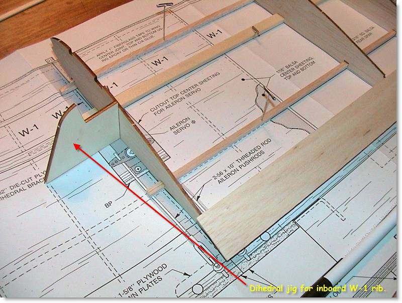

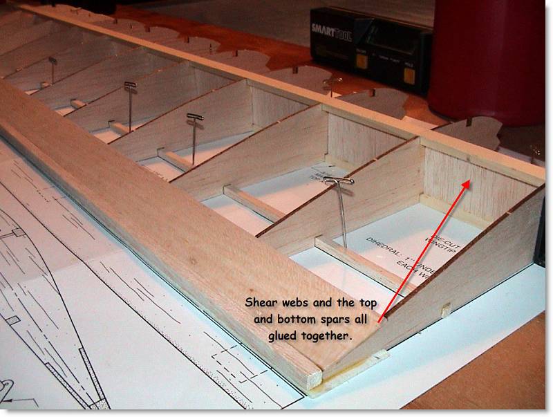

Before gluing in the shear webs I braced the outer rib to keep it straight and prevent it from bowing outwards.
I dry fitted the shear webs and sanded as needed. I then dry fitted the top main spar to make sure it would seat flush into the slots, then glued them all together. The top and bottom TE sheeting and spar are also shown glued in place.

It's imperative that the shear webbing is glued on all four sides for maximum strength.
Next I started sheeting the top.

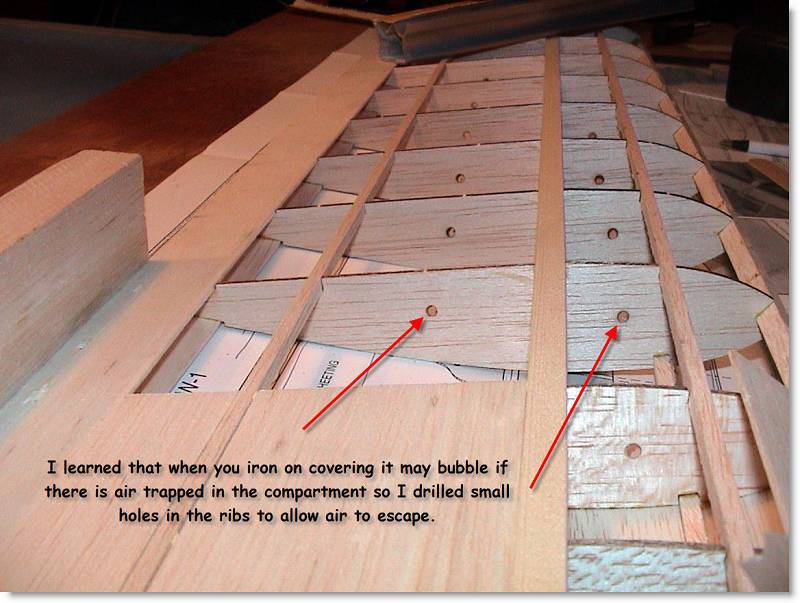

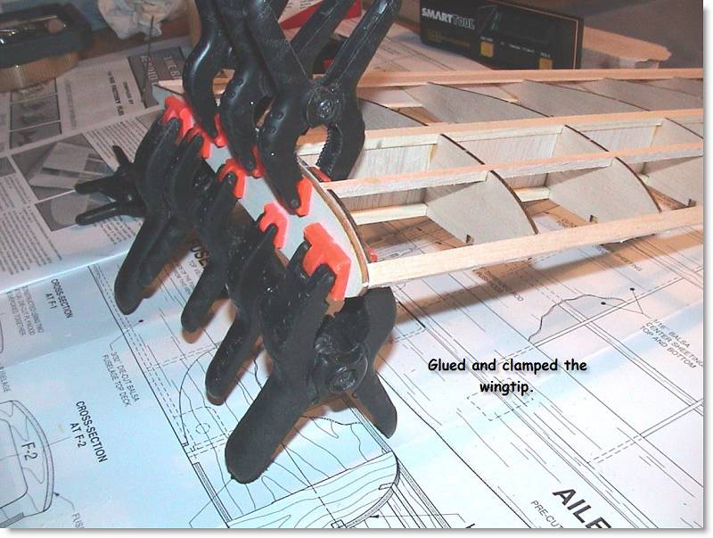

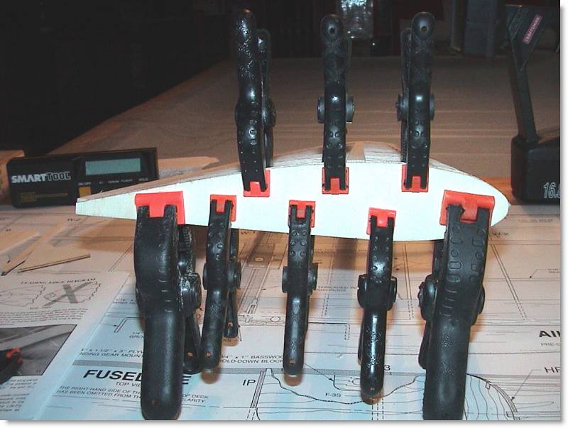

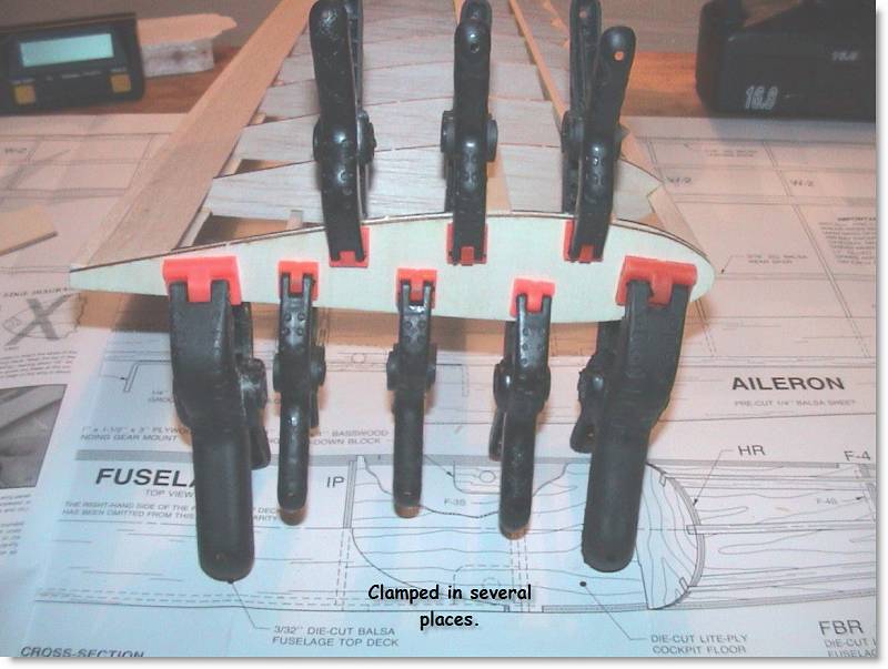

Glued and clamped on the wingtip.
I learned that when you iron on covering it may bubble if there is air trapped in the underlying compartment so I drilled small holes in the ribs to allow air to escape. My covering skills are still evolving so I need all the help I can get
Bottom of the wing is sheeted. I clamped the curved sheet to make sure it would stay.
Popsicle sticks, tongue depressors, etc. are useful for helping clamp. I sometimes place wax paper under them to make sure they don't stick.

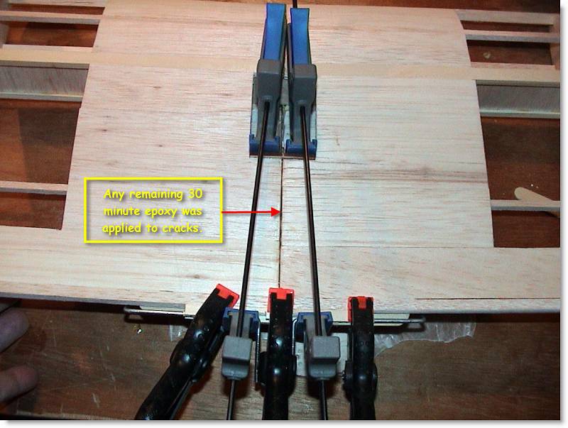

I glued the wing panels together with 30 minute epoxy then clamped them together.
The dihedral should be 2 degrees per wing panel.
To check this angle, the manual says to lay one wing flat and check the distance from the table to the bottom of the raised wing. This should be approximately 2 inches.

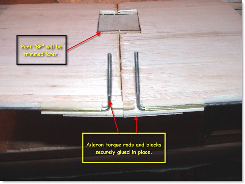

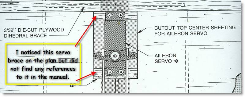

I glued the piece labeled "BP" with 30 minute epoxy.
Torque rod blocks and plywood wing hold-down plates also glued in place with 30 minute epoxy.
Any remaining epoxy was applied to the seam between the wings.
I noticed the plans showed a brace for the aileron servo but found no reference to it in the manual. I will have to add that later.

Old 03-25-2007 | 11:51 AM
Kmot's Avatar
My Feedback: (24)
Joined: Jun 2003
Posts: 10,963
Received 5 Likes on 5 Posts
From: Northridge, CA
Default RE: SIG Fourstar 40 (4*) Build Thread
The servo brace, as you call it, looks to simply be hardwood blocks to screw down your servo in place. As for flaps, seems everything I have ever read about the Four Star series of planes is that they are all floaters, and do not need flaps. But if you want to install them, I like the idea of about equal splits, as in your first photo.

Here is the plywood wing hold-down plates, aileron torque rods, and the torque rod blocks glued in place. The part "BP" will be trimmed later.
ID:	649592   Click image for larger version
ID:	649593   Click image for larger version
