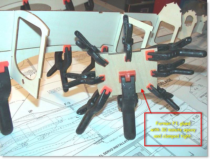

Old 03-25-2007 | 05:21 PM
  #27
rwright142's Avatar
Joined: Sep 2004
Posts: 2,143
From: Indianapolis, IN
Default RE: SIG Fourstar 40 (4*) Build Thread

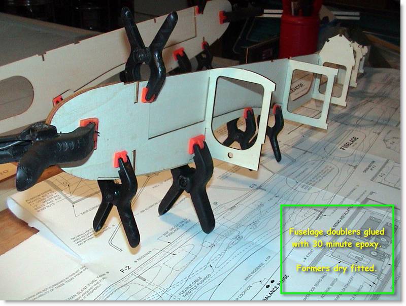

I applied the fiberglass strip to the wing center section so have moved on the fuselage.
The fuselage doublers have been glued to the fuselage with 30 minute epoxy.
I'm glad the manual says to "Make sure you make a left and a right side!"
Former F1 glued with 30 minute epoxy and clamped tight. The remaning formers are dry fitted.
ID:	649750   Click image for larger version

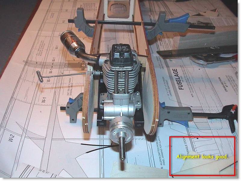

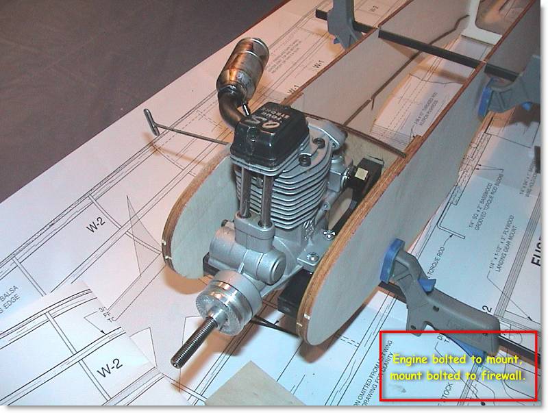

Engine bolted to mount, mount bolted to firewall. Alignment looks good. Had to make a small notch for access to the needle valve.

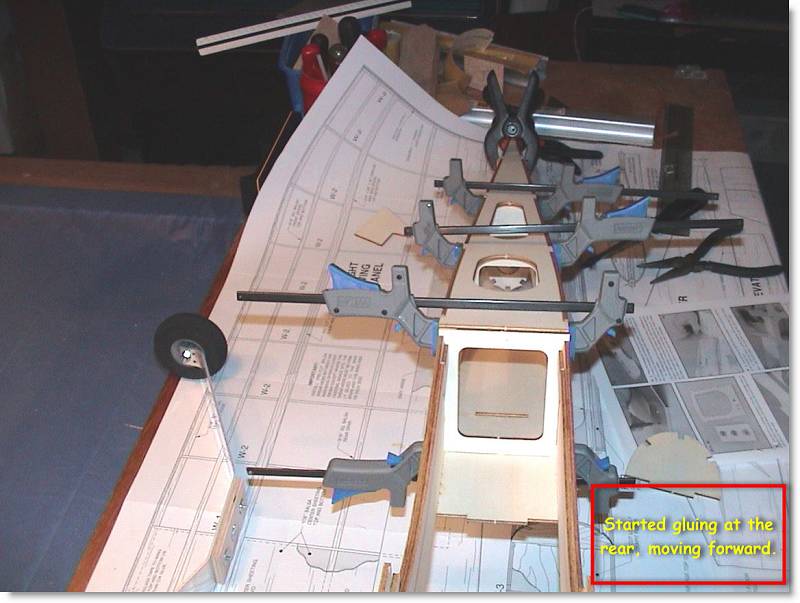

Started gluing at the rear, moving forward. Waiting for the aft to dry before I start on the front.

rw: You sure do have a nice collection of clamps!

I was marveling at that as well; he sure knows how to hold things down.

hahaha - ok... I guess I 'over-do' it sometimes...
You can use them for many things: belts, bread 'twisties', to hold clothes on the clothesline, radiator hoses, earrings, billfold, to hold your nose closed when swimming, etc.

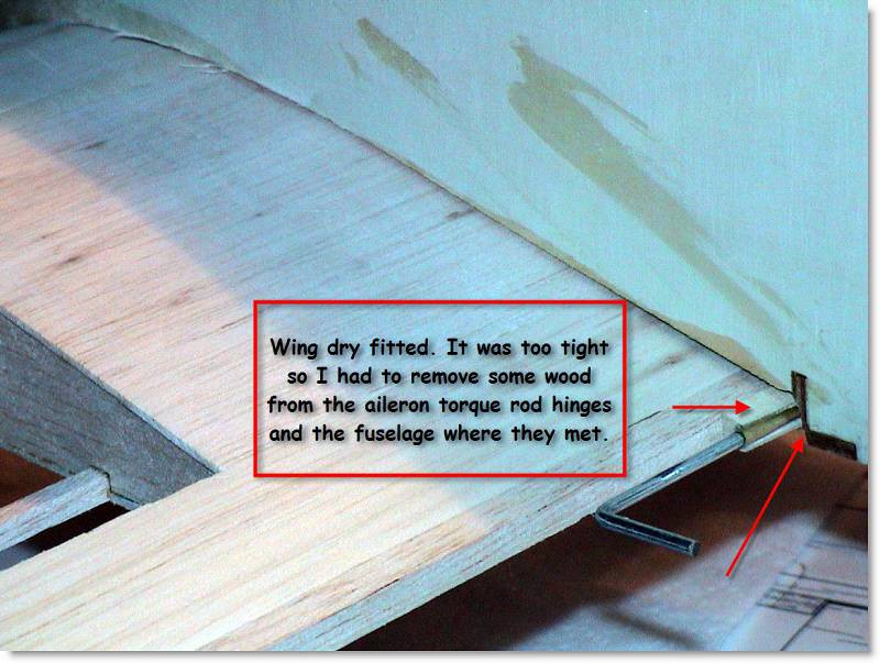

The next thing I did was measured, cut, dry fitted, then glued in place the stringers.
I then dry fitted the wing.
It was too tight so I had to remove some wood from the aileron torque rod hinges and the fuselage where they met.

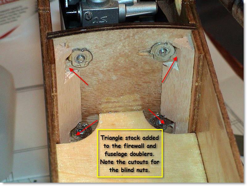

I glued in triangle stock to the firewall and fuselage doublers. Note the cutouts for the blind nuts.

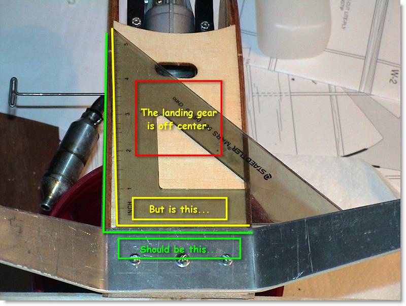

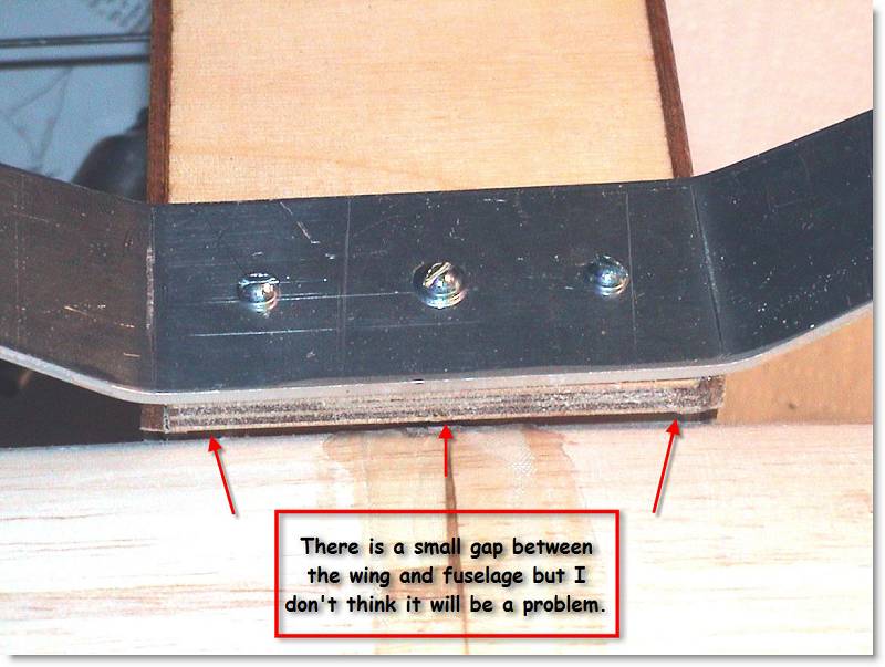

Old 04-01-2007 | 09:08 AM
  #34
rwright142's Avatar
Joined: Sep 2004
Posts: 2,143

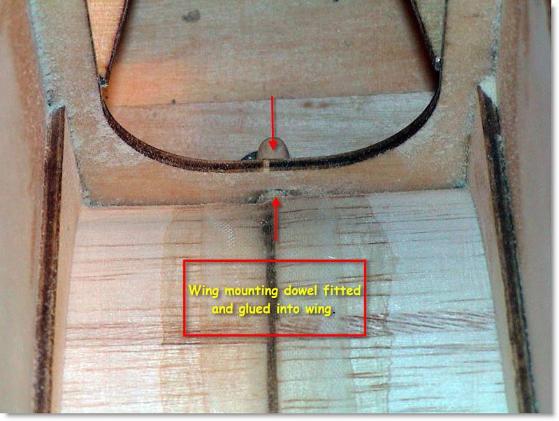

I fitted and glued the wing mounting dowel into the wing.
Before drilling the wing mounting holes, I used string to make sure that both ends of the wings were the same distance from a point at the end of the fuselage. I had to 'scoot' the wing sideways just a little to achieve this. I then drew a line on the fuselage and the wing to use as a guide before I drilled and tapped.
Notice a small gap between the wing bottom and fuselage - I don't think it will be a problem.
The landing gear is off center. I won't know how badly this will affect taxiing until I get the tail wheel on, but does anyone have a suggestion for a fix? Should I be able to slightly bend the aluminum where the wheels screw in?
ID:	654298   Click image for larger version
ID:	654299   Click image for larger version
ID:	654300   Click image for larger version
Old 04-09-2007 | 07:45 AM
  #35
Joined: Feb 2004
Posts: 21
From: Del Rio, TX
RW: Based on my ARF version of the four* and reading other threads, the small gap between the leading edge of the wing and fuse is normal. I fuel proofed the area and added a small strip of foam that seals the gap when the wing is installed.
Re misalignment of the landing gear. I'm sure you're aware of seveal solutions, but I think I would just ream out the two outboard holes to allow alignment. If the screws then won't prevent it from shifting, I would add two more outboard holes and secure with 1/2 inch self tapping screws.
Old 04-09-2007 | 08:10 AM
  #36
rwright142's Avatar
Joined: Sep 2004
Posts: 2,143
Thanks for the tips, I will follow your advice.

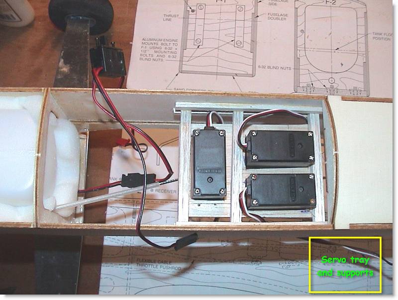

Here's the servo tray in place and a shot of the entire servo bay with push wire and rods attached.

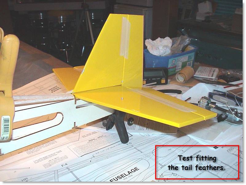

I test fitting the tail feathers and measured the length of the push rods for connection to the rudder and elevator.
I then routed the throttle cable and fuel lines through the firewall.
Former F2 had to be notched to allow throttle cable to pass through.

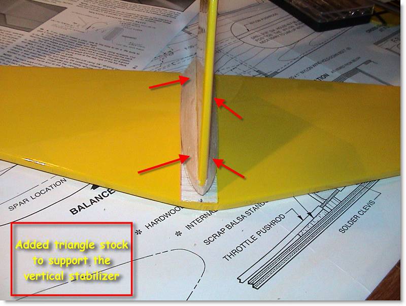

Old 04-24-2007 | 06:44 AM
  #43
rwright142's Avatar
Joined: Sep 2004
Posts: 2,143

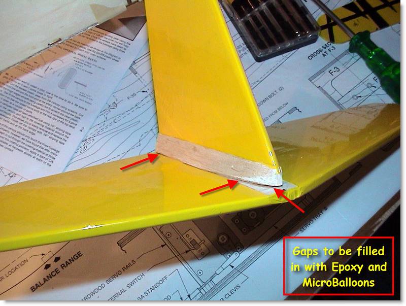

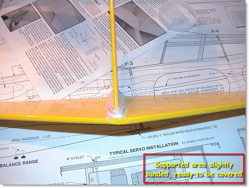

I followed mclina's advice and added triangle stock to support the vertical stabilizer.
Shown are gaps that will be filled in with Expoy and Micro Balloons.
Then you see the gaps filled with 30 minute epoxy (picture says 20 but it is 30) mixed with the Micro Balloons.
Next you see the strengthened area slightly sanded, ready to be covered.
ID:	671210   Click image for larger version
ID:	671211   Click image for larger version
ID:	671212   Click image for larger version

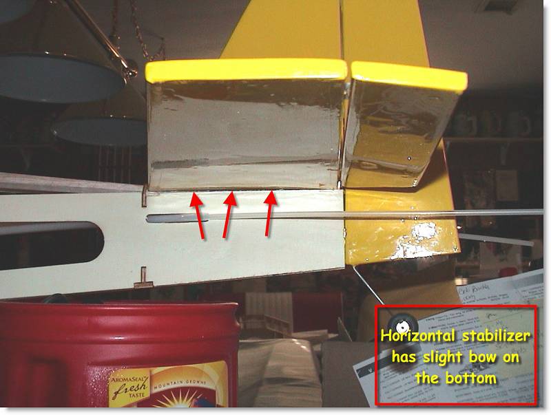

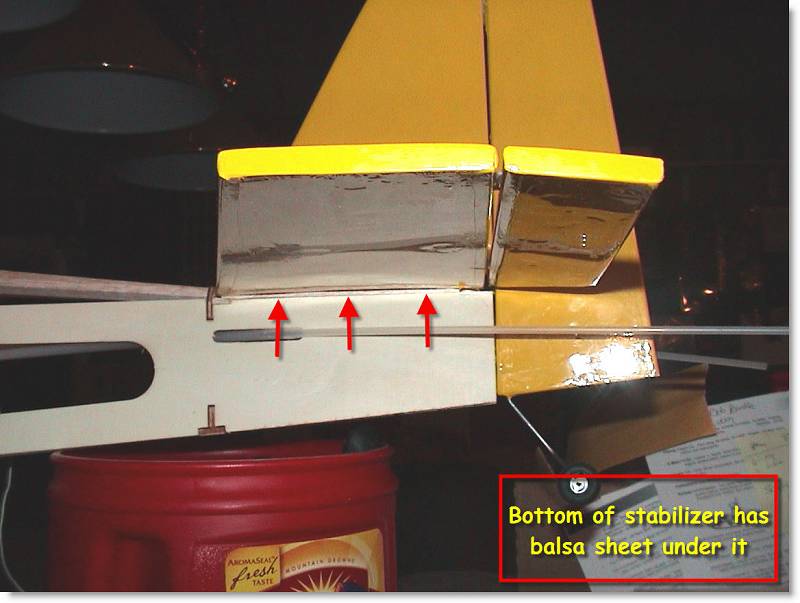

Old 04-24-2007 | 06:47 AM
  #44
rwright142's Avatar
Joined: Sep 2004
Posts: 2,143

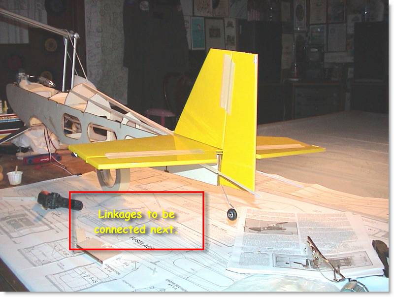

I did not notice this before, but the bottom of the horizontal stabilizer has a slight bow preventing it from seating flat onto the fuselage. I placed a sheet of balsa under the stabilizer, sanded, and then glued it to the tail. I will add some filler before expoying the empennage on.
The rudder and elevators are hinged in place. After covering the fuselage I will add the hinge to the aft section for the bottom of the rudder. The empennage will be moved aft slightly because in the pictures the rudder touches the fuselage.
ID:	671214   Click image for larger version
Old 04-24-2007 | 09:02 AM
  #45
mclina's Avatar
Joined: Dec 2006
Posts: 1,809
From: Westford, MA
Looking good. I see that you did not bevel the leading edge of your elevator or rudder. Does this give you enough clearance to get full throws without binding?
One mistake I made, which you did not, is that I didn't check that my veritical stab was aligned with the back edge of the fuselage, and I ended up with a bigger hinge gap than I would have liked on the lower rudder hinge. Your's looks much better.
Keep those pictures coming.
I checked the deflection and all is good. I thought about rounding the LE and TE edges and just got lazy I think - or maybe distracted... My granddaughter spends a lot of time on the bench with me working on her 'airpwane" so I spend a lot of time making sure she is careful. I keep her away from the glues, sharp instruments, etc... I just enjoy watching her build and may forget where I was in my build... hahaha
Luckily, as I was epoxying the VStab onto the HStab I remembered the part about it up with the rear of the fuse or I would have made the same mistake.
Thanks again for the triangle stock support tip. You just may have saved my plane from a crash.

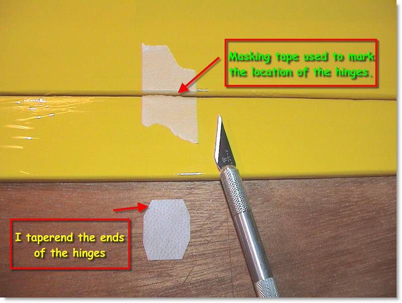

There are numerous threads about covering so I won't post the process. Suffice it to say I sanded with 240 then 400 grit sandpaper. If you are interested in seeing a couple of the tutorials by Mike Buzzeo (Minnflyer), go here
http://www.rcuniverse.com/magazine/a...article_id=726
or here
http://www.rcuniverse.com/magazine/a...?article_id=67
For the wings, make sure you cover the wingtips before anything else. It makes the covering look a lot better with less wrinkles.
I used scissors to taper the ends of the hinges to help them slide in.
the masking tape is used to mark the location of the hinges on the wing and the ailerons to keep them on target.

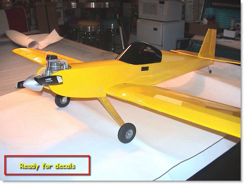

She's ready for decals!
I need to secure the canopy, any suggestions? The manual says to use 1/4 inch trim tape but I don't have any. Can I use Titebond, CA, or epoxy? I don't intend on taking it off, and it is painted on the inside so I don't care about the cloud that CA causes. I just want to know if one of these will work to keep it on.
Control throws are spot on.
The manual says to balance on the main spar. By my measurement it turned out very nose heavy (3.25 inches from the LE). I will need weight on the tail. Any suggestions on where to add tail weight? I was thinking of screwing something on to the bottom aft of the fuselage, under the elevator pushrod. Opinions?
The last picture is of my granddaughter Abby. I will take this picture and make a decal out of it and place it on the vertical stabilizer. In the picture she's chalking my pool stick so the writing on the tail will say "Hot Shot".
