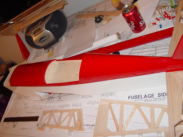

For those of you that are interested, here is some Monokote work, along with some tips. I know there are some folks out there that know it all. This is for the people who welcome help. I am enjoying sharing my building, maybe I will continue this as the plane completes.
For your Monokote job, you could just do what most ARF planes come with, and that is 2 pieces of covering that overlaps in the center, but that leaves a visible seam that I don't like. Since I am custom building this airplane to my liking and more strict pickiness, I want a seamless job on the top of the turtle deck and fuse. To do this, first decide where you want the top color to start, and make a paper pattern.

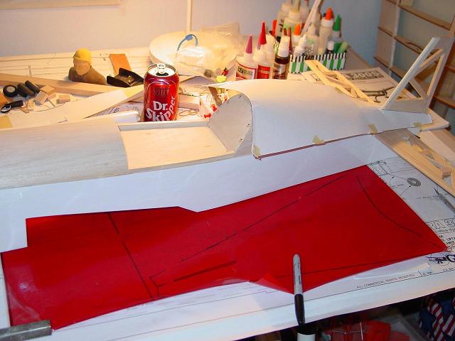

Default Stuffing a .60 into a GP Extra 300 .40 kit
With the paper pattern taped in a few spots, draw a few reference marks for where you want the color seperation, and curve the paper the best you can to the other side and do the same. Add more paper if you need to, the remove, cut out, and recheck. If it looks right, then transfer the pattern UPSIDEDOWN to the BACK or inside of the Monokote (the backing) and trace it with a permanent marker.

Transfer the Monokote ( or whatever your using ) to the airplane, and put a few tabs of tape on to keep it in place. Measure the other side and adjust if you need. Make it as smooth as possible. Tack a few spots near the tape, then iron the seams ONLY, and maybe up about an inch. Do both sides.

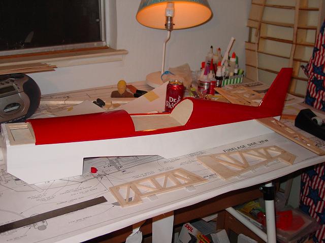

With a heat gun, going a little bit from one side then the next, slowly shrink the sides first ending up in the center last. It will need a lot of heat, be careful to not burn a hole, or yourself. Make sure that you have the sides well ironed down, and try not to reheat the sides, that would cause them to shift. When done, it will look smoother than most guys stuff out there, because you did it yourself, and listened to some advice. Know it alls need not apply.
Have other stuff to do to, but will keep you posted.

Sorry it has been longer than expected, I've had other things to tend to, but here is the plane in the finishing stages of Monokote, then will be the plastic cowing and wheel pants, I should just spend the 50 bucks and buy the Fibertech ones, but thats 50% of the cost of the plane, so on this guy, I will be cheap and use the kit's plastic stuff, and save the money to finish up my 33% Extra.

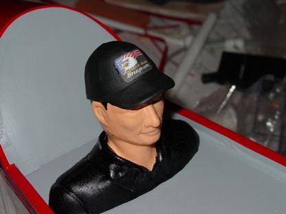

still behind on this, but here is his Snap-on cap.

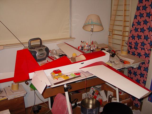

Still behind on this project, but it is closer to getting done, as is, it is ready to fly, but there are some finishing touches to be done, like mount my fill line, N numbers, tail graphics.
Here is the .60 Rossi

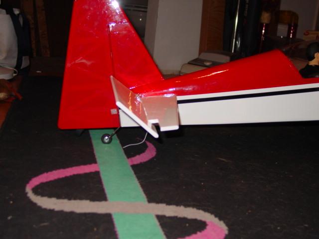

This should be enough elevator

I will have to finish this up in a couple of weeks, I have another plane to put together for my buddy, an extra Extra.

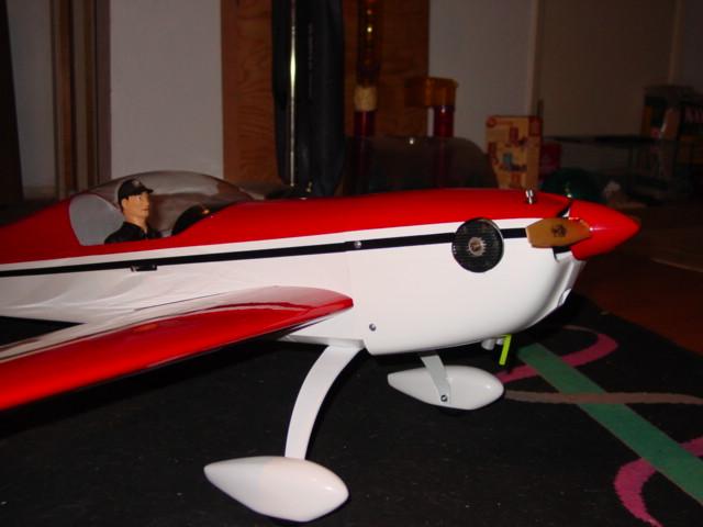

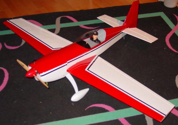

A few finishing details done.
If you got this far, thanks for getting past all the ulgy negative stuff from before. In my opinion, it was still worth it.
