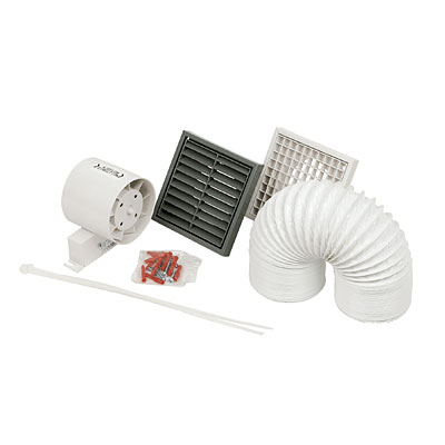

If you are using CA a mask is a waste of time. The vapour will go straight through it.
You need an extractor fan to give positive ventilation.
See below mine cost £12. Hang the hose out the window and set it to suck. Place the fan unit next to the area to be glued and work away.
I am very very allergic to both CA and epoxy but use both with this system. [ Surgical gloves as well with epoxy. ]
