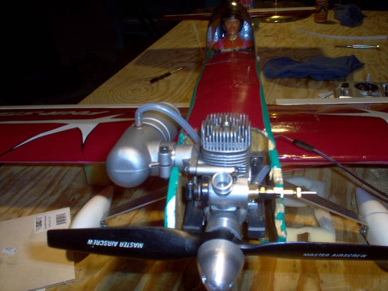

THE build is coming together I sent pictures of my 4star 40 i got one of my club members crashed so i took it and rebult it i have a super tigre 40 on it and she realy pulles out just thought TO SHARE

Great looking plane FlyingDJ
I may already have an engine If I can get an adjustment needle for it and it fires up Ill just use the engine I had in my garage.. its a GP 45

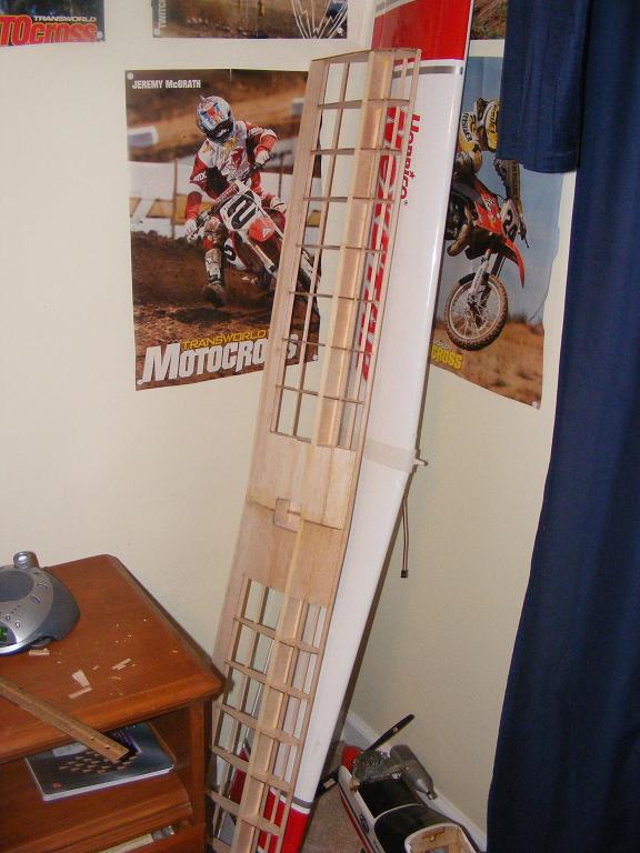

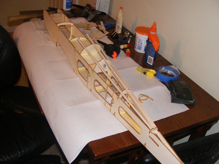

Hey everyone!
Got a little bit more done
Heres the fuselage all glued and still letting it dry though
Put the stringers in place, is that how the back of the stringers are supposed to sit?
Let me know how it all looks

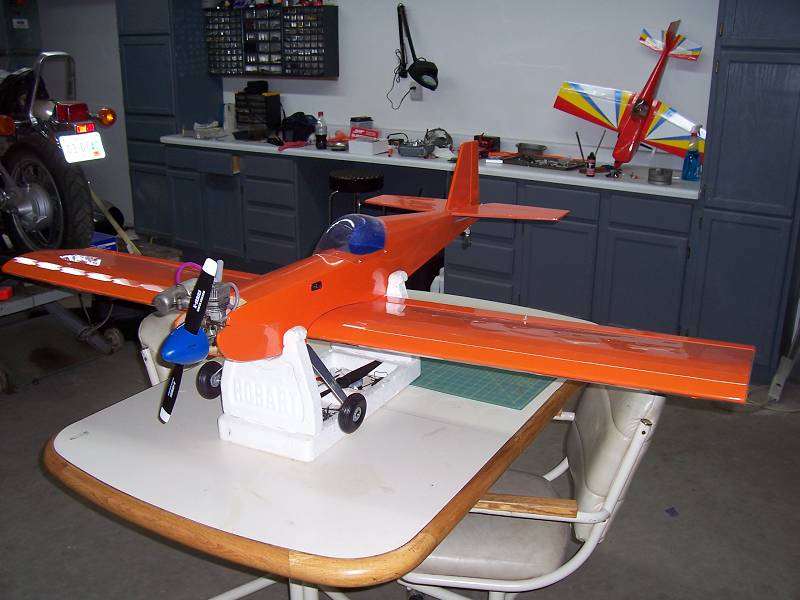

Did someone mention an orange 4 * ? .40 and .60 both orange . lol

great looking planes!
what colors the bottom?

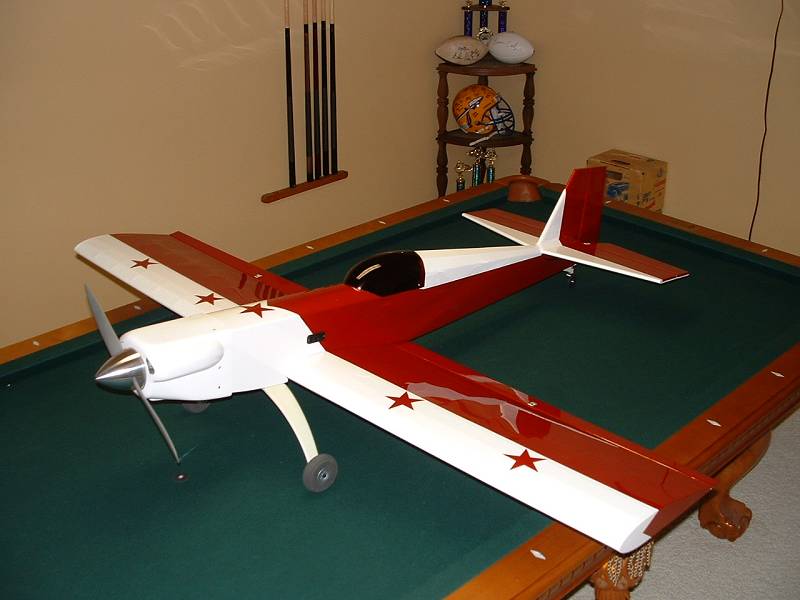

Did anyone mention yellow or Metallic Red and White. The yellow 40 was my first kit-46 ax with 12.25x3.75 APC prop-SOOOO nice. The 60 I just finished-should fly but who knows!

The .40 has 4 inch wide black and white stripes. The .60 has 8 inch dark blue and white squares .
